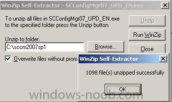

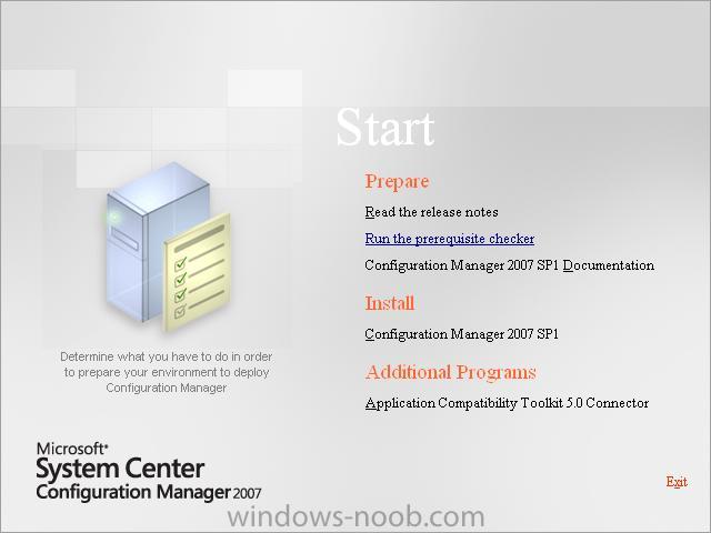

First of all download the Service Pack 1 update and then run the EXE file which will unzip it to a folder of your choice (I chose to call the folder sccm2007sp1)
Once unzipped you can burn that to a DVD or run the splash.hta file contained in C:\sccm2007sp1\SCConfigMgr07_UPD_EN

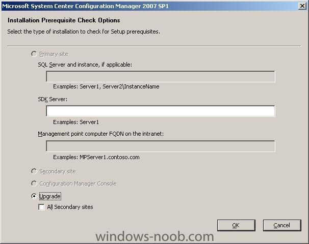

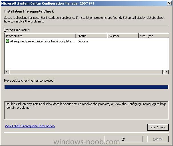

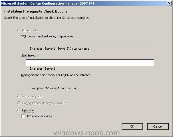

Once it starts you can run the prerequisite checker to see what you need to fix before continuing...

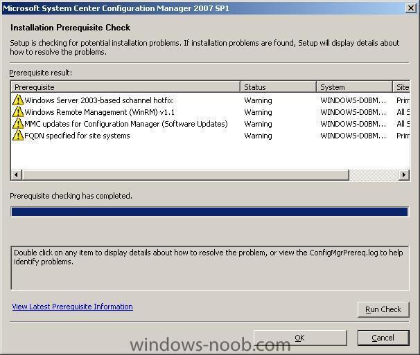

you will be presented with a prerequisite check
I left everything as it was and clicked on OK

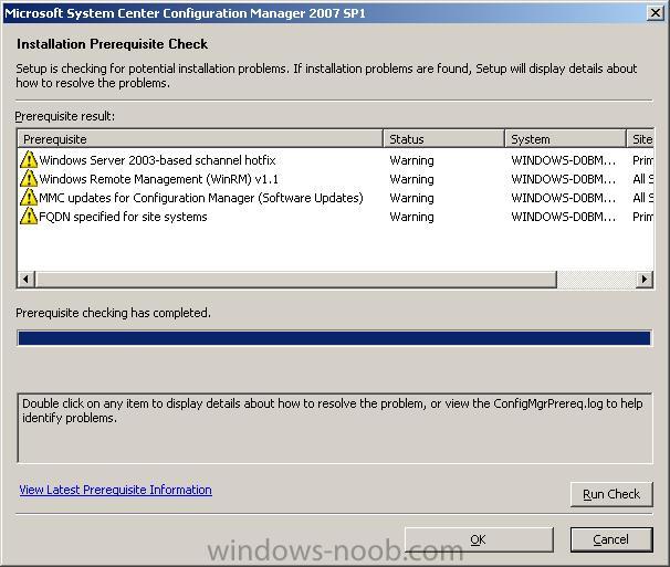

once done you'll get a list of errors that need to be resolved such as below, double click on any one to see what the recommended action is and then action each one
My first error told me that I needed to do as follows:

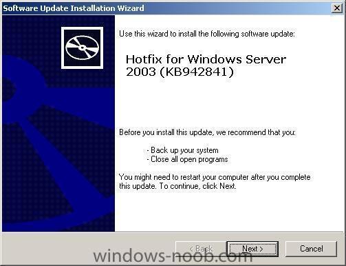

Configuration Manager out of band service point requires Windows Server 2003-based schannel hotfix. The schannel hotfix is available for download at: http://support.microsoft.com/kb/942841/en-us.
as this was a hotfix i was pleasantly surprised to see that Microsoft now allow you to download the hotfix semi-directly, you have to enter your email address twice and input a number displayed on screen, you then get an email with the hotfix download details...
So I downloaded the first one and extracted it with the password supplied in the email.
While the hotfix installed I clicked OK on the prerequisite checker for SCCM 2007 sp1.
Once the hotfix was done installing, it wanted a reboot, so I rebooted. And then I ran the SCCM 2007 SP1 prerequisite checker again by starting at the beginning and running splash.hta...
This time however I was down to only 3 warnings :)

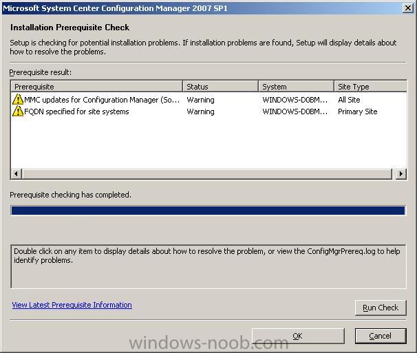

I must have been lucky because when I ran the SCCM sp1 prerequisite checker again, I was only shown 2 warnings (below)
Next up was my MMC update
This software update addresses several MMC errors that may occur when running the Configuration Manager console. This update should be applied if any of the following occur: Configuration Manager console stops responding when the host computer is low on available memory, context menu errors on console home pages, or inconsistent display after drag-and-drop operations do not succeed. More information about this update is available at: http://go.microsoft.com/fwlink/?LinkId=98349.
Once installed, I ran the SCCM 2007 SP1 pre requisite checker again, it told me i still needed this fix, so I decided to reboot (the hotfix didn't request it), the reboot didn't help it still listed it as a warning...
so I viewed the ConfigMgrPrereq.log file (stored in the root of C:\) and it had a line that read
Failed to connect to registry for KB940848 with 203 that lead me to this post
Using regmon from Sysinternals I found the missing key and made a reg file of it, if you want it make sure you've applied the correct hotfix first then:-
As a workaround I've produced the following hack.

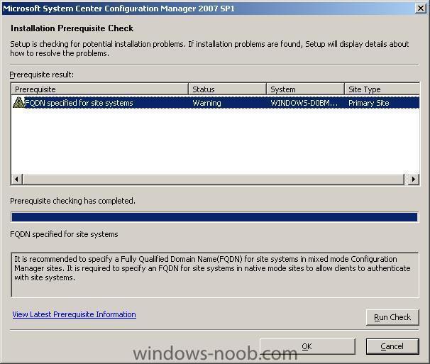

FQDN Warning.
It is recommended to specify a Fully Qualified Domain Name(FQDN) for site systems in mixed mode Configuration Manager sites. It is required to specify an FQDN for site systems in native mode sites to allow clients to authenticate with site systems.
As my SCCM 2007 site is mixed mode I chose to resolve this warning by doing as follows:-

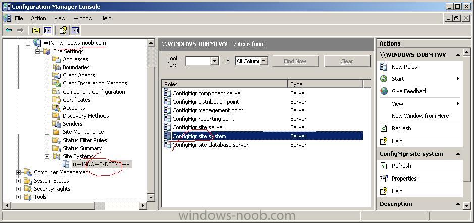

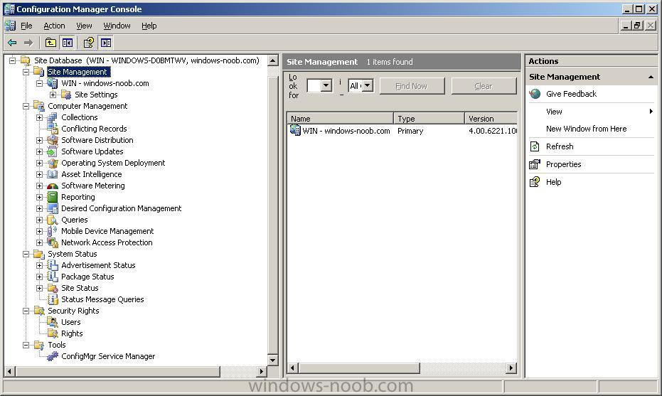

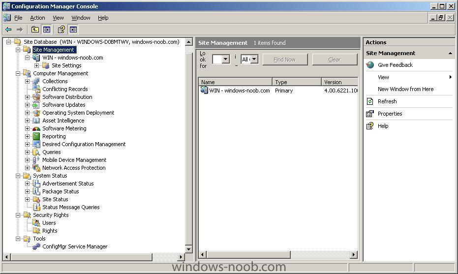

To fix the FQDN error try the following:
1. Start SCCM Console
2. Click Site Database
3. Click Site Management
4. Click on Site
5. Click Site Settings
6. Go to Site Systems
7. Click on SCCM Server (where State Migration Point is located)
8. Right click on “Configmgr Site System”
9. Click on Properties

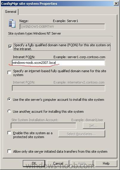

10. In the "Specify a fully qualified domain name (FQDN) for this site system on the intranet” change the Intranet FQDN to something like my example here
it was WINDOWS-DOBMTWV
I changed it to windows-noob.sccm2007.local and clicked apply,

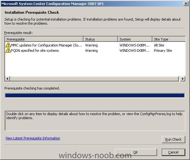

after waiting a few minutes for SCCM 2007 to udpate itself I ran the pre-req checker again and finally, success !

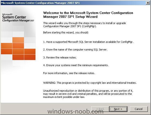

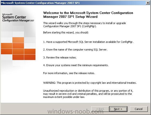

Part 2. Run the SCCM 2007 SP1 installation wizard.

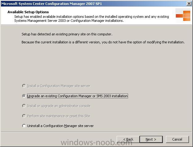

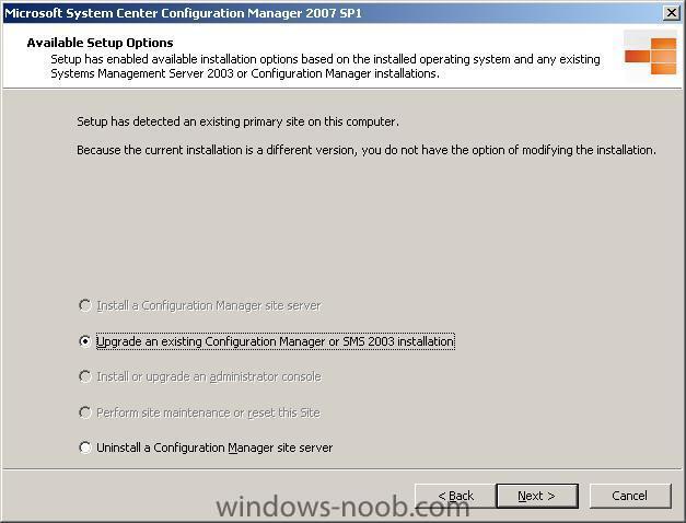

Click Next to continue and choose the default option which is to 'Upgrade...'.

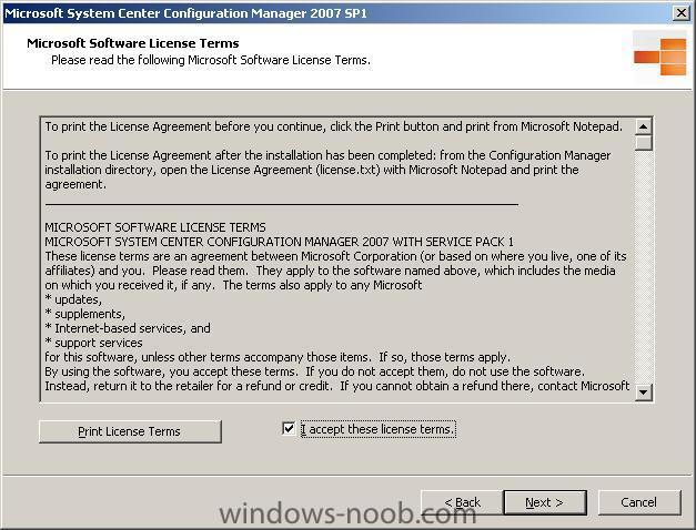

accept the license and click next

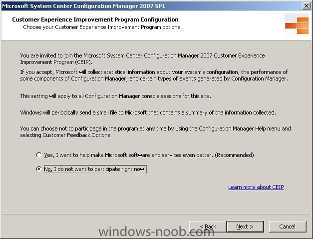

decide if you want to participate in the CEIP

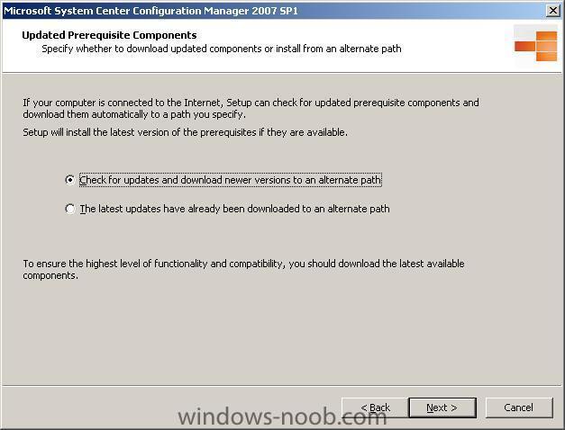

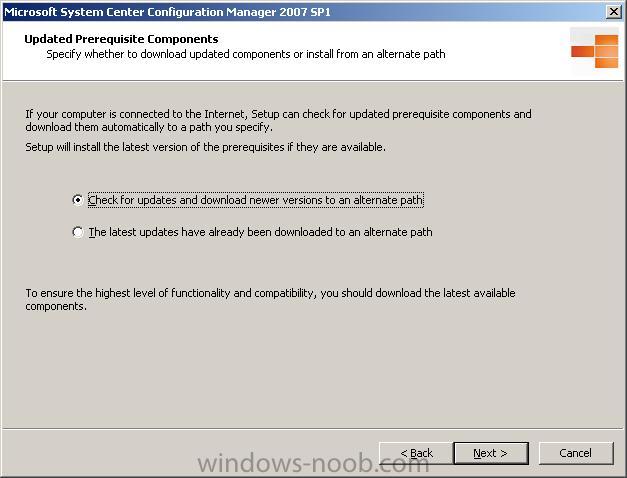

let the wizard check for updates....

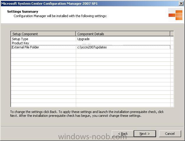

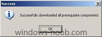

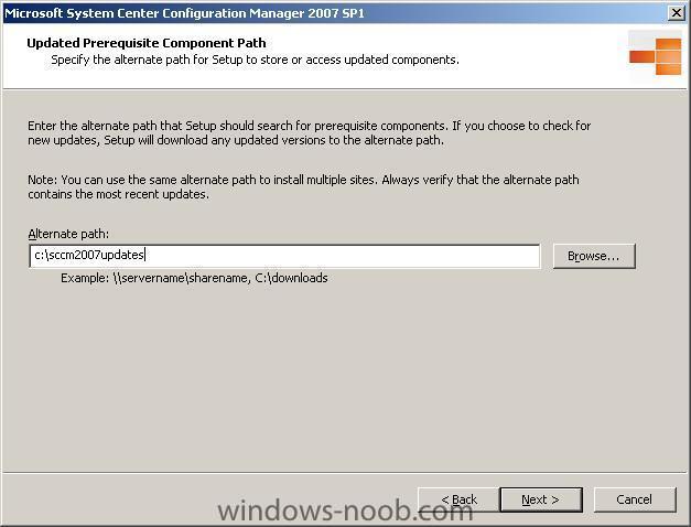

create a new local directory and then give that path to the wizard for the local updates to be stored...

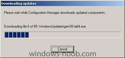

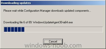

updates are downloaded (89 in my case...)
you'll be told the update download is complete,
and you'll get an upgrade summary

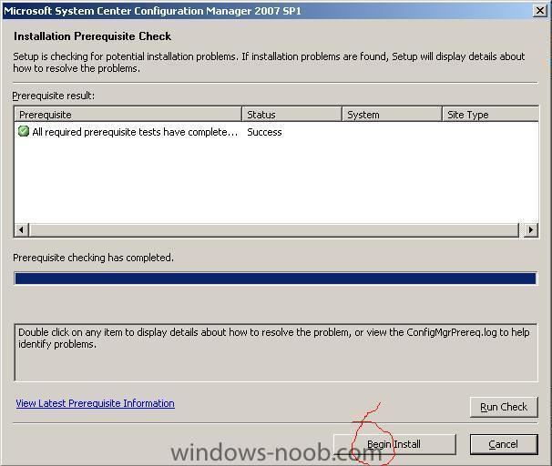

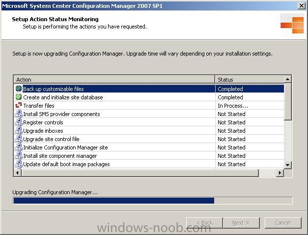

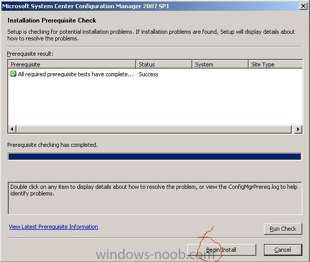

clicking next will run the pre-requisite checker again ! but now you'll see a new button, Begin Install

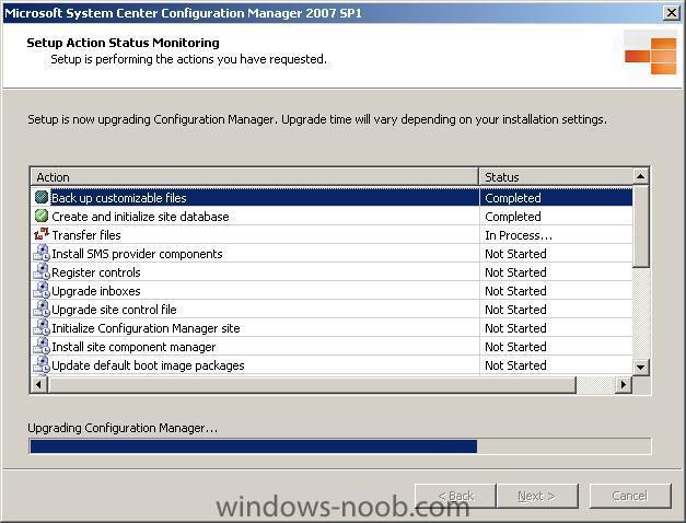

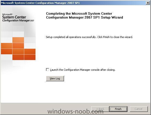

Clicking that will start the actual process (how long winded can it all get ?) and this process can take some time (no kidding...) so go make a cup of coffee... or 10

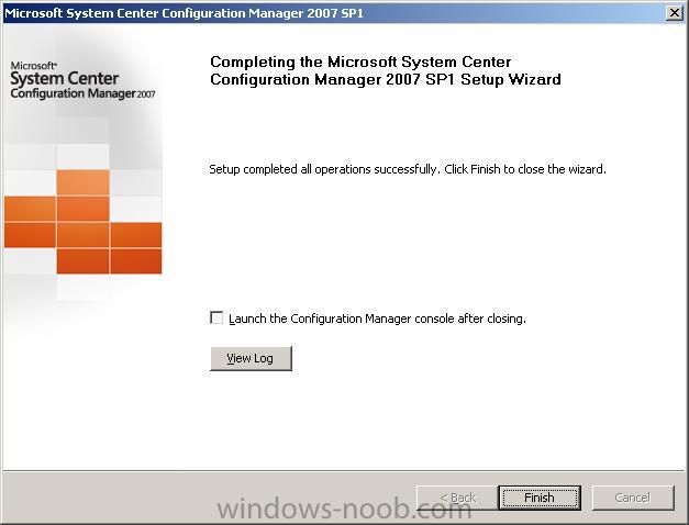

after what seems like an eternity the process will finish and you have to click next...
