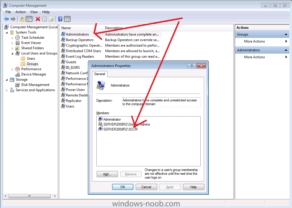

Next verify that you added the ConfigMgr site server computer account to the Local Administrators group on the windows 7 box. The screenshot below is from the Windows 7 computer. Once you've added the account to the Local Administrators group,
Note: You must reboot the Windows 7 box before installing the DP role otherwise IIS may not get installed automatically.

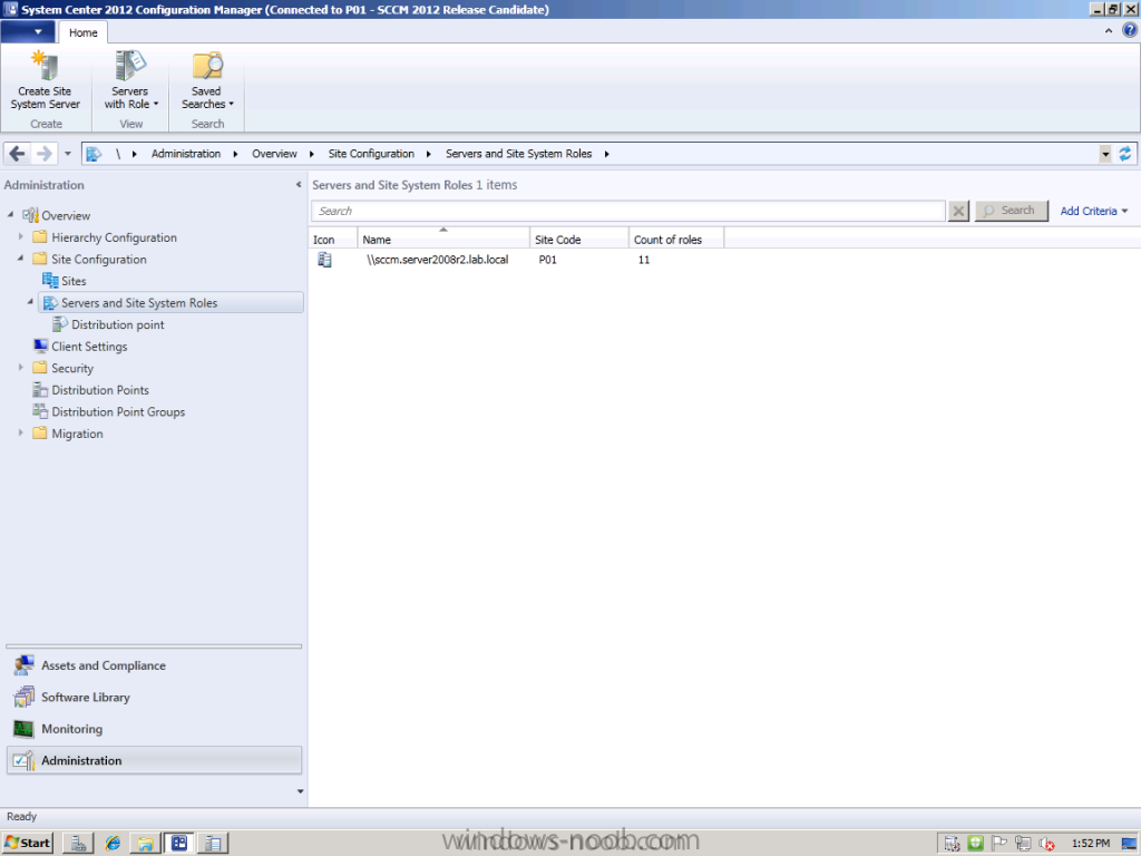

To start the installation of the Distribution Point role on the Windows 7 box, select Servers and Site System Roles from Site Configuration in the in the Administration part of the ConfigMgr Console.

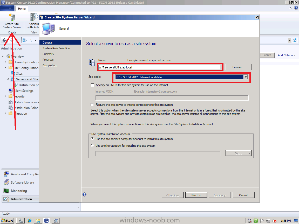

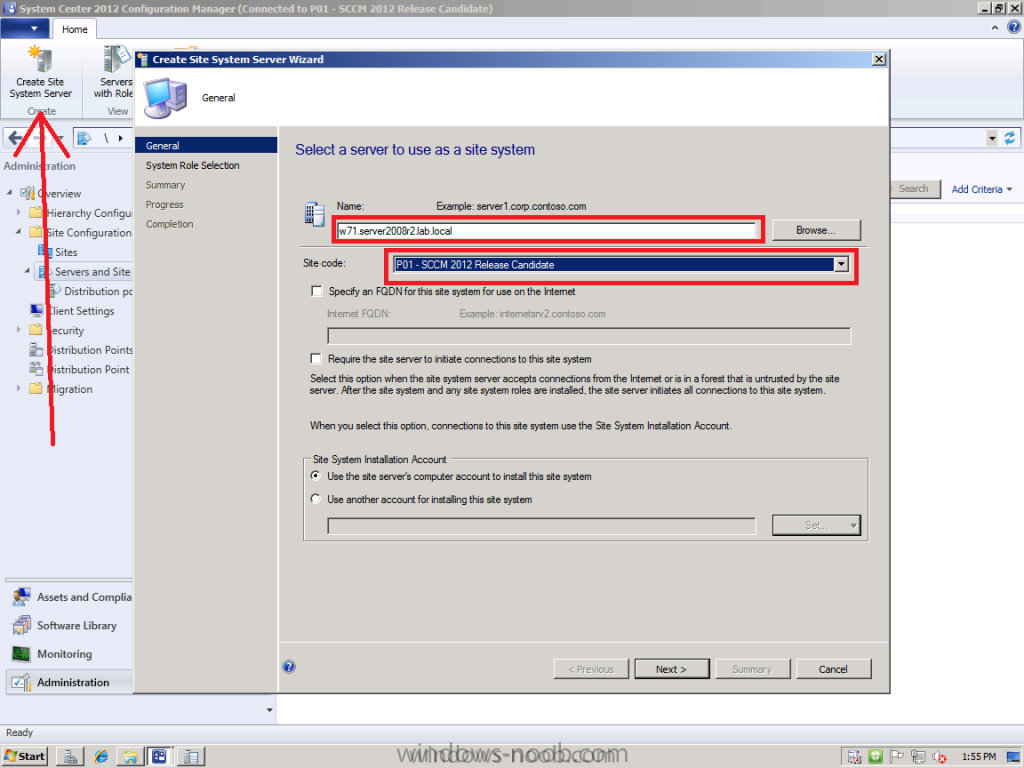

In the Ribbon, click on Create Site System Server, when the wizard appears, type in the FQDN of your Windows 7 computer and select your site code that it will be connected to from the drop down menu.

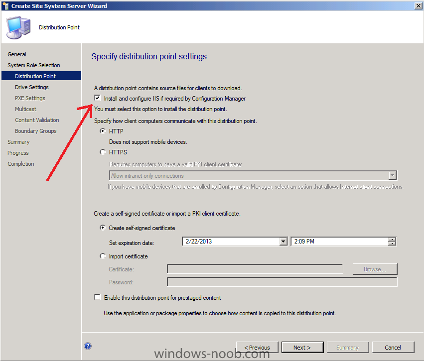

specify if you want IIS installed automatically or not (Install and configure IIS if required by Configuration Manager)

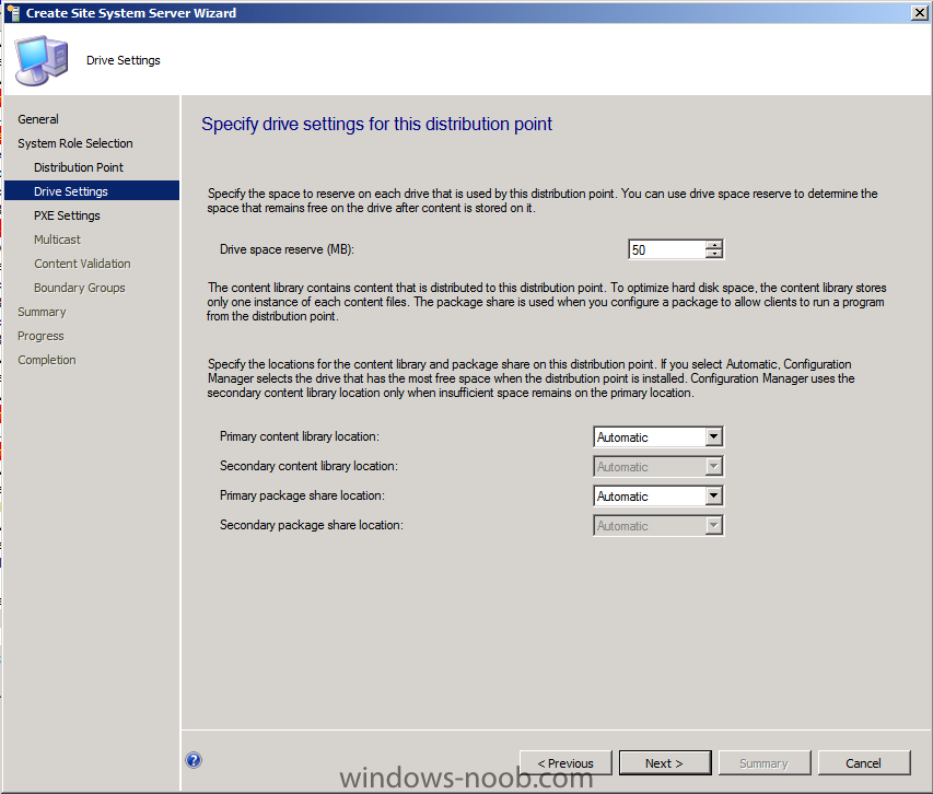

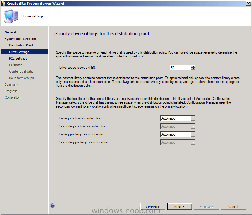

specify drive settings...

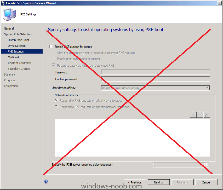

Do NOT enable PXE support (as this is a Windows 7 box and Windows Deployment Services is not available on Windows 7), just click Next

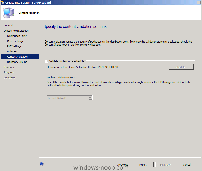

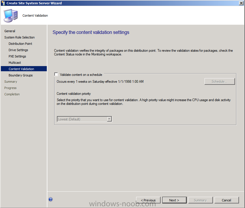

If you want to validate content on a schedule select the box, otherwise click next

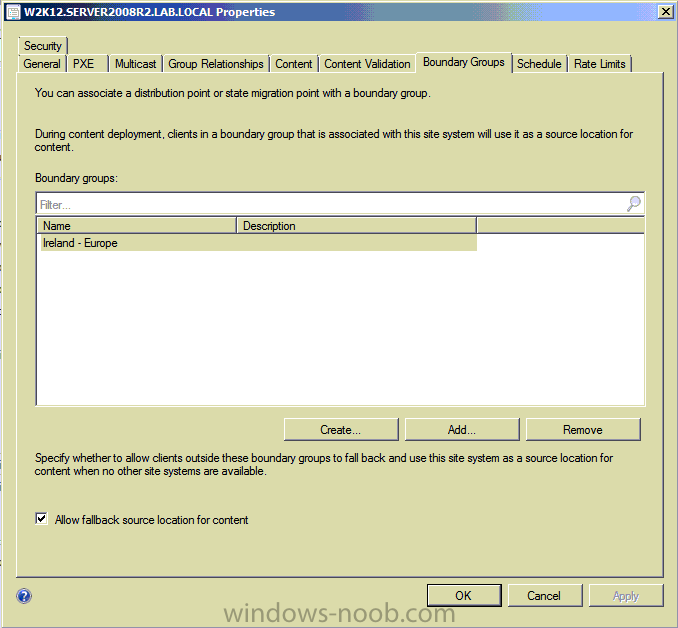

click next, then for Specify the Boundary Groups to associate with this Site System, click Add and select your boundary from those listed

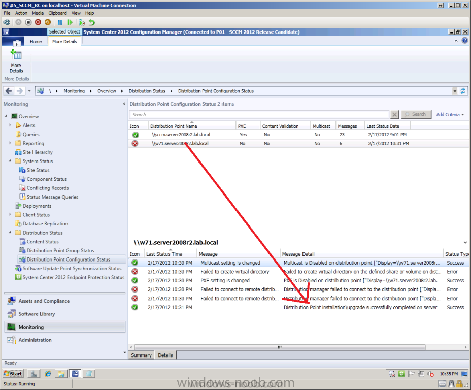

to see how your distribution point installation is progressing, you can monitor it in the ConfigMgr console, check the Distribution Point Configuration Status in Monitoring. Click on the machine name, then select the Details tab underneath, what does it say for your Windows 7 machine, you can even click on More Details in the ribbon to see if it provides more details about your issue.

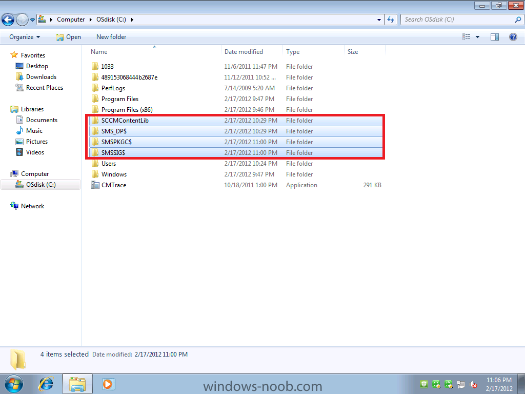

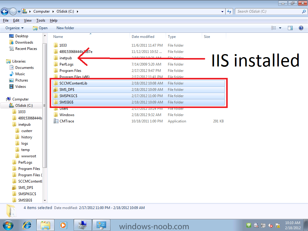

once it's done installing the Distribution Point role you'll see it reports it successfully and creates the needed folder structure on your windows 7 box.
if you forgot to install IIS then install it on your Windows 7 box (you don't need to reinstall the distribution point role)
once again, monitor the status of your dp again, it should refresh to all Green (ok) and finally, it's all done and working and content is being copied to your new distribution point.
