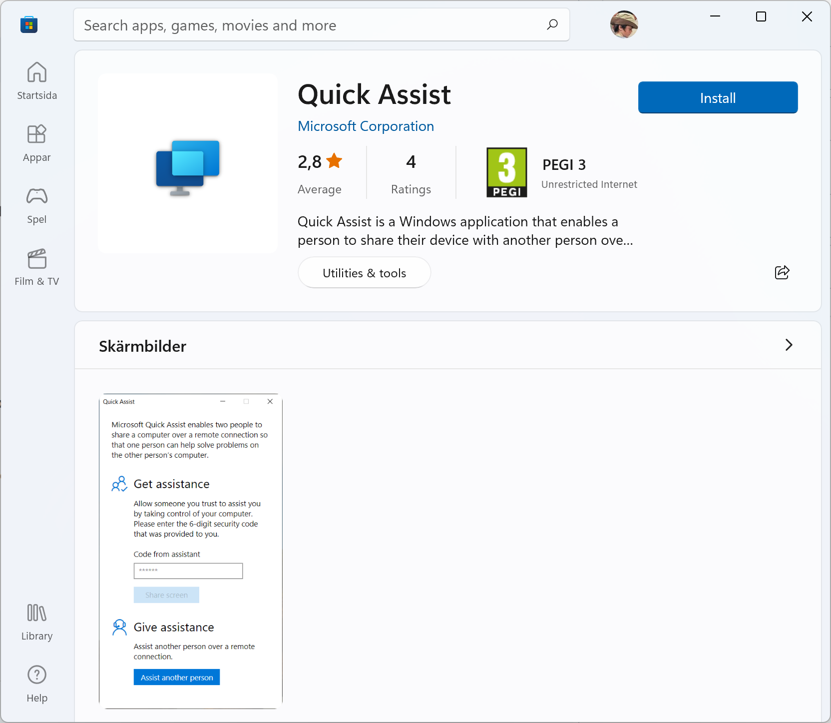

	If you (like me) have used Quick Assist in the past you might be disappointed to know that the built in Windows 10/11 app is going to be killed off in the coming days and replaced with Quick Assist from the Microsoft Store.
</p>
<p>
	<a class="ipsAttachLink ipsAttachLink_image" data-fileext="png" data-fileid="23089" href="https://www.windows-noob.com/forums/uploads/monthly_2022_05/image.png.bf2bd7becb5de531d639693e8d6ce2cf.png" rel=""><img alt="image.png" class="ipsImage ipsImage_thumbnailed" data-fileid="23089" data-ratio="86.91" data-unique="7zydzp4ou" width="863" src="https://www.windows-noob.com/forums/uploads/monthly_2022_05/image.thumb.png.9787b40f18e066c6ff1f06c74e066fb5.png"></a>
</p>
<p>
</p>
<p>

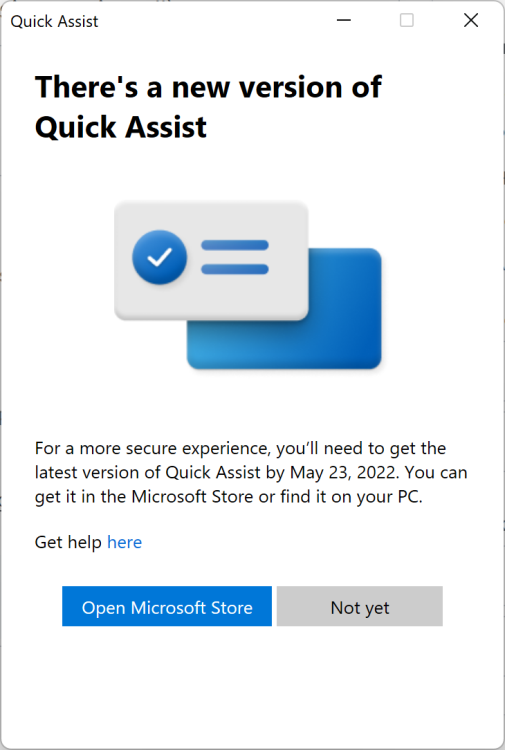

	If you start the Quick Assist app today you'll see something like this (taken from my Windows 11 computer).
</p>
<p>
	<a class="ipsAttachLink ipsAttachLink_image" data-fileext="png" data-fileid="23088" href="https://www.windows-noob.com/forums/uploads/monthly_2022_05/image.png.3a758808341daccabe9ead2ff6840724.png" rel=""><img alt="image.png" class="ipsImage ipsImage_thumbnailed" data-fileid="23088" data-ratio="148.51" data-unique="j6cuq42c0" width="505" src="https://www.windows-noob.com/forums/uploads/monthly_2022_05/image.thumb.png.7973546bd7dd29e4f4e19abf8ba048da.png"></a>
</p>

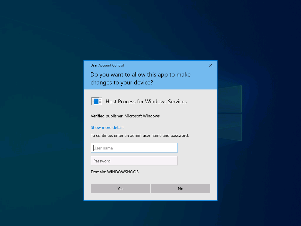

<ul><li>
		If you were supporting users in Windows Autopilot using <strong>CTRL+Windows key + Q</strong>, then that built in ability will be gone.
	</li>
	<li>
		If your users are <strong>Standard Users </strong>(and they should be) then they won't be able to install the app from the Store as it requires local admin permissions. Below screenshot is from a Windows 10 vm running as a standard user.
	</li>
</ul><p>
	<a class="ipsAttachLink ipsAttachLink_image" data-fileext="png" data-fileid="23091" href="https://www.windows-noob.com/forums/uploads/monthly_2022_05/image.png.4c09fb10e946fa95d2619154c6158063.png" rel=""><img alt="image.png" class="ipsImage ipsImage_thumbnailed" data-fileid="23091" data-ratio="75.00" data-unique="douo0uttt" width="1000" src="https://www.windows-noob.com/forums/uploads/monthly_2022_05/image.thumb.png.77d9f20495fd6bff7f1fa5f66fab6642.png"></a>
</p>
<ul><li>
		If the computer you are supporting has Store app issues (and that's a common problem, for example store apps not working after a Cumulative update was installed and waiting on a reboot).
	</li>
	<li>
		The new app uses characters as well as numbers, and that might confuse some people
	</li>
</ul><p>
</p>
<p>
	<a class="ipsAttachLink ipsAttachLink_image" data-fileext="png" data-fileid="23090" href="https://www.windows-noob.com/forums/uploads/monthly_2022_05/image.png.77bd81caf9251a2ab1527bb3345357bb.png" rel=""><img alt="image.png" class="ipsImage ipsImage_thumbnailed" data-fileid="23090" data-ratio="158.56" data-unique="xwxb50cku" width="473" src="https://www.windows-noob.com/forums/uploads/monthly_2022_05/image.thumb.png.b0e497b968b14cd4ad4797476ec0d2b7.png"></a>
</p>
<p>
	Ironically, the new Store apps provided instructions say nothing about the fact that the user has to download the Store app to get support.
</p>

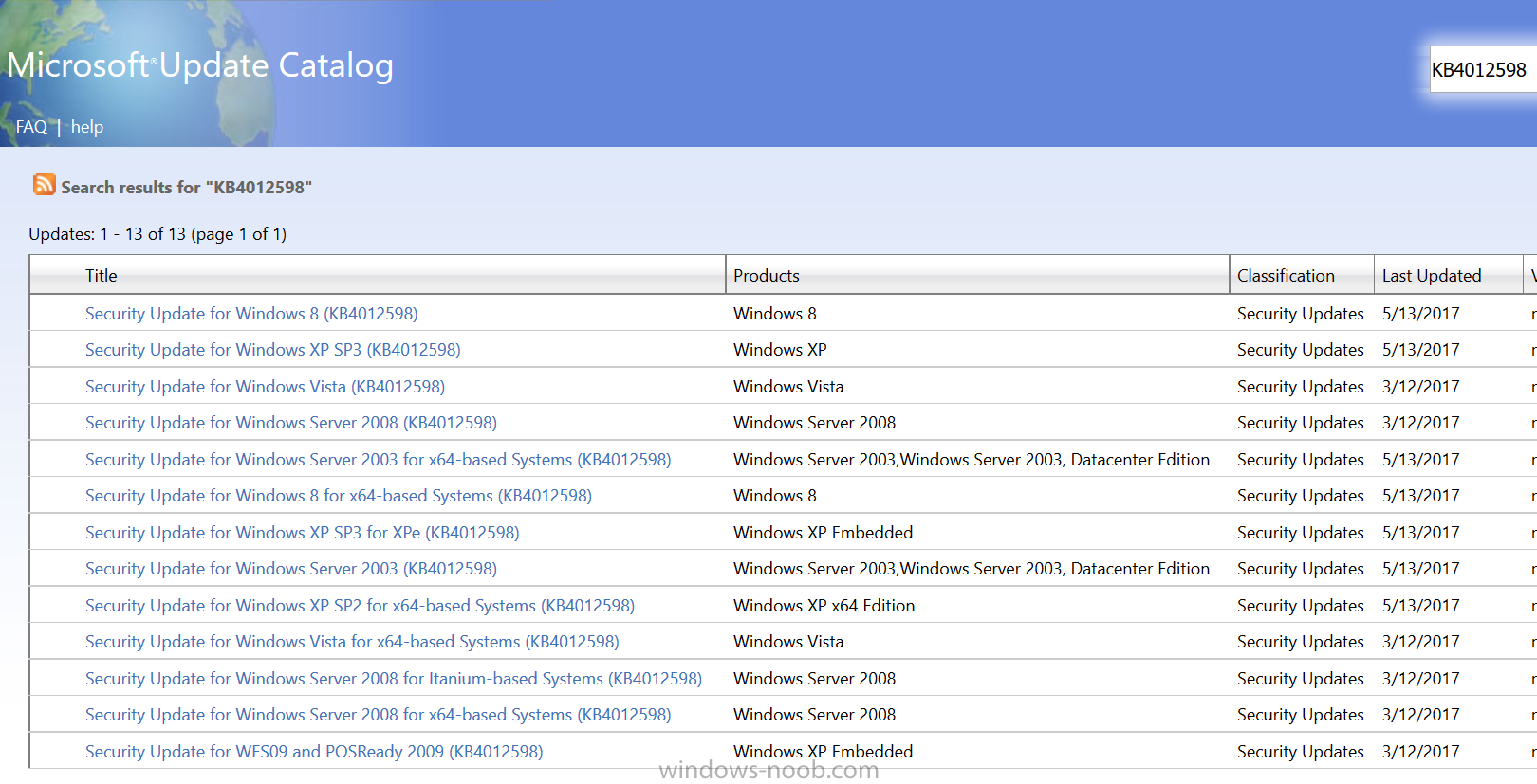

	WannaCry was a disaster that could have been prevented if people took notice. If you didn’t hear about it you must have been asleep, here is a <a href="https://en.wikipedia.org/wiki/WannaCry_ransomware_attack" rel="external nofollow">refresher</a>.
</p>
<p style="text-align: center;">
	<a href="https://www.niallbrady.com/wp-content/uploads/2019/05/Wana_Decrypt0r_screenshot.png" rel="external"><img alt="Wana_Decrypt0r_screenshot.png" class="aligncenter size-full wp-image-5084" data-ratio="75.50" height="453" sizes="(max-width: 600px) 100vw, 600px" srcset="https://www.niallbrady.com/wp-content/uploads/2019/05/Wana_Decrypt0r_screenshot.png, https://www.niallbrady.com/wp-content/uploads/2019/05/Wana_Decrypt0r_screenshot-300x227.png" width="600" src="https://www.niallbrady.com/wp-content/uploads/2019/05/Wana_Decrypt0r_screenshot.png"></a>
</p>
<p>
</p>
<p>
	After WannaCry, most businesses took notice and updated their operating systems, patched them and took measures to avoid a further outbreak. But today, May 14th, 2019, Microsoft has released information that warns of yet another WannaCry-like worm.
</p>
<p>
	<span style="color:#e74c3c;"><strong>Note</strong>: If you are using Windows 10, you are OK, you are not vulnerable to this CVE. If not, and if you are still on Windows 7 then start upgrading to Windows 10 by using the Inplace Upgrade Task Sequence I explain about </span><a href="https://www.niallbrady.com/2019/01/06/forcefully-upgrading-windows-7-or-windows-10-to-a-newer-version-of-windows-10/" rel="external"><span style="color:#e74c3c;">here</span></a><span style="color:#e74c3c;"> or if you cannot upgrade immediately, then patch Windows 7 to protect it from this vulnerability.</span>
</p>
<blockquote>
	<p>
		<em>Vulnerable in-support systems include Windows 7, Windows Server 2008 R2, and Windows Server 2008. Downloads for in-support versions of Windows can be found in the <a href="https://portal.msrc.microsoft.com/en-US/security-guidance/advisory/CVE-2019-0708" rel="external nofollow">Microsoft Security Update Guide</a>. Customers who use an in-support version of Windows and have automatic updates enabled are automatically protected.</em>
	</p>
	<p>
		<em>Out-of-support systems include Windows 2003 and Windows XP. If you are on an out-of-support version, the best way to address this vulnerability is to upgrade to the latest version of Windows. Even so, we are making fixes available for these out-of-support versions of Windows in <a href="https://support.microsoft.com/help/4500705" rel="external nofollow">KB4500705</a>.</em>
	</p>
</blockquote>
<p>
	If however you are running Windows XP, yes…. that old unsupported operating system then take warning !
</p>
<p>
	Today, Microsoft has warned against the wormable capabilities from this CVE (critical Remote Code Execution vulnerability) and they blogged about what to do to avoid it happening to you.
</p>
	<a href="https://www.niallbrady.com/wp-content/uploads/2019/05/Virus_Blaster.jpg" rel="external"><img alt="Virus_Blaster.jpg" class="aligncenter size-full wp-image-5083" data-ratio="59.76" height="251" sizes="(max-width: 420px) 100vw, 420px" srcset="https://www.niallbrady.com/wp-content/uploads/2019/05/Virus_Blaster.jpg, https://www.niallbrady.com/wp-content/uploads/2019/05/Virus_Blaster-300x179.jpg" width="420" src="https://www.niallbrady.com/wp-content/uploads/2019/05/Virus_Blaster.jpg"></a>
</p>
<p>
	Read that blog post here: <a href="https://blogs.technet.microsoft.com/msrc/2019/05/14/prevent-a-worm-by-updating-remote-desktop-services-cve-2019-0708/" ipsnoembed="true" rel="external nofollow">https://blogs.technet.microsoft.com/msrc/2019/05/14/prevent-a-worm-by-updating-remote-desktop-services-cve-2019-0708/</a>
</p>
<p>
	It’s very clear from their text that this is all about protecting customers from the next worm, <strong>so pay attention</strong> and if you have old operating systems that are in support and affected, then update immediately.
</p>
<p>
	<span style="color: #ff0000;">Note: This is so serious that even <strong>Windows XP</strong> and <strong>Windows Server 2003</strong> are getting updates from Microsoft for this vulnerability. You can download those updates from Microsoft Catalog here.</span>
</p>
<p>
	<a href="https://support.microsoft.com/en-ca/help/4500705/customer-guidance-for-cve-2019-0708" ipsnoembed="true" rel="external nofollow">https://support.microsoft.com/en-ca/help/4500705/customer-guidance-for-cve-2019-0708</a>
</p>]]></description><guid isPermaLink="false">16699</guid><pubDate>Wed, 15 May 2019 08:26:53 +0000</pubDate></item><item><title>Windows 10 Enterprise, version 1809 (updated Sept &#x2019;18) is released, and Windows Server 2019 is Generally Available !</title><link>https://www.windows-noob.com/forums/topic/16395-windows-10-enterprise-version-1809-updated-sept-%E2%80%9918-is-released-and-windows-server-2019-is-generally-available/</link><description><![CDATA[<div class="entry-content">

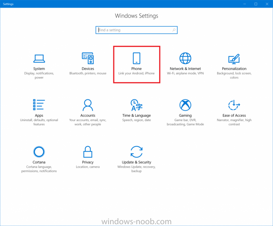

<h1>
	<span style="font-size:36px;">What’s New in Build 16251 For PC</span>
</h1>
<h2>
	<span style="font-size:16px;">Windows lets you link your phone and PC</span>
</h2>
<p>
	You may remember at Build Microsoft talked about PCs and phones working better together. With Build 16251, they are introducing the first set of features that enable “linking” your phone to your PC. This build’s scenario is focused on cross-device web-browsing. Today, we’re asking for you Windows Insiders to help us test this experience out using your Android phones.  Support for iPhone is coming very soon, stay tuned.
</p>
<p class="x-hidden-focus">

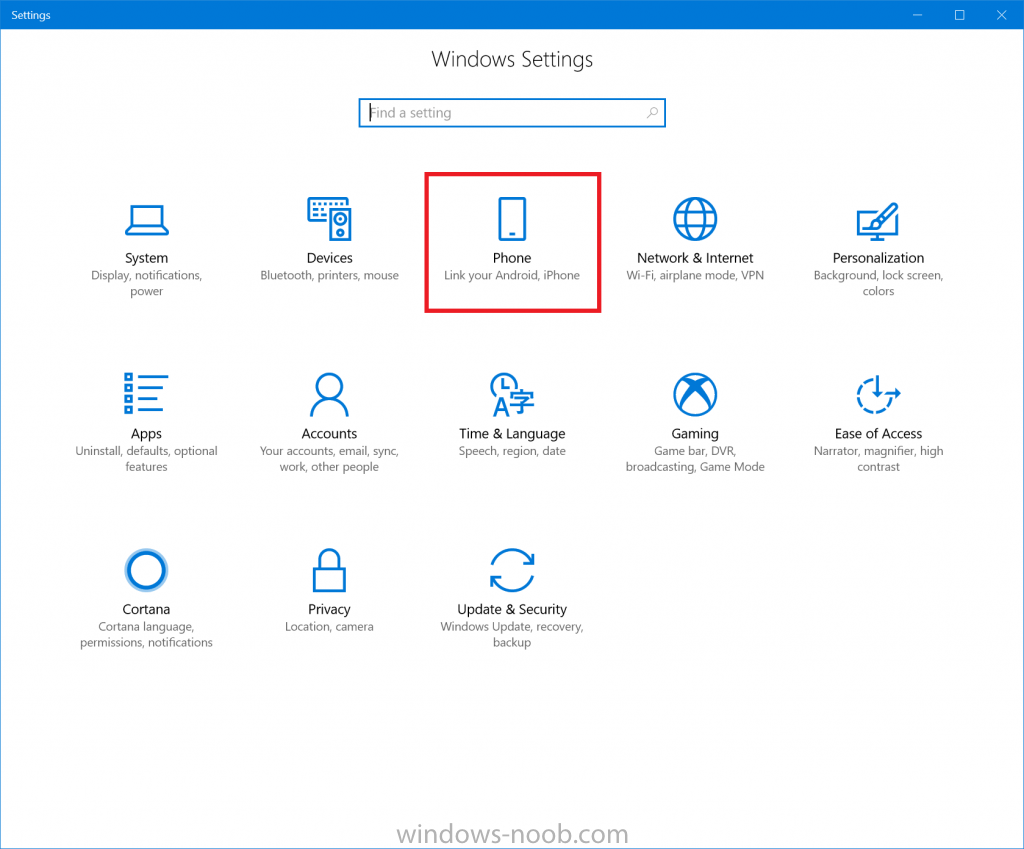

	To get started, after installing today’s new build on your PC, go to <strong>Settings &gt; Phone </strong>and link your phone. Having you link your phone ensures that your sessions from your phone are continued only on to the PC that you’ve chosen. After adding your phone to be linked, you will receive an SMS from us directing you to install a test application called “Microsoft Apps” for Android that completes the link between your phone and PC and enables one of our first cross device browsing scenarios.
</p>
	<a class="ipsAttachLink ipsAttachLink_image" href="https://www.windows-noob.com/forums/uploads/monthly_2017_07/500b997f020621d701ce478b327f1bbd-1024x849.png.a492c270f5be78dcd17cb0bf7ea67195.png" data-fileid="18687" rel=""><img class="ipsImage ipsImage_thumbnailed" data-fileid="18687" data-unique="xz9twscex" src="https://www.windows-noob.com/forums/uploads/monthly_2017_07/500b997f020621d701ce478b327f1bbd-1024x849.thumb.png.68116e62a635513b28c6914c638726cc.png" style="" alt="500b997f020621d701ce478b327f1bbd-1024x849.png"></a>
</p>
	After you’ve linked your phone, just go to your phone and start browsing the web. When you are at a website you want to view on your PC, simply invoke the native share experience on your phone and share the website to the “Continue on PC” option. You might need to click the “…” or more to add this test app to your share menu.
</p>

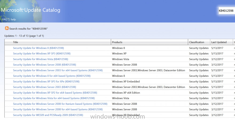

	To patch your unsupported operating systems, get over to <a href="http://www.catalog.update.microsoft.com/Search.aspx?q=KB4012598" rel="external nofollow">this url</a> and download the available patches.
</p>
<p>
	<a class="ipsAttachLink ipsAttachLink_image" data-fileid="18431" href="https://www.windows-noob.com/forums/uploads/monthly_2017_05/patches.png.f8923fb9ef0c0d890526c5d4232f267c.png" rel=""><img alt="patches.png" class="ipsImage ipsImage_thumbnailed" data-fileid="18431" data-unique="488w6z4av" src="https://www.windows-noob.com/forums/uploads/monthly_2017_05/patches.thumb.png.da343429b15db1711cddf1f41665f72c.png" style=""></a>
</p>
<p>
	WannaCry has multiple vectors, but you should remove one vector, SMBv1. Do as follows
</p>
<p>
	1. Block 445 inbound
</p>
<p>
	2. Install <a href="https://technet.microsoft.com/en-us/library/security/ms17-010.aspx?f=255&amp;MSPPError=-2147217396" rel="external nofollow">MS17-010</a>
</p>
<p>
	3. Remove SMB1
</p>
]]></description><guid isPermaLink="false">15353</guid><pubDate>Sat, 13 May 2017 14:14:51 +0000</pubDate></item><item><title>Announcing the Windows ADK 10 Insider Preview Build 15021</title><link>https://www.windows-noob.com/forums/topic/15182-announcing-the-windows-adk-10-insider-preview-build-15021/</link><description><![CDATA[
