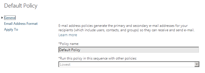

In EAC: By default after the installation we only have one policy, called Default Policy.
I want to edit this one, by selecting the “Default Policy” and pressing the “pen” icon.
The Default Policy is showing up, in the left menu, press “Email Address Format”.

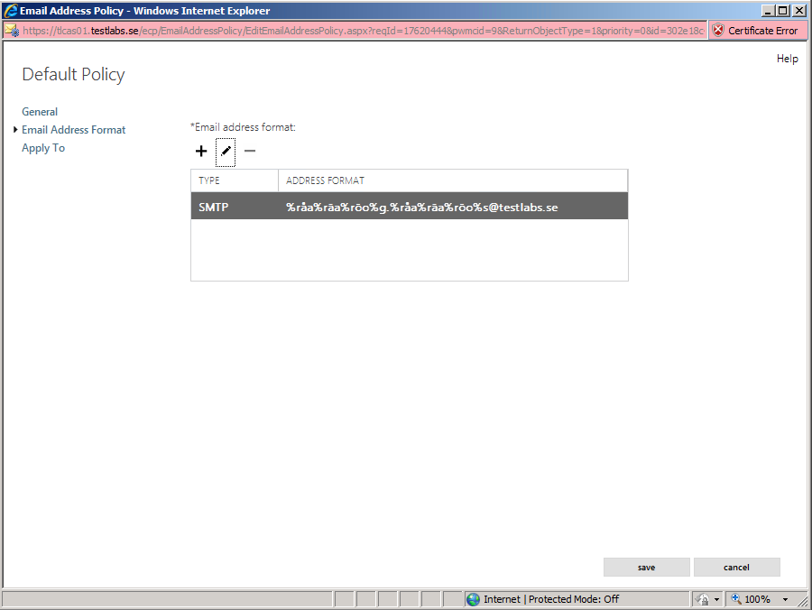

Since I live in Sweden and we have some special characters that I want to get rid of, I’m using the custom policy, Address type: SMTP and the Email address parameters:
%råa%räa%röo%g.%råa%räa%röo%s@testlabs.se
%r means it replaces the character after, in this case åäö. Which it replaces with aao.
When you have done the change press the “Save” button at the bottom of the page.
Check so that the change is correct, then press the “Save” button.

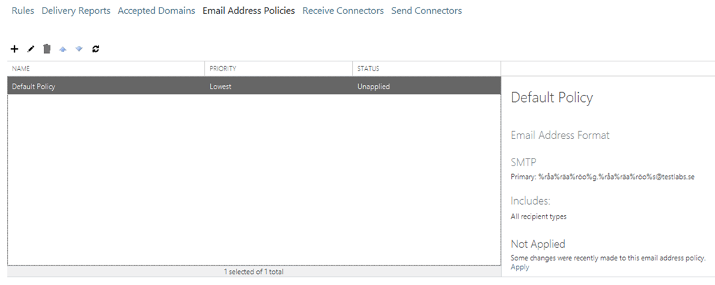

After the changes have been saved, it needs to be applied. This is done by pressing the “Apply” text/button down in the right menu.

It can easily be checked if the policy has been applied, it will show a True or False value. For checking the value run the command below:
Get-EmailAddressPolicy | fl *appl*
Note: Don’t forget to update the Policy, or else the new addresses won’t be pushed out to the recipients.
