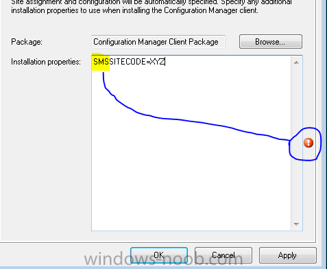

Would you guys know the resolution of an issue with SiteCode XYZ that is created by "Type: Stand-Alone Media" reporting back (in my case SITECODE=in the US) and not to the proper Region Sitecode?
Infrastructure: CAS w/6 Primaries
- I have read that the Stand Alone Media would need to be created in the Region primary to report to correct sitecode?
- In the Task Sequence I try to add in the "Installation Properties" The site code I want to use, but does not like "SMS" in the there and if take SMS and just have "SITECODE" the error goes away but it doesn't resolve the overall issue. (Pictured)
This is driving me crazy because Regions for example Canada or Europe is reporting back to the US management point.
Thanks,
Hey, it's my understanding that you can not specify 'SMSsiteCode' in the installation properties. It automatically detects that based on the site location you created the media. So if you have 1 CAS and 6 primaries: PS1, PS2, PS3, etc, and you wanted the site media to contain PS1 site code, you need to create the media from that specific site. Same goes for PS2, PS3, etc.
From the SCCM Console, you would essentially connect to PS1 Site Server, create your standalone media and you should be good to go.
Does this make sense?
