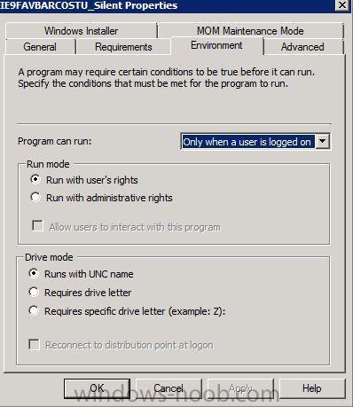

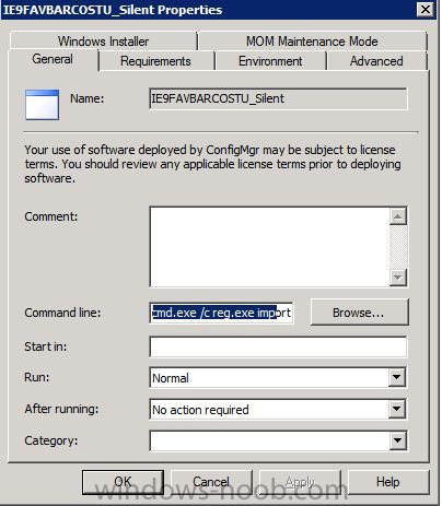

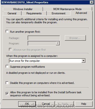

post-22178-0-20320200-1399293519_thumb.jpgpost-22178-0-67948000-1399293529_thumb.jpgpost-22178-0-25236000-1399293535_thumb.jpg

the solution does not work for me. I am doing something wrong, so here is how I do it:
1. Go to my test virtual machine and run your first command: cmd.exe /c reg.exe load HKEY_LOCAL_MACHINE\defuser c:\users\default\ntuser.dat
2. I run your second command: cmd.exe /c reg.exe import "ie9.reg" and ie9.reg file looks like this:
Windows Registry Editor Version 5.00
[HKEY_LOCAL_MACHINE\Defuser\Software\Microsoft\Internet Explorer\MINIE]
"TabBandWidth"=dword:000001a8
"LinksBandEnabled"=dword:00000001
"AlwaysShowMenus"=dword:00000001
As you can see I have manually changed the hkcu with hklm key like you told our other college to do. I must admit that I don't understand this line:
"the important thing here is that the registry file refers to the mountpoint referenced in our first step, below is an example of that"
I hope that you are reffering that whatever we are importing that it must contain the hklm key.
3. Then I execute the last command: cmd.exe /c reg.exe unload HKEY_LOCAL_MACHINE\defuser
Under all command I get the "operation completed successfully". I have made a software collection and advertised it but when I get the advertisement nothing happens, I am logged as a user (with admin rights).

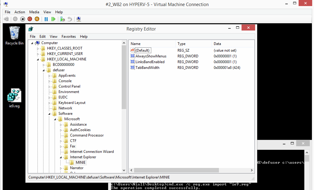

i've just tested your reg key with the defuser path in it, and it works just fine..before i do the final command (reg unload) i verified the defuser path in the registry, see screenshot below, the default user hive is loaded in hklm\defuser...., i applied your reg key to that defuser hive.

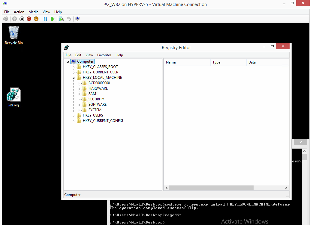

then i closed regedit (as you can't unload when it's open), and then after i unload the registry i open it again to see how things look, notice no defuser path, that is correct,
now, you are probably wondering where the HKCU settings have gone, well they are applied to 'default user' hive (all new users)

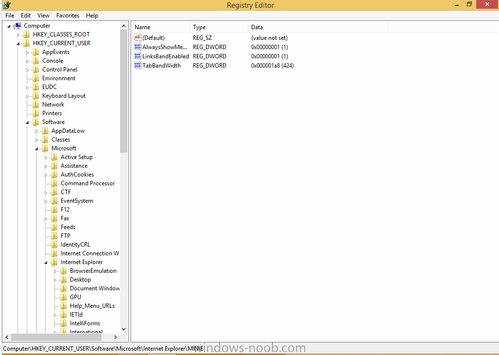

so login to this computer as a new user and then check the hkcu path for your changes...

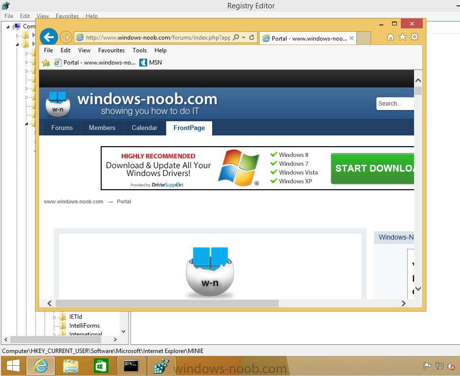

and the setting is indeed in the registry as you see above, starting IE shows the change also.
So your reg key works, the defuser process applies the change for all users (all new user profiles created on a machine) whereas as pure HKCU reg key (with no defuser references) will make the change for the current logged on user only.
