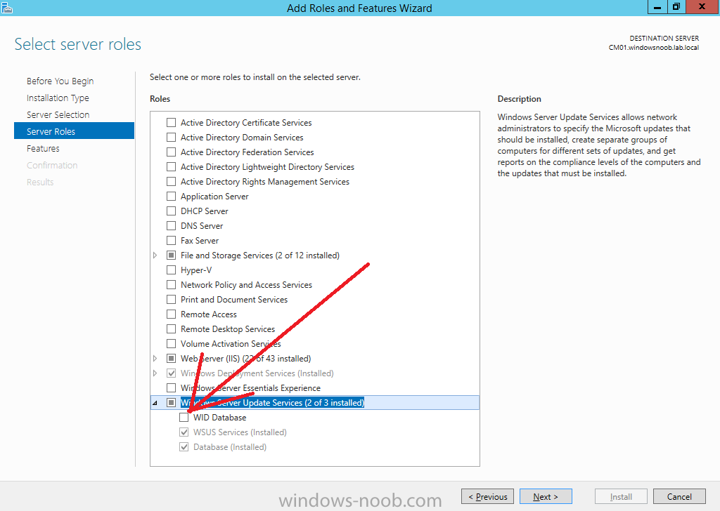

However, after sever trials and tribulations reading and adjusting to my infrastructure constraints, I have discovered that the ‘DeploymentConfigTemplate_WSUS.xml’ needed to be adjusted. I was being plagued with the server needed to be rebooted error when attempting to install WSUS.
So I tried to parse and read the ‘DeploymentConfigTemplate_WSUS.xml’ and since I do not currently know of an editor for these type template files, I had to walk through, recreate and compare.
I discovered that the WID (Windows Internal Database) was causing the issue. Due to the fact we are installing to a full SQL server build, we do not need the WID. For some reason even if you unselect the ‘WID Database’ option in role services, it does not uncheck the Feature installation of WID.
So you have to go back and uncheck the ‘Windows Internal Database’ in the Features list.

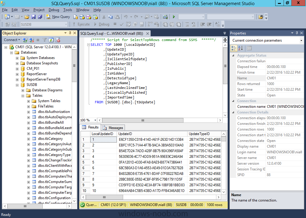

interesting because it's not configured after running the script and I too am using SQL to host the WSUS DB.
and here's the SQL SUSDB which is in use
were you seeing otherwise ? what version of Windows Server 2012 R2 did you run the script on ?
