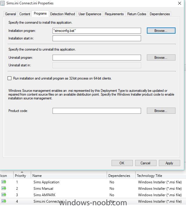

I have created an application which contains multiple installs which all work well however I have added a bat file at the end which copies a couple of INI files to a directory. The bat file seems to work fine but during the install it doesn’t. I may be going about it the wrong way so any advice would be welcome.

Assuming the programs run under system context? User will not have permission to C;\windows. Does \\mysccmserver file share give every machine account permission to the files?
You could just put a copy of connect.ini & sims.ini in the application content source. Then you would just need to change the bat file to (this way the ini files will just be in the working directory) :

I think the issues is access to the C:\WINDOWS folder as i have to run as administrator in order to work. During a TS i can just create a package and use xcopy which works but im trying to build it into the application
Is there a specific reason not to put the files into your package sources?
No there's not, i can do that, how would i reference that in the bat file though?
if not exist "C:\Program Files\SIMS\SIMS.Net\connect.ini" copy /y "\\%~dp\Sims Connect ini" "C:\Program Files\SIMS\SIMS.Net"
