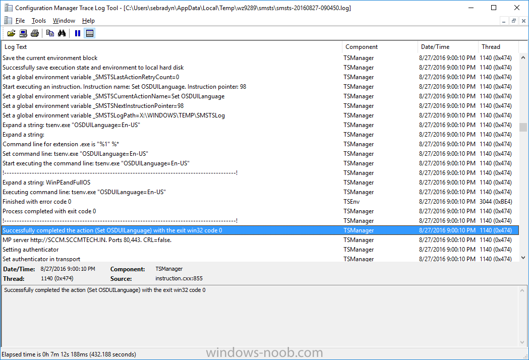

Hi... I followed this guide and had it working fine for a couple of months now (THANK YOU!). However, it has stopped working after we captured a new Win10 1607 WIM. From what I can tell in the logs, the language pack installs fine. The unattend gets updated properly. However, in the Windows setup log file, it tells me that it can't set the language because it is not installed (UILanguage is not installed in the system). So, clearly, it is not installing even though it is reporting successful. How do I go about troubleshooting the "install language pack offline" step? FYI, this is happening with all of the language packs... not just the es-MX from the screenshots below.
smsts.log showing the command completed successfully:
Unattend before restart for windows setup:
setupact.log from UnattendGC showing the failure to set the language:
