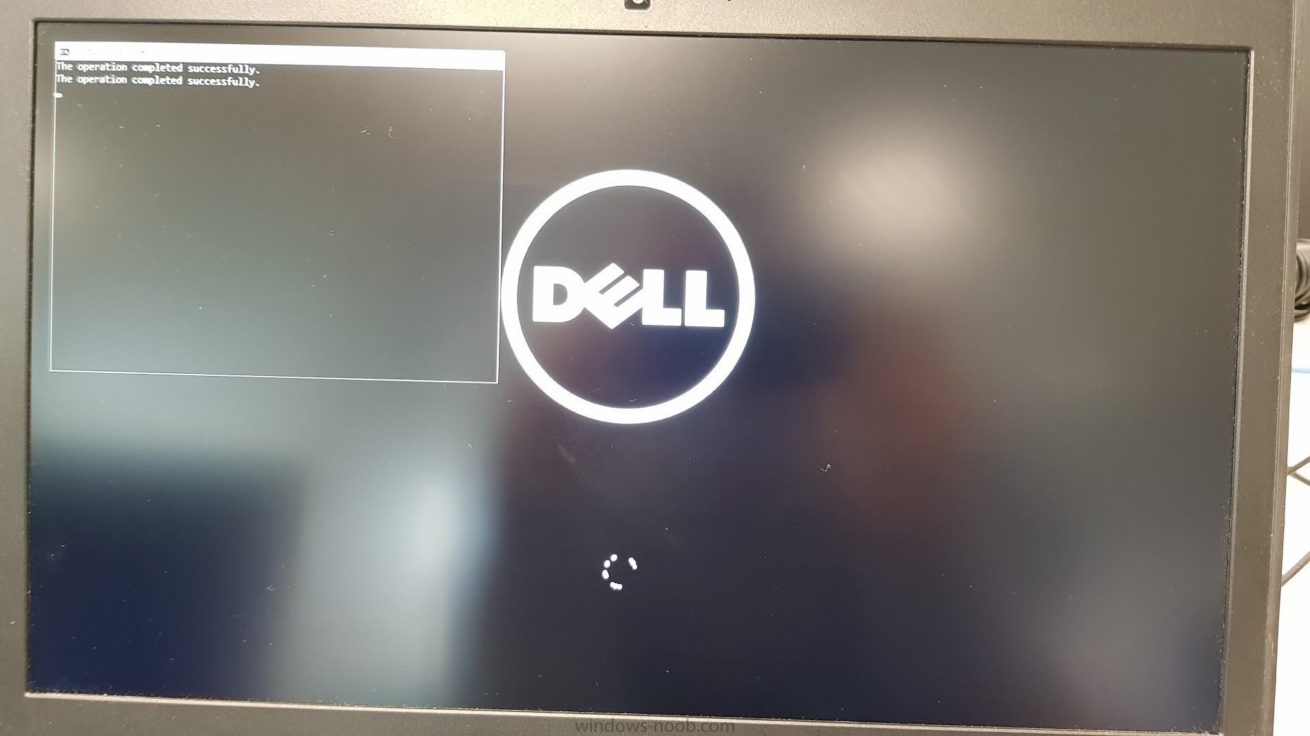

dinci5 7 Posted November 14, 2017 Report post Posted November 14, 2017 I'm starting to hate SCCM. This product has so many bugs it really isn't fun anymore. Now all my upgrades hang at setupcomplete.cmd until it times out. After OS starts the CM client is stuck in Provisioning Mode. The OS is upgraded though and it works fine. But the TS never completes successfully. Only thing I see in smsts is this: Succeeded loading resource DLL 'C:\WINDOWS\CCM\1033\TSRES.DLL' TSManager 11/14/2017 10:28:08 AM 5952 (0x1740) Failed to create an instance of COM progress UI object. Error code 0x80040154 TSManager 11/14/2017 10:28:08 AM 5952 (0x1740) Timed out waiting for ccmexec service to be fully operational TSManager 11/14/2017 10:58:17 AM 5952 (0x1740) 0, HRESULT=80004005 (e:\qfe\nts\sms\framework\tscore\utils.cpp,5348) TSManager 11/14/2017 10:58:17 AM 5952 (0x1740) Failed to wait for Ccmexec service to be fully operational (0x80004005) TSManager 11/14/2017 10:58:17 AM 5952 (0x1740) TS::Utility::WaitForCcmExec(g_hShutdownEvent), HRESULT=80004005 (e:\qfe\nts\sms\client\tasksequence\tsmanager\tsmanager.cpp,1343) TSManager 11/14/2017 10:58:17 AM 5952 (0x1740) Process completed with exit code 0 TSMBootstrap 11/14/2017 10:58:17 AM 5764 (0x1684) Successfully finalized logs to SMS client log directory from C:\WINDOWS\CCM\Logs TSMBootstrap 11/14/2017 10:58:17 AM 5764 (0x1684) Quote Share this post Link to post Share on other sites
