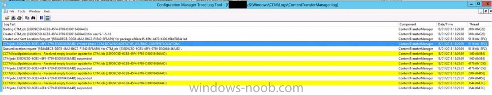

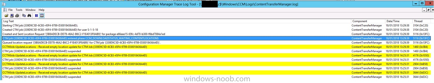

Non-Working Client - ContentTransferManager.log
CTM job {339D9C5D-6CB3-45F4-9789-D30018436A4D} entered phase CCM_DOWNLOADSTATUS_WAITING_CONTENTLOCATIONS
Queued location request '{5B8ADECB-DD78-46A2-B6C2-F1E4013F8AB9}' for CTM job '{339D9C5D-6CB3-45F4-9789-D30018436A4D}'.
CCTMJob::UpdateLocations - Received empty location update for CTM Job {339D9C5D-6CB3-45F4-9789-D30018436A4D}

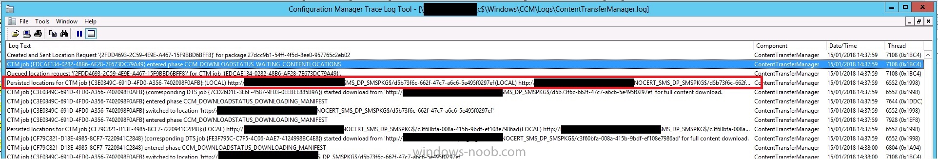

CTM job {EDCAE134-0282-48B6-AF28-7E673DC79A49} entered phase CCM_DOWNLOADSTATUS_WAITING_CONTENTLOCATIONS
Queued location request '{2FDD4693-2C59-4E9E-A467-15F9BBD6BFF8}' for CTM job '{EDCAE134-0282-48B6-AF28-7E673DC79A49}'.
Persisted locations for CTM job {C3E0349C-691D-4FD0-A356-7402098F0AFB}:
              (LOCAL) http://SCCM_SERVER#/SMS_DP_SMSPKG$/d5b73f6c-662f-47c7-a6c6-5e495f0297ef
              (LOCAL) http:// SCCM_SERVER#/NOCERT_SMS_DP_SMSPKG$/d5b73f6c-662f-47c7-a6c6-5e495f0297ef
              (LOCAL) http:// SCCM_SERVER#/SMS_DP_SMSPKG$/d5b73f6c-662f-47c7-a6c6-5e495f0297ef
              (LOCAL) http:// SCCM_SERVER#.SMS_DP_SMSPKG$/d5b73f6c-662f-47c7-a6c6-5e495f0297ef
