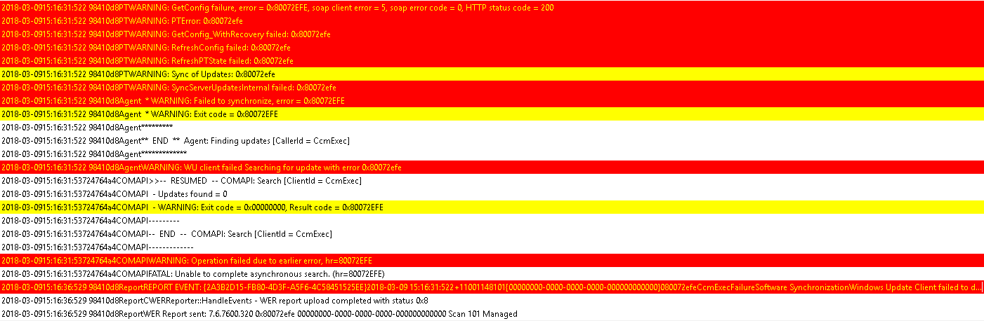

I am stuck in this situation for more than a week. I couldn't find the way to resolve it. Could anyone please have a look and help to give some suggestions if possible?
I have a SCCM 2016 CB environment, one single primary site. I have set up SUP on SCCM site server with WSUS installed, the software update sync is fine, but when I tried to deploy the patches, I keep getting these 2 errors from the client machine. Please help and advise what I have done wrong.
Thank you
Richard
WUAHandler.log error as below
WindowsUpdate.log error as below
0x80072efe means "The connection with the server was terminated abnormally". Is this happening on all clients or specific machines ? can you try to restart windows update services and initate software update scan.
