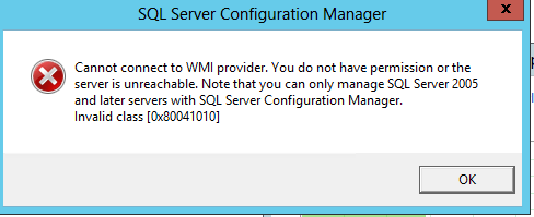

issue got resolved after solving SQL server configuration manager issues.
Open a command prompt as administrator
Navigate to your SQL version’s shared directory (cd <version path>):
SQL 2008:  C:\Program Files (x86)\Microsoft SQL Server\90\Shared\
SQL 2008 R2:  C:\Program Files (x86)\Microsoft SQL Server\100\Shared\
SQL 2012:  C:\Program Files (x86)\Microsoft SQL Server\110\Shared\
SQL 2014:  C:\Program Files (x86)\Microsoft SQL Server\120\Shared\
Then run the following command:
mofcomp sqlmgmproviderxpsp2up.mof

thanks for posting the solution, your SQL server configuration was well messed up though.
did Microsoft CSS explain why they thought your SQL was in such a bad state ?
1802 Upgrade successfully completed.
The funning is I have a rough draft blog post mostly written on how to install the SQL WMI providers. The WMI providers seem to be removed when you applied some of the SQL SU. It wasn't something I thought of when you posted here.
