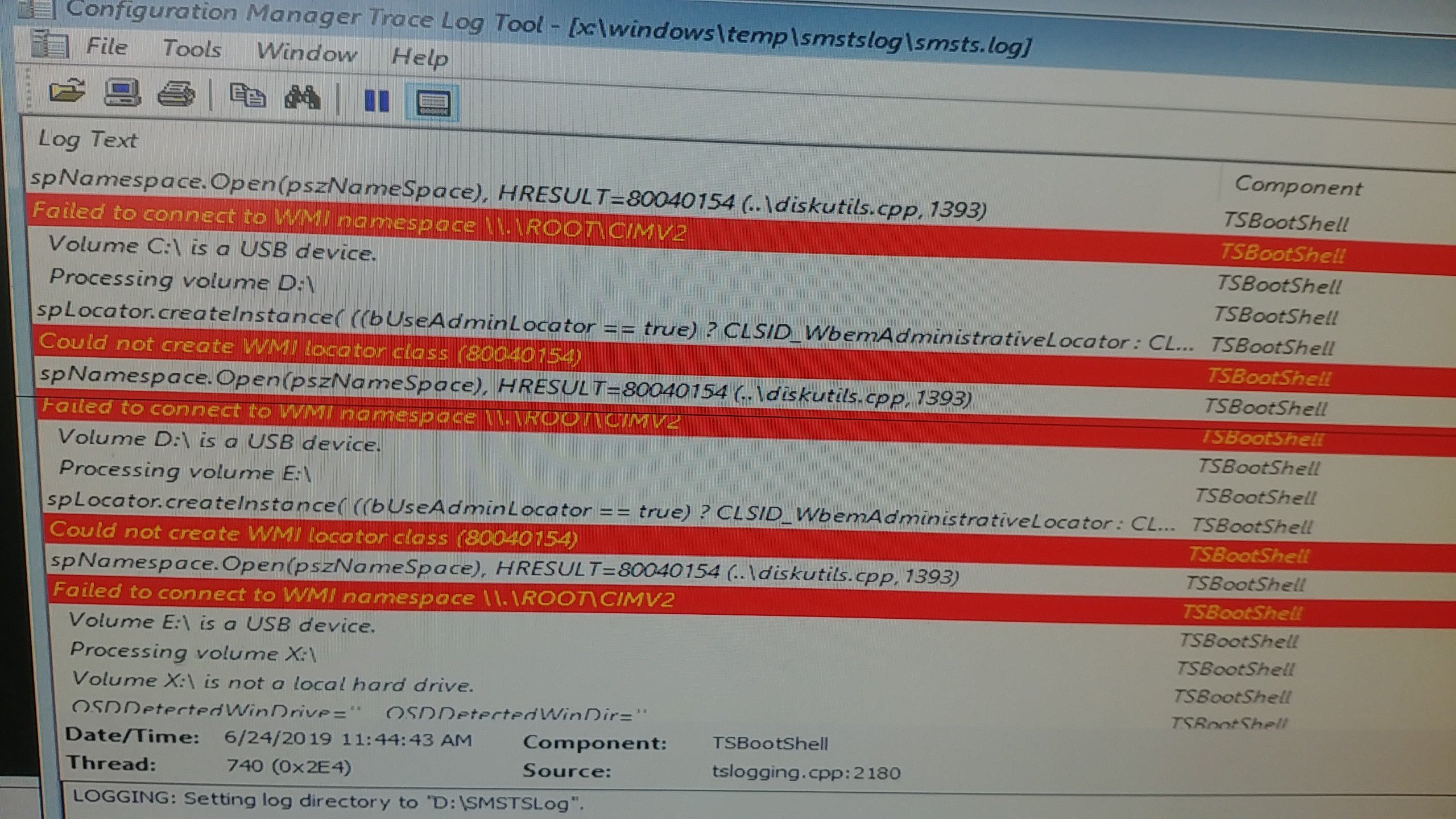

enable diagnostic support in your boot wim, then press f8 at the pxe password screen, in the cmd prompt use cmtrace x:\windows\temp\smstslog\smsts.log
and review the failures in red to see why it's having issues, if you can attach the smsts.log file here that would help or if you cannot, then attach screenshots of the errors highlighted in SMSTS.log
it seems like you have PXE booted and SCCM detects three USB drives and no local drive, is that correct, can you tell me a bit more about how you are testing here ? why are you not trying to test this with virtual machines ?
also, if you are indeed testing on real hardware that is not detecting the hdd, then have you added any storage drivers for the chipset to your boot wim ?

Haven't used a VM since I set everything up over a year ago to be honest as I've always been able to tweak the image slightly every time I've needed to add something to the task sequence.  These are machines that have always worked, so I just went to run the task sequence again.  I can't even deploy the existing task sequences that I've been using since last year.
Other than installing 1902, the latest ADK, PE and running Update Distribution Points on the Boot 64 image I haven't changed a thing.  Ulitmately what I'm trying to do is push out Windows 10 1903.  Up until this update I was installing 1803 without issue.  I'll put a VM together now to test it out though.
try updating your boot wim(s) to the distribution points again, to make sure they get injected with all the new binaries from the SCCM 1902 upgrade.
Once I cleared out all the drivers from Boot Image (x64) it allowed me to boot into SCCM again.  Now I'm back to errors on the task sequence, but at least the devices will image again.  New problem for a new day, but as far as this specific fault goes, it is resolved thank you.
