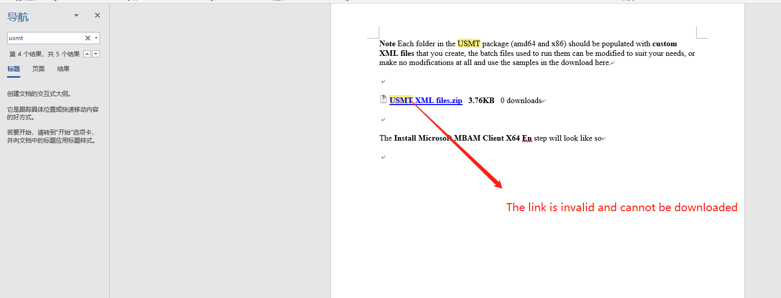

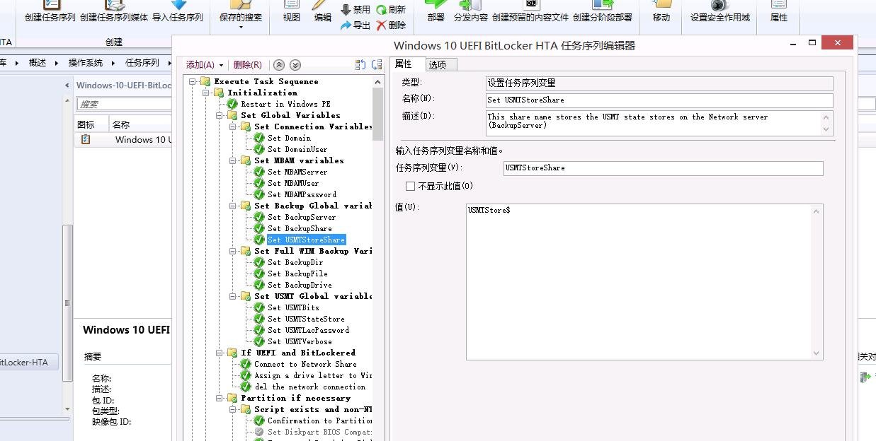

感谢你的帮助, 不过又遇见新问题了,再USMT进行备份时候报错了
Thank you for your help, but have encountered new problems, and then USMT made a backup error.
是否我的utms没有这个配置文件造成的故障,默认usmt的配置文件没办法备份吗
Is my utms not caused by this configuration file, the default usmt configuration file can not be backed up?

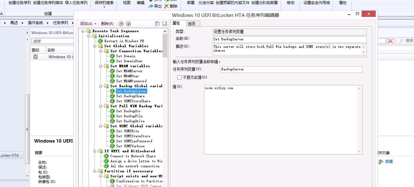

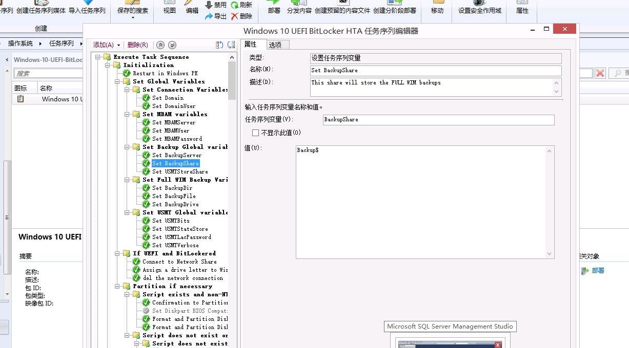

MigLog.xml scanstate.log scanstateprogress.log BDD.log checkcomputername.log Get-Driveletter.log GetComputerName.log GetResourceID.log IsComputerKnown.log IsVolumeEncrypted_ENCPART.log shutdownonerror.log sitecode.log smsts-20190806-120009.log smsts.log zticopylogs.log ZTIGather.log ZTISCCM.log

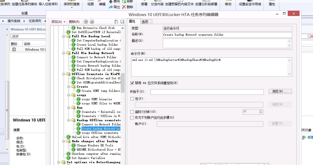

1 hour ago, anyweb said:
s8.thumb.jpg.7b9c5e45e4035f35c48952f4bf4f57b9.jpgs7.thumb.jpg.ec0d2043d535437142f21e22f5b2a663.jpgs6.thumb.jpg.dac505f340158169e6635b4a1b908ddb.jpgs5.thumb.jpg.c63516e4b32bb2417fde6de8b7bb868f.jpgs4.thumb.jpg.eaa9b76e72fe397fcf324ae81530753d.jpgs3.thumb.jpg.39f3f639d26d5fc5289bd70ee5654b79.jpgs2.jpg.ec0ac00339950b484c0cd0092f6c58be.jpgS1.thumb.jpg.ff2b197df6be8c5ab7767381a225cb94.jpg

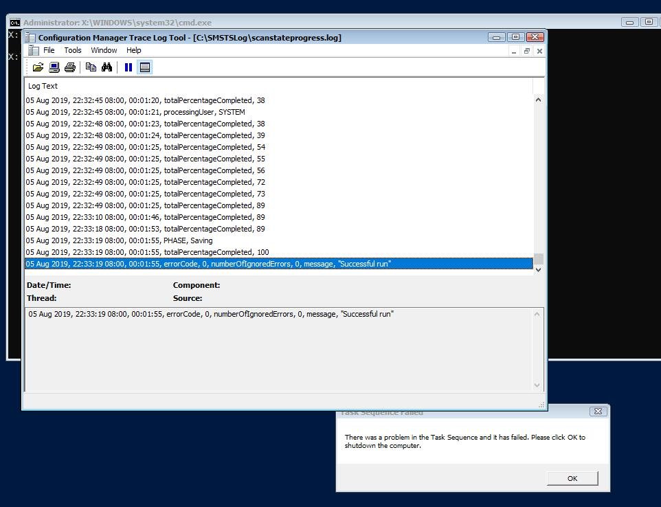

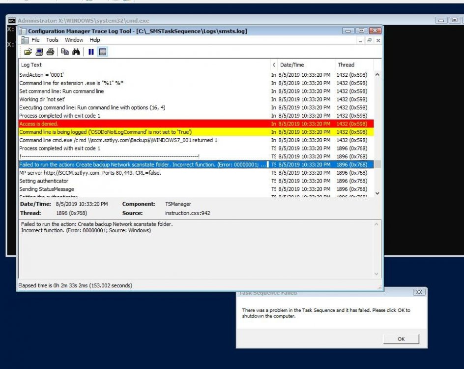

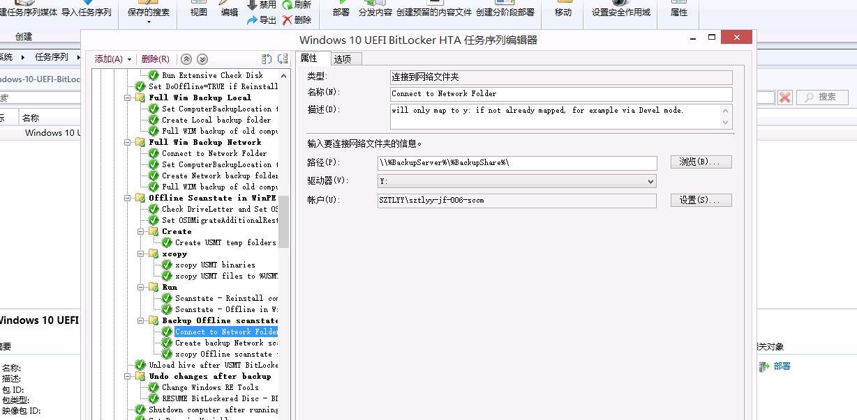

failed to run the action create backup network scanstate folder incorrect function  error 0000001 soruce windows
Seems to be a problem with the network road, can't access?
scanstate.log scanstateprogress.log smsts.log

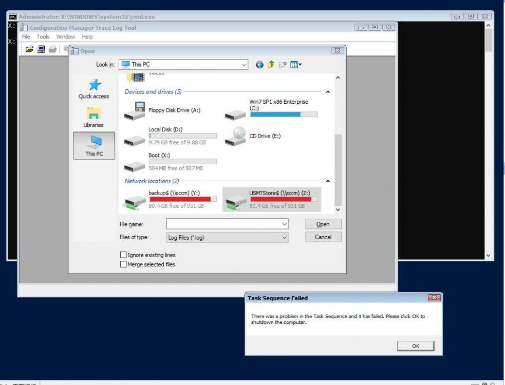

scanstate.log 2.23 MB · 0 downloads scanstateprogress.log 47.82 kB · 0 downloads smsts.log 381.03 kB · 0 downloads

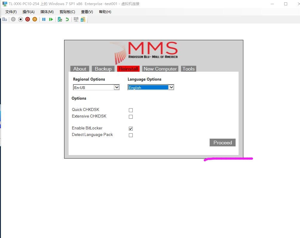

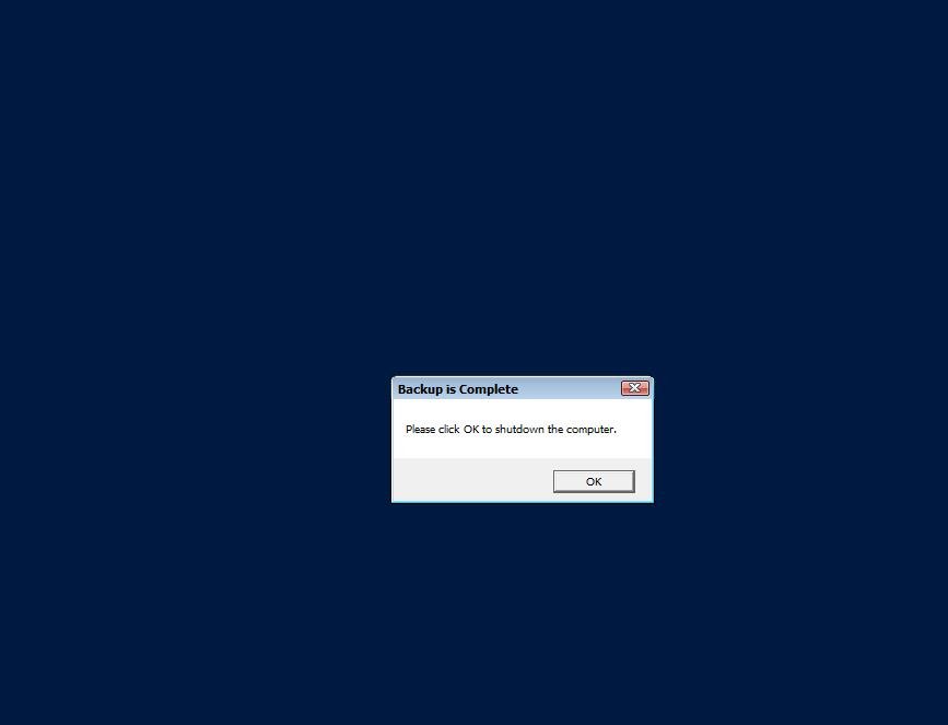

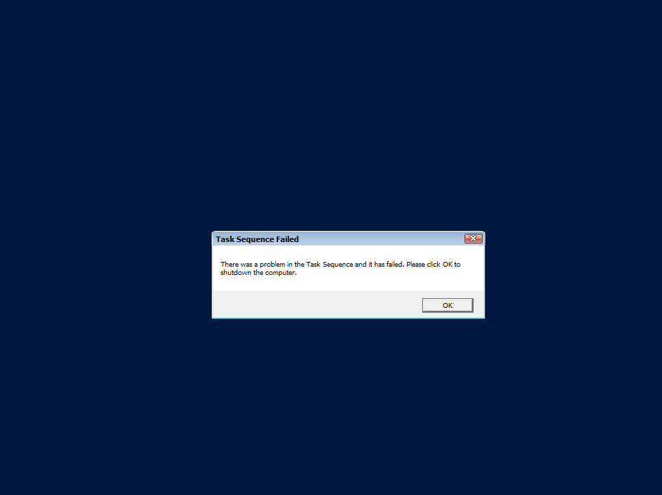

Thank you, I have solved the above problem. However, when reinstalling the system, select the english language and shut down the prompt. After booting into the system, nothing has changed?
211.thumb.jpg.24c3896d620bf25262f35263a2a32d8f.jpg000.jpg.b48fe412f693f8f63255d78ea1e90d0c.jpg
201908060117Logs.zip
reinstall is not a backup, so you must be doing something wrong. If i have time tomorrow i'll take a look at the logs, sorry but i've had a really long day today...

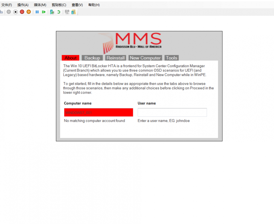

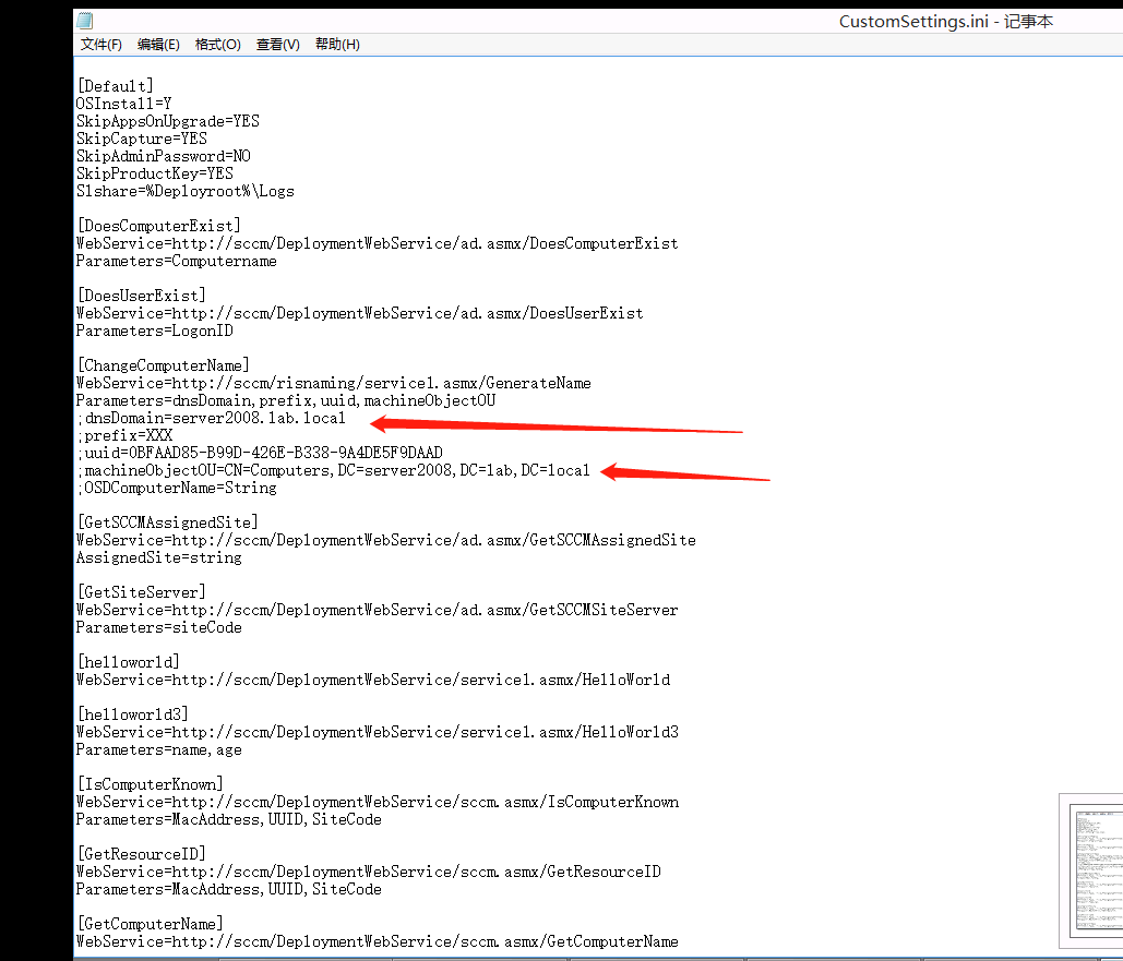

Also, does the CustomSettings.ini configuration need to be set?

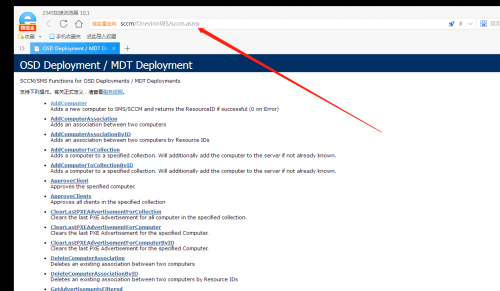

which webservice are you using ? do the webservice url(s) match those in the ini file above, if not then you must amend it accordingly,
the lines that have a ; in front of them are merely comments, they are not actually used

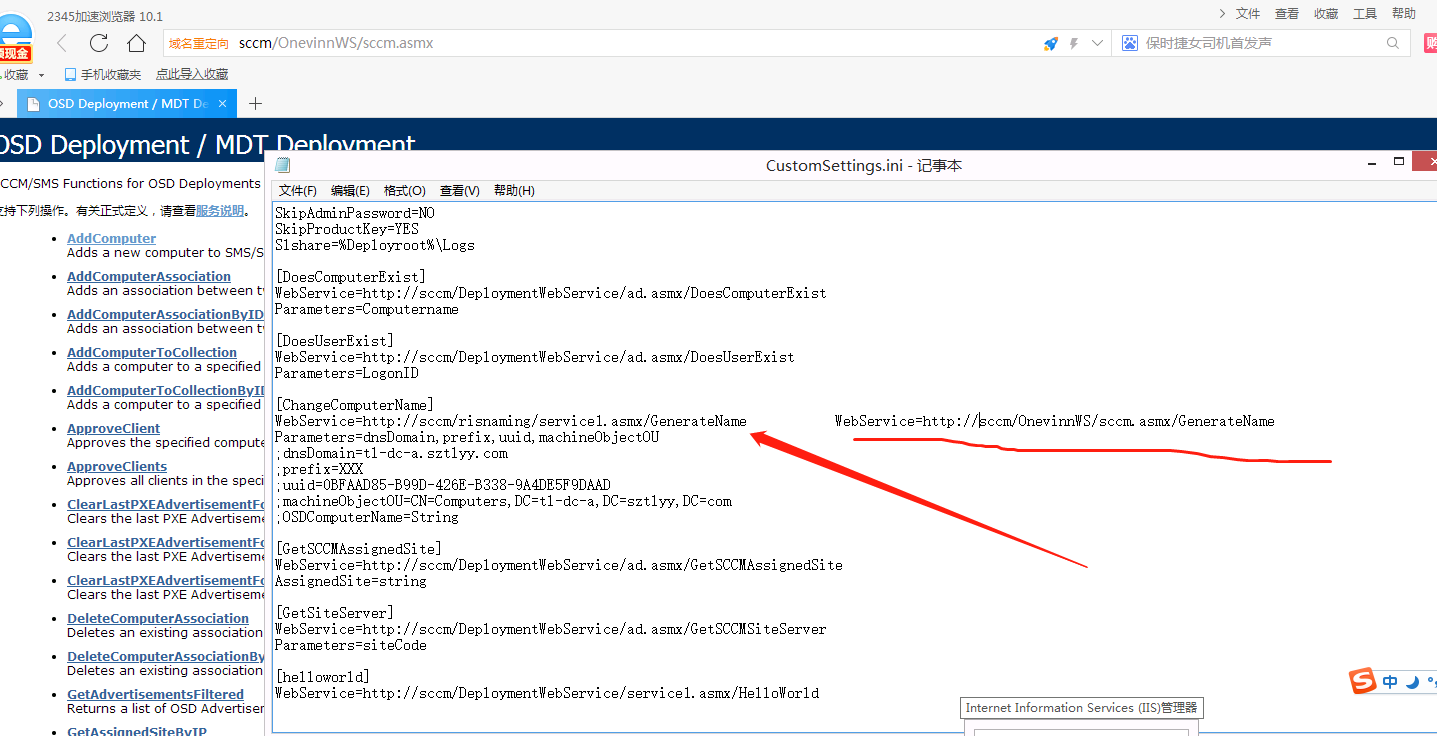

2 hours ago, anyweb said:
你在使用哪个网络服务?webservice url(s)与上面的ini文件中的URL匹配,如果没有,那么你必须相应地修改它,
有一条线; 在他们面前只是评论,他们实际上并没有使用
Http communication mode
[ChangeComputerName]
WebService=http://sccm/risnaming/service1.asmx/GenerateName
Replace it with this?
WebService=http://sccm/OnevinnWS/sccm.asmx/GenerateName
