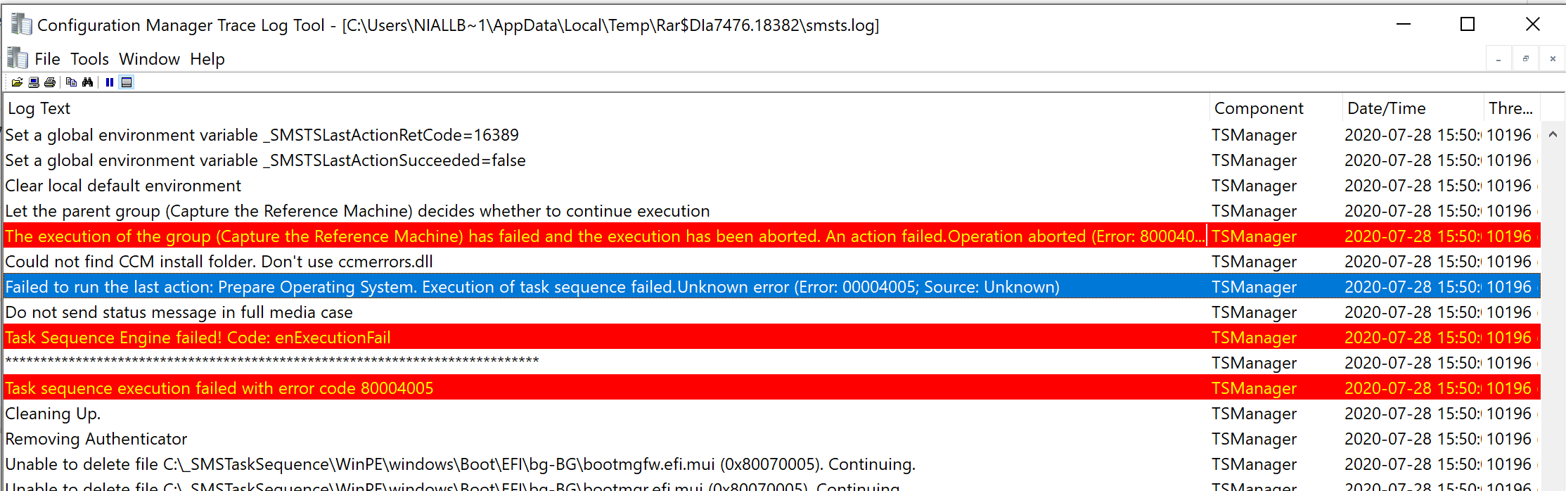

Hello everyone, i have a problem when i am trying to capture an image(During the sysprep). The error code is "sysprep error 0x00004005". I know that is a generally meaning error but i cant find a solution. I tried the solution with the registry settings but no luck. Can everyone help me?

here's your actual error

I use the sccm excactly as this post. The error messages are at the step of sysprep and i dont know why it fails
