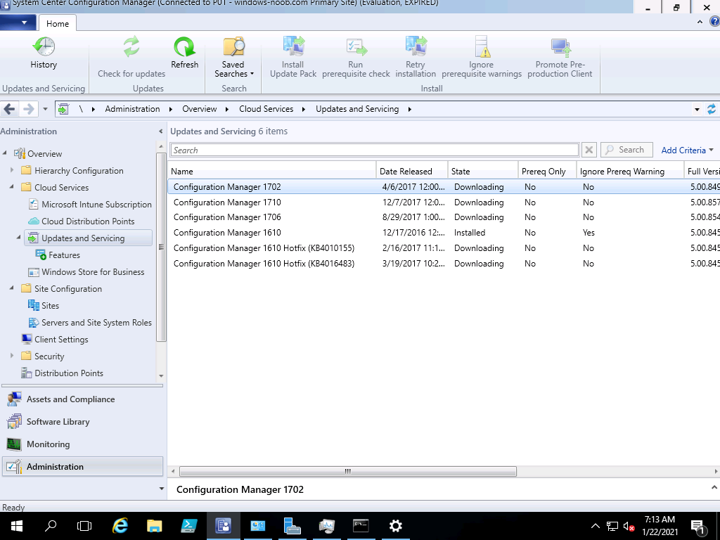

anyweb 480 Posted January 20 Report post Posted January 20 it's been a long time since i blogged about it (see here) but i think you'll have to go n+3, so probably offline upgrade from 1606 to 1706 or so and so on, 1606 has been unsupported for years now what took you so long you will definitely have your work cut out for you here...as you'll also need to upgrade SQL server more than likely, and maybe even the os of the server below is what an old lab of mine looks like (version 1610) after I triggered a sync, so in this case you can see that it can upgrade to 1710 (n+3) so that was... 1610 (n) 1702 1706 1710 based on this I'll guess that you can do the following... 1606 (n) 1610 1702 1706 (n+3) 1710 which would mean that you could theoretically upgrade from 1606 to CM2006 like so 1606>1706>1806>1906>2006 Quote Share this post Link to post Share on other sites

anyweb 480 Posted January 22 Report post Posted January 22 @wudevr please update us with how you get on and any challenges faced, I've updated my reply above with some more info... Quote Share this post Link to post Share on other sites
