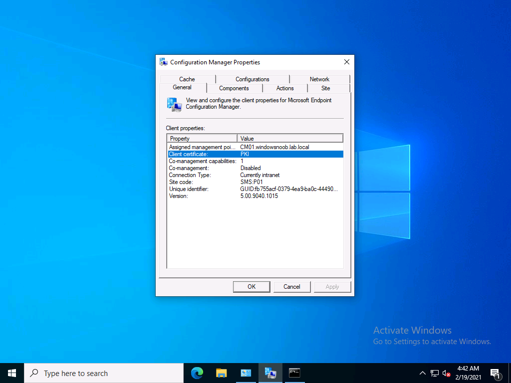

Under Administration - Site Configuration - Sites -> Primary Sites Properties - > Communication Security tab , only checked HTTPS or HTTP. So  not checked use PKI client certificate Also Servers and Site System Roles - I have checked for each DP --> under properties - only HTTP checked under Communication tab. AFAIK , no any HTTPS PKI confiuration.   is it true ?
ok that sounds like it's in HTTP mode. If you check the site component status, how does it look are there any major issues there?
On the clients, what do you see in this screen (a screenshot would help)
