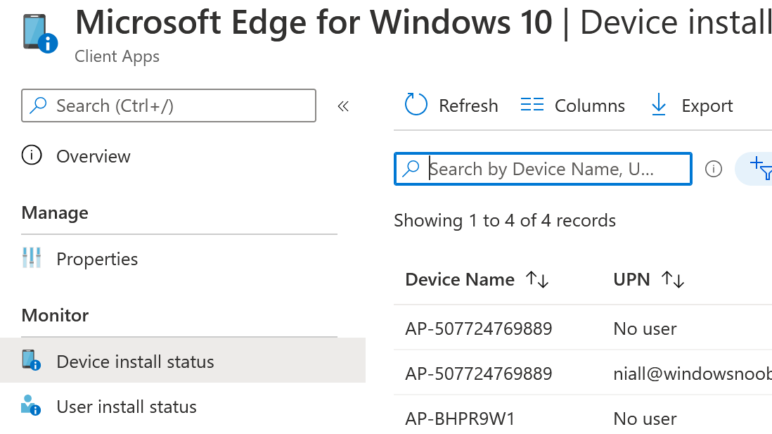

Kingskawn Posted June 4, 2021 Report post Posted June 4, 2021 Edge is updating itself while we are using SCCM to manage the updates as this printscreen is proving When I go to the CM console you can clearly see this update isn't deployed nor downloaded to the package. It isn't even advertised on The latest deployed version is 90.0.818.66 In Intune we don't have an application to install so I cannot figure out, for now, where this thing is coming? Any ideas? Quote Share this post Link to post Share on other sites More sharing options...

0 anyweb Posted June 6, 2021 Report post Posted June 6, 2021 and are you sure it's not getting policy from Intune ? are any of the devices you are investigating showing up in your Edge deployments ? are your Edge logs on the client telling you anything ? Quote Share this post Link to post Share on other sites More sharing options...
0 Kingskawn Posted June 7, 2021 Report post Posted June 7, 2021 Niall, I don't see any app status 'Edge' in Endpoint Manager admin center. What I can see is the Discovered apps and versions These are the workloads for now with co-management Quote Share this post Link to post Share on other sites More sharing options...
