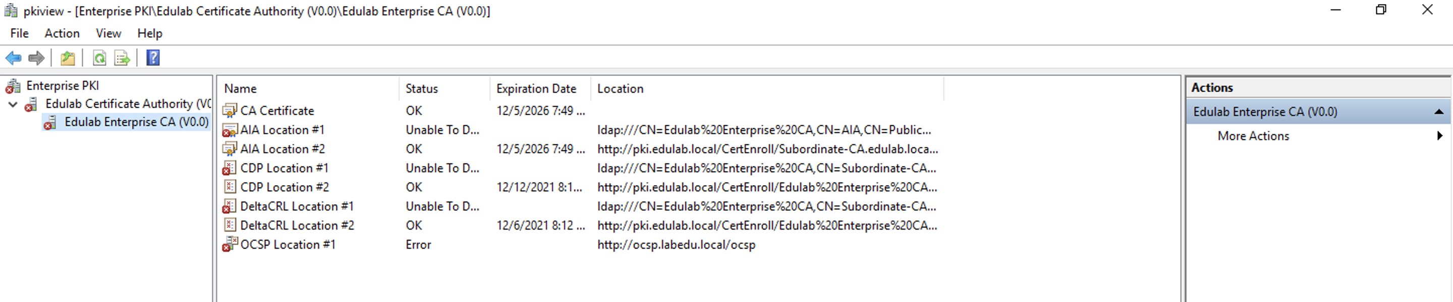

EduPin Posted December 5, 2021 Report post Posted December 5, 2021 Hi! Let's start this with a disclaimer: I'm a complete noob in AD. I need an AD to test something else and I've followed step by step the configuration in this guide:https://mjcb.io/blog/2020/03/09/certificate-authority-windows-server-2019-part-4/ Everything was going very smoothly until I reached "4.7 Verify OCSP Status" and the status of the Enterprise PKI Console was "Error". I've tried to fix it by revoking the CA Exchange Certificate (and maybe something else, I can't remember!) but somehow I think I made the problem even worse (see image attached). Can you please help me out? Many thanks in advance! Ed Quote Share this post Link to post Share on other sites More sharing options...
anyweb Posted December 5, 2021 Report post Posted December 5, 2021 did you try contacting the author of that guide ? clearly it cannot download something, have you tried downloading/verifying the url it's referencing ? I'd also recommend you follow my guides instead, they work every time 🙂 Setting up PKI Part 1 - Introduction and server setup Part 2 - Install and do initial configuration on the Standalone Offline Root CA Part 3 - Prepare the HTTP Web server for CDP and AIA Publication Part 4 - Post configuration on the Standalone Offline Root CA Part 5 - Installing the Enterprise Issuing CA Part 6 - Perform post installation tasks on the Issuing CA Part 7 - Install and configure the OCSP Responder role service Part 8 - Configure AutoEnroll and Verify PKI health Quote Share this post Link to post Share on other sites More sharing options...

anyweb Posted December 5, 2021 Report post Posted December 5, 2021 whether you start again or not is up to you, are you doing this in a lab ? did you take snapshots/checkpoints ? did you see my comment about what the actual error referred to... Quote Share this post Link to post Share on other sites More sharing options...
