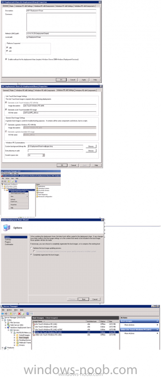

Make sure that you create both a x86 and x64 lite touch PE and add both of those images to WDS server.
Even though the task sequence is probably set to work on any architecture (check the properties), it won't show up unless the computer boots with the same architecture. I can post screen shots tomorrow.
Essentially, right click on your deployment share and make sure you have both x86 and x64 checked. Then regenerate your boot images. Import the x64 to your WDS and restart WDS.
When you boot from PXE, you'll see both LiteTouch PE's. Select the x64.
Let me know if that works for you.
Fingers crossed.

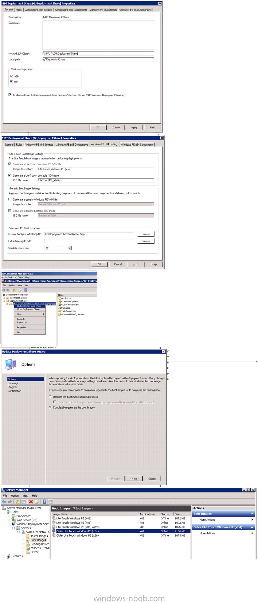

Fingers crossed.

Make sure that you have the check in BOTH boxes in platform supported.
Then check the Windows PE x64 settings to make sure they're right.
Right click the deployment share and select Update
Select "Completely generate the boot images"
Import into WDS
I hope this helps.
Import into WDS
I hope this helps.
Thanks for the snapshots will update soon
