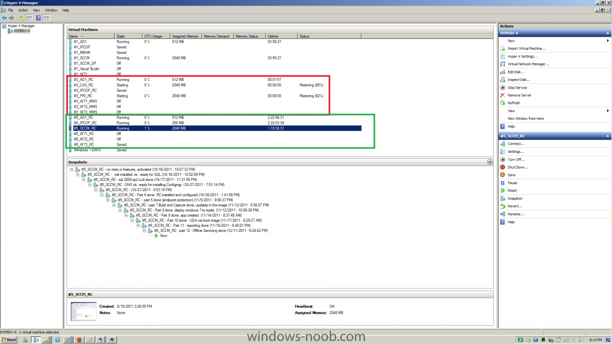

nothing strange about them, the SCCM box has 2gb RAM, 4gb is really recommended but in a lab 2gb seems to work fine, it's got 150GB hdd partitioned as os=30gb and d=rest of drive,
the AD1 server (domain controller/dhcp/dns) is 512 mb ram and 30gb hdd,
anything else you want to know ? i have created separate networks so for example #5_SCCM_RC is on a virtual network spanning 192.168.5.x and #3_SCCM_RC is 192.168.3.x means i can have multiple environments which are not interfering with each other
