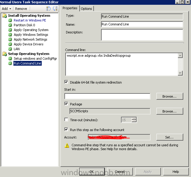

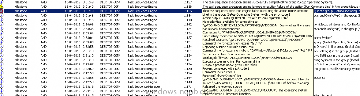

1.I have tried creating package and added progrgram into it and use that program into task sequence
2. I have also tried Adding command line in task sequence but didnt help. and error comes "incorrect function"
Pls see the below task sequence and error log

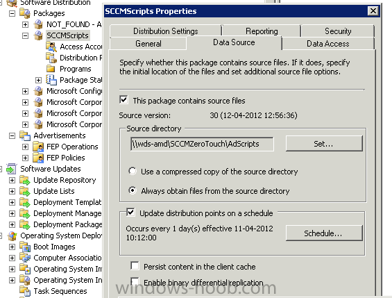

Hi
I have created a package called "SCCmScripts" and not added any program into and give the UNC path where the .vbs script is located.
I have applied your script but still get the error "incorrect function".
Pls see the below screenshots.

Hello Jorgen,
Hello Peter,
The issue have been resolved now.
The Culprit was VMvaretools which was changed registry HKEY_LOCAL_MACHINE\SOFTWARE\Microsoft\COM3 value ;Hence my .vbs script was unable to run.
See http://dynamicdatace...y/provisioning/
To troubleshoot the issue i followed below steps.
1. Copying script to local system folder
2. Running the script from local system and redirects its output to .txt file so that the exact error can be viewed,
3. The error in .txt was it "could not find the script engine."
4. Change the registry setting is command line TS.
reg add HKEY_LOCAL_MACHINE\SOFTWARE\Microsoft\COM3 /v REGDBVersion /t REG_BINARY /d 010000 /f
5. SUCCESS
