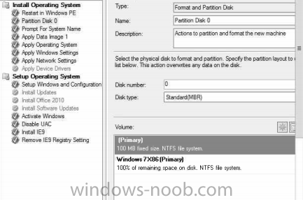

Move the apply data image1 directly above the apply OS task...in the partiotion task you will see 2 partitions the 1st one been very small approx 100mb this is the apply data image1 thus the reason as to why you have to move it above the apply OS task, also in partition task select the second partition and edit it make it install on 100% of the rest of the disk(this is your C drive) and also name the partition if you like!!
I have some images that have this apply data image after I have captured from a VM, and when I create an OS image and TS out of it I have the same tasks(apply data image 1 and apply OS), i do the above and it works for me, no reason as to why it should not work for you!! Remove the capture files and remove the capture windows settings of the task sequence and see how it go's..
This image is same as your TS except i moved the apply data image above the apply OS
This one shows the the 100 mb partition(this is the apply data image and by default is above the main primary partition thus the reason as to why you have to move it above the apply OS)
