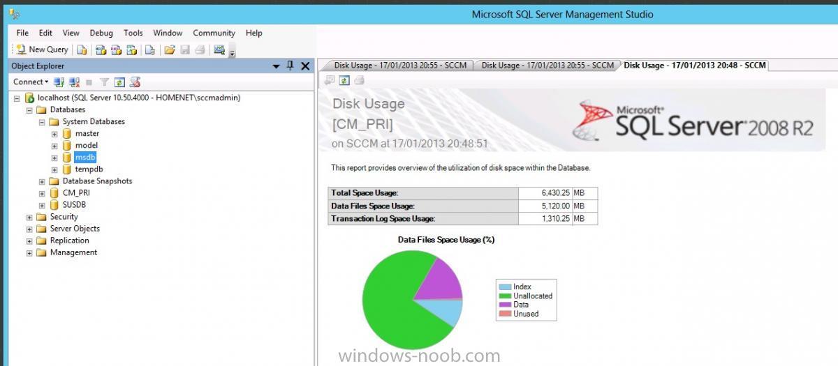

Hi Garth,
I checked the drive again.
I've got 8GB free out of 30GB.
The SCCM DB is quite small, please see the attached screenshot.
So I don't know what could be taking up all of this space and causing it to grow.
I'm confused about what the problem is, in CM12 the db will start with 5GB and grow.
I would just watch the drive and only worry about it if grow much more.

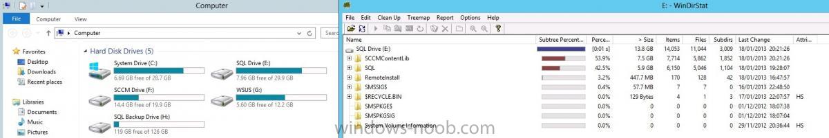

Hi Garth,
I,ve attached a screen shot of my drives.
I've also analysed my SQL Drive and it's reporting as being around 13.9GB in use.
But as you can see in the picture Windows is reporting a lot more.
It's a bit confusing and I'm trying to find out what's consuming this space.
I can see form the screenshot that you have CM12 Content library on your E:\, you should move this, to another drive. And H:\ looks like the best one, all your other drives are just too small.
Is your SQL reporting log increasing in size??
I had a similar problem where by my main drive was dramatically increasing in size every day for some reason. I pin pointed it to be the SQL reporting log. It was adding 3-4GB everyday(this site had approx 1500 machines).
If this is the culprit then you will have to shrink the reporting DB and also change the recovery model to simple as it probably set to full mode at present!!
Also 30GB for SQL, not sure about this?
Would it not be better just to have a default C drive and also E drive with all installed on it??
Without sounding irrational but from a personal perspective it looks a bit messy with the current setup considering all these drives reside on the same server anyway??
