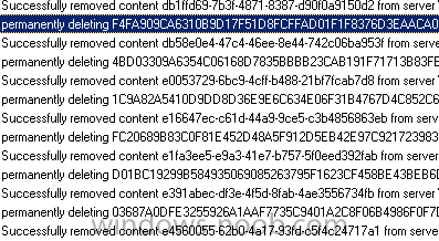

Looking at SCCM logs and looking at the Server Audit logs only showed me that my main server (computer account) was deleting my source content. I was able to determine the first time it happened (date and time) by the dist manager and packagetransfer logs.
My problem involved software updates. Software updates were configured by my coworker to download and they pointed the content to download to the root of the share which ended up deleting all source content. I went under Deployment Packages and selected to display the Package Source Path. This revealed a package was pointing to the root. Made a change to the package to point it to another folder within the software updates folder we have and that cleared the problem.
