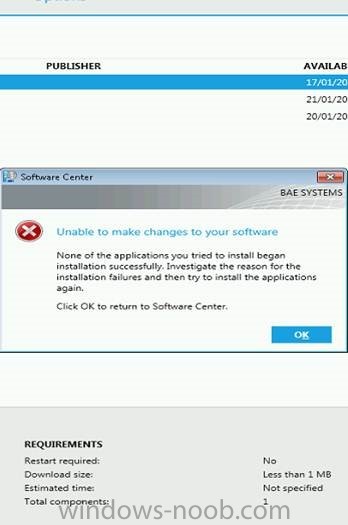

Ok so this task sequence ive migrated from 2007 to 2012 it works fine as a bare metal build from pxe.
So ive added usmt with hardlnks to this ts and now am trying to run it live on the machine.
I select the ts from software centre and it does nothing for around 20 secs.
And then this error pops up:
CAS logs looked fine to me….or at least I thought I did.
The only real error I could find in the logs was this from execmgr..
DC100017 is my ts ID
NOW…I had this exact same issue on Tuesday. And I fixed the issue simply by adding the MACHINE IM TRYING TO RUN THE TS ON…..TO THE SMSPKGE$ SHARE ON ITS LOCAL DP.
And then BAM!! Works a treat.
So then I had the client add the built in “domain computers” AD group. To the SMSPKGE$ share on the DP.
Thought all was fine and dandy.
2 days later….
Exact same error is back in the exact same way.
So for some reason I have a permissions issue again…
Yup i can confirm.
Cheers Kevla
Edit: i know for a fact it only fails when the old packages migrated from 2007 sccm are included in the TS...
I believe they are calling scripts that include UNC paths or something.
After i added the machine AD account work fine...
2 days later...stopped working
EDIT: FIXED...........again!
OS is server 2012. Seems the perms had been changed on the smspkge$ folder since i fixed it days ago.
Its on server 2012…looks as though the smspkge$ folder had new ownership and the perms i added had no longer filtered down through all the packges within smspkge$.
Ive had to take ownership back. Remove all perms. And re-add ensuring they filtered all the way down.
And once again the TS started straight away.
Cheers for the help Kevla.
