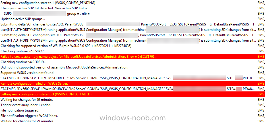

After deploying the SUP role, I get the following in wsyncmgr.log and WCM.log

  • WSUS Configuration Manager failed to configure upstream server settings on WSUS Server "PrimaryFQDN".
  • WSUS Configuration Manager will not be able to configure WSUS Server "PrimaryFQDN" as the WSUS Server remoting API's of version 3.0 SP2 or greater are not installed on this site server.Solution: WSUS Server configuration on the WSUS Site System requires WSUS Server remoting API of version 3.0 SP2 or greater to be installed on the site server. To install the remoting API for version 3.0 SP2 run "WSUSSetup.exe console_install=1" on the site server or refer to the documentation.

Do you have wsus console installed in the SCCM Server?! that's a requirement... I had that error a couple of years ago and I just had to install the CONSOLE (not the service). There is a powershell command for that. Hope it works!
