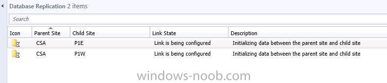

fom the CAS: Link is being configured. In initializing data between the parent site
and the child site

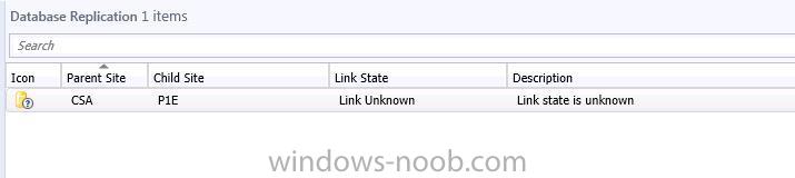

from the Primary: Link Unknown. Link state is unknown
