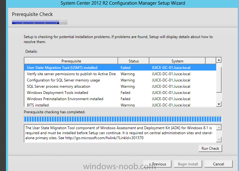

i am trying to build a config manager lab using sccm 2012 on server 2012 and sql 2012, everything is installed on 1 server. Everything installs ok and the adk is on c:\programe files. however when i try and install sccm the adk fails the prerequsite check, it say installed but
It might sound obvious, but have you tried removing and re-installing the ADK with all of the correction options selected and then try re-running the SCCM prereq check?
