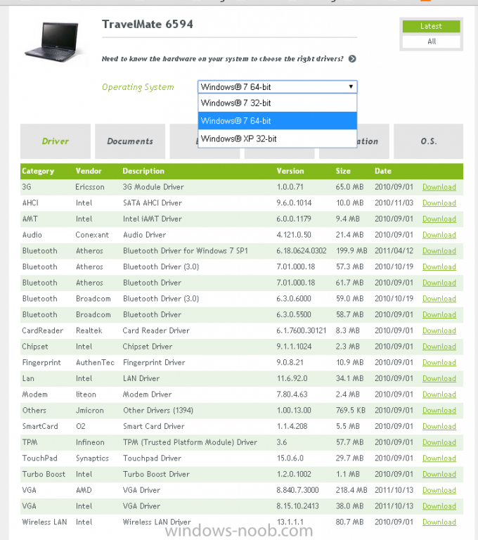

Also your model is fairly old, it might be a matter of compatibility straight up... i.e. see below, they don't offer win 8 or 8.1 drivers. I had a lot of problems with drivers moving to 8.1 in a few cases. You can probably get the latest Chipset and AHCI drivers from the manufacturers directly though, 90% of the win7 drivers may work, but you should definetly go through and make sure when you import them they have "win 8.1" capable checked off in the "applicability" section.
