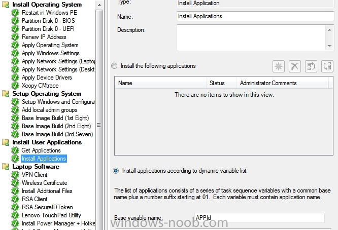

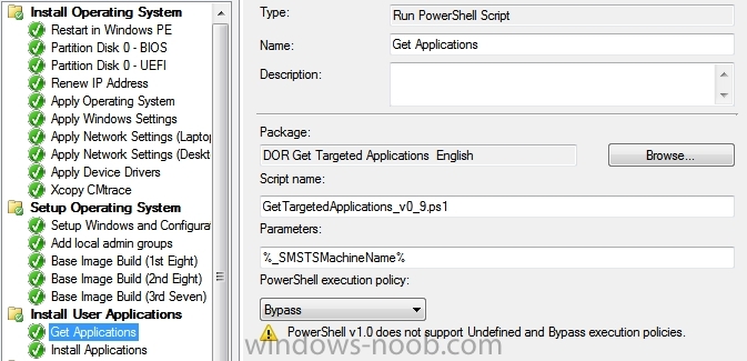

Your link looks very promising. Would I need to import affinity associations prior to trying something like this or can i stick with entering a user affinity upon execution of the image TS? I have already added the SMSTSUdaUsers variable to my boot image and am currently testing it out. It prompted me for a primary user so i am crossing my fingers.
Being a little slow, could you explain the $ResourceName and $Container variable for your script a little more.
I am going to assume that the "Get Applications" TS step shown in the illustration is where the powershell script is configured.
Great info...Thanks again for the ideas.
It doesn't matter how you input the user, as long as you do :)
The resourcename variable is the name of the computer object running the task sequence and the container variable is the folder name that contains your application deployment collections (just to prevent the script from searching through all collections).
Got it. Since I plan on implementing this script for all devices, can I use %_SMSTSMachineName% as the ResourceName?

The deployment works fine until the powershell script executes. I followed the instructions (I think) correctly. I created a package for the script with no program. It has been distributed correctly to my distribution points. I have created a separate folder called "Software Applications" within the Applications node and populated it with my Firefox application (see app_container attachment). I have tested the application to ensure that it works correctly.
Script Parameters:
param (
[%_SMSTSMachineName%]$ResourceName,
[DOR]$SiteCode,
[sCCM2012DOR.fqdn]$SiteServer, (is the fqdn required here?)
[software Applications]$Container
TS Steps: (see attached files, get_apps executes powershell, install_apps installs them)
Every thing executes fine up to the powershell step. Then the system hangs for a few seconds and reboots. The user affinity is set correctly, but firefox is not installed. Once rebooted and the config manager starts communicating, firefox is loaded based on the user group setting assigned to the primary user.

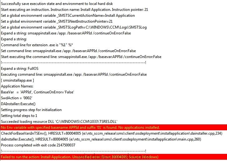

It appears that there is more to this. The TS just failed with the error code 0x00000001. I am trying to find the logs now to see what went wrong.
