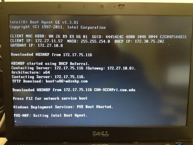

I've scoured windows-noob for the last couple days, but can't find anything relating to what I'm seeing during a PXE boot.
I currently have a side-by-side SCCM install. My new rollout is all HTTPS with a CAS infrastructure, just trying to get PXE working on it.
I've re installed the DP multiple times, attempted to manually remove WDS and its shares (remoteinstall) and have rebuilt the Boot Images from the WAIK (the Win 8.1 ones), and have ensured they are on the DP.
It looks like PXE is working fine, but SCCM or WDS is not finding the Boot Images from SCCM?
I don't really understand the process after the PXE client loads "\\FQDN.edu\REMINST\SMSBoot\x86\wdsnbp.com"
Thanks so much in advance!
WDSNBP started using DHCP referral.
Are you working across VLANs?
Have you configured DHCP options? (Unsupported by Microsoft)
If any of the above are true, you will have to configure IP helpers, DHCP relays on your switches.
Also I see it is requesting you to press f12 for network boot, I assume you have pressed F12 at this stage?

I have configured DHCP with the 66 and 67 options. These settings in DHCP work great with my other SCCM deployment, when I change the IP to the new SCCM server, I get the screenshot above. The DHCP Helpers and relays are configured on the core and have worked with other SCCM/FOG/Altiris deployments.
Pressing f12 gets me to a boot device not found message.
