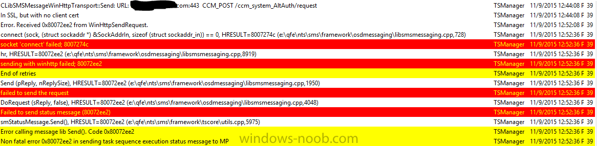

The logs all contain errors like this, when it happens...
It looks like it tries a few times to connect to the distribution point but is unable to - and then results in failure. The error codes are actually pretty difficult to find solid information on...the errors in the majority of the forums I read always have 1 or 2 more items listed along with the error that helps point them in a direction. So, I was wondering if we could spark up a conversation and perhaps bring some resolution to my service desk teams who randomly struggle to image!

Error code 8007274c:
