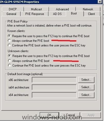

If the computers start in PXe boot,you can configure Boot options in WDS to not ask for Press F12 . If you are in server 2K3,you can replace pxeboot.com with pxeboot.n12 .Is that what you are looking for.

Thanks for your reply, but that's not what I mean. I already know this thing, but I want to suppress the first F12 (and I don't want to change boot order in the bios).
