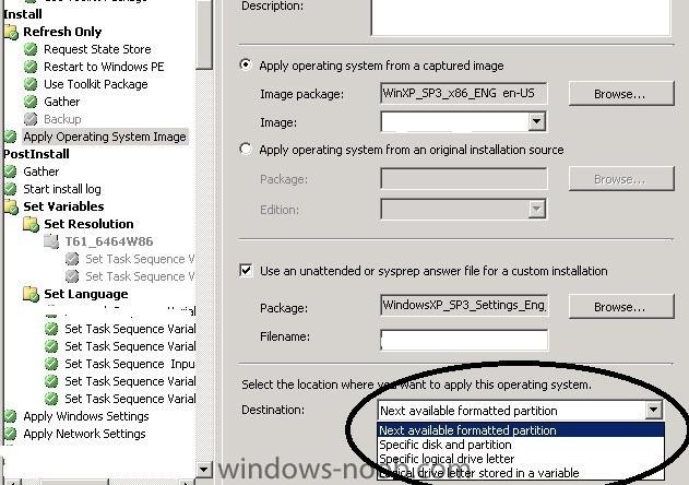

Hallo, I'm in process of deployment Windows 7 OS, exisitng computers with Win XP have one HDD disk0, currently there is two partition C: has 98 GB and D: have the rest drive is I think entire hdd has 232 gb. I need to build and capture image with windows 7. How to configure task sequence to retain former hdd structure and leave user data on D: drive and only format existing c: volume?

You can remove the format and partition disk task in TS and only use the apply operating system on the selected partition like C or D etc.

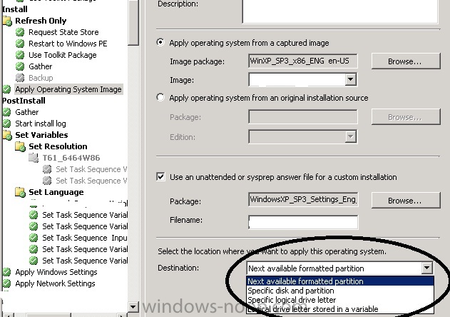

thanks for replay Eswar i will try this
