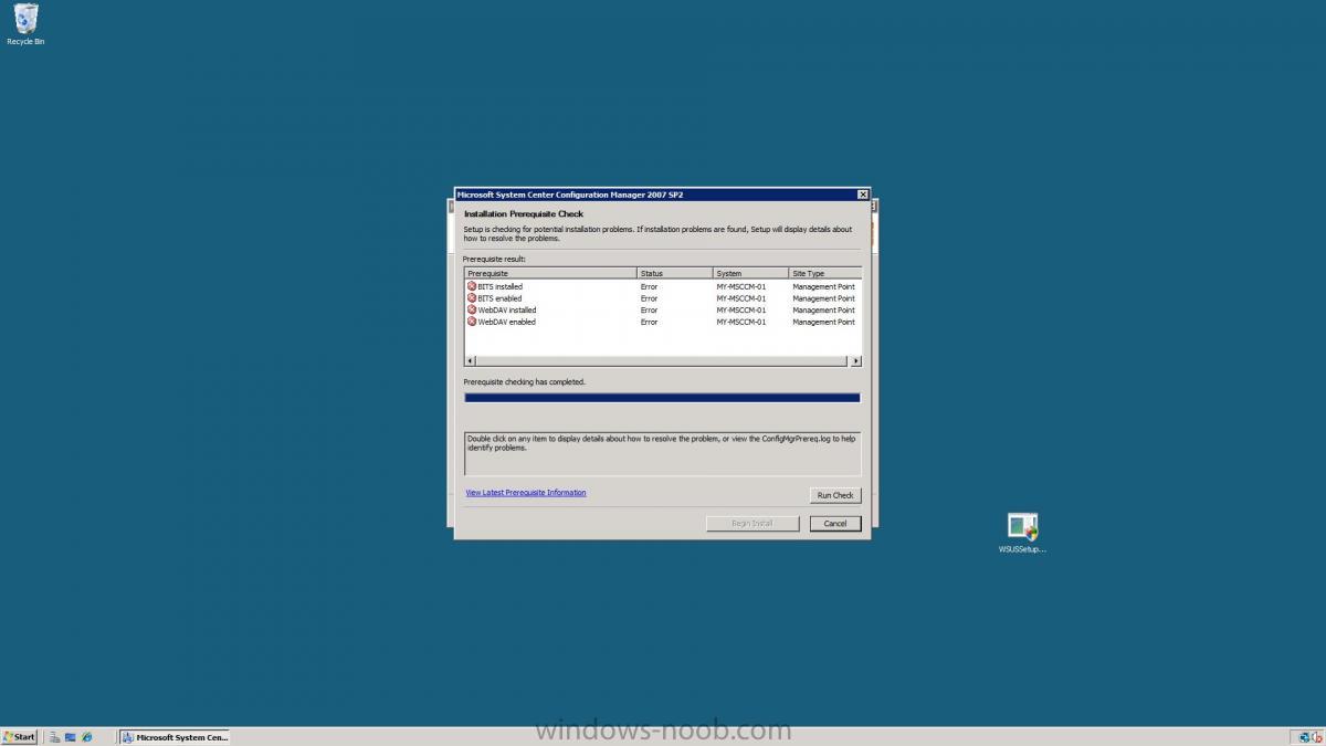

We are currently trying to install Configuration Mgr 2007 on Server 08. I have installed WebDAV and SQL and the followin Features and Roles:
Web Server IIS
Windows Deployment
Windows Server Update Services
.NET Framework
BITS Server Extensions
Desktop Experience
Remote Differential Compression
Remote Server Administration Tools
Windows Internal Database
Windows Process Activaton Service
I have ran Installation Prerequisite and it was successful but when I try to install Configuration Mgr it gives BITs and WebDav errors ( see screenshot ).
Any ideas?
Thanks
Yes WebDAV is enabled, thanks for the link to the whitepaper, I'm going to go through it step by step, I'll let you know the results!
Ok, found a site that said I needed IIS 6 compatability installed, did that and it worked. Thanks for the help.
