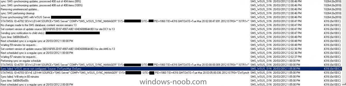

I successfully set up SUP and initially synchronised. I have a full list of update and it was fine. After the first sync, I'm now getting the attached error.
I have checked the ports in SUP and ensured they are set to 8530 and 8531. Is there anywhere else to check? I have also tried a manual sync and still has the 'WSUS server not configured'.
Is there anywhere else I need to check? No (apparent) issue in SUPSetup.log, WSUSCtrl.log, and WCM.log.

Open the WSUS console and try to connect to the SCCM server. Let me know what happens.
Hi Waynegro,
Thanks for your quick reply.
I can connect to the SCCM primary site server via port 8530 successfuly.
