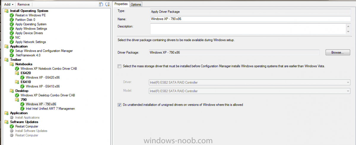

Here is your problem
"The step (Windows XP - E6420 x86) must be running in WinPE"
Which query you mean!? E.g.: for the E6410 I add the following WMI query:
select * from win32_computersystem where model like '%E6410%'
This worked so far I can see that in the log

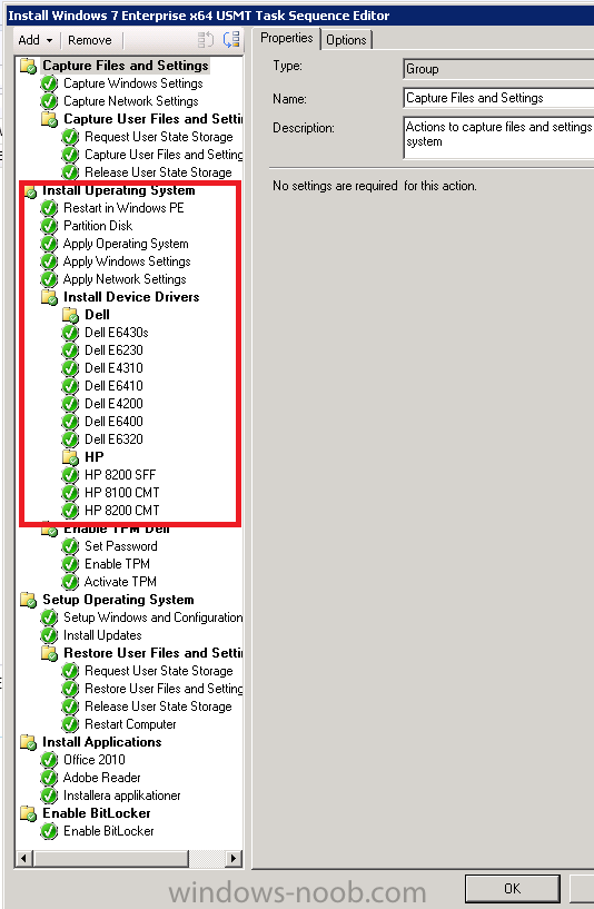

You need to move those before you install the client, like this. Do you see the difference? :) Because you need to be inside WinPE.

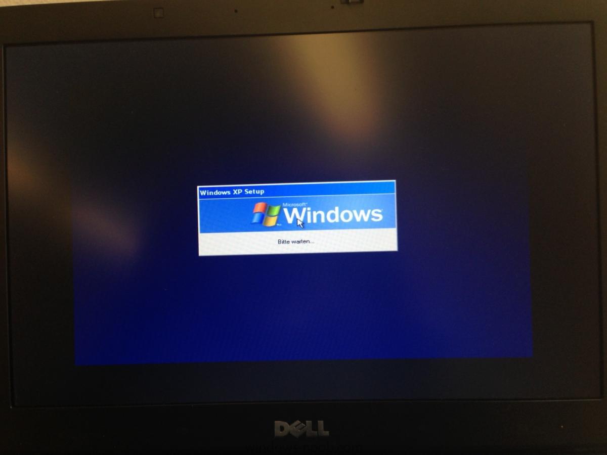

Its not working. When the System boots after the Driver installation it get this window (attached). It seems to be a missing Network driver. But this is not possible because before It was running!?
After some investigation into this problem, I found out that the ST Micro Accelerometer is causing the problem during the installation.
