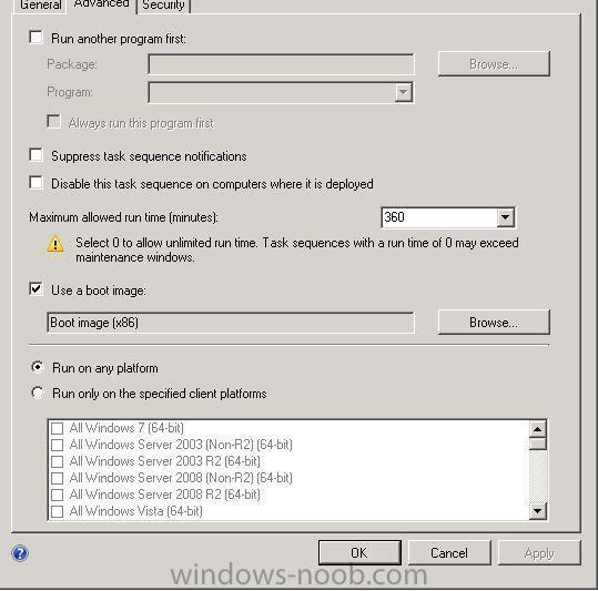

However on boot I select one of our task sequences abd it fails with "This task sequence cannot be run because the program files for SSF0000A cannot be located on a distribution point............."
Looking on our backup it looks like ID SSF0000A was the boot image that I deleted.

Rocket Man you are a star.
I had only selected the new image when I was creating my task media.
