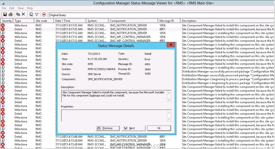

Hi All,

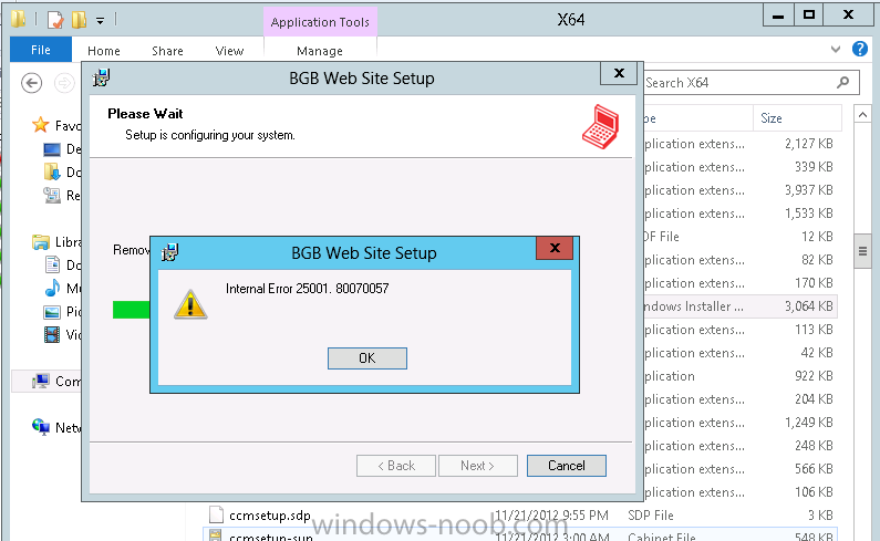

I have a SCCM lab setup with the plan to migrate clients from CM2007 to CM2012. I have a Windows Server 2012 Domain Controller and SCCM2007 running on Windows server 2008 R2 and 1 Windows 7 and 1 Windows XP client. I created another Windows Server 2012 VM running CM 2012 on it with SQL server 2012.I was able to install CM successfully accept the Control Manager component. It fails to install the bgisapi.msi. I tried to manually install the msi, but it fails with an internal error as shwon in the attached image. Attached is the log file for MPmsi and bgbisapi. I would appreciate some help and advise.
Thanks!! in advance.
