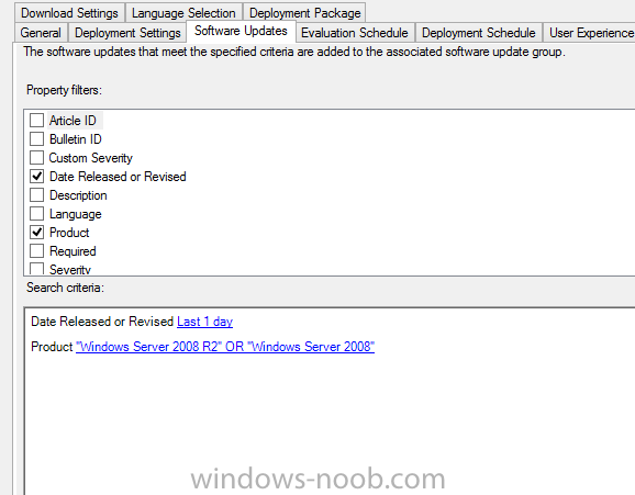

This my setup for Server 2008 for example:
Do I need to enable the "Severity" and/or maybe "Update Classification" to get all of them?

You'd have to compare and contrast the list of updates you're deploying in Configuration Manager with the list of updates that is being shown in the Windows Update screen. See if there are any major products (eg. Microsoft Office 2013) missing from your SUP configuration in Configuration Manager, that have updates shown in the Windows Update screen.
