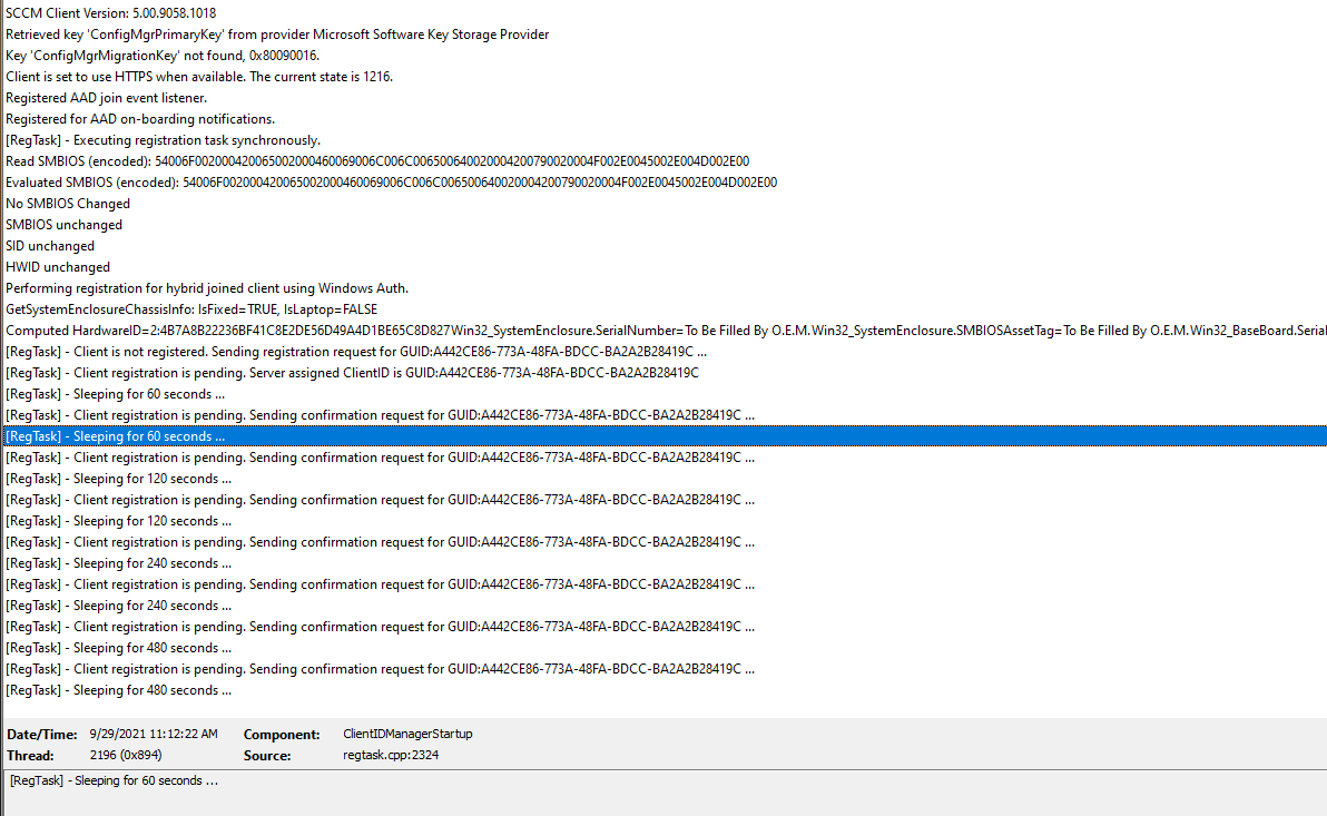

The machines that were giving me issue I just did the delete on SMSCFG.INI and then restarted the SMS to get a new cert to register correctly I'm back to way above my #'s Sorry for the long thread but I got it fixed in end. -

Update still waiting on MS did a another reinstall watched the logs ensured all permission are correct I have both of Sites setup this way So question. Can I go to the \Administration\Overview\Security\Certificates And Just import this SMS into the Certificate folders I know this should be done automatically? I want to make sure the thumbprint matches my SMS in the SMS folder or the one in personal. Can someone confirm with me if I can do this and the correct ones to match up? I also made sure i didn't have anything being blocked in my \Administration\Overview\Security\Certificates still getting the same errors from clients not registering My clients just do this They never register just sleep and retry forever; done clean install; deleted machine keys ect; different strings restart SMS ect same issue. -

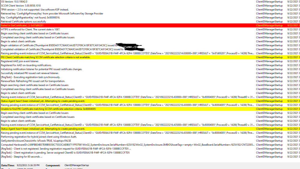

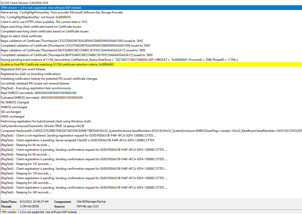

So I wasn't getting anywhere with the self singed so I changed over to HTTPS and did the full patchmypc PKI guide Can you confirm it's getting the PKI cert correctly here also it's still stuck on Client registration. I'm going to do a reboot after hours to see if that will fix the issue. I think the PKI is working from this log; I'm able to view the IIS from each site goes to the correct page boundries are good. I hope I don't have a messed up IIS setting or something I did changed over the required SSL cert and set the correct certs to ignore. -

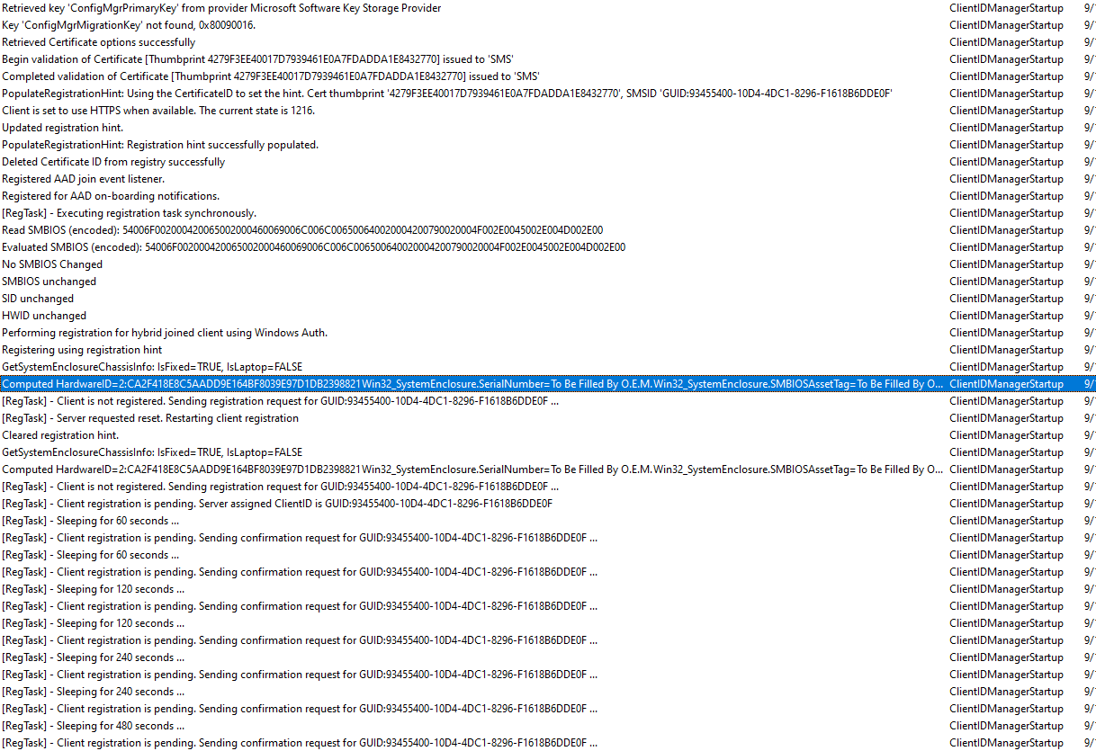

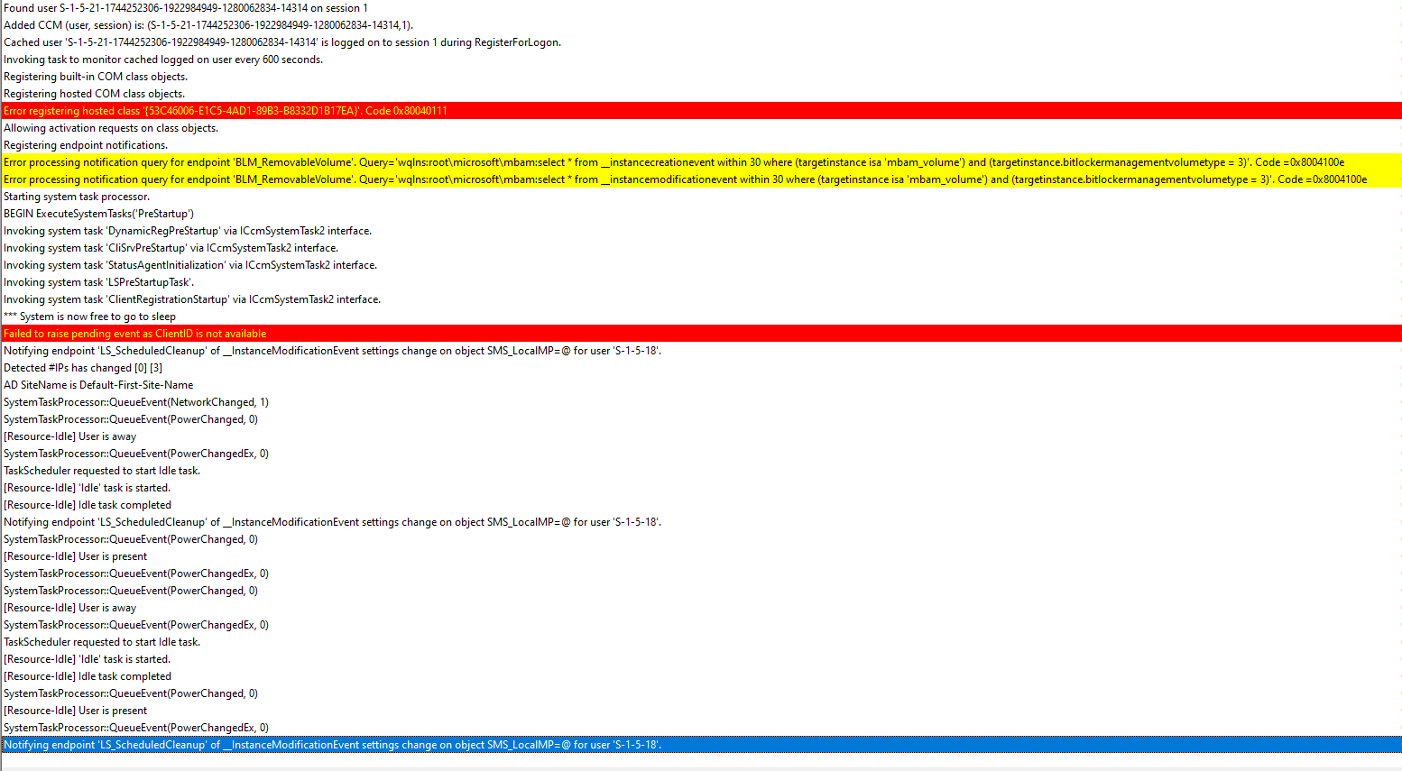

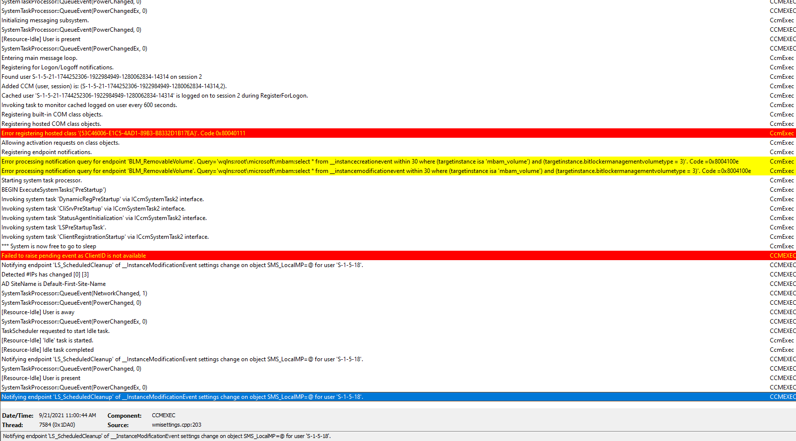

So I reinstalled both MP's one I did the HTTPS to HTTP and my main wouldn't take so I completed deleted via the SCCM console and re added it Was getting the same errors So i went back to the tell it to look for the SMS string under the PKI and also without both give me the same type of errors Here is the SMS Just sits and never registers the client. Client Certificate None Here is the CCMecec on the SMS This a Failed to raise pending event as ClientID is not available, I have looked and not found many working links for this issue. Same Error type of my other machine Same Ccmexec.log error Two different machines -

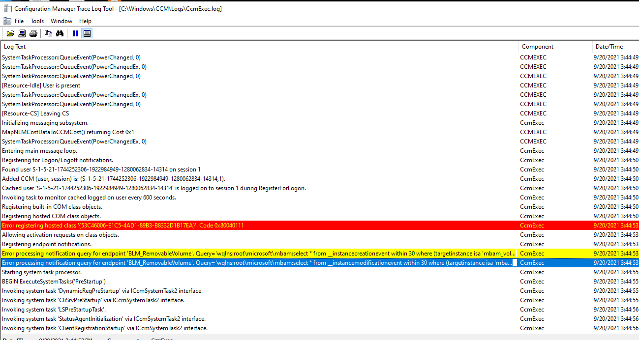

Here is my CCmexec log from one of my failed cert clients This Error registering hosted class '{53C46006-E1C5-4AD1-89B3-B8332D1B17EA}'. Code 0x80040111 CcmExec 9/20/2021 3:44:53 PM 15444 (0x3C54) This Error registering hosted class Code 0x80040111 This doesn't not give me much to work out; been looking for all articles on this error goes back to mp issues. I will try another Management Point reinstall as from my last set of logs the certs look like they are applying. -

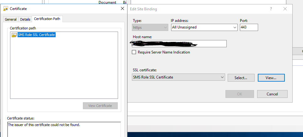

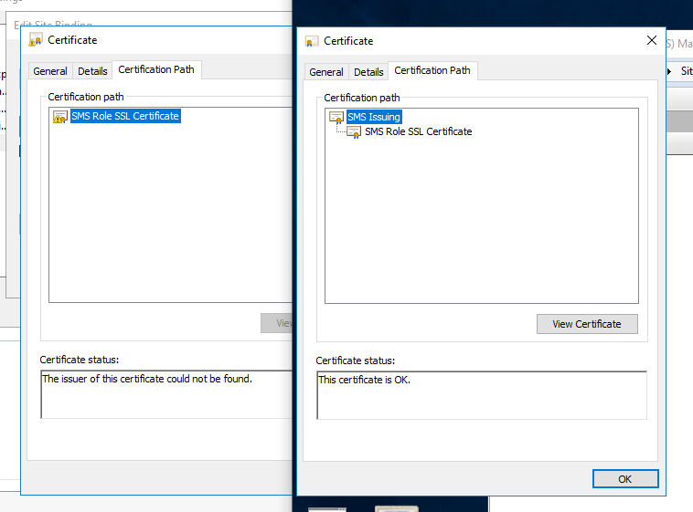

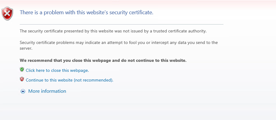

So i went ahead and deleted the old certs and did what SCCMentor said to delete the EHTTP with the Site Check and ensure a new SMS role is install. what's strange is my 02 will recreate the SSM Role SSL Certificate and auto re add it; my 01 i have to manually import it but it does re add. They both give me cert errors when going to 443 via IE see screen shot above. This is on my 02 fresh install client after cleanup Both of the SMS Role SSL Certifcate give me Is there any setting in IIS I am missing? Most are check to ignore certificate I was not getting Retrieved key 'ConfigMgrPrimaryKey' from provider Microsoft Software Key Storage Provider ClientIDManagerStartup 9/19/2021 9:41:57 PM 6352 (0x18D0) This is good. I also see it gets a SMS cert but it still never finishes the setup and still shows up Certificate None I doubled checked and this is good as my http://mysccm/sms_mp/.sms_aut?mplist goes to the XML file on both of my servers http://mysccm/sms_mp/.sms_aut?mpcert works on both of my servers goes the the MPcertificate path with the long text Just kind of stuck on what to try next. -

When you say you deleted your I deleted the SMS Role SSL Certificate certificate from local machine this is from the Server This would be the one in the SMS folder? Personal Folder? Or Secure Folder? Can you show me on the MMC I think I need to do this; also when I go to binding do I need to have the Server host name here? and have Required Server Name Checked I noticed when I did I was able to browse to port 443 via the IIS but like i said my 02 I'm unable to. My 01 issuer of the certificate could not be found but works via IIS My 02 this certificate is ok runs into error browse via IIS I'm thinking the 02 still has my copy and i just need to delete it and re do it; I'm still getting the same errors installing on my 01 might try a reboot after hours and report back -

So I have two servers One I think it was created and the other I copied it; can i just delete them both and have them re created So my 01 has this IF I set it to check box I can go to browse 403 and takes me the IIS page ie it works My 02 Still gives me this and when I go to the browse the 403 web page to check the cert This is my 02 this is my IIS page so there is an issue I still have this error I only have 1 thing to Select for the SMS Role SSL Certificate? I'm going to try to reinstall some clients on my 01 and see if takes Let me know thanks for the help so far. This is such a mess. -

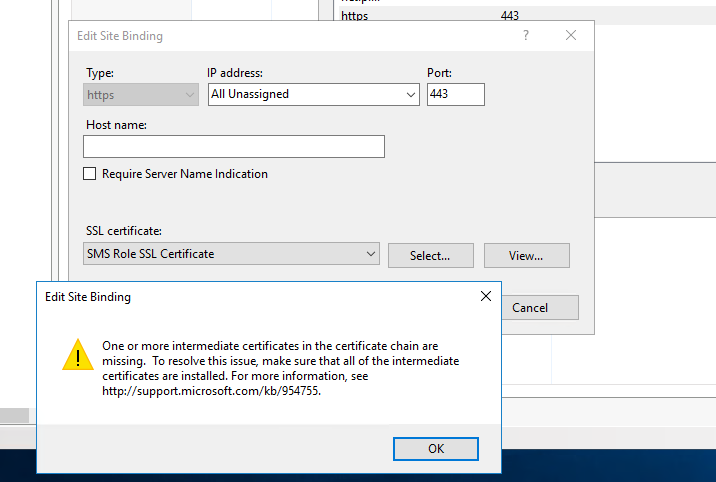

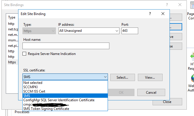

@SCCMentor Those screen shots are so helpful! I went in and found that SMS cert I needed I went I added it to the IIS and I have been manually adding them in. I can see this is not the way. I thought as much as there is no documentation on it How can I Set the IIS SSL cert to 'Not selected' can I just delete it for now? -
Clients not getting self singed certs
TeachMeSCCM replied to TeachMeSCCM's topic in Configuration Manager 2012
So I only have this on my 2ed host my 1st main host does not have this. ^^THIS IS MY 02 When I select it I get this message. I don't get any other messages with my other certs and yes I did try to get PKI to work but was not able to. Does the client complete registration? Hard to know when we are working off screenshots. Yes it shows up in my SCCM console but shows Client None. ^^This is my 01 I had created these PKI and ISS in the past by importing them for the MMC; this is on me I was trying to fix this on my own; I still trying to figure out how to get this right. Thanks so much for all the help so far. I really appreciate it.
