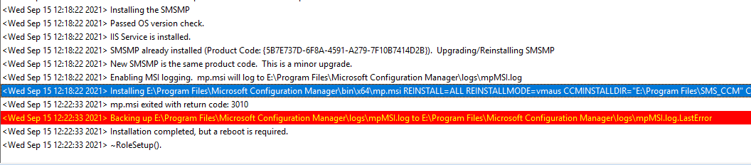

So I reinstalled both MP's one I did the HTTPS to HTTP and my main wouldn't take so I completed deleted via the SCCM console and re added it Was getting the same errors So i went back to the tell it to look for the SMS string under the PKI and also without both give me the same type of errors Here is the SMS Just sits and never registers the client. Client Certificate None Here is the CCMecec on the SMS This a Failed to raise pending event as ClientID is not available, I have looked and not found many working links for this issue. Same Error type of my other machine Same Ccmexec.log error Two different machines -

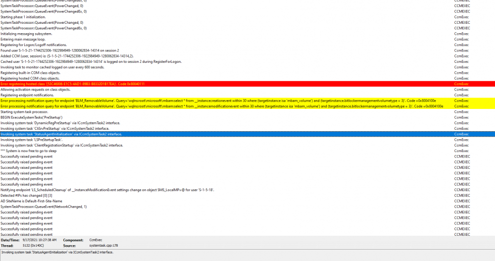

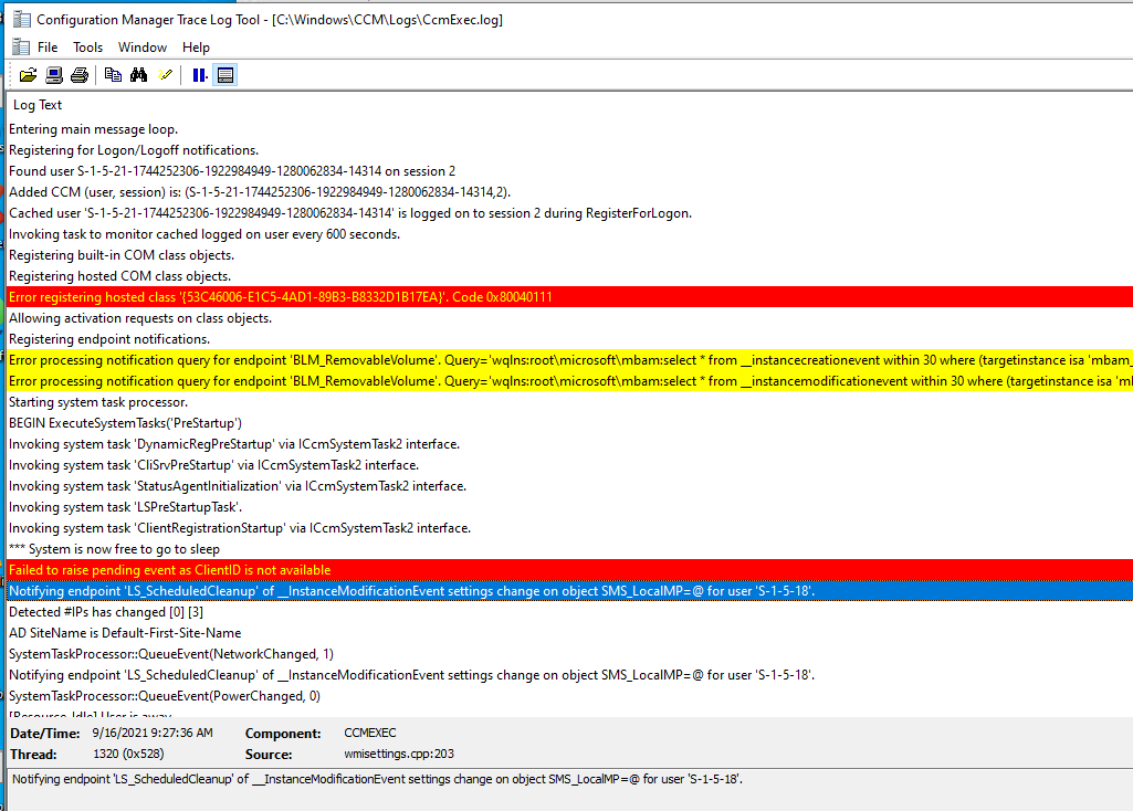

Here is my CCmexec log from one of my failed cert clients This Error registering hosted class '{53C46006-E1C5-4AD1-89B3-B8332D1B17EA}'. Code 0x80040111 CcmExec 9/20/2021 3:44:53 PM 15444 (0x3C54) This Error registering hosted class Code 0x80040111 This doesn't not give me much to work out; been looking for all articles on this error goes back to mp issues. I will try another Management Point reinstall as from my last set of logs the certs look like they are applying. -

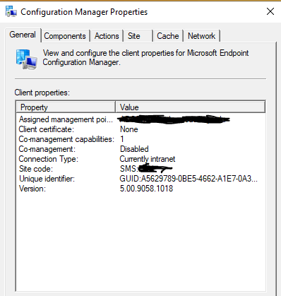

I have it set to the SMS Cert On Both You can see it gets the SMS cert But it does the Regtask forever and never registers the client so it installs and shows Client Certificate None. -

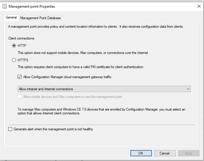

I did; my roles are setup to HTTP Only I have it setup the same as you have listed above. On both Distribution setup the same way -

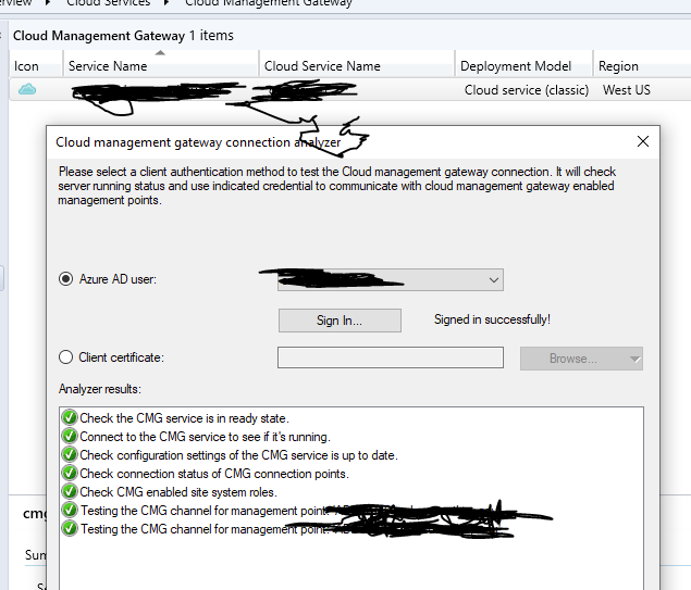

I have my CMG setup correctly test to ensure I have the correct information in the client for the CMG so that is working but this ongoing cert issue. -

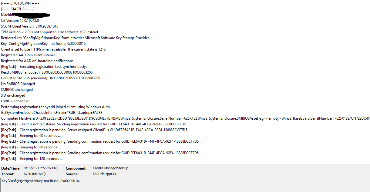

I'm using the CCMclean and doing a fresh install with both the default ie site code And the other with command line ccmsetup.exe /mp=Mine.mine.mine SMSSITECODE=mine Here is what my logs say I am having this issue site wide. Old machines not getting updated certs and fresh installs/test vms all getting the same errors Both of my site servers show they have no client installed as well Almost all my machines are like this Not getting a Client certificate; I see them in SCCM some say Client installed this is not Ture; when i check the pc's I see this CCMexec Site Services are all green; please let me know if you need more info or logs I'm trying to figure this out. I really appreciate your help -

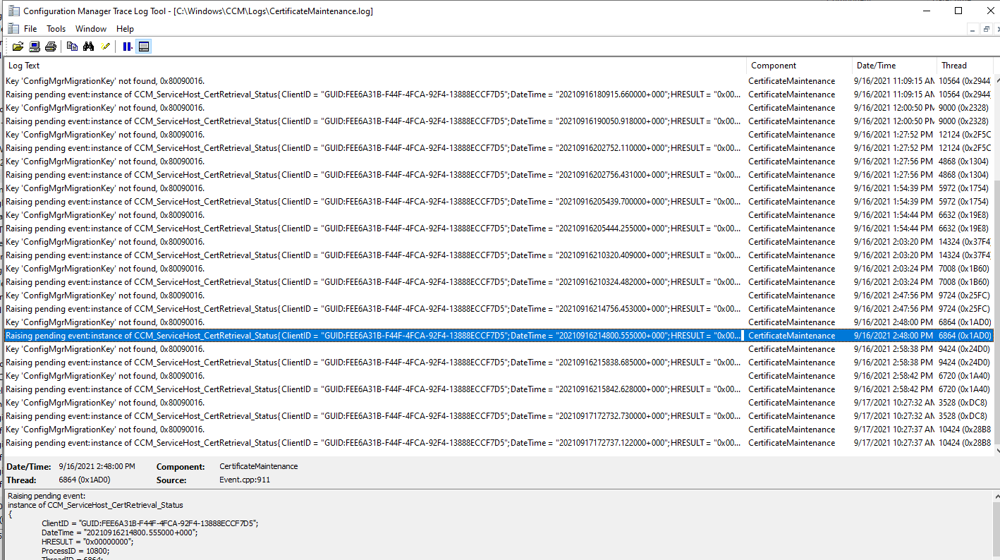

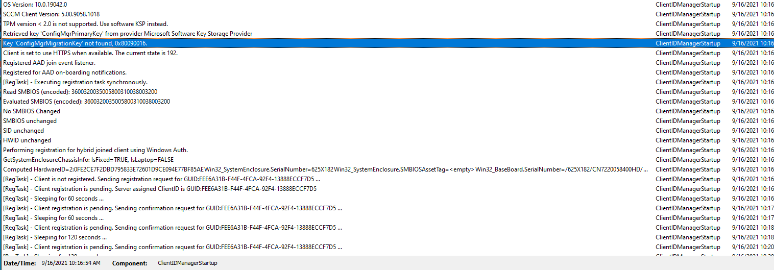

I am trying to use E http and the clients are not getting there certs. I use to get certs and after it expired I deleted the old one; as the system never auto updated it. I am still having this issue with many clients with all of the same error as above SCCM installs but never gets a client cert. I'm stuck with the Key 'ConfigMgrMigrationKey' not found, 0x80090016. ClientIDManagerStartup with no luck fixing it. See above errors -

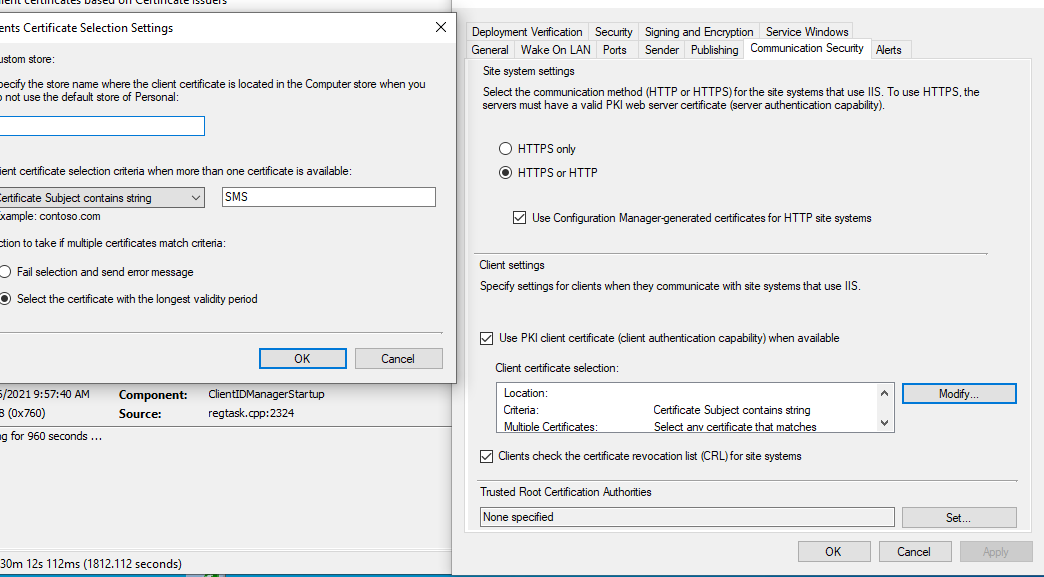

So If I change it to just HTTPS or HTTP check and take off the PKI and CRL uncheck both I also unchecked the Use configuration Manger-Gen cert I get this error This is why I had to setup to look for the SMS cert and it looked like it at least got a cert in the past but same issue with the machine never registering -
Hello New to posting on this forum. I'll try my best My Mp is setup to http When i changed it back I did reboot it. I can d I was having issue with machines losing there certs. Long story short my cert in my MMC store in the SMS folder was expired; I have taken over this 1/2 ass setup and I'm trying my best. I was told that SCCM would automatically update the cert. This is not happening. I have found if I delete the old cert it created a new one. But now I'm still getting these errors I have ensured my boundaries are good but I'm unable to get clients to get certificates I am going by IP addresses not subnet. This is happening for new and old clients. http://mysccm/sms_mp/.sms_aut?mplist goes to the XML file on both of my servers http://mysccm/sms_mp/.sms_aut?mpcert works on both of my servers goes the the MPcertificate path with the long text I do have it setup a bit strange I'm doing the point the SMS and use PKI if it's there. I have tired it every other way and none of the ways work for me. I have tired it like every single way and this way I can get a cert and it register but it never registers the client so I get the SCCM to install Client Cert shows None and my Software store doesn't work won't update ect. Let me know if you need more logs or info. This has been such a paint to figure out.
