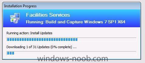

It's not that, because it was working just fine before. I can't remember now if I somehow went in and decided I knew better and tweaked the B&C Task Squence from what Niall has in his guide or what. I also think it has something to do with teh updates themselves. I went ahead and deleted the Updates stuff from teh guide and re-created that part. I created a new B&C TS. I started the VM this morning and selected the new B&C and it's in the beginning phase of doingt teh Capturing Step right now, which is past the Install Updates phase. So, I think I might have this thing worked out. I was nervous for a while because it was stuck at 6 of 36 for a long time. I can only guess it was a big update like .net4 or something, but it seems to be progressing now. I will say this though, it takes forever to capture this plain jane image. Not sure if it's the VM I have SCCM 2012 installed in or what. Thanks for ths suggestion.

I have started over again, and went back to do a fresh new Win7 Build & Capture and I am stuck at the Install Updates screen. It shows 1 of 31, and I have watched it stay here twice for over an hour each time before I stopped the virtual machine and started over. What have I done to break this? Is there a log stored on this VM that I can get to and review to detect what the problem is while it's stuck on this screen? If so, how, where is it and what is the file? Thanks for your help.

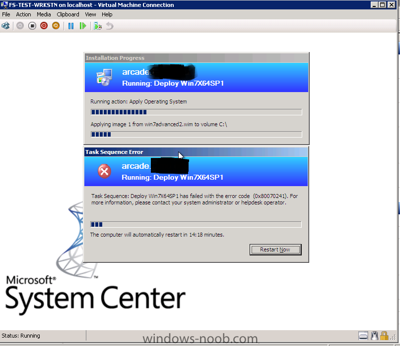

Sorry, I found another post of yours in the forums which pointed me in teh right direction. I was skipping the Win PE boot part. I have since gotten in, and have a command prompt up and a drive mapped to my server and successfully copied the sms log file. So, I have started the imaging process again, and when I get to that error, I'll just press enter in the command window as I have the copy command ready to go. At that point, I'll try and look over the log, but might need to email you or post it here to get some added help. Thanks again.

I don't know how to check the smsts.log file. Someone here on campus told me to press F8 to get to it when booting teh failed computer. However, this is a VH, and once it gets past the PXE menu all I get is the BOOTMGR file is missing screen. I have tried pressing F8, Shift-F8 at all different times during the boot process to no avail. As for the binary differentual being enabled; yes the checkbox is checked on the Operating System Image on teh Data Source tab.

I followed all teh docs just fine. I have a working WDS server in my production environment, so I want to use the image I deploy there insode my test environment. So, I copied teh wim file over, imported it, and all looks well. I can PXE boot and select it. Everything seems to be working right until I get the message below. It partitions and formats the C: and then copies the image down and then starts the apply image phase. Everything looks ok, and then it gets to the 5 blue bars and I get a Task Sequence Error. I have researched the error code for a week and can't seem to figure this one out. Why does it deploy fine inside my WDS server, but does not deploy fine here? Any help is very much appreciated as this is a critical piece for us moving to SCCM 2012 when it becomes RTM. Thanks.

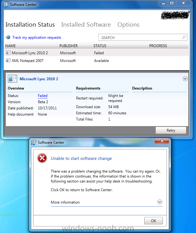

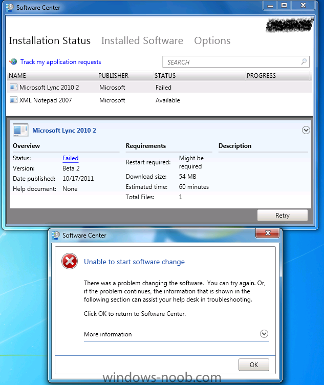

I am having problems trying to install the Lync 201 client via the msi file. I have successfully deployed the XML Notepad msi file, so I know the system works. I have setup the Lync 2010 Client exactly as the XML Notepad, and I get the error attached in this screen shot. The user that is logged into the computer I am trying this on, Windows 7 X64 Ent., is just a domain user account. Since this is what it will be when I push it out to the masses, I wanted to replicate this in my test environment. So, what am I doing wrong that I get this error message? Thanks.
