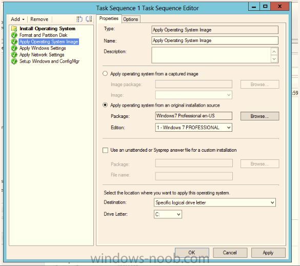

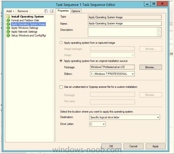

  1. here is a screen shot of my TS
  2. I am new to sccm 2012 have some experience of sccm 2007, My Test server setup at the moment is Server 2012 which is the DC running the SQL and SCCM 2012, I know not the ideal setup but this is jsut for testing. My Task sequence is set to build a machine using "Apply Operating System From Original Installer Source" I have have everything copied to the DP but when the ts runs is spends a bit of time formatting the HDD and then flys through the other steps and then reboots leaving me with no error codes could some have a look at the log file attach and advise me as to wear I am going wrong. <![LOG[LOGGING: Finalize process ID set to 732]LOG]!><time="13:07:29.745+480" date="03-05-2014" component="TSBootShell" context="" type="1" thread="736" file="tslogging.cpp:1495"> <![LOG[==============================[ TSBootShell.exe ]==============================]LOG]!><time="13:07:29.745+480" date="03-05-2014" component="TSBootShell" context="" type="1" thread="736" file="bootshell.cpp:1052"> <![LOG[succeeded loading resource DLL 'X:\sms\bin\x64\1033\TSRES.DLL']LOG]!><time="13:07:29.745+480" date="03-05-2014" component="TSBootShell" context="" type="1" thread="736" file="util.cpp:963"> <![LOG[Debug shell is enabled]LOG]!><time="13:07:29.745+480" date="03-05-2014" component="TSBootShell" context="" type="1" thread="736" file="bootshell.cpp:1063"> <![LOG[Waiting for PNP initialization...]LOG]!><time="13:07:29.792+480" date="03-05-2014" component="TSBootShell" context="" type="1" thread="748" file="bootshell.cpp:60"> <![LOG[RAM Disk Boot Path: NET(0)\SMSIMAGES\SPF00005\BOOT.SPF00005.WIM]LOG]!><time="13:07:29.792+480" date="03-05-2014" component="TSBootShell" context="" type="1" thread="748" file="configpath.cpp:186"> <![LOG[booted from network (PXE)]LOG]!><time="13:07:29.792+480" date="03-05-2014" component="TSBootShell" context="" type="1" thread="748" file="configpath.cpp:201"> <![LOG[Network(PXE) path: X:\sms\data\]LOG]!><time="13:07:29.792+480" date="03-05-2014" component="TSBootShell" context="" type="1" thread="748" file="configpath.cpp:203"> <![LOG[Found config path X:\sms\data\]LOG]!><time="13:07:29.792+480" date="03-05-2014" component="TSBootShell" context="" type="1" thread="748" file="bootshell.cpp:545"> <![LOG[booting from removable media, not restoring bootloaders on hard drive]LOG]!><time="13:07:29.792+480" date="03-05-2014" component="TSBootShell" context="" type="1" thread="748" file="bootshell.cpp:579"> <![LOG[X:\sms\data\WinPE does not exist.]LOG]!><time="13:07:29.792+480" date="03-05-2014" component="TSBootShell" context="" type="1" thread="748" file="bootshell.cpp:596"> <![LOG[X:\_SmsTsWinPE\WinPE does not exist.]LOG]!><time="13:07:29.792+480" date="03-05-2014" component="TSBootShell" context="" type="1" thread="748" file="bootshell.cpp:610"> <![LOG[Executing command line: wpeinit.exe -winpe]LOG]!><time="13:07:29.792+480" date="03-05-2014" component="TSBootShell" context="" type="1" thread="748" file="bootshell.cpp:857"> <![LOG[The command completed successfully.]LOG]!><time="13:07:40.779+480" date="03-05-2014" component="TSBootShell" context="" type="1" thread="748" file="bootshell.cpp:939"> <![LOG[starting DNS client service.]LOG]!><time="13:07:40.779+480" date="03-05-2014" component="TSBootShell" context="" type="1" thread="748" file="bootshell.cpp:663"> <![LOG[Executing command line: X:\sms\bin\x64\TsmBootstrap.exe /env:WinPE /configpath:X:\sms\data\]LOG]!><time="13:07:41.293+480" date="03-05-2014" component="TSBootShell" context="" type="1" thread="748" file="bootshell.cpp:857"> <![LOG[The command completed successfully.]LOG]!><time="13:07:41.293+480" date="03-05-2014" component="TSBootShell" context="" type="1" thread="748" file="bootshell.cpp:939"> <![LOG[==============================[ TSMBootStrap.exe ]==============================]LOG]!><time="13:07:41.402+480" date="03-05-2014" component="TSMBootstrap" context="" type="1" thread="520" file="tsmbootstrap.cpp:1129"> <![LOG[Command line: X:\sms\bin\x64\TsmBootstrap.exe /env:WinPE /configpath:X:\sms\data\]LOG]!><time="13:07:41.402+480" date="03-05-2014" component="TSMBootstrap" context="" type="0" thread="520" file="tsmbootstrap.cpp:1130"> <![LOG[succeeded loading resource DLL 'X:\sms\bin\x64\1033\TSRES.DLL']LOG]!><time="13:07:41.402+480" date="03-05-2014" component="TSMBootstrap" context="" type="1" thread="520" file="util.cpp:963"> <![LOG[succeeded loading resource DLL 'X:\sms\bin\x64\TSRESNLC.DLL']LOG]!><time="13:07:41.402+480" date="03-05-2014" component="TSMBootstrap" context="" type="1" thread="520" file="resourceutils.cpp:169"> <![LOG[Adding SMS bin folder "X:\sms\bin\x64" to the system environment PATH]LOG]!><time="13:07:41.417+480" date="03-05-2014" component="TSMBootstrap" context="" type="0" thread="520" file="tsmbootstrap.cpp:963"> <![LOG[PXE Boot with Root = X:\]LOG]!><time="13:07:41.417+480" date="03-05-2014" component="TSMBootstrap" context="" type="1" thread="520" file="tsmbootstrap.cpp:1062"> <![LOG[Executing from PXE in WinPE]LOG]!><time="13:07:41.417+480" date="03-05-2014" component="TSMBootstrap" context="" type="1" thread="520" file="tsmbootstrap.cpp:1077"> <![LOG[Loading TsPxe.dll from X:\sms\bin\x64\TsPxe.dll]LOG]!><time="13:07:41.417+480" date="03-05-2014" component="TSMBootstrap" context="" type="0" thread="520" file="tsmbootstraputil.cpp:1320"> <![LOG[TsPxe.dll loaded]LOG]!><time="13:07:41.433+480" date="03-05-2014" component="TSPxe" context="" type="0" thread="520" file="tsmbootstraputil.cpp:1330"> <![LOG[Device has PXE booted]LOG]!><time="13:07:41.433+480" date="03-05-2014" component="TSPxe" context="" type="0" thread="520" file="tspxe.cpp:122"> <![LOG[Variable Path: \SMSTemp\2014.03.05.10.55.26.0008.{0E5C83DB-85AD-4344-A5EC-9CD47416D44A}.boot.var]LOG]!><time="13:07:41.433+480" date="03-05-2014" component="TSPxe" context="" type="0" thread="520" file="tspxe.cpp:134"> <![LOG[succesfully added firewall rule for Tftp]LOG]!><time="13:07:41.449+480" date="03-05-2014" component="TSPxe" context="" type="0" thread="520" file="fwopen.cpp:123"> <![LOG[Executing: X:\sms\bin\x64\smstftp.exe -i 10.100.43.50 get \SMSTemp\2014.03.05.10.55.26.0008.{0E5C83DB-85AD-4344-A5EC-9CD47416D44A}.boot.var X:\sms\data\variables.dat]LOG]!><time="13:07:41.449+480" date="03-05-2014" component="TSPxe" context="" type="0" thread="520" file="tspxe.cpp:177"> <![LOG[Command line for extension .exe is "%1" %*]LOG]!><time="13:07:41.527+480" date="03-05-2014" component="TSPxe" context="" type="0" thread="520" file="commandline.cpp:228"> <![LOG[set command line: "X:\sms\bin\x64\smstftp.exe" -i 10.100.43.50 get \SMSTemp\2014.03.05.10.55.26.0008.{0E5C83DB-85AD-4344-A5EC-9CD47416D44A}.boot.var X:\sms\data\variables.dat]LOG]!><time="13:07:41.527+480" date="03-05-2014" component="TSPxe" context="" type="0" thread="520" file="commandline.cpp:731"> <![LOG[Executing command line: "X:\sms\bin\x64\smstftp.exe" -i 10.100.43.50 get \SMSTemp\2014.03.05.10.55.26.0008.{0E5C83DB-85AD-4344-A5EC-9CD47416D44A}.boot.var X:\sms\data\variables.dat]LOG]!><time="13:07:41.527+480" date="03-05-2014" component="TSPxe" context="" type="1" thread="520" file="commandline.cpp:827"> <![LOG[Process completed with exit code 0]LOG]!><time="13:07:41.636+480" date="03-05-2014" component="TSPxe" context="" type="1" thread="520" file="commandline.cpp:1123"> <![LOG[succesfully removed firewall rule for Tftp]LOG]!><time="13:07:41.651+480" date="03-05-2014" component="TSPxe" context="" type="0" thread="520" file="fwopen.cpp:146"> <![LOG[successfully downloaded pxe variable file.]LOG]!><time="13:07:41.651+480" date="03-05-2014" component="TSPxe" context="" type="1" thread="520" file="tspxe.cpp:187"> <![LOG[we are booted using PXE]LOG]!><time="13:07:41.651+480" date="03-05-2014" component="TSPxe" context="" type="1" thread="520" file="tsmediawizardcontrol.cpp:2629"> <![LOG[we are booted using PXE and we don't use a password or the password is provided by the user]LOG]!><time="13:07:41.651+480" date="03-05-2014" component="TSPxe" context="" type="1" thread="520" file="tsmediawizardcontrol.cpp:2645"> <![LOG[Found network adapter "Broadcom NetLink Gigabit Ethernet" with IP Address 10.100.43.100.]LOG]!><time="13:07:41.651+480" date="03-05-2014" component="TSPxe" context="" type="0" thread="520" file="tsmbootstraputil.cpp:474"> <![LOG[Run PXE Interactive]LOG]!><time="13:07:41.651+480" date="03-05-2014" component="TSPxe" context="" type="0" thread="520" file="tsmediawizardcontrol.cpp:2780"> <![LOG[Running Wizard in Interactive mode]LOG]!><time="13:07:41.651+480" date="03-05-2014" component="TSPxe" context="" type="1" thread="520" file="tsmediawizardcontrol.cpp:2782"> <![LOG[Loading Media Variables from "X:\sms\data\variables.dat"]LOG]!><time="13:07:41.667+480" date="03-05-2014" component="TSPxe" context="" type="1" thread="520" file="tsremovablemedia.cpp:322"> <![LOG[CryptDecrypt (hKey, 0, 1, 0, pData, &dwDecryptedLen), HRESULT=80090005 (e:\nts_sccm_release\sms\framework\smscrypt\windes.cpp,165)]LOG]!><time="13:07:41.667+480" date="03-05-2014" component="TSPxe" context="" type="0" thread="520" file="windes.cpp:165"> <![LOG[sMS::Crypto::DES::DecryptBuffer( (BYTE*)pszPassword, (DWORD)(wcslen(pszPassword)*sizeof(WCHAR)), encryptedBuffer.getBuffer(), (DWORD)encryptedBuffer.size(), pbDecryptedBuffer, dwDecryptedBufferSize ), HRESULT=80090005 (e:\nts_sccm_release\sms\framework\tscore\tsremovablemedia.cpp,387)]LOG]!><time="13:07:41.667+480" date="03-05-2014" component="TSPxe" context="" type="0" thread="520" file="tsremovablemedia.cpp:387"> <![LOG[Activating Welcome Page.]LOG]!><time="13:07:41.667+480" date="03-05-2014" component="TSPxe" context="" type="0" thread="520" file="tsmediawelcomepage.cpp:131"> <![LOG[Loading bitmap]LOG]!><time="13:07:41.683+480" date="03-05-2014" component="TSPxe" context="" type="1" thread="520" file="tsmbootstrap.cpp:1228"> <![LOG[WelcomePage::OnWizardNext()]LOG]!><time="13:10:04.370+480" date="03-05-2014" component="TSPxe" context="" type="0" thread="520" file="tsmediawelcomepage.cpp:340"> <![LOG[Loading Media Variables from "X:\sms\data\variables.dat"]LOG]!><time="13:10:04.370+480" date="03-05-2014" component="TSPxe" context="" type="1" thread="520" file="tsremovablemedia.cpp:322"> <![LOG[CryptDecrypt (hKey, 0, 1, 0, pData, &dwDecryptedLen), HRESULT=80090005 (e:\nts_sccm_release\sms\framework\smscrypt\windes.cpp,165)]LOG]!><time="13:10:04.370+480" date="03-05-2014" component="TSPxe" context="" type="0" thread="520" file="windes.cpp:165"> <![LOG[sMS::Crypto::DES::DecryptBuffer( (BYTE*)pszPassword, (DWORD)(wcslen(pszPassword)*sizeof(WCHAR)), encryptedBuffer.getBuffer(), (DWORD)encryptedBuffer.size(), pbDecryptedBuffer, dwDecryptedBufferSize ), HRESULT=80090005 (e:\nts_sccm_release\sms\framework\tscore\tsremovablemedia.cpp,387)]LOG]!><time="13:10:04.370+480" date="03-05-2014" component="TSPxe" context="" type="0" thread="520" file="tsremovablemedia.cpp:387"> <![LOG[Loading Media Variables from "X:\sms\data\variables.dat"]LOG]!><time="13:10:04.370+480" date="03-05-2014" component="TSPxe" context="" type="1" thread="520" file="tsremovablemedia.cpp:322"> <![LOG[CryptDecrypt (hKey, 0, 1, 0, pData, &dwDecryptedLen), HRESULT=80090005 (e:\nts_sccm_release\sms\framework\smscrypt\windes.cpp,165)]LOG]!><time="13:10:04.370+480" date="03-05-2014" component="TSPxe" context="" type="0" thread="520" file="windes.cpp:165"> <![LOG[sMS::Crypto::DES::DecryptBuffer( (BYTE*)pszPassword, (DWORD)(wcslen(pszPassword)*sizeof(WCHAR)), encryptedBuffer.getBuffer(), (DWORD)encryptedBuffer.size(), pbDecryptedBuffer, dwDecryptedBufferSize ), HRESULT=80090005 (e:\nts_sccm_release\sms\framework\tscore\tsremovablemedia.cpp,387)]LOG]!><time="13:10:04.370+480" date="03-05-2014" component="TSPxe" context="" type="0" thread="520" file="tsremovablemedia.cpp:387"> <![LOG[Verifying media password.]LOG]!><time="13:10:04.370+480" date="03-05-2014" component="TSPxe" context="" type="1" thread="520" file="tsmediawizardcontrol.cpp:271"> <![LOG[Loading Media Variables from "X:\sms\data\variables.dat"]LOG]!><time="13:10:04.370+480" date="03-05-2014" component="TSPxe" context="" type="1" thread="520" file="tsremovablemedia.cpp:322"> <![LOG[spawned thread 1012 to download policy.]LOG]!><time="13:10:04.432+480" date="03-05-2014" component="TSPxe" context="" type="1" thread="520" file="tsmediawelcomepage.cpp:405"> <![LOG[Entering TSMediaWizardControl::GetPolicy.]LOG]!><time="13:10:04.432+480" date="03-05-2014" component="TSPxe" context="" type="0" thread="1012" file="tsmediawizardcontrol.cpp:527"> <![LOG[Creating key 'Software\Microsoft\SMS\47006C006F00620061006C005C007B00350031004100300031003600420036002D0046003000440045002D0034003700350032002D0042003900370043002D003500340045003600460033003800360041003900310032007D00']LOG]!><time="13:10:04.432+480" date="03-05-2014" component="TSPxe" context="" type="1" thread="1012" file="environmentscope.cpp:284"> <![LOG[Environment scope successfully created: Global\{51A016B6-F0DE-4752-B97C-54E6F386A912}]LOG]!><time="13:10:04.432+480" date="03-05-2014" component="TSPxe" context="" type="1" thread="1012" file="environmentscope.cpp:659"> <![LOG[Creating key 'Software\Microsoft\SMS\47006C006F00620061006C005C007B00420041003300410033003900300030002D0043004100360044002D0034006100630031002D0038004300320038002D003500300037003300410046004300320032004200300033007D00']LOG]!><time="13:10:04.432+480" date="03-05-2014" component="TSPxe" context="" type="1" thread="1012" file="environmentscope.cpp:284"> <![LOG[Environment scope successfully created: Global\{BA3A3900-CA6D-4ac1-8C28-5073AFC22B03}]LOG]!><time="13:10:04.432+480" date="03-05-2014" component="TSPxe" context="" type="1" thread="1012" file="environmentscope.cpp:659"> <![LOG[setting LogMaxSize to 1000000]LOG]!><time="13:10:04.432+480" date="03-05-2014" component="TSPxe" context="" type="1" thread="1012" file="tsmediawizardcontrol.cpp:555"> <![LOG[setting LogMaxHistory to 1]LOG]!><time="13:10:04.432+480" date="03-05-2014" component="TSPxe" context="" type="1" thread="1012" file="tsmediawizardcontrol.cpp:556"> <![LOG[setting LogLevel to 0]LOG]!><time="13:10:04.432+480" date="03-05-2014" component="TSPxe" context="" type="1" thread="1012" file="tsmediawizardcontrol.cpp:557"> <![LOG[setting LogEnabled to 1]LOG]!><time="13:10:04.432+480" date="03-05-2014" component="TSPxe" context="" type="1" thread="1012" file="tsmediawizardcontrol.cpp:558"> <![LOG[setting LogDebug to 1]LOG]!><time="13:10:04.432+480" date="03-05-2014" component="TSPxe" context="" type="1" thread="1012" file="tsmediawizardcontrol.cpp:559"> <![LOG[uEFI: false]LOG]!><time="13:10:04.432+480" date="03-05-2014" component="TSPxe" context="" type="1" thread="1012" file="tsmediawizardcontrol.cpp:569"> <![LOG[Loading variables from the Task Sequencing Removable Media.]LOG]!><time="13:10:04.432+480" date="03-05-2014" component="TSPxe" context="" type="1" thread="1012" file="tsmediawizardcontrol.cpp:584"> <![LOG[Loading Media Variables from "X:\sms\data\variables.dat"]LOG]!><time="13:10:04.432+480" date="03-05-2014" component="TSPxe" context="" type="1" thread="1012" file="tsremovablemedia.cpp:322"> <![LOG[succeeded loading resource DLL 'X:\sms\bin\x64\1033\TSRES.DLL']LOG]!><time="13:10:04.448+480" date="03-05-2014" component="TSPxe" context="" type="1" thread="1012" file="util.cpp:963"> <![LOG[setting SMSTSMP TS environment variable]LOG]!><time="13:10:04.448+480" date="03-05-2014" component="TSPxe" context="" type="1" thread="1012" file="tsmediawizardcontrol.cpp:604"> <![LOG[setting _SMSMediaGuid TS environment variable]LOG]!><time="13:10:04.448+480" date="03-05-2014" component="TSPxe" context="" type="1" thread="1012" file="tsmediawizardcontrol.cpp:604"> <![LOG[setting _SMSTSBootMediaPackageID TS environment variable]LOG]!><time="13:10:04.448+480" date="03-05-2014" component="TSPxe" context="" type="1" thread="1012" file="tsmediawizardcontrol.cpp:604"> <![LOG[setting _SMSTSHTTPPort TS environment variable]LOG]!><time="13:10:04.448+480" date="03-05-2014" component="TSPxe" context="" type="1" thread="1012" file="tsmediawizardcontrol.cpp:604"> <![LOG[setting _SMSTSHTTPSPort TS environment variable]LOG]!><time="13:10:04.448+480" date="03-05-2014" component="TSPxe" context="" type="1" thread="1012" file="tsmediawizardcontrol.cpp:604"> <![LOG[setting _SMSTSIISSSLState TS environment variable]LOG]!><time="13:10:04.448+480" date="03-05-2014" component="TSPxe" context="" type="1" thread="1012" file="tsmediawizardcontrol.cpp:604"> <![LOG[setting _SMSTSLaunchMode TS environment variable]LOG]!><time="13:10:04.448+480" date="03-05-2014" component="TSPxe" context="" type="1" thread="1012" file="tsmediawizardcontrol.cpp:604"> <![LOG[setting _SMSTSMediaPFX TS environment variable]LOG]!><time="13:10:04.448+480" date="03-05-2014" component="TSPxe" context="" type="1" thread="1012" file="tsmediawizardcontrol.cpp:604"> <![LOG[setting _SMSTSPublicRootKey TS environment variable]LOG]!><time="13:10:04.448+480" date="03-05-2014" component="TSPxe" context="" type="1" thread="1012" file="tsmediawizardcontrol.cpp:604"> <![LOG[setting _SMSTSSiteCode TS environment variable]LOG]!><time="13:10:04.448+480" date="03-05-2014" component="TSPxe" context="" type="1" thread="1012" file="tsmediawizardcontrol.cpp:604"> <![LOG[setting _SMSTSSiteSigningCertificate TS environment variable]LOG]!><time="13:10:04.448+480" date="03-05-2014" component="TSPxe" context="" type="1" thread="1012" file="tsmediawizardcontrol.cpp:604"> <![LOG[setting _SMSTSUseFirstCert TS environment variable]LOG]!><time="13:10:04.448+480" date="03-05-2014" component="TSPxe" context="" type="1" thread="1012" file="tsmediawizardcontrol.cpp:604"> <![LOG[setting _SMSTSx64UnknownMachineGUID TS environment variable]LOG]!><time="13:10:04.448+480" date="03-05-2014" component="TSPxe" context="" type="1" thread="1012" file="tsmediawizardcontrol.cpp:604"> <![LOG[setting _SMSTSx86UnknownMachineGUID TS environment variable]LOG]!><time="13:10:04.448+480" date="03-05-2014" component="TSPxe" context="" type="1" thread="1012" file="tsmediawizardcontrol.cpp:604"> <![LOG[Root CA Public Certs=]LOG]!><time="13:10:04.448+480" date="03-05-2014" component="TSPxe" context="" type="1" thread="1012" file="tsmediawizardcontrol.cpp:615"> <![LOG[Missing root CA environment variable from variables file]LOG]!><time="13:10:04.448+480" date="03-05-2014" component="TSPxe" context="" type="1" thread="1012" file="tsmediawizardcontrol.cpp:621"> <![LOG[support Unknown Machines: 0]LOG]!><time="13:10:04.448+480" date="03-05-2014" component="TSPxe" context="" type="1" thread="1012" file="tsmediawizardcontrol.cpp:632"> <![LOG[Custom hook from X:\\TSConfig.INI is ]LOG]!><time="13:10:04.448+480" date="03-05-2014" component="TSPxe" context="" type="1" thread="1012" file="tsmediawizardcontrol.cpp:675"> <![LOG[No hook is found to be executed before downloading policy]LOG]!><time="13:10:04.448+480" date="03-05-2014" component="TSPxe" context="" type="1" thread="1012" file="tsmediawizardcontrol.cpp:699"> <![LOG[Authenticator from the environment is empty.]LOG]!><time="13:10:04.463+480" date="03-05-2014" component="TSPxe" context="" type="1" thread="1012" file="tsmediawizardcontrol.cpp:838"> <![LOG[Need to create Authenticator Info using PFX]LOG]!><time="13:10:04.463+480" date="03-05-2014" component="TSPxe" context="" type="1" thread="1012" file="tsmediawizardcontrol.cpp:850"> <![LOG[initialized CStringStream object with string: {B407B519-EA17-4C2A-85B7-092713FFBF40};2014-03-05T21:10:04Z.]LOG]!><time="13:10:04.557+480" date="03-05-2014" component="TSPxe" context="" type="0" thread="1012" file="stringstream.cpp:101"> <![LOG[set media certificate in transport]LOG]!><time="13:10:04.604+480" date="03-05-2014" component="TSPxe" context="" type="0" thread="1012" file="libsmsmessaging.cpp:9418"> <![LOG[set authenticator in transport]LOG]!><time="13:10:04.604+480" date="03-05-2014" component="TSPxe" context="" type="0" thread="1012" file="libsmsmessaging.cpp:7751"> <![LOG[CLibSMSMessageWinHttpTransport::Send: URL: SV-DCSCCM-01.spitfire.local:80 GET /SMS_MP/.sms_aut?MPKEYINFORMATIONMEDIA]LOG]!><time="13:10:04.619+480" date="03-05-2014" component="TSPxe" context="" type="1" thread="1012" file="libsmsmessaging.cpp:8621"> <![LOG[Request was succesful.]LOG]!><time="13:10:04.682+480" date="03-05-2014" component="TSPxe" context="" type="0" thread="1012" file="libsmsmessaging.cpp:8956"> <![LOG[Default CSP is Microsoft Enhanced RSA and AES Cryptographic Provider]LOG]!><time="13:10:04.682+480" date="03-05-2014" component="TSPxe" context="" type="0" thread="1012" file="libcrypt.cpp:1904"> <![LOG[Default CSP Type is 24]LOG]!><time="13:10:04.682+480" date="03-05-2014" component="TSPxe" context="" type="0" thread="1012" file="libcrypt.cpp:1905"> <![LOG[New settings:]LOG]!><time="13:10:04.697+480" date="03-05-2014" component="TSPxe" context="" type="1" thread="1012" file="tsmediawizardcontrol.cpp:925"> <![LOG[ site=SPF,SPF, MP=http://SV-DCSCCM-01.spitfire.local, ports: http=80,https=443]LOG]!><time="13:10:04.697+480" date="03-05-2014" component="TSPxe" context="" type="1" thread="1012" file="tsmediawizardcontrol.cpp:927"> <![LOG[ certificates are received from MP.]LOG]!><time="13:10:04.697+480" date="03-05-2014" component="TSPxe" context="" type="1" thread="1012" file="tsmediawizardcontrol.cpp:931"> <![LOG[unknown machine GUIDs: d41d77d8-2d65-40da-8941-ae6b5ebdd2ad 6d4ab1d2-42e8-4fb8-bef2-141ff84f0757]LOG]!><time="13:10:04.697+480" date="03-05-2014" component="TSPxe" context="" type="1" thread="1012" file="tsmediawizardcontrol.cpp:986"> <![LOG[Getting MP time information]LOG]!><time="13:10:04.697+480" date="03-05-2014" component="TSPxe" context="" type="1" thread="1012" file="tsmediawizardcontrol.cpp:1021"> <![LOG[set authenticator in transport]LOG]!><time="13:10:04.697+480" date="03-05-2014" component="TSPxe" context="" type="0" thread="1012" file="libsmsmessaging.cpp:7751"> <![LOG[Requesting client identity]LOG]!><time="13:10:04.744+480" date="03-05-2014" component="TSPxe" context="" type="1" thread="1012" file="libsmsmessaging.cpp:5760"> <![LOG[setting message signatures.]LOG]!><time="13:10:04.760+480" date="03-05-2014" component="TSPxe" context="" type="0" thread="1012" file="libsmsmessaging.cpp:1297"> <![LOG[setting the authenticator.]LOG]!><time="13:10:04.760+480" date="03-05-2014" component="TSPxe" context="" type="0" thread="1012" file="libsmsmessaging.cpp:1327"> <![LOG[CLibSMSMessageWinHttpTransport::Send: URL: SV-DCSCCM-01.spitfire.local:80 CCM_POST /ccm_system/request]LOG]!><time="13:10:04.760+480" date="03-05-2014" component="TSPxe" context="" type="1" thread="1012" file="libsmsmessaging.cpp:8621"> <![LOG[Request was succesful.]LOG]!><time="13:10:04.775+480" date="03-05-2014" component="TSPxe" context="" type="0" thread="1012" file="libsmsmessaging.cpp:8956"> <![LOG[::DecompressBuffer(65536)]LOG]!><time="13:10:04.791+480" date="03-05-2014" component="TSPxe" context="" type="0" thread="1012" file="ccmzlib.cpp:739"> <![LOG[Decompression (zlib) succeeded: original size 430, uncompressed size 2536.]LOG]!><time="13:10:04.791+480" date="03-05-2014" component="TSPxe" context="" type="0" thread="1012" file="ccmzlib.cpp:651"> <![LOG[-60 -60]LOG]!><time="13:10:04.791+480" date="03-05-2014" component="TSPxe" context="" type="1" thread="1012" file="libsmsmessaging.cpp:5956"> <![LOG[server time zone info: 0, , [0 10 0 5 2 0 0 0], 0, , [0 3 0 5 1 0 0 0], -60]LOG]!><time="13:10:04.791+480" date="03-05-2014" component="TSPxe" context="" type="1" thread="1012" file="libsmsmessaging.cpp:6055"> <![LOG[Client Identity: ]LOG]!><time="13:10:04.791+480" date="03-05-2014" component="TSPxe" context="" type="1" thread="1012" file="libsmsmessaging.cpp:6140"> <![LOG[Netbios name: ]LOG]!><time="13:10:04.791+480" date="03-05-2014" component="TSPxe" context="" type="1" thread="1012" file="libsmsmessaging.cpp:6156"> <![LOG[Current time: 2014-03-05 21:10:04.791 TZ:Pacific Standard Time Bias:0480]LOG]!><time="13:10:04.791+480" date="03-05-2014" component="TSPxe" context="" type="1" thread="1012" file="tsmediawizardcontrol.cpp:1090"> <![LOG[Current time zone info: 480, Pacific Standard Time, [0 0 0 0 0 0 0 0], 0, , [0 0 0 0 0 0 0 0], 0]LOG]!><time="13:10:04.791+480" date="03-05-2014" component="TSPxe" context="" type="1" thread="1012" file="tsmediawizardcontrol.cpp:1118"> <![LOG[Adjusting the system time: -28799.315 seconds]LOG]!><time="13:10:04.791+480" date="03-05-2014" component="TSPxe" context="" type="1" thread="1012" file="tsmediawizardcontrol.cpp:1120"> <![LOG[Time zone info set to: 0, , [0 10 0 5 2 0 0 0], 0, , [0 3 0 5 1 0 0 0], -60]LOG]!><time="21:10:04.791+00" date="03-05-2014" component="TSPxe" context="" type="1" thread="1012" file="tsmediawizardcontrol.cpp:1156"> <![LOG[New time: 2014-03-05 13:10:05.475]LOG]!><time="13:10:05.464+00" date="03-05-2014" component="TSPxe" context="" type="1" thread="1012" file="tsmediawizardcontrol.cpp:1172"> <![LOG[Current time: 2014-03-05 13:10:05.464 TZ: Bias:0000]LOG]!><time="13:10:05.464+00" date="03-05-2014" component="TSPxe" context="" type="1" thread="1012" file="tsmediawizardcontrol.cpp:1178"> <![LOG[Downloading policy from http://SV-DCSCCM-01.spitfire.local.]LOG]!><time="13:10:05.500+00" date="03-05-2014" component="TSPxe" context="" type="1" thread="1012" file="tsmediawizardcontrol.cpp:1185"> <![LOG[initializing HTTP transport.]LOG]!><time="13:10:05.500+00" date="03-05-2014" component="TSPxe" context="" type="0" thread="1012" file="tspolicy.cpp:817"> <![LOG[ Setting URL = http://SV-DCSCCM-01.spitfire.local.]LOG]!><time="13:10:05.500+00" date="03-05-2014" component="TSPxe" context="" type="0" thread="1012" file="tspolicy.cpp:818"> <![LOG[ Setting Ports = 80,443.]LOG]!><time="13:10:05.500+00" date="03-05-2014" component="TSPxe" context="" type="0" thread="1012" file="tspolicy.cpp:821"> <![LOG[ Setting CRL = false.]LOG]!><time="13:10:05.500+00" date="03-05-2014" component="TSPxe" context="" type="0" thread="1012" file="tspolicy.cpp:824"> <![LOG[ Setting Server Certificates.]LOG]!><time="13:10:05.500+00" date="03-05-2014" component="TSPxe" context="" type="0" thread="1012" file="tspolicy.cpp:841"> <![LOG[set authenticator in transport]LOG]!><time="13:10:05.500+00" date="03-05-2014" component="TSPxe" context="" type="0" thread="1012" file="libsmsmessaging.cpp:7751"> <![LOG[ Setting Media Certificate.]LOG]!><time="13:10:05.500+00" date="03-05-2014" component="TSPxe" context="" type="0" thread="1012" file="tspolicy.cpp:849"> <![LOG[Preparing Client Identity Request.]LOG]!><time="13:10:05.546+00" date="03-05-2014" component="TSPxe" context="" type="0" thread="1012" file="tspolicy.cpp:583"> <![LOG[ Setting transport.]LOG]!><time="13:10:05.546+00" date="03-05-2014" component="TSPxe" context="" type="0" thread="1012" file="tspolicy.cpp:586"> <![LOG[ Setting SourceID = {B407B519-EA17-4C2A-85B7-092713FFBF40}.]LOG]!><time="13:10:05.546+00" date="03-05-2014" component="TSPxe" context="" type="0" thread="1012" file="tspolicy.cpp:590"> <![LOG[ Setting site code = SPF.]LOG]!><time="13:10:05.546+00" date="03-05-2014" component="TSPxe" context="" type="0" thread="1012" file="tspolicy.cpp:595"> <![LOG[Can not find DeploymentType in file TsmBootstrap.ini or the file doesn't exist. This is not running on Windows To Go.]LOG]!><time="13:10:05.546+00" date="03-05-2014" component="TSPxe" context="" type="1" thread="1012" file="utils.cpp:1314"> <![LOG[ Setting SMBIOS GUID = 815DA2F2-2A4A-CB11-834A-A75C285CF24F.]LOG]!><time="13:10:06.326+00" date="03-05-2014" component="TSPxe" context="" type="0" thread="1012" file="tspolicy.cpp:623"> <![LOG[ Adding MAC Address 00:1C:25:95:E4:93.]LOG]!><time="13:10:06.373+00" date="03-05-2014" component="TSPxe" context="" type="0" thread="1012" file="tspolicy.cpp:642"> <![LOG[Executing Client Identity Request.]LOG]!><time="13:10:06.373+00" date="03-05-2014" component="TSPxe" context="" type="0" thread="1012" file="tspolicy.cpp:666"> <![LOG[Requesting client identity]LOG]!><time="13:10:06.373+00" date="03-05-2014" component="TSPxe" context="" type="1" thread="1012" file="libsmsmessaging.cpp:5760"> <![LOG[setting message signatures.]LOG]!><time="13:10:06.389+00" date="03-05-2014" component="TSPxe" context="" type="0" thread="1012" file="libsmsmessaging.cpp:1297"> <![LOG[setting the authenticator.]LOG]!><time="13:10:06.389+00" date="03-05-2014" component="TSPxe" context="" type="0" thread="1012" file="libsmsmessaging.cpp:1327"> <![LOG[CLibSMSMessageWinHttpTransport::Send: URL: SV-DCSCCM-01.spitfire.local:80 CCM_POST /ccm_system/request]LOG]!><time="13:10:06.389+00" date="03-05-2014" component="TSPxe" context="" type="1" thread="1012" file="libsmsmessaging.cpp:8621"> <![LOG[Request was succesful.]LOG]!><time="13:10:06.404+00" date="03-05-2014" component="TSPxe" context="" type="0" thread="1012" file="libsmsmessaging.cpp:8956"> <![LOG[::DecompressBuffer(65536)]LOG]!><time="13:10:06.404+00" date="03-05-2014" component="TSPxe" context="" type="0" thread="1012" file="ccmzlib.cpp:739"> <![LOG[Decompression (zlib) succeeded: original size 429, uncompressed size 2536.]LOG]!><time="13:10:06.404+00" date="03-05-2014" component="TSPxe" context="" type="0" thread="1012" file="ccmzlib.cpp:651"> <![LOG[-60 -60]LOG]!><time="13:10:06.404+00" date="03-05-2014" component="TSPxe" context="" type="1" thread="1012" file="libsmsmessaging.cpp:5956"> <![LOG[server time zone info: 0, , [0 10 0 5 2 0 0 0], 0, , [0 3 0 5 1 0 0 0], -60]LOG]!><time="13:10:06.404+00" date="03-05-2014" component="TSPxe" context="" type="1" thread="1012" file="libsmsmessaging.cpp:6055"> <![LOG[Client Identity: ]LOG]!><time="13:10:06.404+00" date="03-05-2014" component="TSPxe" context="" type="1" thread="1012" file="libsmsmessaging.cpp:6140"> <![LOG[Netbios name: ]LOG]!><time="13:10:06.404+00" date="03-05-2014" component="TSPxe" context="" type="1" thread="1012" file="libsmsmessaging.cpp:6156"> <![LOG[Client GUID = , Netbios name = , State = Known]LOG]!><time="13:10:06.404+00" date="03-05-2014" component="TSPxe" context="" type="0" thread="1012" file="tspolicy.cpp:686"> <![LOG[using unknown machine GUID: 6d4ab1d2-42e8-4fb8-bef2-141ff84f0757]LOG]!><time="13:10:06.404+00" date="03-05-2014" component="TSPxe" context="" type="1" thread="1012" file="tspolicy.cpp:901"> <![LOG[GetSystemEnclosureChassisInfo: IsFixed=TRUE, IsLaptop=TRUE]LOG]!><time="13:10:06.420+00" date="03-05-2014" component="TSPxe" context="" type="1" thread="1012" file="libmachineinfo.cpp:189"> <![LOG[Hash computed from CSP: Microsoft Enhanced RSA and AES Cryptographic Provider, AlgID: 32772, HashSize: 20 ]LOG]!><time="13:10:06.436+00" date="03-05-2014" component="TSPxe" context="" type="0" thread="1012" file="libcrypt.cpp:699"> <![LOG[Computed HardwareID=2:3C79BE89126F022C85DB564212BAFE8C42EEBC63 Win32_SystemEnclosure.SerialNumber=Not Available Win32_SystemEnclosure.SMBIOSAssetTag=No Asset Information Win32_BaseBoard.SerialNumber=VF1XX88P0AG Win32_BIOS.SerialNumber=L3P4050 Win32_NetworkAdapterConfiguration.MACAddress=<Not used on laptop>]LOG]!><time="13:10:06.436+00" date="03-05-2014" component="TSPxe" context="" type="1" thread="1012" file="libmachineinfo.cpp:958"> <![LOG[Hardware ID: 2:3C79BE89126F022C85DB564212BAFE8C42EEBC63]LOG]!><time="13:10:06.436+00" date="03-05-2014" component="TSPxe" context="" type="1" thread="1012" file="tspolicy.cpp:404"> <![LOG[Preparing the Client DDR Message]LOG]!><time="13:10:06.451+00" date="03-05-2014" component="TSPxe" context="" type="0" thread="1012" file="tspolicy.cpp:456"> <![LOG[ Setting SourceID = {B407B519-EA17-4C2A-85B7-092713FFBF40}.]LOG]!><time="13:10:06.451+00" date="03-05-2014" component="TSPxe" context="" type="0" thread="1012" file="tspolicy.cpp:464"> <![LOG[sending the Client DDR message.]LOG]!><time="13:10:06.451+00" date="03-05-2014" component="TSPxe" context="" type="0" thread="1012" file="tspolicy.cpp:546"> <![LOG[sending Report]LOG]!><time="13:10:06.467+00" date="03-05-2014" component="TSPxe" context="" type="1" thread="1012" file="libsmsmessaging.cpp:7099"> <![LOG[<Report><ReportHeader><Identification><Machine><ClientInstalled>0</ClientInstalled><ClientType>1</ClientType><Unknown>1</Unknown><ClientID>GUID:612ad4ce-de06-4eae-8078-cd6861a3529a</ClientID><ClientVersion>5.00.0000.0000</ClientVersion><NetBIOSName>Unknown</NetBIOSName><CodePage>437</CodePage><SystemDefaultLCID>1033</SystemDefaultLCID></Machine></Identification><ReportDetails><ReportContent>Inventory Data</ReportContent><ReportType>Full</ReportType><Date>20140305131006.000000+000</Date><Version>1.0</Version><Format>1.1</Format></ReportDetails><InventoryAction ActionType="Predefined"><InventoryActionID>{00000000-0000-0000-0000-000000000003}</InventoryActionID><Description>Discovery</Description><InventoryActionLastUpdateTime>20140305131006.000000+000</InventoryActionLastUpdateTime></InventoryAction> </ReportHeader> <ReportBody><Instance ParentClass="CCM_ClientIdentificationInformation" Class="CCM_ClientIdentificationInformation" Namespace="root\ccm" Content="New"><CCM_ClientIdentificationInformation><HardwareID1>2:3C79BE89126F022C85DB564212BAFE8C42EEBC63</HardwareID1></CCM_ClientIdentificationInformation></Instance><Instance ParentClass="Win32_NetworkAdapterConfiguration" Class="Win32_NetworkAdapterConfiguration" Namespace="root\cimv2" Content="New"><Win32_NetworkAdapterConfiguration><MACAddress>00:1C:25:95:E4:93</MACAddress></Win32_NetworkAdapterConfiguration></Instance><Instance ParentClass="Win32_ComputerSystemProduct" Class="Win32_ComputerSystemProduct" Namespace="root\cimv2" Content="New"><Win32_ComputerSystemProduct><UUID>815DA2F2-2A4A-CB11-834A-A75C285CF24F</UUID></Win32_ComputerSystemProduct></Instance></ReportBody> </Report> ]LOG]!><time="13:10:06.467+00" date="03-05-2014" component="TSPxe" context="" type="1" thread="1012" file="libsmsmessaging.cpp:7100"> <![LOG[setting message signatures.]LOG]!><time="13:10:06.467+00" date="03-05-2014" component="TSPxe" context="" type="0" thread="1012" file="libsmsmessaging.cpp:1297"> <![LOG[setting the authenticator.]LOG]!><time="13:10:06.467+00" date="03-05-2014" component="TSPxe" context="" type="0" thread="1012" file="libsmsmessaging.cpp:1327"> <![LOG[CLibSMSMessageWinHttpTransport::Send: URL: SV-DCSCCM-01.spitfire.local:80 CCM_POST /ccm_system/request]LOG]!><time="13:10:06.467+00" date="03-05-2014" component="TSPxe" context="" type="1" thread="1012" file="libsmsmessaging.cpp:8621"> <![LOG[Request was succesful.]LOG]!><time="13:10:06.467+00" date="03-05-2014" component="TSPxe" context="" type="0" thread="1012" file="libsmsmessaging.cpp:8956"> <![LOG[submitted new client identity: GUID:612ad4ce-de06-4eae-8078-cd6861a3529a]LOG]!><time="13:10:06.482+00" date="03-05-2014" component="TSPxe" context="" type="1" thread="1012" file="tspolicy.cpp:926"> <![LOG[Preparing Policy Assignment Request.]LOG]!><time="13:10:06.482+00" date="03-05-2014" component="TSPxe" context="" type="0" thread="1012" file="tspolicy.cpp:944"> <![LOG[ Setting transport.]LOG]!><time="13:10:06.482+00" date="03-05-2014" component="TSPxe" context="" type="0" thread="1012" file="tspolicy.cpp:945"> <![LOG[ Setting site code = SPF.]LOG]!><time="13:10:06.482+00" date="03-05-2014" component="TSPxe" context="" type="0" thread="1012" file="tspolicy.cpp:948"> <![LOG[ Setting client ID = 6d4ab1d2-42e8-4fb8-bef2-141ff84f0757.]LOG]!><time="13:10:06.482+00" date="03-05-2014" component="TSPxe" context="" type="0" thread="1012" file="tspolicy.cpp:950"> <![LOG[ Setting site signing Certificate.]LOG]!><time="13:10:06.482+00" date="03-05-2014" component="TSPxe" context="" type="0" thread="1012" file="tspolicy.cpp:955"> <![LOG[setting SiteSigningCertificateContext]LOG]!><time="13:10:06.482+00" date="03-05-2014" component="TSPxe" context="" type="1" thread="1012" file="libsmsmessaging.cpp:2516"> <![LOG[Executing Policy Assignment Request.]LOG]!><time="13:10:06.482+00" date="03-05-2014" component="TSPxe" context="" type="0" thread="1012" file="tspolicy.cpp:967"> <![LOG[sending RequestAssignments]LOG]!><time="13:10:06.482+00" date="03-05-2014" component="TSPxe" context="" type="1" thread="1012" file="libsmsmessaging.cpp:2793"> <![LOG[setting message signatures.]LOG]!><time="13:10:06.482+00" date="03-05-2014" component="TSPxe" context="" type="0" thread="1012" file="libsmsmessaging.cpp:1297"> <![LOG[setting the authenticator.]LOG]!><time="13:10:06.482+00" date="03-05-2014" component="TSPxe" context="" type="0" thread="1012" file="libsmsmessaging.cpp:1327"> <![LOG[CLibSMSMessageWinHttpTransport::Send: URL: SV-DCSCCM-01.spitfire.local:80 CCM_POST /ccm_system/request]LOG]!><time="13:10:06.482+00" date="03-05-2014" component="TSPxe" context="" type="1" thread="1012" file="libsmsmessaging.cpp:8621"> <![LOG[Request was succesful.]LOG]!><time="13:10:06.514+00" date="03-05-2014" component="TSPxe" context="" type="0" thread="1012" file="libsmsmessaging.cpp:8956"> <![LOG[::DecompressBuffer(65536)]LOG]!><time="13:10:06.514+00" date="03-05-2014" component="TSPxe" context="" type="0" thread="1012" file="ccmzlib.cpp:739"> <![LOG[Decompression (zlib) succeeded: original size 26003, uncompressed size 123304.]LOG]!><time="13:10:06.514+00" date="03-05-2014" component="TSPxe" context="" type="0" thread="1012" file="ccmzlib.cpp:651"> <![LOG[Request client ID: 6d4ab1d2-42e8-4fb8-bef2-141ff84f0757]LOG]!><time="13:10:06.529+00" date="03-05-2014" component="TSPxe" context="" type="1" thread="1012" file="libsmsmessaging.cpp:2847"> <![LOG[Response client ID: 6d4ab1d2-42e8-4fb8-bef2-141ff84f0757]LOG]!><time="13:10:06.529+00" date="03-05-2014" component="TSPxe" context="" type="1" thread="1012" file="libsmsmessaging.cpp:2848"> <![LOG[Retrieving Policy Assignments:]LOG]!><time="13:10:06.529+00" date="03-05-2014" component="TSPxe" context="" type="0" thread="1012" file="tspolicy.cpp:971"> <![LOG[ Processing Policy Assignment {64c8008d-de87-4083-9b9e-4941a59115e4}.]LOG]!><time="13:10:06.529+00" date="03-05-2014" component="TSPxe" context="" type="0" thread="1012" file="tspolicy.cpp:977"> <![LOG[ Processing Policy Assignment {c1636d3d-7666-4374-9661-de41d9ac80c2}.]LOG]!><time="13:10:06.529+00" date="03-05-2014" component="TSPxe" context="" type="0" thread="1012" file="tspolicy.cpp:977"> <![LOG[ Processing Policy Assignment {2dab3766-5ffe-4924-83c2-81e5913f4be4}.]LOG]!><time="13:10:06.529+00" date="03-05-2014" component="TSPxe" context="" type="0" thread="1012" file="tspolicy.cpp:977"> <![LOG[ Processing Policy Assignment {f5e8aea1-14ec-4dc7-8b40-41f1f2bb2807}.]LOG]!><time="13:10:06.529+00" date="03-05-2014" component="TSPxe" context="" type="0" thread="1012" file="tspolicy.cpp:977"> <![LOG[ Processing Policy Assignment {cfab20a1-2f82-4deb-bd3d-8dd29ddf46a0}.]LOG]!><time="13:10:06.545+00" date="03-05-2014" component="TSPxe" context="" type="0" thread="1012" file="tspolicy.cpp:977"> <![LOG[ Processing Policy Assignment {14e37255-9eec-4b07-91f5-ad2149ed88a5}.]LOG]!><time="13:10:06.545+00" date="03-05-2014" component="TSPxe" context="" type="0" thread="1012" file="tspolicy.cpp:977"> <![LOG[ Processing Policy Assignment {8dff6c80-1cc1-4f6e-b0ef-31a2e81fb4fe}.]LOG]!><time="13:10:06.545+00" date="03-05-2014" component="TSPxe" context="" type="0" thread="1012" file="tspolicy.cpp:977"> <![LOG[ Processing Policy Assignment {181a8456-bbc0-4636-889a-f8f4d77478ef}.]LOG]!><time="13:10:06.545+00" date="03-05-2014" component="TSPxe" context="" type="0" thread="1012" file="tspolicy.cpp:977"> <![LOG[ Processing Policy Assignment {ca985356-5963-4d93-a634-4346a2e76152}.]LOG]!><time="13:10:06.545+00" date="03-05-2014" component="TSPxe" context="" type="0" thread="1012" file="tspolicy.cpp:977"> <![LOG[ Processing Policy Assignment {e28dabf0-8e7b-4058-afc9-fc41b3c85516}.]LOG]!><time="13:10:06.545+00" date="03-05-2014" component="TSPxe" context="" type="0" thread="1012" file="tspolicy.cpp:977"> <![LOG[ Processing Policy Assignment {88fe718a-7a75-4c1d-b6a6-7be8688373a2}.]LOG]!><time="13:10:06.545+00" date="03-05-2014" component="TSPxe" context="" type="0" thread="1012" file="tspolicy.cpp:977"> <![LOG[ Processing Policy Assignment {5dd54f72-6fea-4c15-bf0e-20e96a5a6eef}.]LOG]!><time="13:10:06.545+00" date="03-05-2014" component="TSPxe" context="" type="0" thread="1012" file="tspolicy.cpp:977"> <![LOG[ Processing Policy Assignment {f6b9a07d-19bd-4266-86f8-b91bca8036fc}.]LOG]!><time="13:10:06.545+00" date="03-05-2014" component="TSPxe" context="" type="0" thread="1012" file="tspolicy.cpp:977"> <![LOG[ Processing Policy Assignment {43ab0dae-00cc-4d0c-a223-6ba0faa2c36d}.]LOG]!><time="13:10:06.545+00" date="03-05-2014" component="TSPxe" context="" type="0" thread="1012" file="tspolicy.cpp:977"> <![LOG[ Processing Policy Assignment {2c5b5819-db2a-49b2-85ba-545918d1eddf}.]LOG]!><time="13:10:06.545+00" date="03-05-2014" component="TSPxe" context="" type="0" thread="1012" file="tspolicy.cpp:977"> <![LOG[ Processing Policy Assignment {cf9f153a-5b22-476b-870c-6d41be176cd2}.]LOG]!><time="13:10:06.545+00" date="03-05-2014" component="TSPxe" context="" type="0" thread="1012" file="tspolicy.cpp:977"> <![LOG[ Processing Policy Assignment {c615fbe7-f7c6-4151-ad1c-ab5a783fb025}.]LOG]!><time="13:10:06.545+00" date="03-05-2014" component="TSPxe" context="" type="0" thread="1012" file="tspolicy.cpp:977"> <![LOG[ Processing Policy Assignment {c81bcf76-aa87-45cd-afc5-6a8d25733bfe}.]LOG]!><time="13:10:06.545+00" date="03-05-2014" component="TSPxe" context="" type="0" thread="1012" file="tspolicy.cpp:977"> <![LOG[ Processing Policy Assignment {da0ffa55-741a-4f6b-8110-bbbbf7395864}.]LOG]!><time="13:10:06.545+00" date="03-05-2014" component="TSPxe" context="" type="0" thread="1012" file="tspolicy.cpp:977"> <![LOG[ Processing Policy Assignment {f930b725-04a5-4dc6-8899-b66bc1034ed0}.]LOG]!><time="13:10:06.545+00" date="03-05-2014" component="TSPxe" context="" type="0" thread="1012" file="tspolicy.cpp:977"> <![LOG[ Processing Policy Assignment {6bc5392a-ad33-443d-9856-09918e459461}.]LOG]!><time="13:10:06.545+00" date="03-05-2014" component="TSPxe" context="" type="0" thread="1012" file="tspolicy.cpp:977"> <![LOG[ Processing Policy Assignment {77e980e3-a6ca-4402-86fc-3606beae8e9f}.]LOG]!><time="13:10:06.545+00" date="03-05-2014" component="TSPxe" context="" type="0" thread="1012" file="tspolicy.cpp:977"> <![LOG[ Processing Policy Assignment {9fd5ed01-11dd-4bbd-a589-6adeb798ded1}.]LOG]!><time="13:10:06.545+00" date="03-05-2014" component="TSPxe" context="" type="0" thread="1012" file="tspolicy.cpp:977"> <![LOG[ Processing Policy Assignment {d23599c1-35bd-4617-9091-3356fc721d4d}.]LOG]!><time="13:10:06.545+00" date="03-05-2014" component="TSPxe" context="" type="0" thread="1012" file="tspolicy.cpp:977"> <![LOG[ Processing Policy Assignment {ead11352-c376-43a9-b021-0bd68b242b62}.]LOG]!><time="13:10:06.545+00" date="03-05-2014" component="TSPxe" context="" type="0" thread="1012" file="tspolicy.cpp:977"> <![LOG[ Processing Policy Assignment {2544384c-4328-47e8-8f63-fdd46632c622}.]LOG]!><time="13:10:06.545+00" date="03-05-2014" component="TSPxe" context="" type="0" thread="1012" file="tspolicy.cpp:977"> <![LOG[ Processing Policy Assignment {49f29ccd-1ea7-4cd8-bc1a-dd24f170a636}.]LOG]!><time="13:10:06.545+00" date="03-05-2014" component="TSPxe" context="" type="0" thread="1012" file="tspolicy.cpp:977"> <![LOG[ Processing Policy Assignment {0cc939db-caa4-4643-81b2-1b2eba3cb018}.]LOG]!><time="13:10:06.545+00" date="03-05-2014" component="TSPxe" context="" type="0" thread="1012" file="tspolicy.cpp:977"> <![LOG[ Processing Policy Assignment {00ad013d-5e7b-43e2-a4c5-c4123f6659a5}.]LOG]!><time="13:10:06.545+00" date="03-05-2014" component="TSPxe" context="" type="0" thread="1012" file="tspolicy.cpp:977"> <![LOG[ Processing Policy Assignment {0a21581e-9bc9-4968-a34d-ee2fc77d1bf3}.]LOG]!><time="13:10:06.545+00" date="03-05-2014" component="TSPxe" context="" type="0" thread="1012" file="tspolicy.cpp:977"> <![LOG[ Processing Policy Assignment {fb8f1ae5-e652-427c-af47-01658c17f270}.]LOG]!><time="13:10:06.545+00" date="03-05-2014" component="TSPxe" context="" type="0" thread="1012" file="tspolicy.cpp:977"> <![LOG[ Processing Policy Assignment {805c8dda-9004-4fd8-b5c4-de19b8a4863b}.]LOG]!><time="13:10:06.545+00" date="03-05-2014" component="TSPxe" context="" type="0" thread="1012" file="tspolicy.cpp:977"> <![LOG[ Processing Policy Assignment {fd80382c-3022-4c0b-9bf4-64c7c664a2e2}.]LOG]!><time="13:10:06.545+00" date="03-05-2014" component="TSPxe" context="" type="0" thread="1012" file="tspolicy.cpp:977"> <![LOG[ Processing Policy Assignment SPF20000-SPF00004-3B5BFFE2.]LOG]!><time="13:10:06.545+00" date="03-05-2014" component="TSPxe" context="" type="0" thread="1012" file="tspolicy.cpp:977"> <![LOG[ Processing Policy Assignment SRC10000.]LOG]!><time="13:10:06.545+00" date="03-05-2014" component="TSPxe" context="" type="0" thread="1012" file="tspolicy.cpp:977"> <![LOG[ Processing Policy Assignment SPF20004-SPF0000D-6F6BCC28.]LOG]!><time="13:10:06.545+00" date="03-05-2014" component="TSPxe" context="" type="0" thread="1012" file="tspolicy.cpp:977"> <![LOG[ Processing Policy Assignment DEP-SPF20004-SPF00005-6F6BCC28.]LOG]!><time="13:10:06.545+00" date="03-05-2014" component="TSPxe" context="" type="0" thread="1012" file="tspolicy.cpp:977"> <![LOG[ Processing Policy Assignment DEP-SPF20004-SPF00003-6F6BCC28.]LOG]!><time="13:10:06.545+00" date="03-05-2014" component="TSPxe" context="" type="0" thread="1012" file="tspolicy.cpp:977"> <![LOG[ Processing Policy Assignment {3B800AB4-058A-45DA-A407-FB4C301AA5E1}/4.]LOG]!><time="13:10:06.545+00" date="03-05-2014" component="TSPxe" context="" type="0" thread="1012" file="tspolicy.cpp:977"> <![LOG[ Processing Policy Assignment {3B800AB4-058A-45DA-A407-FB4C301AA5E1}/9.]LOG]!><time="13:10:06.545+00" date="03-05-2014" component="TSPxe" context="" type="0" thread="1012" file="tspolicy.cpp:977"> <![LOG[ Processing Policy Assignment {3B800AB4-058A-45DA-A407-FB4C301AA5E1}/13.]LOG]!><time="13:10:06.545+00" date="03-05-2014" component="TSPxe" context="" type="0" thread="1012" file="tspolicy.cpp:977"> <![LOG[ Processing Policy Assignment {3B800AB4-058A-45DA-A407-FB4C301AA5E1}/25.]LOG]!><time="13:10:06.545+00" date="03-05-2014" component="TSPxe" context="" type="0" thread="1012" file="tspolicy.cpp:977"> <![LOG[ Processing Policy Assignment {3B800AB4-058A-45DA-A407-FB4C301AA5E1}/26.]LOG]!><time="13:10:06.545+00" date="03-05-2014" component="TSPxe" context="" type="0" thread="1012" file="tspolicy.cpp:977"> <![LOG[ Processing Policy Assignment DEP-SPF20004-SPF0000F-6F6BCC28.]LOG]!><time="13:10:06.545+00" date="03-05-2014" component="TSPxe" context="" type="0" thread="1012" file="tspolicy.cpp:977"> <![LOG[successfully read 44 policy assignments.]LOG]!><time="13:10:06.545+00" date="03-05-2014" component="TSPxe" context="" type="1" thread="1012" file="tspolicy.cpp:991"> <![LOG[Downloading policy body SPF20004-SPF0000D-6F6BCC28.]LOG]!><time="13:10:06.545+00" date="03-05-2014" component="TSPxe" context="" type="1" thread="1012" file="tspolicy.cpp:2040"> <![LOG[Preparing Policy Body Request.]LOG]!><time="13:10:06.545+00" date="03-05-2014" component="TSPxe" context="" type="0" thread="1012" file="tspolicy.cpp:2043"> <![LOG[ Setting transport.]LOG]!><time="13:10:06.545+00" date="03-05-2014" component="TSPxe" context="" type="0" thread="1012" file="tspolicy.cpp:2044"> <![LOG[ Setting policy location = http://<mp>/SMS_MP/.sms_pol?SPF20004-SPF0000D-6F6BCC28.26_00.]LOG]!><time="13:10:06.545+00" date="03-05-2014" component="TSPxe" context="" type="0" thread="1012" file="tspolicy.cpp:2046"> <![LOG[Executing Policy Body Request.]LOG]!><time="13:10:06.545+00" date="03-05-2014" component="TSPxe" context="" type="0" thread="1012" file="tspolicy.cpp:2063"> <![LOG[CLibSMSMessageWinHttpTransport::Send: URL: SV-DCSCCM-01.spitfire.local:80 GET /SMS_MP/.sms_pol?SPF20004-SPF0000D-6F6BCC28.26_00]LOG]!><time="13:10:06.545+00" date="03-05-2014" component="TSPxe" context="" type="1" thread="1012" file="libsmsmessaging.cpp:8621"> <![LOG[Request was succesful.]LOG]!><time="13:10:06.560+00" date="03-05-2014" component="TSPxe" context="" type="0" thread="1012" file="libsmsmessaging.cpp:8956"> <![LOG[Found a secure policy.]LOG]!><time="13:10:06.560+00" date="03-05-2014" component="TSPxe" context="" type="1" thread="1012" file="libsmsmessaging.cpp:4563"> <![LOG[Trying to decode policy.]LOG]!><time="13:10:06.560+00" date="03-05-2014" component="TSPxe" context="" type="1" thread="1012" file="libsmsmessaging.cpp:4567"> <![LOG[Policy decoded.]LOG]!><time="13:10:06.576+00" date="03-05-2014" component="TSPxe" context="" type="1" thread="1012" file="libsmsmessaging.cpp:4602"> <![LOG[Hash computed from CSP: Microsoft Enhanced RSA and AES Cryptographic Provider, AlgID: 32780, HashSize: 32 ]LOG]!><time="13:10:06.576+00" date="03-05-2014" component="TSPxe" context="" type="0" thread="1012" file="libcrypt.cpp:699"> <![LOG[Expected Hash size: 32, Computed Hash size: 32 ]LOG]!><time="13:10:06.576+00" date="03-05-2014" component="TSPxe" context="" type="0" thread="1012" file="libcrypt.cpp:746"> <![LOG[Request location: HTTP://<MP>/SMS_MP/.SMS_POL?SPF20004-SPF0000D-6F6BCC28.26_00]LOG]!><time="13:10:06.592+00" date="03-05-2014" component="TSPxe" context="" type="1" thread="1012" file="libsmsmessaging.cpp:4815"> <![LOG[Response ID: SPF20004-SPF0000D-6F6BCC28]LOG]!><time="13:10:06.592+00" date="03-05-2014" component="TSPxe" context="" type="1" thread="1012" file="libsmsmessaging.cpp:4816"> <![LOG[Reading Policy Body.]LOG]!><time="13:10:06.592+00" date="03-05-2014" component="TSPxe" context="" type="0" thread="1012" file="tspolicy.cpp:2071"> <![LOG[Parsing Policy Body.]LOG]!><time="13:10:06.592+00" date="03-05-2014" component="TSPxe" context="" type="0" thread="1012" file="tspolicy.cpp:2078"> <![LOG[This Task sequence is set for DownloadOnDemand]LOG]!><time="13:10:06.592+00" date="03-05-2014" component="TSPxe" context="" type="1" thread="1012" file="tspolicy.cpp:3150"> <![LOG[Retrieving collection variable policy.]LOG]!><time="13:10:06.607+00" date="03-05-2014" component="TSPxe" context="" type="1" thread="1012" file="tspolicy.cpp:1512"> <![LOG[Found 0 collection variables.]LOG]!><time="13:10:06.607+00" date="03-05-2014" component="TSPxe" context="" type="0" thread="1012" file="tspolicy.cpp:1520"> <![LOG[Retrieving machine variable policy.]LOG]!><time="13:10:06.607+00" date="03-05-2014" component="TSPxe" context="" type="1" thread="1012" file="tspolicy.cpp:1530"> <![LOG[Found 0 machine variables.]LOG]!><time="13:10:06.607+00" date="03-05-2014" component="TSPxe" context="" type="0" thread="1012" file="tspolicy.cpp:1538"> <![LOG[setting collection variables in the task sequencing environment.]LOG]!><time="13:10:06.607+00" date="03-05-2014" component="TSPxe" context="" type="1" thread="1012" file="utils.cpp:157"> <![LOG[setting machine variables in the task sequencing environment.]LOG]!><time="13:10:06.607+00" date="03-05-2014" component="TSPxe" context="" type="1" thread="1012" file="utils.cpp:157"> <![LOG[Exiting TSMediaWizardControl::GetPolicy.]LOG]!><time="13:10:06.607+00" date="03-05-2014" component="TSPxe" context="" type="0" thread="1012" file="tsmediawizardcontrol.cpp:1378"> <![LOG[WelcomePage::OnWizardNext()]LOG]!><time="13:10:06.607+00" date="03-05-2014" component="TSPxe" context="" type="0" thread="520" file="tsmediawelcomepage.cpp:340"> <![LOG[Loading Media Variables from "X:\sms\data\variables.dat"]LOG]!><time="13:10:06.607+00" date="03-05-2014" component="TSPxe" context="" type="1" thread="520" file="tsremovablemedia.cpp:322"> <![LOG[CryptDecrypt (hKey, 0, 1, 0, pData, &dwDecryptedLen), HRESULT=80090005 (e:\nts_sccm_release\sms\framework\smscrypt\windes.cpp,165)]LOG]!><time="13:10:06.607+00" date="03-05-2014" component="TSPxe" context="" type="0" thread="520" file="windes.cpp:165"> <![LOG[sMS::Crypto::DES::DecryptBuffer( (BYTE*)pszPassword, (DWORD)(wcslen(pszPassword)*sizeof(WCHAR)), encryptedBuffer.getBuffer(), (DWORD)encryptedBuffer.size(), pbDecryptedBuffer, dwDecryptedBufferSize ), HRESULT=80090005 (e:\nts_sccm_release\sms\framework\tscore\tsremovablemedia.cpp,387)]LOG]!><time="13:10:06.607+00" date="03-05-2014" component="TSPxe" context="" type="0" thread="520" file="tsremovablemedia.cpp:387"> <![LOG[skipping Confirmation Page.]LOG]!><time="13:10:06.607+00" date="03-05-2014" component="TSPxe" context="" type="0" thread="520" file="tsmediaconfirmationpage.cpp:170"> <![LOG[Activating Task Sequence Selection Page.]LOG]!><time="13:10:06.623+00" date="03-05-2014" component="TSPxe" context="" type="0" thread="520" file="tsmediataskselectionpage.cpp:112"> <![LOG[Executing command line: X:\WINDOWS\system32\cmd.exe /k]LOG]!><time="13:10:07.855+00" date="03-05-2014" component="TSBootShell" context="" type="1" thread="736" file="bootshell.cpp:857"> <![LOG[The command completed successfully.]LOG]!><time="13:10:07.855+00" date="03-05-2014" component="TSBootShell" context="" type="1" thread="736" file="bootshell.cpp:939"> <![LOG[successfully launched command shell.]LOG]!><time="13:10:07.855+00" date="03-05-2014" component="TSBootShell" context="" type="1" thread="736" file="bootshell.cpp:430"> <![LOG[TaskSelectionPage::OnWizardNext()]LOG]!><time="13:10:10.754+00" date="03-05-2014" component="TSPxe" context="" type="0" thread="520" file="tsmediataskselectionpage.cpp:137"> <![LOG[skipping Variables Selection Page.]LOG]!><time="13:10:10.769+00" date="03-05-2014" component="TSPxe" context="" type="0" thread="520" file="tsmediavariablesselectionpage.cpp:155"> <![LOG[Activating Resolve Progress Page.]LOG]!><time="13:10:10.769+00" date="03-05-2014" component="TSPxe" context="" type="0" thread="520" file="tsmediaresolveprogresspage.cpp:76"> <![LOG[ResolveProgressPage::OnWizardNext()]LOG]!><time="13:10:10.769+00" date="03-05-2014" component="TSPxe" context="" type="0" thread="520" file="tsmediaresolveprogresspage.cpp:113"> <![LOG[spawned thread 1516 to resolve task sequence dependencies.]LOG]!><time="13:10:10.769+00" date="03-05-2014" component="TSPxe" context="" type="1" thread="520" file="tsmediaresolveprogresspage.cpp:142"> <![LOG[No content source files for selected task sequence.]LOG]!><time="13:10:10.769+00" date="03-05-2014" component="TSPxe" context="" type="1" thread="1516" file="tspolicy.cpp:3387"> <![LOG[Getting policy for CCM_SoftwareDistribution[AdvertID=SPF20004", PackageID="SPF00003", ProgramID="*]]LOG]!><time="13:10:10.769+00" date="03-05-2014" component="TSPxe" context="" type="0" thread="1516" file="tspolicy.cpp:2430"> <![LOG[Downloading policy body DEP-SPF20004-SPF00003-6F6BCC28.]LOG]!><time="13:10:10.769+00" date="03-05-2014" component="TSPxe" context="" type="1" thread="1516" file="tspolicy.cpp:2040"> <![LOG[Preparing Policy Body Request.]LOG]!><time="13:10:10.769+00" date="03-05-2014" component="TSPxe" context="" type="0" thread="1516" file="tspolicy.cpp:2043"> <![LOG[ Setting transport.]LOG]!><time="13:10:10.769+00" date="03-05-2014" component="TSPxe" context="" type="0" thread="1516" file="tspolicy.cpp:2044"> <![LOG[ Setting policy location = http://<mp>/SMS_MP/.sms_pol?DEP-SPF20004-SPF00003-6F6BCC28.1_00.]LOG]!><time="13:10:10.769+00" date="03-05-2014" component="TSPxe" context="" type="0" thread="1516" file="tspolicy.cpp:2046"> <![LOG[Executing Policy Body Request.]LOG]!><time="13:10:10.769+00" date="03-05-2014" component="TSPxe" context="" type="0" thread="1516" file="tspolicy.cpp:2063"> <![LOG[CLibSMSMessageWinHttpTransport::Send: URL: SV-DCSCCM-01.spitfire.local:80 GET /SMS_MP/.sms_pol?DEP-SPF20004-SPF00003-6F6BCC28.1_00]LOG]!><time="13:10:10.769+00" date="03-05-2014" component="TSPxe" context="" type="1" thread="1516" file="libsmsmessaging.cpp:8621"> <![LOG[Request was succesful.]LOG]!><time="13:10:10.785+00" date="03-05-2014" component="TSPxe" context="" type="0" thread="1516" file="libsmsmessaging.cpp:8956"> <![LOG[Hash computed from CSP: Microsoft Enhanced RSA and AES Cryptographic Provider, AlgID: 32780, HashSize: 32 ]LOG]!><time="13:10:10.785+00" date="03-05-2014" component="TSPxe" context="" type="0" thread="1516" file="libcrypt.cpp:699"> <![LOG[Expected Hash size: 32, Computed Hash size: 32 ]LOG]!><time="13:10:10.785+00" date="03-05-2014" component="TSPxe" context="" type="0" thread="1516" file="libcrypt.cpp:746"> <![LOG[Request location: HTTP://<MP>/SMS_MP/.SMS_POL?DEP-SPF20004-SPF00003-6F6BCC28.1_00]LOG]!><time="13:10:10.785+00" date="03-05-2014" component="TSPxe" context="" type="1" thread="1516" file="libsmsmessaging.cpp:4815"> <![LOG[Response ID: DEP-SPF20004-SPF00003-6F6BCC28]LOG]!><time="13:10:10.785+00" date="03-05-2014" component="TSPxe" context="" type="1" thread="1516" file="libsmsmessaging.cpp:4816"> <![LOG[Reading Policy Body.]LOG]!><time="13:10:10.785+00" date="03-05-2014" component="TSPxe" context="" type="0" thread="1516" file="tspolicy.cpp:2071"> <![LOG[Parsing Policy Body.]LOG]!><time="13:10:10.785+00" date="03-05-2014" component="TSPxe" context="" type="0" thread="1516" file="tspolicy.cpp:2078"> <![LOG[Getting content hash value for reference package SPF00003 from policy]LOG]!><time="13:10:10.785+00" date="03-05-2014" component="TSPxe" context="" type="1" thread="1516" file="tspolicy.cpp:2503"> <![LOG[successfully resolved policy for SPF00003.]LOG]!><time="13:10:10.785+00" date="03-05-2014" component="TSPxe" context="" type="0" thread="1516" file="tspolicy.cpp:2558"> <![LOG[Resolving content location for SPF00003]LOG]!><time="13:10:10.785+00" date="03-05-2014" component="TSPxe" context="" type="0" thread="1516" file="tspolicy.cpp:2575"> <![LOG[Getting network access account.]LOG]!><time="13:10:10.785+00" date="03-05-2014" component="TSPxe" context="" type="0" thread="1516" file="tspolicy.cpp:1836"> <![LOG[Downloading policy body {f930b725-04a5-4dc6-8899-b66bc1034ed0}.]LOG]!><time="13:10:10.785+00" date="03-05-2014" component="TSPxe" context="" type="1" thread="1516" file="tspolicy.cpp:2040"> <![LOG[Preparing Policy Body Request.]LOG]!><time="13:10:10.785+00" date="03-05-2014" component="TSPxe" context="" type="0" thread="1516" file="tspolicy.cpp:2043"> <![LOG[ Setting transport.]LOG]!><time="13:10:10.785+00" date="03-05-2014" component="TSPxe" context="" type="0" thread="1516" file="tspolicy.cpp:2044"> <![LOG[ Setting policy location = http://<mp>/SMS_MP/.sms_pol?{f930b725-04a5-4dc6-8899-b66bc1034ed0}.2_00.]LOG]!><time="13:10:10.785+00" date="03-05-2014" component="TSPxe" context="" type="0" thread="1516" file="tspolicy.cpp:2046"> <![LOG[Executing Policy Body Request.]LOG]!><time="13:10:10.785+00" date="03-05-2014" component="TSPxe" context="" type="0" thread="1516" file="tspolicy.cpp:2063"> <![LOG[CLibSMSMessageWinHttpTransport::Send: URL: SV-DCSCCM-01.spitfire.local:80 GET /SMS_MP/.sms_pol?{f930b725-04a5-4dc6-8899-b66bc1034ed0}.2_00]LOG]!><time="13:10:10.801+00" date="03-05-2014" component="TSPxe" context="" type="1" thread="1516" file="libsmsmessaging.cpp:8621"> <![LOG[Request was succesful.]LOG]!><time="13:10:10.801+00" date="03-05-2014" component="TSPxe" context="" type="0" thread="1516" file="libsmsmessaging.cpp:8956"> <![LOG[Found a secure policy.]LOG]!><time="13:10:10.801+00" date="03-05-2014" component="TSPxe" context="" type="1" thread="1516" file="libsmsmessaging.cpp:4563"> <![LOG[Trying to decode policy.]LOG]!><time="13:10:10.801+00" date="03-05-2014" component="TSPxe" context="" type="1" thread="1516" file="libsmsmessaging.cpp:4567"> <![LOG[Policy decoded.]LOG]!><time="13:10:10.816+00" date="03-05-2014" component="TSPxe" context="" type="1" thread="1516" file="libsmsmessaging.cpp:4602"> <![LOG[Hash computed from CSP: Microsoft Enhanced RSA and AES Cryptographic Provider, AlgID: 32780, HashSize: 32 ]LOG]!><time="13:10:10.816+00" date="03-05-2014" component="TSPxe" context="" type="0" thread="1516" file="libcrypt.cpp:699"> <![LOG[Expected Hash size: 32, Computed Hash size: 32 ]LOG]!><time="13:10:10.816+00" date="03-05-2014" component="TSPxe" context="" type="0" thread="1516" file="libcrypt.cpp:746"> <![LOG[Request location: HTTP://<MP>/SMS_MP/.SMS_POL?{F930B725-04A5-4DC6-8899-B66BC1034ED0}.2_00]LOG]!><time="13:10:10.816+00" date="03-05-2014" component="TSPxe" context="" type="1" thread="1516" file="libsmsmessaging.cpp:4815"> <![LOG[Response ID: {F930B725-04A5-4DC6-8899-B66BC1034ED0}]LOG]!><time="13:10:10.816+00" date="03-05-2014" component="TSPxe" context="" type="1" thread="1516" file="libsmsmessaging.cpp:4816"> <![LOG[Reading Policy Body.]LOG]!><time="13:10:10.816+00" date="03-05-2014" component="TSPxe" context="" type="0" thread="1516" file="tspolicy.cpp:2071"> <![LOG[Parsing Policy Body.]LOG]!><time="13:10:10.816+00" date="03-05-2014" component="TSPxe" context="" type="0" thread="1516" file="tspolicy.cpp:2078"> <![LOG[Found NetworkAccessUsername/NetworkAccessPassword from NAAConfig CCM_NetworkAccessAccount]LOG]!><time="13:10:10.816+00" date="03-05-2014" component="TSPxe" context="" type="1" thread="1516" file="tspolicy.cpp:1754"> <![LOG[Network Access Account has a non-empty value]LOG]!><time="13:10:10.816+00" date="03-05-2014" component="TSPxe" context="" type="1" thread="1516" file="tspolicy.h:175"> <![LOG[Getting local network information.]LOG]!><time="13:10:10.816+00" date="03-05-2014" component="TSPxe" context="" type="1" thread="1516" file="resolvesource.cpp:1991"> <![LOG[DhcpGetOriginalSubnetMask entry point is supported.]LOG]!><time="13:10:10.816+00" date="03-05-2014" component="TSPxe" context="" type="0" thread="1516" file="ccmiputil.cpp:117"> <![LOG[begin checking Alternate Network Configuration]LOG]!><time="13:10:10.816+00" date="03-05-2014" component="TSPxe" context="" type="0" thread="1516" file="ccmiputil.cpp:1095"> <![LOG[spNamespace.Open(sNamespacePath), HRESULT=8004100e (e:\nts_sccm_release\sms\framework\ccmutillib\ccmiputil.cpp,1109)]LOG]!><time="13:10:10.832+00" date="03-05-2014" component="TSPxe" context="" type="0" thread="1516" file="ccmiputil.cpp:1109"> <![LOG[Finished checking Alternate Network Configuration]LOG]!><time="13:10:10.832+00" date="03-05-2014" component="TSPxe" context="" type="0" thread="1516" file="ccmiputil.cpp:1172"> <![LOG[Adapter {32486CA1-6462-4242-AF7B-874B4231267E} is DHCP enabled. Checking quarantine status.]LOG]!><time="13:10:10.847+00" date="03-05-2014" component="TSPxe" context="" type="0" thread="1516" file="ccmiputil.cpp:436"> <![LOG[Content location request:]LOG]!><time="13:10:10.847+00" date="03-05-2014" component="TSPxe" context="" type="1" thread="1516" file="resolvesource.cpp:1996"> <![LOG[ Package : SPF00003.1]LOG]!><time="13:10:10.847+00" date="03-05-2014" component="TSPxe" context="" type="1" thread="1516" file="resolvesource.cpp:1997"> <![LOG[ Client : 6d4ab1d2-42e8-4fb8-bef2-141ff84f0757]LOG]!><time="13:10:10.847+00" date="03-05-2014" component="TSPxe" context="" type="1" thread="1516" file="resolvesource.cpp:1998"> <![LOG[ Local : 1]LOG]!><time="13:10:10.847+00" date="03-05-2014" component="TSPxe" context="" type="1" thread="1516" file="resolvesource.cpp:1999"> <![LOG[ Remote : 4]LOG]!><time="13:10:10.847+00" date="03-05-2014" component="TSPxe" context="" type="1" thread="1516" file="resolvesource.cpp:2000"> <![LOG[ Internet: 0]LOG]!><time="13:10:10.847+00" date="03-05-2014" component="TSPxe" context="" type="1" thread="1516" file="resolvesource.cpp:2001"> <![LOG[sending RequestContentLocations for SPF00003]LOG]!><time="13:10:10.863+00" date="03-05-2014" component="TSPxe" context="" type="1" thread="1516" file="libsmsmessaging.cpp:3464"> <![LOG[setting message signatures.]LOG]!><time="13:10:10.863+00" date="03-05-2014" component="TSPxe" context="" type="0" thread="1516" file="libsmsmessaging.cpp:1297"> <![LOG[setting the authenticator.]LOG]!><time="13:10:10.863+00" date="03-05-2014" component="TSPxe" context="" type="0" thread="1516" file="libsmsmessaging.cpp:1327"> <![LOG[CLibSMSMessageWinHttpTransport::Send: URL: SV-DCSCCM-01.spitfire.local:80 CCM_POST /ccm_system/request]LOG]!><time="13:10:10.863+00" date="03-05-2014" component="TSPxe" context="" type="1" thread="1516" file="libsmsmessaging.cpp:8621"> <![LOG[Request was succesful.]LOG]!><time="13:10:10.894+00" date="03-05-2014" component="TSPxe" context="" type="0" thread="1516" file="libsmsmessaging.cpp:8956"> <![LOG[::DecompressBuffer(65536)]LOG]!><time="13:10:10.894+00" date="03-05-2014" component="TSPxe" context="" type="0" thread="1516" file="ccmzlib.cpp:739"> <![LOG[Decompression (zlib) succeeded: original size 554, uncompressed size 1746.]LOG]!><time="13:10:10.894+00" date="03-05-2014" component="TSPxe" context="" type="0" thread="1516" file="ccmzlib.cpp:651"> <![LOG[Location Reply: <ContentLocationReply SchemaVersion="1.00"><ContentInfo PackageFlags="16777216"><ContentHashValues/></ContentInfo><Sites><Site><MPSite SiteCode="SPF" MasterSiteCode="SPF" SiteLocality="FALLBACK" IISPreferedPort="80" IISSSLPreferedPort="443"/><LocationRecords><LocationRecord><URL Name="http://SV-DCSCCM-01.spitfire.local/SMS_DP_SMSPKG$/SPF00003" Signature="http://SV-DCSCCM-01.spitfire.local/SMS_DP_SMSSIG$/SPF00003"/><ADSite Name="Default-First-Site-Name"/><IPSubnets><IPSubnet Address="10.100.43.0"/><IPSubnet Address=""/></IPSubnets><Metric Value=""/><Version>7804</Version><Capabilities SchemaVersion="1.0"><Property Name="SSLState" Value="0"/></Capabilities><ServerRemoteName>SV-DCSCCM-01.spitfire.local</ServerRemoteName><DPType>SERVER</DPType><Windows Trust="0"/><Locality>FALLBACK</Locality></LocationRecord></LocationRecords></Site></Sites></ContentLocationReply>]LOG]!><time="13:10:10.894+00" date="03-05-2014" component="TSPxe" context="" type="1" thread="1516" file="libsmsmessaging.cpp:3491"> <![LOG[MCS server: ]LOG]!><time="13:10:10.894+00" date="03-05-2014" component="TSPxe" context="" type="1" thread="1516" file="libsmsmessaging.cpp:3678"> <![LOG[Found location: http://SV-DCSCCM-01.spitfire.local/SMS_DP_SMSPKG$/SPF00003]LOG]!><time="13:10:10.894+00" date="03-05-2014" component="TSPxe" context="" type="1" thread="1516" file="libsmsmessaging.cpp:3766"> <![LOG[Local=0]LOG]!><time="13:10:10.894+00" date="03-05-2014" component="TSPxe" context="" type="1" thread="1516" file="libsmsmessaging.cpp:3803"> <![LOG[Processing 1 locations.]LOG]!><time="13:10:10.894+00" date="03-05-2014" component="TSPxe" context="" type="1" thread="1516" file="resolvesource.cpp:2032"> <![LOG[Processing remote location:]LOG]!><time="13:10:10.894+00" date="03-05-2014" component="TSPxe" context="" type="1" thread="1516" file="resolvesource.cpp:2079"> <![LOG[ Flags: 01000000]LOG]!><time="13:10:10.894+00" date="03-05-2014" component="TSPxe" context="" type="1" thread="1516" file="resolvesource.cpp:2080"> <![LOG[ URLs : 1]LOG]!><time="13:10:10.894+00" date="03-05-2014" component="TSPxe" context="" type="1" thread="1516" file="resolvesource.cpp:2081"> <![LOG[ SMB : ]LOG]!><time="13:10:10.894+00" date="03-05-2014" component="TSPxe" context="" type="1" thread="1516" file="resolvesource.cpp:2082"> <![LOG[ MCS : ]LOG]!><time="13:10:10.894+00" date="03-05-2014" component="TSPxe" context="" type="1" thread="1516" file="resolvesource.cpp:2083"> <![LOG[Adding URL location item 3 2 00000390 00000000 http://SV-DCSCCM-01.spitfire.local/SMS_DP_SMSPKG$/SPF00003]LOG]!><time="13:10:10.894+00" date="03-05-2014" component="TSPxe" context="" type="1" thread="1516" file="resolvesource.cpp:2117"> <![LOG[Prioritized locations:]LOG]!><time="13:10:10.894+00" date="03-05-2014" component="TSPxe" context="" type="1" thread="1516" file="resolvesource.cpp:2146"> <![LOG[ http://SV-DCSCCM-01.spitfire.local/SMS_DP_SMSPKG$/SPF00003]LOG]!><time="13:10:10.894+00" date="03-05-2014" component="TSPxe" context="" type="1" thread="1516" file="resolvesource.cpp:2162"> <![LOG[sPF00003 content location: ]LOG]!><time="13:10:10.894+00" date="03-05-2014" component="TSPxe" context="" type="0" thread="1516" file="tspolicy.cpp:2642"> <![LOG[sPF00003 http content location: http://SV-DCSCCM-01.spitfire.local/SMS_DP_SMSPKG$/SPF00003]LOG]!><time="13:10:10.894+00" date="03-05-2014" component="TSPxe" context="" type="0" thread="1516" file="tspolicy.cpp:2660"> <![LOG[Getting policy for CCM_SoftwareDistribution[AdvertID=SPF20004", PackageID="SPF00005", ProgramID="*]]LOG]!><time="13:10:10.894+00" date="03-05-2014" component="TSPxe" context="" type="0" thread="1516" file="tspolicy.cpp:2430"> <![LOG[Downloading policy body DEP-SPF20004-SPF00005-6F6BCC28.]LOG]!><time="13:10:10.894+00" date="03-05-2014" component="TSPxe" context="" type="1" thread="1516" file="tspolicy.cpp:2040"> <![LOG[Preparing Policy Body Request.]LOG]!><time="13:10:10.894+00" date="03-05-2014" component="TSPxe" context="" type="0" thread="1516" file="tspolicy.cpp:2043"> <![LOG[ Setting transport.]LOG]!><time="13:10:10.894+00" date="03-05-2014" component="TSPxe" context="" type="0" thread="1516" file="tspolicy.cpp:2044"> <![LOG[ Setting policy location = http://<mp>/SMS_MP/.sms_pol?DEP-SPF20004-SPF00005-6F6BCC28.2_00.]LOG]!><time="13:10:10.894+00" date="03-05-2014" component="TSPxe" context="" type="0" thread="1516" file="tspolicy.cpp:2046"> <![LOG[Executing Policy Body Request.]LOG]!><time="13:10:10.894+00" date="03-05-2014" component="TSPxe" context="" type="0" thread="1516" file="tspolicy.cpp:2063"> <![LOG[CLibSMSMessageWinHttpTransport::Send: URL: SV-DCSCCM-01.spitfire.local:80 GET /SMS_MP/.sms_pol?DEP-SPF20004-SPF00005-6F6BCC28.2_00]LOG]!><time="13:10:10.894+00" date="03-05-2014" component="TSPxe" context="" type="1" thread="1516" file="libsmsmessaging.cpp:8621"> <![LOG[Request was succesful.]LOG]!><time="13:10:10.910+00" date="03-05-2014" component="TSPxe" context="" type="0" thread="1516" file="libsmsmessaging.cpp:8956"> <![LOG[Hash computed from CSP: Microsoft Enhanced RSA and AES Cryptographic Provider, AlgID: 32780, HashSize: 32 ]LOG]!><time="13:10:10.910+00" date="03-05-2014" component="TSPxe" context="" type="0" thread="1516" file="libcrypt.cpp:699"> <![LOG[Expected Hash size: 32, Computed Hash size: 32 ]LOG]!><time="13:10:10.910+00" date="03-05-2014" component="TSPxe" context="" type="0" thread="1516" file="libcrypt.cpp:746"> <![LOG[Request location: HTTP://<MP>/SMS_MP/.SMS_POL?DEP-SPF20004-SPF00005-6F6BCC28.2_00]LOG]!><time="13:10:10.910+00" date="03-05-2014" component="TSPxe" context="" type="1" thread="1516" file="libsmsmessaging.cpp:4815"> <![LOG[Response ID: DEP-SPF20004-SPF00005-6F6BCC28]LOG]!><time="13:10:10.910+00" date="03-05-2014" component="TSPxe" context="" type="1" thread="1516" file="libsmsmessaging.cpp:4816"> <![LOG[Reading Policy Body.]LOG]!><time="13:10:10.910+00" date="03-05-2014" component="TSPxe" context="" type="0" thread="1516" file="tspolicy.cpp:2071"> <![LOG[Parsing Policy Body.]LOG]!><time="13:10:10.910+00" date="03-05-2014" component="TSPxe" context="" type="0" thread="1516" file="tspolicy.cpp:2078"> <![LOG[Getting content hash value for reference package SPF00005 from policy]LOG]!><time="13:10:10.910+00" date="03-05-2014" component="TSPxe" context="" type="1" thread="1516" file="tspolicy.cpp:2503"> <![LOG[successfully resolved policy for SPF00005.]LOG]!><time="13:10:10.910+00" date="03-05-2014" component="TSPxe" context="" type="0" thread="1516" file="tspolicy.cpp:2558"> <![LOG[Resolving content location for SPF00005]LOG]!><time="13:10:10.910+00" date="03-05-2014" component="TSPxe" context="" type="0" thread="1516" file="tspolicy.cpp:2575"> <![LOG[Getting network access account.]LOG]!><time="13:10:10.910+00" date="03-05-2014" component="TSPxe" context="" type="0" thread="1516" file="tspolicy.cpp:1836"> <![LOG[Found NetworkAccessUsername/NetworkAccessPassword from NAAConfig CCM_NetworkAccessAccount]LOG]!><time="13:10:10.910+00" date="03-05-2014" component="TSPxe" context="" type="1" thread="1516" file="tspolicy.cpp:1754"> <![LOG[Network Access Account has a non-empty value]LOG]!><time="13:10:10.910+00" date="03-05-2014" component="TSPxe" context="" type="1" thread="1516" file="tspolicy.h:175"> <![LOG[Getting local network information.]LOG]!><time="13:10:10.910+00" date="03-05-2014" component="TSPxe" context="" type="1" thread="1516" file="resolvesource.cpp:1991"> <![LOG[DHCP entry points already initialized.]LOG]!><time="13:10:10.910+00" date="03-05-2014" component="TSPxe" context="" type="0" thread="1516" file="ccmiputil.cpp:75"> <![LOG[begin checking Alternate Network Configuration]LOG]!><time="13:10:10.910+00" date="03-05-2014" component="TSPxe" context="" type="0" thread="1516" file="ccmiputil.cpp:1095"> <![LOG[spNamespace.Open(sNamespacePath), HRESULT=8004100e (e:\nts_sccm_release\sms\framework\ccmutillib\ccmiputil.cpp,1109)]LOG]!><time="13:10:10.910+00" date="03-05-2014" component="TSPxe" context="" type="0" thread="1516" file="ccmiputil.cpp:1109"> <![LOG[Finished checking Alternate Network Configuration]LOG]!><time="13:10:10.910+00" date="03-05-2014" component="TSPxe" context="" type="0" thread="1516" file="ccmiputil.cpp:1172"> <![LOG[Adapter {32486CA1-6462-4242-AF7B-874B4231267E} is DHCP enabled. Checking quarantine status.]LOG]!><time="13:10:10.910+00" date="03-05-2014" component="TSPxe" context="" type="0" thread="1516" file="ccmiputil.cpp:436"> <![LOG[Content location request:]LOG]!><time="13:10:10.910+00" date="03-05-2014" component="TSPxe" context="" type="1" thread="1516" file="resolvesource.cpp:1996"> <![LOG[ Package : SPF00005.6]LOG]!><time="13:10:10.925+00" date="03-05-2014" component="TSPxe" context="" type="1" thread="1516" file="resolvesource.cpp:1997"> <![LOG[ Client : 6d4ab1d2-42e8-4fb8-bef2-141ff84f0757]LOG]!><time="13:10:10.925+00" date="03-05-2014" component="TSPxe" context="" type="1" thread="1516" file="resolvesource.cpp:1998"> <![LOG[ Local : 1]LOG]!><time="13:10:10.925+00" date="03-05-2014" component="TSPxe" context="" type="1" thread="1516" file="resolvesource.cpp:1999"> <![LOG[ Remote : 4]LOG]!><time="13:10:10.925+00" date="03-05-2014" component="TSPxe" context="" type="1" thread="1516" file="resolvesource.cpp:2000"> <![LOG[ Internet: 0]LOG]!><time="13:10:10.925+00" date="03-05-2014" component="TSPxe" context="" type="1" thread="1516" file="resolvesource.cpp:2001"> <![LOG[sending RequestContentLocations for SPF00005]LOG]!><time="13:10:10.925+00" date="03-05-2014" component="TSPxe" context="" type="1" thread="1516" file="libsmsmessaging.cpp:3464"> <![LOG[setting message signatures.]LOG]!><time="13:10:10.925+00" date="03-05-2014" component="TSPxe" context="" type="0" thread="1516" file="libsmsmessaging.cpp:1297"> <![LOG[setting the authenticator.]LOG]!><time="13:10:10.925+00" date="03-05-2014" component="TSPxe" context="" type="0" thread="1516" file="libsmsmessaging.cpp:1327"> <![LOG[CLibSMSMessageWinHttpTransport::Send: URL: SV-DCSCCM-01.spitfire.local:80 CCM_POST /ccm_system/request]LOG]!><time="13:10:10.925+00" date="03-05-2014" component="TSPxe" context="" type="1" thread="1516" file="libsmsmessaging.cpp:8621"> <![LOG[Request was succesful.]LOG]!><time="13:10:10.941+00" date="03-05-2014" component="TSPxe" context="" type="0" thread="1516" file="libsmsmessaging.cpp:8956"> <![LOG[::DecompressBuffer(65536)]LOG]!><time="13:10:10.957+00" date="03-05-2014" component="TSPxe" context="" type="0" thread="1516" file="ccmzlib.cpp:739"> <![LOG[Decompression (zlib) succeeded: original size 549, uncompressed size 1738.]LOG]!><time="13:10:10.957+00" date="03-05-2014" component="TSPxe" context="" type="0" thread="1516" file="ccmzlib.cpp:651"> <![LOG[Location Reply: <ContentLocationReply SchemaVersion="1.00"><ContentInfo PackageFlags="1056"><ContentHashValues/></ContentInfo><Sites><Site><MPSite SiteCode="SPF" MasterSiteCode="SPF" SiteLocality="FALLBACK" IISPreferedPort="80" IISSSLPreferedPort="443"/><LocationRecords><LocationRecord><URL Name="http://SV-DCSCCM-01.spitfire.local/SMS_DP_SMSPKG$/SPF00005" Signature="http://SV-DCSCCM-01.spitfire.local/SMS_DP_SMSSIG$/SPF00005"/><ADSite Name="Default-First-Site-Name"/><IPSubnets><IPSubnet Address="10.100.43.0"/><IPSubnet Address=""/></IPSubnets><Metric Value=""/><Version>7804</Version><Capabilities SchemaVersion="1.0"><Property Name="SSLState" Value="0"/></Capabilities><ServerRemoteName>SV-DCSCCM-01.spitfire.local</ServerRemoteName><DPType>SERVER</DPType><Windows Trust="0"/><Locality>FALLBACK</Locality></LocationRecord></LocationRecords></Site></Sites></ContentLocationReply>]LOG]!><time="13:10:10.957+00" date="03-05-2014" component="TSPxe" context="" type="1" thread="1516" file="libsmsmessaging.cpp:3491"> <![LOG[MCS server: ]LOG]!><time="13:10:10.957+00" date="03-05-2014" component="TSPxe" context="" type="1" thread="1516" file="libsmsmessaging.cpp:3678"> <![LOG[Found location: http://SV-DCSCCM-01.spitfire.local/SMS_DP_SMSPKG$/SPF00005]LOG]!><time="13:10:10.957+00" date="03-05-2014" component="TSPxe" context="" type="1" thread="1516" file="libsmsmessaging.cpp:3766"> <![LOG[Local=0]LOG]!><time="13:10:10.957+00" date="03-05-2014" component="TSPxe" context="" type="1" thread="1516" file="libsmsmessaging.cpp:3803"> <![LOG[Processing 1 locations.]LOG]!><time="13:10:10.957+00" date="03-05-2014" component="TSPxe" context="" type="1" thread="1516" file="resolvesource.cpp:2032"> <![LOG[Processing remote location:]LOG]!><time="13:10:10.957+00" date="03-05-2014" component="TSPxe" context="" type="1" thread="1516" file="resolvesource.cpp:2079"> <![LOG[ Flags: 00000420]LOG]!><time="13:10:10.957+00" date="03-05-2014" component="TSPxe" context="" type="1" thread="1516" file="resolvesource.cpp:2080"> <![LOG[ URLs : 1]LOG]!><time="13:10:10.957+00" date="03-05-2014" component="TSPxe" context="" type="1" thread="1516" file="resolvesource.cpp:2081"> <![LOG[ SMB : ]LOG]!><time="13:10:10.957+00" date="03-05-2014" component="TSPxe" context="" type="1" thread="1516" file="resolvesource.cpp:2082"> <![LOG[ MCS : ]LOG]!><time="13:10:10.957+00" date="03-05-2014" component="TSPxe" context="" type="1" thread="1516" file="resolvesource.cpp:2083"> <![LOG[Adding URL location item 3 2 00000075 00000000 http://SV-DCSCCM-01.spitfire.local/SMS_DP_SMSPKG$/SPF00005]LOG]!><time="13:10:10.957+00" date="03-05-2014" component="TSPxe" context="" type="1" thread="1516" file="resolvesource.cpp:2117"> <![LOG[Prioritized locations:]LOG]!><time="13:10:10.957+00" date="03-05-2014" component="TSPxe" context="" type="1" thread="1516" file="resolvesource.cpp:2146"> <![LOG[ http://SV-DCSCCM-01.spitfire.local/SMS_DP_SMSPKG$/SPF00005]LOG]!><time="13:10:10.957+00" date="03-05-2014" component="TSPxe" context="" type="1" thread="1516" file="resolvesource.cpp:2162"> <![LOG[sPF00005 content location: ]LOG]!><time="13:10:10.957+00" date="03-05-2014" component="TSPxe" context="" type="0" thread="1516" file="tspolicy.cpp:2642"> <![LOG[sPF00005 http content location: http://SV-DCSCCM-01.spitfire.local/SMS_DP_SMSPKG$/SPF00005]LOG]!><time="13:10:10.957+00" date="03-05-2014" component="TSPxe" context="" type="0" thread="1516" file="tspolicy.cpp:2660"> <![LOG[Getting policy for CCM_SoftwareDistribution[AdvertID=SPF20004", PackageID="SPF0000F", ProgramID="*]]LOG]!><time="13:10:10.957+00" date="03-05-2014" component="TSPxe" context="" type="0" thread="1516" file="tspolicy.cpp:2430"> <![LOG[Downloading policy body DEP-SPF20004-SPF0000F-6F6BCC28.]LOG]!><time="13:10:10.957+00" date="03-05-2014" component="TSPxe" context="" type="1" thread="1516" file="tspolicy.cpp:2040"> <![LOG[Preparing Policy Body Request.]LOG]!><time="13:10:10.957+00" date="03-05-2014" component="TSPxe" context="" type="0" thread="1516" file="tspolicy.cpp:2043"> <![LOG[ Setting transport.]LOG]!><time="13:10:10.957+00" date="03-05-2014" component="TSPxe" context="" type="0" thread="1516" file="tspolicy.cpp:2044"> <![LOG[ Setting policy location = http://<mp>/SMS_MP/.sms_pol?DEP-SPF20004-SPF0000F-6F6BCC28.5_00.]LOG]!><time="13:10:10.957+00" date="03-05-2014" component="TSPxe" context="" type="0" thread="1516" file="tspolicy.cpp:2046"> <![LOG[Executing Policy Body Request.]LOG]!><time="13:10:10.957+00" date="03-05-2014" component="TSPxe" context="" type="0" thread="1516" file="tspolicy.cpp:2063"> <![LOG[CLibSMSMessageWinHttpTransport::Send: URL: SV-DCSCCM-01.spitfire.local:80 GET /SMS_MP/.sms_pol?DEP-SPF20004-SPF0000F-6F6BCC28.5_00]LOG]!><time="13:10:10.957+00" date="03-05-2014" component="TSPxe" context="" type="1" thread="1516" file="libsmsmessaging.cpp:8621"> <![LOG[Request was succesful.]LOG]!><time="13:10:10.972+00" date="03-05-2014" component="TSPxe" context="" type="0" thread="1516" file="libsmsmessaging.cpp:8956"> <![LOG[Hash computed from CSP: Microsoft Enhanced RSA and AES Cryptographic Provider, AlgID: 32780, HashSize: 32 ]LOG]!><time="13:10:10.972+00" date="03-05-2014" component="TSPxe" context="" type="0" thread="1516" file="libcrypt.cpp:699"> <![LOG[Expected Hash size: 32, Computed Hash size: 32 ]LOG]!><time="13:10:10.972+00" date="03-05-2014" component="TSPxe" context="" type="0" thread="1516" file="libcrypt.cpp:746"> <![LOG[Request location: HTTP://<MP>/SMS_MP/.SMS_POL?DEP-SPF20004-SPF0000F-6F6BCC28.5_00]LOG]!><time="13:10:10.972+00" date="03-05-2014" component="TSPxe" context="" type="1" thread="1516" file="libsmsmessaging.cpp:4815"> <![LOG[Response ID: DEP-SPF20004-SPF0000F-6F6BCC28]LOG]!><time="13:10:10.972+00" date="03-05-2014" component="TSPxe" context="" type="1" thread="1516" file="libsmsmessaging.cpp:4816"> <![LOG[Reading Policy Body.]LOG]!><time="13:10:10.972+00" date="03-05-2014" component="TSPxe" context="" type="0" thread="1516" file="tspolicy.cpp:2071"> <![LOG[Parsing Policy Body.]LOG]!><time="13:10:10.972+00" date="03-05-2014" component="TSPxe" context="" type="0" thread="1516" file="tspolicy.cpp:2078"> <![LOG[Getting content hash value for reference package SPF0000F from policy]LOG]!><time="13:10:10.972+00" date="03-05-2014" component="TSPxe" context="" type="1" thread="1516" file="tspolicy.cpp:2503"> <![LOG[successfully resolved policy for SPF0000F.]LOG]!><time="13:10:10.972+00" date="03-05-2014" component="TSPxe" context="" type="0" thread="1516" file="tspolicy.cpp:2558"> <![LOG[Resolving content location for SPF0000F]LOG]!><time="13:10:10.972+00" date="03-05-2014" component="TSPxe" context="" type="0" thread="1516" file="tspolicy.cpp:2575"> <![LOG[Getting network access account.]LOG]!><time="13:10:10.972+00" date="03-05-2014" component="TSPxe" context="" type="0" thread="1516" file="tspolicy.cpp:1836"> <![LOG[Found NetworkAccessUsername/NetworkAccessPassword from NAAConfig CCM_NetworkAccessAccount]LOG]!><time="13:10:10.972+00" date="03-05-2014" component="TSPxe" context="" type="1" thread="1516" file="tspolicy.cpp:1754"> <![LOG[Network Access Account has a non-empty value]LOG]!><time="13:10:10.972+00" date="03-05-2014" component="TSPxe" context="" type="1" thread="1516" file="tspolicy.h:175"> <![LOG[Getting local network information.]LOG]!><time="13:10:10.972+00" date="03-05-2014" component="TSPxe" context="" type="1" thread="1516" file="resolvesource.cpp:1991"> <![LOG[DHCP entry points already initialized.]LOG]!><time="13:10:10.972+00" date="03-05-2014" component="TSPxe" context="" type="0" thread="1516" file="ccmiputil.cpp:75"> <![LOG[begin checking Alternate Network Configuration]LOG]!><time="13:10:10.972+00" date="03-05-2014" component="TSPxe" context="" type="0" thread="1516" file="ccmiputil.cpp:1095"> <![LOG[spNamespace.Open(sNamespacePath), HRESULT=8004100e (e:\nts_sccm_release\sms\framework\ccmutillib\ccmiputil.cpp,1109)]LOG]!><time="13:10:10.972+00" date="03-05-2014" component="TSPxe" context="" type="0" thread="1516" file="ccmiputil.cpp:1109"> <![LOG[Finished checking Alternate Network Configuration]LOG]!><time="13:10:10.972+00" date="03-05-2014" component="TSPxe" context="" type="0" thread="1516" file="ccmiputil.cpp:1172"> <![LOG[Adapter {32486CA1-6462-4242-AF7B-874B4231267E} is DHCP enabled. Checking quarantine status.]LOG]!><time="13:10:10.988+00" date="03-05-2014" component="TSPxe" context="" type="0" thread="1516" file="ccmiputil.cpp:436"> <![LOG[Content location request:]LOG]!><time="13:10:10.988+00" date="03-05-2014" component="TSPxe" context="" type="1" thread="1516" file="resolvesource.cpp:1996"> <![LOG[ Package : SPF0000F.2]LOG]!><time="13:10:10.988+00" date="03-05-2014" component="TSPxe" context="" type="1" thread="1516" file="resolvesource.cpp:1997"> <![LOG[ Client : 6d4ab1d2-42e8-4fb8-bef2-141ff84f0757]LOG]!><time="13:10:10.988+00" date="03-05-2014" component="TSPxe" context="" type="1" thread="1516" file="resolvesource.cpp:1998"> <![LOG[ Local : 1]LOG]!><time="13:10:10.988+00" date="03-05-2014" component="TSPxe" context="" type="1" thread="1516" file="resolvesource.cpp:1999"> <![LOG[ Remote : 4]LOG]!><time="13:10:10.988+00" date="03-05-2014" component="TSPxe" context="" type="1" thread="1516" file="resolvesource.cpp:2000"> <![LOG[ Internet: 0]LOG]!><time="13:10:10.988+00" date="03-05-2014" component="TSPxe" context="" type="1" thread="1516" file="resolvesource.cpp:2001"> <![LOG[sending RequestContentLocations for SPF0000F]LOG]!><time="13:10:10.988+00" date="03-05-2014" component="TSPxe" context="" type="1" thread="1516" file="libsmsmessaging.cpp:3464"> <![LOG[setting message signatures.]LOG]!><time="13:10:11.003+00" date="03-05-2014" component="TSPxe" context="" type="0" thread="1516" file="libsmsmessaging.cpp:1297"> <![LOG[setting the authenticator.]LOG]!><time="13:10:11.003+00" date="03-05-2014" component="TSPxe" context="" type="0" thread="1516" file="libsmsmessaging.cpp:1327"> <![LOG[CLibSMSMessageWinHttpTransport::Send: URL: SV-DCSCCM-01.spitfire.local:80 CCM_POST /ccm_system/request]LOG]!><time="13:10:11.003+00" date="03-05-2014" component="TSPxe" context="" type="1" thread="1516" file="libsmsmessaging.cpp:8621"> <![LOG[Request was succesful.]LOG]!><time="13:10:11.019+00" date="03-05-2014" component="TSPxe" context="" type="0" thread="1516" file="libsmsmessaging.cpp:8956"> <![LOG[::DecompressBuffer(65536)]LOG]!><time="13:10:11.019+00" date="03-05-2014" component="TSPxe" context="" type="0" thread="1516" file="ccmzlib.cpp:739"> <![LOG[Decompression (zlib) succeeded: original size 557, uncompressed size 1746.]LOG]!><time="13:10:11.019+00" date="03-05-2014" component="TSPxe" context="" type="0" thread="1516" file="ccmzlib.cpp:651"> <![LOG[Location Reply: <ContentLocationReply SchemaVersion="1.00"><ContentInfo PackageFlags="67108896"><ContentHashValues/></ContentInfo><Sites><Site><MPSite SiteCode="SPF" MasterSiteCode="SPF" SiteLocality="FALLBACK" IISPreferedPort="80" IISSSLPreferedPort="443"/><LocationRecords><LocationRecord><URL Name="http://SV-DCSCCM-01.spitfire.local/SMS_DP_SMSPKG$/SPF0000F" Signature="http://SV-DCSCCM-01.spitfire.local/SMS_DP_SMSSIG$/SPF0000F"/><ADSite Name="Default-First-Site-Name"/><IPSubnets><IPSubnet Address="10.100.43.0"/><IPSubnet Address=""/></IPSubnets><Metric Value=""/><Version>7804</Version><Capabilities SchemaVersion="1.0"><Property Name="SSLState" Value="0"/></Capabilities><ServerRemoteName>SV-DCSCCM-01.spitfire.local</ServerRemoteName><DPType>SERVER</DPType><Windows Trust="0"/><Locality>FALLBACK</Locality></LocationRecord></LocationRecords></Site></Sites></ContentLocationReply>]LOG]!><time="13:10:11.019+00" date="03-05-2014" component="TSPxe" context="" type="1" thread="1516" file="libsmsmessaging.cpp:3491"> <![LOG[MCS server: ]LOG]!><time="13:10:11.019+00" date="03-05-2014" component="TSPxe" context="" type="1" thread="1516" file="libsmsmessaging.cpp:3678"> <![LOG[Found location: http://SV-DCSCCM-01.spitfire.local/SMS_DP_SMSPKG$/SPF0000F]LOG]!><time="13:10:11.019+00" date="03-05-2014" component="TSPxe" context="" type="1" thread="1516" file="libsmsmessaging.cpp:3766"> <![LOG[Local=0]LOG]!><time="13:10:11.019+00" date="03-05-2014" component="TSPxe" context="" type="1" thread="1516" file="libsmsmessaging.cpp:3803"> <![LOG[Processing 1 locations.]LOG]!><time="13:10:11.019+00" date="03-05-2014" component="TSPxe" context="" type="1" thread="1516" file="resolvesource.cpp:2032"> <![LOG[Processing remote location:]LOG]!><time="13:10:11.019+00" date="03-05-2014" component="TSPxe" context="" type="1" thread="1516" file="resolvesource.cpp:2079"> <![LOG[ Flags: 04000020]LOG]!><time="13:10:11.019+00" date="03-05-2014" component="TSPxe" context="" type="1" thread="1516" file="resolvesource.cpp:2080"> <![LOG[ URLs : 1]LOG]!><time="13:10:11.019+00" date="03-05-2014" component="TSPxe" context="" type="1" thread="1516" file="resolvesource.cpp:2081"> <![LOG[ SMB : ]LOG]!><time="13:10:11.019+00" date="03-05-2014" component="TSPxe" context="" type="1" thread="1516" file="resolvesource.cpp:2082"> <![LOG[ MCS : ]LOG]!><time="13:10:11.019+00" date="03-05-2014" component="TSPxe" context="" type="1" thread="1516" file="resolvesource.cpp:2083"> <![LOG[Adding URL location item 3 2 00000146 00000000 http://SV-DCSCCM-01.spitfire.local/SMS_DP_SMSPKG$/SPF0000F]LOG]!><time="13:10:11.019+00" date="03-05-2014" component="TSPxe" context="" type="1" thread="1516" file="resolvesource.cpp:2117"> <![LOG[Prioritized locations:]LOG]!><time="13:10:11.019+00" date="03-05-2014" component="TSPxe" context="" type="1" thread="1516" file="resolvesource.cpp:2146"> <![LOG[ http://SV-DCSCCM-01.spitfire.local/SMS_DP_SMSPKG$/SPF0000F]LOG]!><time="13:10:11.019+00" date="03-05-2014" component="TSPxe" context="" type="1" thread="1516" file="resolvesource.cpp:2162"> <![LOG[sPF0000F content location: ]LOG]!><time="13:10:11.019+00" date="03-05-2014" component="TSPxe" context="" type="0" thread="1516" file="tspolicy.cpp:2642"> <![LOG[sPF0000F http content location: http://SV-DCSCCM-01.spitfire.local/SMS_DP_SMSPKG$/SPF0000F]LOG]!><time="13:10:11.019+00" date="03-05-2014" component="TSPxe" context="" type="0" thread="1516" file="tspolicy.cpp:2660"> <![LOG[No need to register providers]LOG]!><time="13:10:11.019+00" date="03-05-2014" component="TSPxe" context="" type="1" thread="1516" file="tsmbootstraputil.cpp:1000"> <![LOG[Registering the Progress UI.]LOG]!><time="13:10:11.019+00" date="03-05-2014" component="TSPxe" context="" type="0" thread="1516" file="tsmediawizardcontrol.cpp:1726"> <![LOG[Command line for extension .exe is "%1" %*]LOG]!><time="13:10:11.019+00" date="03-05-2014" component="TSPxe" context="" type="0" thread="1516" file="commandline.cpp:228"> <![LOG[set command line: "X:\sms\bin\x64\TsProgressUI.exe" /Register:WinPE]LOG]!><time="13:10:11.019+00" date="03-05-2014" component="TSPxe" context="" type="0" thread="1516" file="commandline.cpp:731"> <![LOG[Executing command line: "X:\sms\bin\x64\TsProgressUI.exe" /Register:WinPE]LOG]!><time="13:10:11.019+00" date="03-05-2014" component="TSPxe" context="" type="1" thread="1516" file="commandline.cpp:827"> <![LOG[==========[ TsProgressUI started in process 1528 ]==========]LOG]!><time="13:10:11.066+00" date="03-05-2014" component="TsProgressUI" context="" type="1" thread="1532" file="winmain.cpp:330"> <![LOG[Command line: "X:\sms\bin\x64\TsProgressUI.exe" /Register:WinPE]LOG]!><time="13:10:11.066+00" date="03-05-2014" component="TsProgressUI" context="" type="0" thread="1532" file="winmain.cpp:332"> <![LOG[Registering COM classes]LOG]!><time="13:10:11.066+00" date="03-05-2014" component="TsProgressUI" context="" type="1" thread="1532" file="winmain.cpp:187"> <![LOG[sbModulePath = X:\sms\bin\x64\TsProgressUI.exe]LOG]!><time="13:10:11.066+00" date="03-05-2014" component="TsProgressUI" context="" type="1" thread="1532" file="tsprogressuiclass.cpp:625"> <![LOG[unregistering class objects]LOG]!><time="13:10:11.066+00" date="03-05-2014" component="TsProgressUI" context="" type="1" thread="1532" file="winmain.cpp:495"> <![LOG[shutdown complete.]LOG]!><time="13:10:11.066+00" date="03-05-2014" component="TsProgressUI" context="" type="1" thread="1532" file="winmain.cpp:512"> <![LOG[Process completed with exit code 0]LOG]!><time="13:10:11.066+00" date="03-05-2014" component="TSPxe" context="" type="1" thread="1516" file="commandline.cpp:1123"> <![LOG[successfully registered TS Progress UI.]LOG]!><time="13:10:11.066+00" date="03-05-2014" component="TSPxe" context="" type="1" thread="1516" file="utils.cpp:2279"> <![LOG[Creating the Task Sequencing Environment.]LOG]!><time="13:10:11.066+00" date="03-05-2014" component="TSPxe" context="" type="0" thread="1516" file="tsmediawizardcontrol.cpp:1733"> <![LOG[setting Media Variables in Task Sequencing Environment.]LOG]!><time="13:10:11.066+00" date="03-05-2014" component="TSPxe" context="" type="0" thread="1516" file="tsmediawizardcontrol.cpp:1739"> <![LOG[setting WinPE Flag in the Task Sequencing Environment.]LOG]!><time="13:10:11.066+00" date="03-05-2014" component="TSPxe" context="" type="0" thread="1516" file="tsmediawizardcontrol.cpp:1763"> <![LOG[setting Media Type Flag in the Task Sequencing Environment.]LOG]!><time="13:10:11.066+00" date="03-05-2014" component="TSPxe" context="" type="0" thread="1516" file="tsmediawizardcontrol.cpp:1769"> <![LOG[setting Local Computer Name in the Task Sequencing Environment.]LOG]!><time="13:10:11.066+00" date="03-05-2014" component="TSPxe" context="" type="0" thread="1516" file="tsmediawizardcontrol.cpp:1775"> <![LOG[setting Selected Task Sequence Information Task Sequencing Environment.]LOG]!><time="13:10:11.066+00" date="03-05-2014" component="TSPxe" context="" type="0" thread="1516" file="tsmediawizardcontrol.cpp:1782"> <![LOG[setting selected task sequence information in the environment.]LOG]!><time="13:10:11.066+00" date="03-05-2014" component="TSPxe" context="" type="1" thread="1516" file="tspolicy.cpp:3490"> <![LOG[::CompressBuffer(65536,-1)]LOG]!><time="13:10:11.081+00" date="03-05-2014" component="TSPxe" context="" type="0" thread="1516" file="ccmzlib.cpp:700"> <![LOG[Compression (zlib) succeeded: original size 22450, compressed size 2712.]LOG]!><time="13:10:11.081+00" date="03-05-2014" component="TSPxe" context="" type="0" thread="1516" file="ccmzlib.cpp:489"> <![LOG[setting source for SPF00003 to ]LOG]!><time="13:10:11.081+00" date="03-05-2014" component="TSPxe" context="" type="1" thread="1516" file="resolvesource.cpp:3754"> <![LOG[setting _SMSTSHTTPSPF00003 to http://SV-DCSCCM-01.spitfire.local/SMS_DP_SMSPKG$/SPF00003]LOG]!><time="13:10:11.081+00" date="03-05-2014" component="TSPxe" context="" type="1" thread="1516" file="tspolicy.cpp:3629"> <![LOG[setting _SMSTSPKGFLAGSSPF00003 to 16777216]LOG]!><time="13:10:11.081+00" date="03-05-2014" component="TSPxe" context="" type="1" thread="1516" file="tspolicy.cpp:3653"> <![LOG[::CompressBuffer(65536,-1)]LOG]!><time="13:10:11.081+00" date="03-05-2014" component="TSPxe" context="" type="0" thread="1516" file="ccmzlib.cpp:700"> <![LOG[Compression (zlib) succeeded: original size 22254, compressed size 2712.]LOG]!><time="13:10:11.081+00" date="03-05-2014" component="TSPxe" context="" type="0" thread="1516" file="ccmzlib.cpp:489"> <![LOG[setting source for SPF00005 to ]LOG]!><time="13:10:11.081+00" date="03-05-2014" component="TSPxe" context="" type="1" thread="1516" file="resolvesource.cpp:3754"> <![LOG[setting _SMSTSHTTPSPF00005 to http://SV-DCSCCM-01.spitfire.local/SMS_DP_SMSPKG$/SPF00005]LOG]!><time="13:10:11.081+00" date="03-05-2014" component="TSPxe" context="" type="1" thread="1516" file="tspolicy.cpp:3629"> <![LOG[setting _SMSTSPKGFLAGSSPF00005 to 1056]LOG]!><time="13:10:11.081+00" date="03-05-2014" component="TSPxe" context="" type="1" thread="1516" file="tspolicy.cpp:3653"> <![LOG[::CompressBuffer(65536,-1)]LOG]!><time="13:10:11.081+00" date="03-05-2014" component="TSPxe" context="" type="0" thread="1516" file="ccmzlib.cpp:700"> <![LOG[Compression (zlib) succeeded: original size 22178, compressed size 2695.]LOG]!><time="13:10:11.081+00" date="03-05-2014" component="TSPxe" context="" type="0" thread="1516" file="ccmzlib.cpp:489"> <![LOG[setting source for SPF0000F to ]LOG]!><time="13:10:11.081+00" date="03-05-2014" component="TSPxe" context="" type="1" thread="1516" file="resolvesource.cpp:3754"> <![LOG[setting _SMSTSHTTPSPF0000F to http://SV-DCSCCM-01.spitfire.local/SMS_DP_SMSPKG$/SPF0000F]LOG]!><time="13:10:11.081+00" date="03-05-2014" component="TSPxe" context="" type="1" thread="1516" file="tspolicy.cpp:3629"> <![LOG[setting _SMSTSPKGFLAGSSPF0000F to 67108896]LOG]!><time="13:10:11.081+00" date="03-05-2014" component="TSPxe" context="" type="1" thread="1516" file="tspolicy.cpp:3653"> <![LOG[initializing the local data path.]LOG]!><time="13:10:11.081+00" date="03-05-2014" component="TSPxe" context="" type="0" thread="1516" file="tsmediawizardcontrol.cpp:1788"> <![LOG[user did not specify local data drive]LOG]!><time="13:10:11.097+00" date="03-05-2014" component="TSPxe" context="" type="0" thread="1516" file="utils.cpp:1391"> <![LOG[Volume C:\ has 79917633536 bytes of free space]LOG]!><time="13:10:11.097+00" date="03-05-2014" component="TSPxe" context="" type="1" thread="1516" file="utils.cpp:536"> <![LOG[Volume D:\ is not a fixed hard drive]LOG]!><time="13:10:11.097+00" date="03-05-2014" component="TSPxe" context="" type="1" thread="1516" file="utils.cpp:495"> <![LOG[Volume X:\ is not a fixed hard drive]LOG]!><time="13:10:11.097+00" date="03-05-2014" component="TSPxe" context="" type="1" thread="1516" file="utils.cpp:495"> <![LOG[TSM root drive = C:\]LOG]!><time="13:10:11.097+00" date="03-05-2014" component="TSPxe" context="" type="1" thread="1516" file="utils.cpp:559"> <![LOG[C:\_SMSTaskSequence folder exists, removing]LOG]!><time="13:10:11.097+00" date="03-05-2014" component="TSPxe" context="" type="1" thread="1516" file="utils.cpp:1161"> <![LOG[Creating directory C:\_SMSTaskSequence]LOG]!><time="13:10:11.097+00" date="03-05-2014" component="TSPxe" context="" type="1" thread="1516" file="utils.cpp:1200"> <![LOG[updated security on object C:\_SMSTaskSequence.]LOG]!><time="13:10:11.482+00" date="03-05-2014" component="TSPxe" context="" type="1" thread="1516" file="utils.cpp:1121"> <![LOG[setting Task Sequence User State Path to "%_SMSTSMDataPath%\UserState".]LOG]!><time="13:10:11.482+00" date="03-05-2014" component="TSPxe" context="" type="0" thread="1516" file="tsmediawizardcontrol.cpp:145"> <![LOG[setting Network Access Account Information in Task Sequencing Environment.]LOG]!><time="13:10:11.482+00" date="03-05-2014" component="TSPxe" context="" type="0" thread="1516" file="tsmediawizardcontrol.cpp:1811"> <![LOG[Found NetworkAccessUsername/NetworkAccessPassword from NAAConfig CCM_NetworkAccessAccount]LOG]!><time="13:10:11.482+00" date="03-05-2014" component="TSPxe" context="" type="1" thread="1516" file="tspolicy.cpp:1754"> <![LOG[Network Access Account has a non-empty value]LOG]!><time="13:10:11.482+00" date="03-05-2014" component="TSPxe" context="" type="1" thread="1516" file="tspolicy.h:175"> <![LOG[Downloading policy body {2c5b5819-db2a-49b2-85ba-545918d1eddf}.]LOG]!><time="13:10:11.482+00" date="03-05-2014" component="TSPxe" context="" type="1" thread="1516" file="tspolicy.cpp:2040"> <![LOG[Preparing Policy Body Request.]LOG]!><time="13:10:11.482+00" date="03-05-2014" component="TSPxe" context="" type="0" thread="1516" file="tspolicy.cpp:2043"> <![LOG[ Setting transport.]LOG]!><time="13:10:11.482+00" date="03-05-2014" component="TSPxe" context="" type="0" thread="1516" file="tspolicy.cpp:2044"> <![LOG[ Setting policy location = http://<mp>/SMS_MP/.sms_pol?{2c5b5819-db2a-49b2-85ba-545918d1eddf}.1_00.]LOG]!><time="13:10:11.482+00" date="03-05-2014" component="TSPxe" context="" type="0" thread="1516" file="tspolicy.cpp:2046"> <![LOG[Executing Policy Body Request.]LOG]!><time="13:10:11.482+00" date="03-05-2014" component="TSPxe" context="" type="0" thread="1516" file="tspolicy.cpp:2063"> <![LOG[CLibSMSMessageWinHttpTransport::Send: URL: SV-DCSCCM-01.spitfire.local:80 GET /SMS_MP/.sms_pol?{2c5b5819-db2a-49b2-85ba-545918d1eddf}.1_00]LOG]!><time="13:10:11.482+00" date="03-05-2014" component="TSPxe" context="" type="1" thread="1516" file="libsmsmessaging.cpp:8621"> <![LOG[Request was succesful.]LOG]!><time="13:10:11.498+00" date="03-05-2014" component="TSPxe" context="" type="0" thread="1516" file="libsmsmessaging.cpp:8956"> <![LOG[Hash computed from CSP: Microsoft Enhanced RSA and AES Cryptographic Provider, AlgID: 32780, HashSize: 32 ]LOG]!><time="13:10:11.498+00" date="03-05-2014" component="TSPxe" context="" type="0" thread="1516" file="libcrypt.cpp:699"> <![LOG[Expected Hash size: 32, Computed Hash size: 32 ]LOG]!><time="13:10:11.498+00" date="03-05-2014" component="TSPxe" context="" type="0" thread="1516" file="libcrypt.cpp:746"> <![LOG[Request location: HTTP://<MP>/SMS_MP/.SMS_POL?{2C5B5819-DB2A-49B2-85BA-545918D1EDDF}.1_00]LOG]!><time="13:10:11.498+00" date="03-05-2014" component="TSPxe" context="" type="1" thread="1516" file="libsmsmessaging.cpp:4815"> <![LOG[Response ID: {2C5B5819-DB2A-49B2-85BA-545918D1EDDF}]LOG]!><time="13:10:11.498+00" date="03-05-2014" component="TSPxe" context="" type="1" thread="1516" file="libsmsmessaging.cpp:4816"> <![LOG[Reading Policy Body.]LOG]!><time="13:10:11.498+00" date="03-05-2014" component="TSPxe" context="" type="0" thread="1516" file="tspolicy.cpp:2071"> <![LOG[Parsing Policy Body.]LOG]!><time="13:10:11.498+00" date="03-05-2014" component="TSPxe" context="" type="0" thread="1516" file="tspolicy.cpp:2078"> <![LOG[Downloading policy body {3B800AB4-058A-45DA-A407-FB4C301AA5E1}/4.]LOG]!><time="13:10:11.498+00" date="03-05-2014" component="TSPxe" context="" type="1" thread="1516" file="tspolicy.cpp:2040"> <![LOG[Preparing Policy Body Request.]LOG]!><time="13:10:11.498+00" date="03-05-2014" component="TSPxe" context="" type="0" thread="1516" file="tspolicy.cpp:2043"> <![LOG[ Setting transport.]LOG]!><time="13:10:11.498+00" date="03-05-2014" component="TSPxe" context="" type="0" thread="1516" file="tspolicy.cpp:2044"> <![LOG[ Setting policy location = http://<mp>/SMS_MP/.sms_pol?{3B800AB4-058A-45DA-A407-FB4C301AA5E1}/4.SHA256:98B9068EA1A0739D16C0FF34C8E47DD51350A98FB9793269151028B498FCFED9.]LOG]!><time="13:10:11.498+00" date="03-05-2014" component="TSPxe" context="" type="0" thread="1516" file="tspolicy.cpp:2046"> <![LOG[Executing Policy Body Request.]LOG]!><time="13:10:11.498+00" date="03-05-2014" component="TSPxe" context="" type="0" thread="1516" file="tspolicy.cpp:2063"> <![LOG[CLibSMSMessageWinHttpTransport::Send: URL: SV-DCSCCM-01.spitfire.local:80 GET /SMS_MP/.sms_pol?{3B800AB4-058A-45DA-A407-FB4C301AA5E1}/4.SHA256:98B9068EA1A0739D16C0FF34C8E47DD51350A98FB9793269151028B498FCFED9]LOG]!><time="13:10:11.498+00" date="03-05-2014" component="TSPxe" context="" type="1" thread="1516" file="libsmsmessaging.cpp:8621"> <![LOG[Request was succesful.]LOG]!><time="13:10:11.498+00" date="03-05-2014" component="TSPxe" context="" type="0" thread="1516" file="libsmsmessaging.cpp:8956"> <![LOG[::DecompressBuffer(65536)]LOG]!><time="13:10:11.513+00" date="03-05-2014" component="TSPxe" context="" type="0" thread="1516" file="ccmzlib.cpp:739"> <![LOG[Decompression (zlib) succeeded: original size 705, uncompressed size 4962.]LOG]!><time="13:10:11.513+00" date="03-05-2014" component="TSPxe" context="" type="0" thread="1516" file="ccmzlib.cpp:651"> <![LOG[Hash computed from CSP: Microsoft Enhanced RSA and AES Cryptographic Provider, AlgID: 32780, HashSize: 32 ]LOG]!><time="13:10:11.513+00" date="03-05-2014" component="TSPxe" context="" type="0" thread="1516" file="libcrypt.cpp:699"> <![LOG[Expected Hash size: 32, Computed Hash size: 32 ]LOG]!><time="13:10:11.513+00" date="03-05-2014" component="TSPxe" context="" type="0" thread="1516" file="libcrypt.cpp:746"> <![LOG[Request location: HTTP://<MP>/SMS_MP/.SMS_POL?{3B800AB4-058A-45DA-A407-FB4C301AA5E1}/4.SHA256:98B9068EA1A0739D16C0FF34C8E47DD51350A98FB9793269151028B498FCFED9]LOG]!><time="13:10:11.513+00" date="03-05-2014" component="TSPxe" context="" type="1" thread="1516" file="libsmsmessaging.cpp:4815"> <![LOG[Response ID: {3B800AB4-058A-45DA-A407-FB4C301AA5E1}/4]LOG]!><time="13:10:11.513+00" date="03-05-2014" component="TSPxe" context="" type="1" thread="1516" file="libsmsmessaging.cpp:4816"> <![LOG[Reading Policy Body.]LOG]!><time="13:10:11.513+00" date="03-05-2014" component="TSPxe" context="" type="0" thread="1516" file="tspolicy.cpp:2071"> <![LOG[Parsing Policy Body.]LOG]!><time="13:10:11.513+00" date="03-05-2014" component="TSPxe" context="" type="0" thread="1516" file="tspolicy.cpp:2078"> <![LOG[Found property CCM_ClientAgentConfig.BrandingTitle = ]LOG]!><time="13:10:11.513+00" date="03-05-2014" component="TSPxe" context="" type="1" thread="1516" file="tspolicy.cpp:1706"> <![LOG[Client agent branding title is empty. Ignoring.]LOG]!><time="13:10:11.513+00" date="03-05-2014" component="TSPxe" context="" type="2" thread="1516" file="tsmediawizardcontrol.cpp:1839"> <![LOG[setting Client ID in Task Sequencing Environment.]LOG]!><time="13:10:11.513+00" date="03-05-2014" component="TSPxe" context="" type="0" thread="1516" file="tsmediawizardcontrol.cpp:1845"> <![LOG[Not using the unknown machine name]LOG]!><time="13:10:11.513+00" date="03-05-2014" component="TSPxe" context="" type="1" thread="1516" file="tsmediawizardcontrol.cpp:1855"> <![LOG[setting SysHealthConfig policy in the environment.]LOG]!><time="13:10:11.513+00" date="03-05-2014" component="TSPxe" context="" type="0" thread="1516" file="tsmediawizardcontrol.cpp:1874"> <![LOG[Downloading policy body {6bc5392a-ad33-443d-9856-09918e459461}.]LOG]!><time="13:10:11.513+00" date="03-05-2014" component="TSPxe" context="" type="1" thread="1516" file="tspolicy.cpp:2040"> <![LOG[Preparing Policy Body Request.]LOG]!><time="13:10:11.513+00" date="03-05-2014" component="TSPxe" context="" type="0" thread="1516" file="tspolicy.cpp:2043"> <![LOG[ Setting transport.]LOG]!><time="13:10:11.513+00" date="03-05-2014" component="TSPxe" context="" type="0" thread="1516" file="tspolicy.cpp:2044"> <![LOG[ Setting policy location = http://<mp>/SMS_MP/.sms_pol?{6bc5392a-ad33-443d-9856-09918e459461}.1_00.]LOG]!><time="13:10:11.513+00" date="03-05-2014" component="TSPxe" context="" type="0" thread="1516" file="tspolicy.cpp:2046"> <![LOG[Executing Policy Body Request.]LOG]!><time="13:10:11.513+00" date="03-05-2014" component="TSPxe" context="" type="0" thread="1516" file="tspolicy.cpp:2063"> <![LOG[CLibSMSMessageWinHttpTransport::Send: URL: SV-DCSCCM-01.spitfire.local:80 GET /SMS_MP/.sms_pol?{6bc5392a-ad33-443d-9856-09918e459461}.1_00]LOG]!><time="13:10:11.513+00" date="03-05-2014" component="TSPxe" context="" type="1" thread="1516" file="libsmsmessaging.cpp:8621"> <![LOG[Request was succesful.]LOG]!><time="13:10:11.513+00" date="03-05-2014" component="TSPxe" context="" type="0" thread="1516" file="libsmsmessaging.cpp:8956"> <![LOG[Hash computed from CSP: Microsoft Enhanced RSA and AES Cryptographic Provider, AlgID: 32780, HashSize: 32 ]LOG]!><time="13:10:11.513+00" date="03-05-2014" component="TSPxe" context="" type="0" thread="1516" file="libcrypt.cpp:699"> <![LOG[Expected Hash size: 32, Computed Hash size: 32 ]LOG]!><time="13:10:11.513+00" date="03-05-2014" component="TSPxe" context="" type="0" thread="1516" file="libcrypt.cpp:746"> <![LOG[Request location: HTTP://<MP>/SMS_MP/.SMS_POL?{6BC5392A-AD33-443D-9856-09918E459461}.1_00]LOG]!><time="13:10:11.513+00" date="03-05-2014" component="TSPxe" context="" type="1" thread="1516" file="libsmsmessaging.cpp:4815"> <![LOG[Response ID: {6BC5392A-AD33-443D-9856-09918E459461}]LOG]!><time="13:10:11.513+00" date="03-05-2014" component="TSPxe" context="" type="1" thread="1516" file="libsmsmessaging.cpp:4816"> <![LOG[Reading Policy Body.]LOG]!><time="13:10:11.529+00" date="03-05-2014" component="TSPxe" context="" type="0" thread="1516" file="tspolicy.cpp:2071"> <![LOG[Parsing Policy Body.]LOG]!><time="13:10:11.529+00" date="03-05-2014" component="TSPxe" context="" type="0" thread="1516" file="tspolicy.cpp:2078"> <![LOG[::CompressBuffer(65536,-1)]LOG]!><time="13:10:11.529+00" date="03-05-2014" component="TSPxe" context="" type="0" thread="1516" file="ccmzlib.cpp:700"> <![LOG[Compression (zlib) succeeded: original size 4652, compressed size 690.]LOG]!><time="13:10:11.529+00" date="03-05-2014" component="TSPxe" context="" type="0" thread="1516" file="ccmzlib.cpp:489"> <![LOG[setting SoftUpdConfig policy in the environment.]LOG]!><time="13:10:11.529+00" date="03-05-2014" component="TSPxe" context="" type="0" thread="1516" file="tsmediawizardcontrol.cpp:1882"> <![LOG[Downloading policy body {43ab0dae-00cc-4d0c-a223-6ba0faa2c36d}.]LOG]!><time="13:10:11.529+00" date="03-05-2014" component="TSPxe" context="" type="1" thread="1516" file="tspolicy.cpp:2040"> <![LOG[Preparing Policy Body Request.]LOG]!><time="13:10:11.529+00" date="03-05-2014" component="TSPxe" context="" type="0" thread="1516" file="tspolicy.cpp:2043"> <![LOG[ Setting transport.]LOG]!><time="13:10:11.529+00" date="03-05-2014" component="TSPxe" context="" type="0" thread="1516" file="tspolicy.cpp:2044"> <![LOG[ Setting policy location = http://<mp>/SMS_MP/.sms_pol?{43ab0dae-00cc-4d0c-a223-6ba0faa2c36d}.1_00.]LOG]!><time="13:10:11.529+00" date="03-05-2014" component="TSPxe" context="" type="0" thread="1516" file="tspolicy.cpp:2046"> <![LOG[Executing Policy Body Request.]LOG]!><time="13:10:11.529+00" date="03-05-2014" component="TSPxe" context="" type="0" thread="1516" file="tspolicy.cpp:2063"> <![LOG[CLibSMSMessageWinHttpTransport::Send: URL: SV-DCSCCM-01.spitfire.local:80 GET /SMS_MP/.sms_pol?{43ab0dae-00cc-4d0c-a223-6ba0faa2c36d}.1_00]LOG]!><time="13:10:11.529+00" date="03-05-2014" component="TSPxe" context="" type="1" thread="1516" file="libsmsmessaging.cpp:8621"> <![LOG[Request was succesful.]LOG]!><time="13:10:11.529+00" date="03-05-2014" component="TSPxe" context="" type="0" thread="1516" file="libsmsmessaging.cpp:8956"> <![LOG[Hash computed from CSP: Microsoft Enhanced RSA and AES Cryptographic Provider, AlgID: 32780, HashSize: 32 ]LOG]!><time="13:10:11.529+00" date="03-05-2014" component="TSPxe" context="" type="0" thread="1516" file="libcrypt.cpp:699"> <![LOG[Expected Hash size: 32, Computed Hash size: 32 ]LOG]!><time="13:10:11.529+00" date="03-05-2014" component="TSPxe" context="" type="0" thread="1516" file="libcrypt.cpp:746"> <![LOG[Request location: HTTP://<MP>/SMS_MP/.SMS_POL?{43AB0DAE-00CC-4D0C-A223-6BA0FAA2C36D}.1_00]LOG]!><time="13:10:11.529+00" date="03-05-2014" component="TSPxe" context="" type="1" thread="1516" file="libsmsmessaging.cpp:4815"> <![LOG[Response ID: {43AB0DAE-00CC-4D0C-A223-6BA0FAA2C36D}]LOG]!><time="13:10:11.529+00" date="03-05-2014" component="TSPxe" context="" type="1" thread="1516" file="libsmsmessaging.cpp:4816"> <![LOG[Reading Policy Body.]LOG]!><time="13:10:11.529+00" date="03-05-2014" component="TSPxe" context="" type="0" thread="1516" file="tspolicy.cpp:2071"> <![LOG[Parsing Policy Body.]LOG]!><time="13:10:11.529+00" date="03-05-2014" component="TSPxe" context="" type="0" thread="1516" file="tspolicy.cpp:2078"> <![LOG[Downloading policy body {3B800AB4-058A-45DA-A407-FB4C301AA5E1}/9.]LOG]!><time="13:10:11.545+00" date="03-05-2014" component="TSPxe" context="" type="1" thread="1516" file="tspolicy.cpp:2040"> <![LOG[Preparing Policy Body Request.]LOG]!><time="13:10:11.545+00" date="03-05-2014" component="TSPxe" context="" type="0" thread="1516" file="tspolicy.cpp:2043"> <![LOG[ Setting transport.]LOG]!><time="13:10:11.545+00" date="03-05-2014" component="TSPxe" context="" type="0" thread="1516" file="tspolicy.cpp:2044"> <![LOG[ Setting policy location = http://<mp>/SMS_MP/.sms_pol?{3B800AB4-058A-45DA-A407-FB4C301AA5E1}/9.SHA256:894EE09FC5BBB71C50D95C57FE93363BBA589E4F42029CF93B74258220718A7A.]LOG]!><time="13:10:11.545+00" date="03-05-2014" component="TSPxe" context="" type="0" thread="1516" file="tspolicy.cpp:2046"> <![LOG[Executing Policy Body Request.]LOG]!><time="13:10:11.545+00" date="03-05-2014" component="TSPxe" context="" type="0" thread="1516" file="tspolicy.cpp:2063"> <![LOG[CLibSMSMessageWinHttpTransport::Send: URL: SV-DCSCCM-01.spitfire.local:80 GET /SMS_MP/.sms_pol?{3B800AB4-058A-45DA-A407-FB4C301AA5E1}/9.SHA256:894EE09FC5BBB71C50D95C57FE93363BBA589E4F42029CF93B74258220718A7A]LOG]!><time="13:10:11.545+00" date="03-05-2014" component="TSPxe" context="" type="1" thread="1516" file="libsmsmessaging.cpp:8621"> <![LOG[Request was succesful.]LOG]!><time="13:10:11.545+00" date="03-05-2014" component="TSPxe" context="" type="0" thread="1516" file="libsmsmessaging.cpp:8956"> <![LOG[::DecompressBuffer(65536)]LOG]!><time="13:10:11.545+00" date="03-05-2014" component="TSPxe" context="" type="0" thread="1516" file="ccmzlib.cpp:739"> <![LOG[Decompression (zlib) succeeded: original size 1567, uncompressed size 13956.]LOG]!><time="13:10:11.545+00" date="03-05-2014" component="TSPxe" context="" type="0" thread="1516" file="ccmzlib.cpp:651"> <![LOG[Hash computed from CSP: Microsoft Enhanced RSA and AES Cryptographic Provider, AlgID: 32780, HashSize: 32 ]LOG]!><time="13:10:11.545+00" date="03-05-2014" component="TSPxe" context="" type="0" thread="1516" file="libcrypt.cpp:699"> <![LOG[Expected Hash size: 32, Computed Hash size: 32 ]LOG]!><time="13:10:11.545+00" date="03-05-2014" component="TSPxe" context="" type="0" thread="1516" file="libcrypt.cpp:746"> <![LOG[Request location: HTTP://<MP>/SMS_MP/.SMS_POL?{3B800AB4-058A-45DA-A407-FB4C301AA5E1}/9.SHA256:894EE09FC5BBB71C50D95C57FE93363BBA589E4F42029CF93B74258220718A7A]LOG]!><time="13:10:11.545+00" date="03-05-2014" component="TSPxe" context="" type="1" thread="1516" file="libsmsmessaging.cpp:4815"> <![LOG[Response ID: {3B800AB4-058A-45DA-A407-FB4C301AA5E1}/9]LOG]!><time="13:10:11.545+00" date="03-05-2014" component="TSPxe" context="" type="1" thread="1516" file="libsmsmessaging.cpp:4816"> <![LOG[Reading Policy Body.]LOG]!><time="13:10:11.545+00" date="03-05-2014" component="TSPxe" context="" type="0" thread="1516" file="tspolicy.cpp:2071"> <![LOG[Parsing Policy Body.]LOG]!><time="13:10:11.545+00" date="03-05-2014" component="TSPxe" context="" type="0" thread="1516" file="tspolicy.cpp:2078"> <![LOG[::CompressBuffer(65536,-1)]LOG]!><time="13:10:11.560+00" date="03-05-2014" component="TSPxe" context="" type="0" thread="1516" file="ccmzlib.cpp:700"> <![LOG[Compression (zlib) succeeded: original size 29690, compressed size 2011.]LOG]!><time="13:10:11.560+00" date="03-05-2014" component="TSPxe" context="" type="0" thread="1516" file="ccmzlib.cpp:489"> <![LOG[setting SoftDistClient config policy in the environment.]LOG]!><time="13:10:11.560+00" date="03-05-2014" component="TSPxe" context="" type="0" thread="1516" file="tsmediawizardcontrol.cpp:1890"> <![LOG[Downloading policy body {da0ffa55-741a-4f6b-8110-bbbbf7395864}.]LOG]!><time="13:10:11.560+00" date="03-05-2014" component="TSPxe" context="" type="1" thread="1516" file="tspolicy.cpp:2040"> <![LOG[Preparing Policy Body Request.]LOG]!><time="13:10:11.560+00" date="03-05-2014" component="TSPxe" context="" type="0" thread="1516" file="tspolicy.cpp:2043"> <![LOG[ Setting transport.]LOG]!><time="13:10:11.560+00" date="03-05-2014" component="TSPxe" context="" type="0" thread="1516" file="tspolicy.cpp:2044"> <![LOG[ Setting policy location = http://<mp>/SMS_MP/.sms_pol?{da0ffa55-741a-4f6b-8110-bbbbf7395864}.1_00.]LOG]!><time="13:10:11.560+00" date="03-05-2014" component="TSPxe" context="" type="0" thread="1516" file="tspolicy.cpp:2046"> <![LOG[Executing Policy Body Request.]LOG]!><time="13:10:11.560+00" date="03-05-2014" component="TSPxe" context="" type="0" thread="1516" file="tspolicy.cpp:2063"> <![LOG[CLibSMSMessageWinHttpTransport::Send: URL: SV-DCSCCM-01.spitfire.local:80 GET /SMS_MP/.sms_pol?{da0ffa55-741a-4f6b-8110-bbbbf7395864}.1_00]LOG]!><time="13:10:11.560+00" date="03-05-2014" component="TSPxe" context="" type="1" thread="1516" file="libsmsmessaging.cpp:8621"> <![LOG[Request was succesful.]LOG]!><time="13:10:11.560+00" date="03-05-2014" component="TSPxe" context="" type="0" thread="1516" file="libsmsmessaging.cpp:8956"> <![LOG[Hash computed from CSP: Microsoft Enhanced RSA and AES Cryptographic Provider, AlgID: 32780, HashSize: 32 ]LOG]!><time="13:10:11.560+00" date="03-05-2014" component="TSPxe" context="" type="0" thread="1516" file="libcrypt.cpp:699"> <![LOG[Expected Hash size: 32, Computed Hash size: 32 ]LOG]!><time="13:10:11.560+00" date="03-05-2014" component="TSPxe" context="" type="0" thread="1516" file="libcrypt.cpp:746"> <![LOG[Request location: HTTP://<MP>/SMS_MP/.SMS_POL?{DA0FFA55-741A-4F6B-8110-BBBBF7395864}.1_00]LOG]!><time="13:10:11.560+00" date="03-05-2014" component="TSPxe" context="" type="1" thread="1516" file="libsmsmessaging.cpp:4815"> <![LOG[Response ID: {DA0FFA55-741A-4F6B-8110-BBBBF7395864}]LOG]!><time="13:10:11.560+00" date="03-05-2014" component="TSPxe" context="" type="1" thread="1516" file="libsmsmessaging.cpp:4816"> <![LOG[Reading Policy Body.]LOG]!><time="13:10:11.560+00" date="03-05-2014" component="TSPxe" context="" type="0" thread="1516" file="tspolicy.cpp:2071"> <![LOG[Parsing Policy Body.]LOG]!><time="13:10:11.560+00" date="03-05-2014" component="TSPxe" context="" type="0" thread="1516" file="tspolicy.cpp:2078"> <![LOG[::CompressBuffer(65536,-1)]LOG]!><time="13:10:11.576+00" date="03-05-2014" component="TSPxe" context="" type="0" thread="1516" file="ccmzlib.cpp:700"> <![LOG[Compression (zlib) succeeded: original size 13742, compressed size 1330.]LOG]!><time="13:10:11.576+00" date="03-05-2014" component="TSPxe" context="" type="0" thread="1516" file="ccmzlib.cpp:489"> <![LOG[setting software update policy in the environment.]LOG]!><time="13:10:11.576+00" date="03-05-2014" component="TSPxe" context="" type="0" thread="1516" file="tsmediawizardcontrol.cpp:1898"> <![LOG[::CompressBuffer(65536,-1)]LOG]!><time="13:10:11.576+00" date="03-05-2014" component="TSPxe" context="" type="0" thread="1516" file="ccmzlib.cpp:700"> <![LOG[bad zlib compression ratio: original size 32, compressed size 38.]LOG]!><time="13:10:11.576+00" date="03-05-2014" component="TSPxe" context="" type="0" thread="1516" file="ccmzlib.cpp:480"> <![LOG[setting software update policy in the environment.]LOG]!><time="13:10:11.576+00" date="03-05-2014" component="TSPxe" context="" type="0" thread="1516" file="tsmediawizardcontrol.cpp:1906"> <![LOG[Downloading policy body {64c8008d-de87-4083-9b9e-4941a59115e4}.]LOG]!><time="13:10:11.576+00" date="03-05-2014" component="TSPxe" context="" type="1" thread="1516" file="tspolicy.cpp:2040"> <![LOG[Preparing Policy Body Request.]LOG]!><time="13:10:11.576+00" date="03-05-2014" component="TSPxe" context="" type="0" thread="1516" file="tspolicy.cpp:2043"> <![LOG[ Setting transport.]LOG]!><time="13:10:11.576+00" date="03-05-2014" component="TSPxe" context="" type="0" thread="1516" file="tspolicy.cpp:2044"> <![LOG[ Setting policy location = http://<mp>/SMS_MP/.sms_pol?{64c8008d-de87-4083-9b9e-4941a59115e4}.1_00.]LOG]!><time="13:10:11.576+00" date="03-05-2014" component="TSPxe" context="" type="0" thread="1516" file="tspolicy.cpp:2046"> <![LOG[Executing Policy Body Request.]LOG]!><time="13:10:11.576+00" date="03-05-2014" component="TSPxe" context="" type="0" thread="1516" file="tspolicy.cpp:2063"> <![LOG[CLibSMSMessageWinHttpTransport::Send: URL: SV-DCSCCM-01.spitfire.local:80 GET /SMS_MP/.sms_pol?{64c8008d-de87-4083-9b9e-4941a59115e4}.1_00]LOG]!><time="13:10:11.576+00" date="03-05-2014" component="TSPxe" context="" type="1" thread="1516" file="libsmsmessaging.cpp:8621"> <![LOG[Request was succesful.]LOG]!><time="13:10:11.576+00" date="03-05-2014" component="TSPxe" context="" type="0" thread="1516" file="libsmsmessaging.cpp:8956"> <![LOG[Hash computed from CSP: Microsoft Enhanced RSA and AES Cryptographic Provider, AlgID: 32780, HashSize: 32 ]LOG]!><time="13:10:11.576+00" date="03-05-2014" component="TSPxe" context="" type="0" thread="1516" file="libcrypt.cpp:699"> <![LOG[Expected Hash size: 32, Computed Hash size: 32 ]LOG]!><time="13:10:11.576+00" date="03-05-2014" component="TSPxe" context="" type="0" thread="1516" file="libcrypt.cpp:746"> <![LOG[Request location: HTTP://<MP>/SMS_MP/.SMS_POL?{64C8008D-DE87-4083-9B9E-4941A59115E4}.1_00]LOG]!><time="13:10:11.576+00" date="03-05-2014" component="TSPxe" context="" type="1" thread="1516" file="libsmsmessaging.cpp:4815"> <![LOG[Response ID: {64C8008D-DE87-4083-9B9E-4941A59115E4}]LOG]!><time="13:10:11.576+00" date="03-05-2014" component="TSPxe" context="" type="1" thread="1516" file="libsmsmessaging.cpp:4816"> <![LOG[Reading Policy Body.]LOG]!><time="13:10:11.576+00" date="03-05-2014" component="TSPxe" context="" type="0" thread="1516" file="tspolicy.cpp:2071"> <![LOG[Parsing Policy Body.]LOG]!><time="13:10:11.576+00" date="03-05-2014" component="TSPxe" context="" type="0" thread="1516" file="tspolicy.cpp:2078"> <![LOG[::CompressBuffer(65536,-1)]LOG]!><time="13:10:11.576+00" date="03-05-2014" component="TSPxe" context="" type="0" thread="1516" file="ccmzlib.cpp:700"> <![LOG[Compression (zlib) succeeded: original size 372, compressed size 181.]LOG]!><time="13:10:11.576+00" date="03-05-2014" component="TSPxe" context="" type="0" thread="1516" file="ccmzlib.cpp:489"> <![LOG[setting quarantine policy in the environment.]LOG]!><time="13:10:11.576+00" date="03-05-2014" component="TSPxe" context="" type="0" thread="1516" file="tsmediawizardcontrol.cpp:1914"> <![LOG[Downloading policy body {c1636d3d-7666-4374-9661-de41d9ac80c2}.]LOG]!><time="13:10:11.576+00" date="03-05-2014" component="TSPxe" context="" type="1" thread="1516" file="tspolicy.cpp:2040"> <![LOG[Preparing Policy Body Request.]LOG]!><time="13:10:11.576+00" date="03-05-2014" component="TSPxe" context="" type="0" thread="1516" file="tspolicy.cpp:2043"> <![LOG[ Setting transport.]LOG]!><time="13:10:11.576+00" date="03-05-2014" component="TSPxe" context="" type="0" thread="1516" file="tspolicy.cpp:2044"> <![LOG[ Setting policy location = http://<mp>/SMS_MP/.sms_pol?{c1636d3d-7666-4374-9661-de41d9ac80c2}.1_00.]LOG]!><time="13:10:11.576+00" date="03-05-2014" component="TSPxe" context="" type="0" thread="1516" file="tspolicy.cpp:2046"> <![LOG[Executing Policy Body Request.]LOG]!><time="13:10:11.591+00" date="03-05-2014" component="TSPxe" context="" type="0" thread="1516" file="tspolicy.cpp:2063"> <![LOG[CLibSMSMessageWinHttpTransport::Send: URL: SV-DCSCCM-01.spitfire.local:80 GET /SMS_MP/.sms_pol?{c1636d3d-7666-4374-9661-de41d9ac80c2}.1_00]LOG]!><time="13:10:11.591+00" date="03-05-2014" component="TSPxe" context="" type="1" thread="1516" file="libsmsmessaging.cpp:8621"> <![LOG[Request was succesful.]LOG]!><time="13:10:11.591+00" date="03-05-2014" component="TSPxe" context="" type="0" thread="1516" file="libsmsmessaging.cpp:8956"> <![LOG[Hash computed from CSP: Microsoft Enhanced RSA and AES Cryptographic Provider, AlgID: 32780, HashSize: 32 ]LOG]!><time="13:10:11.591+00" date="03-05-2014" component="TSPxe" context="" type="0" thread="1516" file="libcrypt.cpp:699"> <![LOG[Expected Hash size: 32, Computed Hash size: 32 ]LOG]!><time="13:10:11.591+00" date="03-05-2014" component="TSPxe" context="" type="0" thread="1516" file="libcrypt.cpp:746"> <![LOG[Request location: HTTP://<MP>/SMS_MP/.SMS_POL?{C1636D3D-7666-4374-9661-DE41D9AC80C2}.1_00]LOG]!><time="13:10:11.591+00" date="03-05-2014" component="TSPxe" context="" type="1" thread="1516" file="libsmsmessaging.cpp:4815"> <![LOG[Response ID: {C1636D3D-7666-4374-9661-DE41D9AC80C2}]LOG]!><time="13:10:11.591+00" date="03-05-2014" component="TSPxe" context="" type="1" thread="1516" file="libsmsmessaging.cpp:4816"> <![LOG[Reading Policy Body.]LOG]!><time="13:10:11.591+00" date="03-05-2014" component="TSPxe" context="" type="0" thread="1516" file="tspolicy.cpp:2071"> <![LOG[Parsing Policy Body.]LOG]!><time="13:10:11.591+00" date="03-05-2014" component="TSPxe" context="" type="0" thread="1516" file="tspolicy.cpp:2078"> <![LOG[::CompressBuffer(65536,-1)]LOG]!><time="13:10:11.591+00" date="03-05-2014" component="TSPxe" context="" type="0" thread="1516" file="ccmzlib.cpp:700"> <![LOG[Compression (zlib) succeeded: original size 2274, compressed size 563.]LOG]!><time="13:10:11.591+00" date="03-05-2014" component="TSPxe" context="" type="0" thread="1516" file="ccmzlib.cpp:489"> <![LOG[setting NAAConfig policy in the environment.]LOG]!><time="13:10:11.591+00" date="03-05-2014" component="TSPxe" context="" type="0" thread="1516" file="tsmediawizardcontrol.cpp:1922"> <![LOG[::CompressBuffer(65536,-1)]LOG]!><time="13:10:11.591+00" date="03-05-2014" component="TSPxe" context="" type="0" thread="1516" file="ccmzlib.cpp:700"> <![LOG[Compression (zlib) succeeded: original size 2940, compressed size 772.]LOG]!><time="13:10:11.591+00" date="03-05-2014" component="TSPxe" context="" type="0" thread="1516" file="ccmzlib.cpp:489"> <![LOG[setting CIVersionInfo policy in the environment.]LOG]!><time="13:10:11.591+00" date="03-05-2014" component="TSPxe" context="" type="0" thread="1516" file="tsmediawizardcontrol.cpp:1930"> <![LOG[::CompressBuffer(65536,-1)]LOG]!><time="13:10:11.591+00" date="03-05-2014" component="TSPxe" context="" type="0" thread="1516" file="ccmzlib.cpp:700"> <![LOG[bad zlib compression ratio: original size 32, compressed size 38.]LOG]!><time="13:10:11.591+00" date="03-05-2014" component="TSPxe" context="" type="0" thread="1516" file="ccmzlib.cpp:480"> <![LOG[CIVersionInfo policy: <PolicyList/> ]LOG]!><time="13:10:11.591+00" date="03-05-2014" component="TSPxe" context="" type="0" thread="1516" file="tsmediawizardcontrol.cpp:1936"> <![LOG[setting RebootSettingsConfig policy in the environment.]LOG]!><time="13:10:11.591+00" date="03-05-2014" component="TSPxe" context="" type="0" thread="1516" file="tsmediawizardcontrol.cpp:1939"> <![LOG[Downloading policy body {cf9f153a-5b22-476b-870c-6d41be176cd2}.]LOG]!><time="13:10:11.591+00" date="03-05-2014" component="TSPxe" context="" type="1" thread="1516" file="tspolicy.cpp:2040"> <![LOG[Preparing Policy Body Request.]LOG]!><time="13:10:11.591+00" date="03-05-2014" component="TSPxe" context="" type="0" thread="1516" file="tspolicy.cpp:2043"> <![LOG[ Setting transport.]LOG]!><time="13:10:11.591+00" date="03-05-2014" component="TSPxe" context="" type="0" thread="1516" file="tspolicy.cpp:2044"> <![LOG[ Setting policy location = http://<mp>/SMS_MP/.sms_pol?{cf9f153a-5b22-476b-870c-6d41be176cd2}.1_00.]LOG]!><time="13:10:11.591+00" date="03-05-2014" component="TSPxe" context="" type="0" thread="1516" file="tspolicy.cpp:2046"> <![LOG[Executing Policy Body Request.]LOG]!><time="13:10:11.591+00" date="03-05-2014" component="TSPxe" context="" type="0" thread="1516" file="tspolicy.cpp:2063"> <![LOG[CLibSMSMessageWinHttpTransport::Send: URL: SV-DCSCCM-01.spitfire.local:80 GET /SMS_MP/.sms_pol?{cf9f153a-5b22-476b-870c-6d41be176cd2}.1_00]LOG]!><time="13:10:11.607+00" date="03-05-2014" component="TSPxe" context="" type="1" thread="1516" file="libsmsmessaging.cpp:8621"> <![LOG[Request was succesful.]LOG]!><time="13:10:11.607+00" date="03-05-2014" component="TSPxe" context="" type="0" thread="1516" file="libsmsmessaging.cpp:8956"> <![LOG[Hash computed from CSP: Microsoft Enhanced RSA and AES Cryptographic Provider, AlgID: 32780, HashSize: 32 ]LOG]!><time="13:10:11.607+00" date="03-05-2014" component="TSPxe" context="" type="0" thread="1516" file="libcrypt.cpp:699"> <![LOG[Expected Hash size: 32, Computed Hash size: 32 ]LOG]!><time="13:10:11.607+00" date="03-05-2014" component="TSPxe" context="" type="0" thread="1516" file="libcrypt.cpp:746"> <![LOG[Request location: HTTP://<MP>/SMS_MP/.SMS_POL?{CF9F153A-5B22-476B-870C-6D41BE176CD2}.1_00]LOG]!><time="13:10:11.607+00" date="03-05-2014" component="TSPxe" context="" type="1" thread="1516" file="libsmsmessaging.cpp:4815"> <![LOG[Response ID: {CF9F153A-5B22-476B-870C-6D41BE176CD2}]LOG]!><time="13:10:11.607+00" date="03-05-2014" component="TSPxe" context="" type="1" thread="1516" file="libsmsmessaging.cpp:4816"> <![LOG[Reading Policy Body.]LOG]!><time="13:10:11.607+00" date="03-05-2014" component="TSPxe" context="" type="0" thread="1516" file="tspolicy.cpp:2071"> <![LOG[Parsing Policy Body.]LOG]!><time="13:10:11.607+00" date="03-05-2014" component="TSPxe" context="" type="0" thread="1516" file="tspolicy.cpp:2078"> <![LOG[::CompressBuffer(65536,-1)]LOG]!><time="13:10:11.607+00" date="03-05-2014" component="TSPxe" context="" type="0" thread="1516" file="ccmzlib.cpp:700"> <![LOG[Compression (zlib) succeeded: original size 1556, compressed size 431.]LOG]!><time="13:10:11.607+00" date="03-05-2014" component="TSPxe" context="" type="0" thread="1516" file="ccmzlib.cpp:489"> <![LOG[setting AppManClientConfig policy in the environment.]LOG]!><time="13:10:11.607+00" date="03-05-2014" component="TSPxe" context="" type="0" thread="1516" file="tsmediawizardcontrol.cpp:1947"> <![LOG[Downloading policy body {9fd5ed01-11dd-4bbd-a589-6adeb798ded1}.]LOG]!><time="13:10:11.607+00" date="03-05-2014" component="TSPxe" context="" type="1" thread="1516" file="tspolicy.cpp:2040"> <![LOG[Preparing Policy Body Request.]LOG]!><time="13:10:11.607+00" date="03-05-2014" component="TSPxe" context="" type="0" thread="1516" file="tspolicy.cpp:2043"> <![LOG[ Setting transport.]LOG]!><time="13:10:11.607+00" date="03-05-2014" component="TSPxe" context="" type="0" thread="1516" file="tspolicy.cpp:2044"> <![LOG[ Setting policy location = http://<mp>/SMS_MP/.sms_pol?{9fd5ed01-11dd-4bbd-a589-6adeb798ded1}.1_00.]LOG]!><time="13:10:11.607+00" date="03-05-2014" component="TSPxe" context="" type="0" thread="1516" file="tspolicy.cpp:2046"> <![LOG[Executing Policy Body Request.]LOG]!><time="13:10:11.607+00" date="03-05-2014" component="TSPxe" context="" type="0" thread="1516" file="tspolicy.cpp:2063"> <![LOG[CLibSMSMessageWinHttpTransport::Send: URL: SV-DCSCCM-01.spitfire.local:80 GET /SMS_MP/.sms_pol?{9fd5ed01-11dd-4bbd-a589-6adeb798ded1}.1_00]LOG]!><time="13:10:11.623+00" date="03-05-2014" component="TSPxe" context="" type="1" thread="1516" file="libsmsmessaging.cpp:8621"> <![LOG[Request was succesful.]LOG]!><time="13:10:11.623+00" date="03-05-2014" component="TSPxe" context="" type="0" thread="1516" file="libsmsmessaging.cpp:8956"> <![LOG[Hash computed from CSP: Microsoft Enhanced RSA and AES Cryptographic Provider, AlgID: 32780, HashSize: 32 ]LOG]!><time="13:10:11.623+00" date="03-05-2014" component="TSPxe" context="" type="0" thread="1516" file="libcrypt.cpp:699"> <![LOG[Expected Hash size: 32, Computed Hash size: 32 ]LOG]!><time="13:10:11.623+00" date="03-05-2014" component="TSPxe" context="" type="0" thread="1516" file="libcrypt.cpp:746"> <![LOG[Request location: HTTP://<MP>/SMS_MP/.SMS_POL?{9FD5ED01-11DD-4BBD-A589-6ADEB798DED1}.1_00]LOG]!><time="13:10:11.623+00" date="03-05-2014" component="TSPxe" context="" type="1" thread="1516" file="libsmsmessaging.cpp:4815"> <![LOG[Response ID: {9FD5ED01-11DD-4BBD-A589-6ADEB798DED1}]LOG]!><time="13:10:11.623+00" date="03-05-2014" component="TSPxe" context="" type="1" thread="1516" file="libsmsmessaging.cpp:4816"> <![LOG[Reading Policy Body.]LOG]!><time="13:10:11.623+00" date="03-05-2014" component="TSPxe" context="" type="0" thread="1516" file="tspolicy.cpp:2071"> <![LOG[Parsing Policy Body.]LOG]!><time="13:10:11.623+00" date="03-05-2014" component="TSPxe" context="" type="0" thread="1516" file="tspolicy.cpp:2078"> <![LOG[::CompressBuffer(65536,-1)]LOG]!><time="13:10:11.623+00" date="03-05-2014" component="TSPxe" context="" type="0" thread="1516" file="ccmzlib.cpp:700"> <![LOG[Compression (zlib) succeeded: original size 6100, compressed size 956.]LOG]!><time="13:10:11.623+00" date="03-05-2014" component="TSPxe" context="" type="0" thread="1516" file="ccmzlib.cpp:489"> <![LOG[Launch mode read from environment variable: 'PXE'.']LOG]!><time="13:10:11.623+00" date="03-05-2014" component="TSPxe" context="" type="1" thread="1516" file="tsmediawizardcontrol.cpp:1975"> <![LOG[bootpackageID: SPF00005 AssociatedWInPE: SPF00005 SourceVersion: 6 AssociatedSourceVersion: 6]LOG]!><time="13:10:11.623+00" date="03-05-2014" component="TSPxe" context="" type="1" thread="1516" file="tsmediawizardcontrol.cpp:2102"> <![LOG[WinPE assocated with task sequence is the same as the boot media.]LOG]!><time="13:10:11.623+00" date="03-05-2014" component="TSPxe" context="" type="1" thread="1516" file="tsmediawizardcontrol.cpp:2116"> <![LOG[setting time zone info to ]LOG]!><time="13:10:11.623+00" date="03-05-2014" component="TSPxe" context="" type="1" thread="1516" file="tsmediawizardcontrol.cpp:2122"> <![LOG[No TimeZone information to set.]LOG]!><time="13:10:11.623+00" date="03-05-2014" component="TSPxe" context="" type="1" thread="1516" file="tsmbootstraputil.cpp:201"> <![LOG[starting Task Sequence Manager.]LOG]!><time="13:10:11.623+00" date="03-05-2014" component="TSPxe" context="" type="1" thread="1516" file="tsmediawizardcontrol.cpp:2132"> <![LOG[executing TS Manager not in full media]LOG]!><time="13:10:11.623+00" date="03-05-2014" component="TSPxe" context="" type="1" thread="1516" file="tsmbootstraputil.cpp:537"> <![LOG[executing TS Manager in x:\sms\bin\x64]LOG]!><time="13:10:11.623+00" date="03-05-2014" component="TSPxe" context="" type="1" thread="1516" file="tsmbootstraputil.cpp:548"> <![LOG[Command line for extension .exe is "%1" %*]LOG]!><time="13:10:11.623+00" date="03-05-2014" component="TSPxe" context="" type="0" thread="1516" file="commandline.cpp:228"> <![LOG[set command line: "TsManager.exe"]LOG]!><time="13:10:11.623+00" date="03-05-2014" component="TSPxe" context="" type="0" thread="1516" file="commandline.cpp:731"> <![LOG[Executing command line: "TsManager.exe"]LOG]!><time="13:10:11.623+00" date="03-05-2014" component="TSPxe" context="" type="1" thread="1516" file="commandline.cpp:827"> <![LOG[successfully intialized Logging for TS Manager.]LOG]!><time="13:10:11.654+00" date="03-05-2014" component="TSManager" context="" type="1" thread="1552" file="tsmanager.cpp:705"> <![LOG[Commandline: "TsManager.exe"]LOG]!><time="13:10:11.654+00" date="03-05-2014" component="TSManager" context="" type="1" thread="1552" file="tsmanager.cpp:60"> <![LOG[/service parameter found at index: -1]LOG]!><time="13:10:11.654+00" date="03-05-2014" component="TSManager" context="" type="1" thread="1552" file="tsmanager.cpp:67"> <![LOG[/standalone parameter found at index: -1]LOG]!><time="13:10:11.654+00" date="03-05-2014" component="TSManager" context="" type="1" thread="1552" file="tsmanager.cpp:77"> <![LOG[/noclient parameter found at index: -1]LOG]!><time="13:10:11.654+00" date="03-05-2014" component="TSManager" context="" type="1" thread="1552" file="tsmanager.cpp:98"> <![LOG[successfully registered Task Sequencing COM Interface.]LOG]!><time="13:10:11.654+00" date="03-05-2014" component="TSManager" context="" type="1" thread="1552" file="environmentlib.cpp:799"> <![LOG[Executing as a standalone exe]LOG]!><time="13:10:11.654+00" date="03-05-2014" component="TSManager" context="" type="1" thread="1552" file="tsmanager.cpp:723"> <![LOG[initializing TS Environment]LOG]!><time="13:10:11.654+00" date="03-05-2014" component="TSManager" context="" type="1" thread="1552" file="tsmanager.cpp:994"> <![LOG[Opening Task Sequencing Environment]LOG]!><time="13:10:11.654+00" date="03-05-2014" component="TSManager" context="" type="1" thread="1552" file="tsmanager.cpp:1031"> <![LOG[Env variable _SMSTSProtectedPaths set to %OSDStateStorePath%;%_SMSTSClientCache%;%_SMSTSNewClientCachePathToCleanup%]LOG]!><time="13:10:11.654+00" date="03-05-2014" component="TSManager" context="" type="1" thread="1552" file="tsmanager.cpp:968"> <![LOG[!sVolumeID.empty(), HRESULT=80004005 (e:\nts_sccm_release\sms\framework\tscore\resolvesource.cpp,478)]LOG]!><time="13:10:11.669+00" date="03-05-2014" component="TSManager" context="" type="0" thread="1552" file="resolvesource.cpp:478"> <![LOG[Deleting volume ID file C:\_SMSTSVolumeID.7159644d-f741-45d5-ab29-0ad8aa4771ca ...]LOG]!><time="13:10:11.669+00" date="03-05-2014" component="TSManager" context="" type="1" thread="1552" file="resolvesource.cpp:519"> <![LOG[DeleteFileW(sVolumeIDFile.c_str()), HRESULT=80070002 (e:\nts_sccm_release\sms\framework\tscore\resolvesource.cpp,521)]LOG]!><time="13:10:11.669+00" date="03-05-2014" component="TSManager" context="" type="0" thread="1552" file="resolvesource.cpp:521"> <![LOG[pwszPath && *pwszPath, HRESULT=80070057 (e:\nts_sccm_release\sms\framework\tscore\resolvesource.cpp,255)]LOG]!><time="13:10:11.669+00" date="03-05-2014" component="TSManager" context="" type="0" thread="1552" file="resolvesource.cpp:255"> <![LOG[pwszPath && *pwszPath, HRESULT=80070057 (e:\nts_sccm_release\sms\framework\tscore\resolvesource.cpp,255)]LOG]!><time="13:10:11.669+00" date="03-05-2014" component="TSManager" context="" type="0" thread="1552" file="resolvesource.cpp:255"> <![LOG[pwszPath && *pwszPath, HRESULT=80070057 (e:\nts_sccm_release\sms\framework\tscore\resolvesource.cpp,255)]LOG]!><time="13:10:11.669+00" date="03-05-2014" component="TSManager" context="" type="0" thread="1552" file="resolvesource.cpp:255"> <![LOG[pwszPath && *pwszPath, HRESULT=80070057 (e:\nts_sccm_release\sms\framework\tscore\resolvesource.cpp,255)]LOG]!><time="13:10:11.669+00" date="03-05-2014" component="TSManager" context="" type="0" thread="1552" file="resolvesource.cpp:255"> <![LOG[Executing in WinPE]LOG]!><time="13:10:11.669+00" date="03-05-2014" component="TSManager" context="" type="1" thread="1552" file="tsmanager.cpp:1161"> <![LOG[_SMSTSReturnToGINA variable set to ]LOG]!><time="13:10:11.669+00" date="03-05-2014" component="TSManager" context="" type="1" thread="1552" file="tsmanager.cpp:1176"> <![LOG[initializing TS Engine]LOG]!><time="13:10:11.669+00" date="03-05-2014" component="TSManager" context="" type="1" thread="1552" file="tsmanager.cpp:1340"> <![LOG[Getting TaskSequenceXML from environment]LOG]!><time="13:10:11.669+00" date="03-05-2014" component="TSManager" context="" type="1" thread="1552" file="tsmanager.cpp:1349"> <![LOG[Parsing task sequence . . .]LOG]!><time="13:10:11.669+00" date="03-05-2014" component="TSManager" context="" type="1" thread="1552" file="tsmanager.cpp:1370"> <![LOG[Loaded TS from string]LOG]!><time="13:10:11.685+00" date="03-05-2014" component="TSManager" context="" type="1" thread="1552" file="tsxml.cpp:86"> <![LOG[Parsing task sequence to get schema version]LOG]!><time="13:10:11.685+00" date="03-05-2014" component="TSManager" context="" type="1" thread="1552" file="tsxml.cpp:106"> <![LOG[Task sequence version 3.00]LOG]!><time="13:10:11.685+00" date="03-05-2014" component="TSManager" context="" type="0" thread="1552" file="tsmanager.cpp:1375"> <![LOG[Task sequence schema version is 3.00]LOG]!><time="13:10:11.685+00" date="03-05-2014" component="TSManager" context="" type="0" thread="1552" file="tsmanager.cpp:1301"> <![LOG[Current supported schema version is 3.10 and 3.00]LOG]!><time="13:10:11.685+00" date="03-05-2014" component="TSManager" context="" type="0" thread="1552" file="tsmanager.cpp:1309"> <![LOG[Processing get action table request]LOG]!><time="13:10:11.685+00" date="03-05-2014" component="TSManager" context="" type="1" thread="1552" file="tsxml.cpp:139"> <![LOG[Got root node now getting list of all child elements]LOG]!><time="13:10:11.685+00" date="03-05-2014" component="TSManager" context="" type="1" thread="1552" file="tsxml.cpp:150"> <![LOG[There are 7 first level steps or groups]LOG]!><time="13:10:11.685+00" date="03-05-2014" component="TSManager" context="" type="1" thread="1552" file="tsxml.cpp:318"> <![LOG[Processing group]LOG]!><time="13:10:11.685+00" date="03-05-2014" component="TSManager" context="" type="1" thread="1552" file="tsxml.cpp:443"> <![LOG[ Parsing group node: Install Operating System]LOG]!><time="13:10:11.685+00" date="03-05-2014" component="TSManager" context="" type="1" thread="1552" file="tsxml.cpp:366"> <![LOG[Description: ]LOG]!><time="13:10:11.685+00" date="03-05-2014" component="TSManager" context="" type="1" thread="1552" file="tsxml.cpp:370"> <![LOG[ContinueOnError: ]LOG]!><time="13:10:11.685+00" date="03-05-2014" component="TSManager" context="" type="1" thread="1552" file="tsxml.cpp:374"> <![LOG[Disable: ]LOG]!><time="13:10:11.685+00" date="03-05-2014" component="TSManager" context="" type="1" thread="1552" file="tsxml.cpp:382"> <![LOG[(__hrMethodRetVal == ((HRESULT)0L)) || (bFailIfMissing == false), HRESULT=80070002 (e:\NTS_SCCM_RELEASE\sms\common\inc\ccmxml.h,582)]LOG]!><time="13:10:11.685+00" date="03-05-2014" component="TSManager" context="" type="0" thread="1552" file="ccmxml.h:582"> <![LOG[No condition is associated with the step.]LOG]!><time="13:10:11.685+00" date="03-05-2014" component="TSManager" context="" type="1" thread="1552" file="tsxml.cpp:670"> <![LOG[Adding begin group instruction at 0]LOG]!><time="13:10:11.685+00" date="03-05-2014" component="TSManager" context="" type="1" thread="1552" file="tsxml.cpp:393"> <![LOG[There are 0 first level steps or groups]LOG]!><time="13:10:11.685+00" date="03-05-2014" component="TSManager" context="" type="1" thread="1552" file="tsxml.cpp:318"> <![LOG[Processed all elements]LOG]!><time="13:10:11.685+00" date="03-05-2014" component="TSManager" context="" type="1" thread="1552" file="tsxml.cpp:333"> <![LOG[Adding end group instruction at 1]LOG]!><time="13:10:11.685+00" date="03-05-2014" component="TSManager" context="" type="1" thread="1552" file="tsxml.cpp:402"> <![LOG[The next instruction after group will be at 2]LOG]!><time="13:10:11.685+00" date="03-05-2014" component="TSManager" context="" type="1" thread="1552" file="tsxml.cpp:408"> <![LOG[ Parsing step node: Restart Computer]LOG]!><time="13:10:11.685+00" date="03-05-2014" component="TSManager" context="" type="1" thread="1552" file="tsxml.cpp:459"> <![LOG[Description: ]LOG]!><time="13:10:11.685+00" date="03-05-2014" component="TSManager" context="" type="1" thread="1552" file="tsxml.cpp:463"> <![LOG[ContinueOnError: true]LOG]!><time="13:10:11.685+00" date="03-05-2014" component="TSManager" context="" type="1" thread="1552" file="tsxml.cpp:467"> <![LOG[successCodeList: 0]LOG]!><time="13:10:11.685+00" date="03-05-2014" component="TSManager" context="" type="1" thread="1552" file="tsxml.cpp:475"> <![LOG[(__hrMethodRetVal == ((HRESULT)0L)) || (bFailIfMissing == false), HRESULT=80070002 (e:\NTS_SCCM_RELEASE\sms\common\inc\ccmxml.h,582)]LOG]!><time="13:10:11.685+00" date="03-05-2014" component="TSManager" context="" type="0" thread="1552" file="ccmxml.h:582"> <![LOG[No condition is associated with the step.]LOG]!><time="13:10:11.685+00" date="03-05-2014" component="TSManager" context="" type="1" thread="1552" file="tsxml.cpp:670"> <![LOG[Disable: true]LOG]!><time="13:10:11.685+00" date="03-05-2014" component="TSManager" context="" type="1" thread="1552" file="tsxml.cpp:484"> <![LOG[Run in attribute: WinPEandFullOS]LOG]!><time="13:10:11.685+00" date="03-05-2014" component="TSManager" context="" type="1" thread="1552" file="tsxml.cpp:492"> <![LOG[Timeout: ]LOG]!><time="13:10:11.685+00" date="03-05-2014" component="TSManager" context="" type="1" thread="1552" file="tsxml.cpp:496"> <![LOG[DefaultVarlist found]LOG]!><time="13:10:11.685+00" date="03-05-2014" component="TSManager" context="" type="1" thread="1552" file="tsxml.cpp:579"> <![LOG[Variable name: SMSRebootMessage]LOG]!><time="13:10:11.685+00" date="03-05-2014" component="TSManager" context="" type="1" thread="1552" file="tsxml.cpp:620"> <![LOG[Variable name: SMSRebootTimeout]LOG]!><time="13:10:11.685+00" date="03-05-2014" component="TSManager" context="" type="1" thread="1552" file="tsxml.cpp:620"> <![LOG[Action command line: smsboot.exe /target:WinPE]LOG]!><time="13:10:11.685+00" date="03-05-2014" component="TSManager" context="" type="1" thread="1552" file="tsxml.cpp:522"> <![LOG[Adding instruction at 2]LOG]!><time="13:10:11.685+00" date="03-05-2014" component="TSManager" context="" type="1" thread="1552" file="tsxml.cpp:524"> <![LOG[ Parsing step node: Format and Partition Disk]LOG]!><time="13:10:11.685+00" date="03-05-2014" component="TSManager" context="" type="1" thread="1552" file="tsxml.cpp:459"> <![LOG[Description: ]LOG]!><time="13:10:11.685+00" date="03-05-2014" component="TSManager" context="" type="1" thread="1552" file="tsxml.cpp:463"> <![LOG[ContinueOnError: true]LOG]!><time="13:10:11.685+00" date="03-05-2014" component="TSManager" context="" type="1" thread="1552" file="tsxml.cpp:467"> <![LOG[successCodeList: 0]LOG]!><time="13:10:11.685+00" date="03-05-2014" component="TSManager" context="" type="1" thread="1552" file="tsxml.cpp:475"> <![LOG[(__hrMethodRetVal == ((HRESULT)0L)) || (bFailIfMissing == false), HRESULT=80070002 (e:\NTS_SCCM_RELEASE\sms\common\inc\ccmxml.h,582)]LOG]!><time="13:10:11.685+00" date="03-05-2014" component="TSManager" context="" type="0" thread="1552" file="ccmxml.h:582"> <![LOG[No condition is associated with the step.]LOG]!><time="13:10:11.685+00" date="03-05-2014" component="TSManager" context="" type="1" thread="1552" file="tsxml.cpp:670"> <![LOG[Disable: ]LOG]!><time="13:10:11.685+00" date="03-05-2014" component="TSManager" context="" type="1" thread="1552" file="tsxml.cpp:484"> <![LOG[Run in attribute: WinPE]LOG]!><time="13:10:11.685+00" date="03-05-2014" component="TSManager" context="" type="1" thread="1552" file="tsxml.cpp:492"> <![LOG[Timeout: ]LOG]!><time="13:10:11.685+00" date="03-05-2014" component="TSManager" context="" type="1" thread="1552" file="tsxml.cpp:496"> <![LOG[DefaultVarlist found]LOG]!><time="13:10:11.685+00" date="03-05-2014" component="TSManager" context="" type="1" thread="1552" file="tsxml.cpp:579"> <![LOG[Variable name: OSDDiskIndex]LOG]!><time="13:10:11.685+00" date="03-05-2014" component="TSManager" context="" type="1" thread="1552" file="tsxml.cpp:620"> <![LOG[Variable name: OSDDiskType]LOG]!><time="13:10:11.685+00" date="03-05-2014" component="TSManager" context="" type="1" thread="1552" file="tsxml.cpp:620"> <![LOG[Variable name: OSDDiskpartBiosCompatibilityMode]LOG]!><time="13:10:11.685+00" date="03-05-2014" component="TSManager" context="" type="1" thread="1552" file="tsxml.cpp:620"> <![LOG[Variable name: OSDGPTBootDisk]LOG]!><time="13:10:11.685+00" date="03-05-2014" component="TSManager" context="" type="1" thread="1552" file="tsxml.cpp:620"> <![LOG[Variable name: OSDPartitionStyle]LOG]!><time="13:10:11.685+00" date="03-05-2014" component="TSManager" context="" type="1" thread="1552" file="tsxml.cpp:620"> <![LOG[Variable name: OSDPartitions0AssignVolumeLetter]LOG]!><time="13:10:11.685+00" date="03-05-2014" component="TSManager" context="" type="1" thread="1552" file="tsxml.cpp:620"> <![LOG[Variable name: OSDPartitions0Bootable]LOG]!><time="13:10:11.685+00" date="03-05-2014" component="TSManager" context="" type="1" thread="1552" file="tsxml.cpp:620"> <![LOG[Variable name: OSDPartitions0FileSystem]LOG]!><time="13:10:11.685+00" date="03-05-2014" component="TSManager" context="" type="1" thread="1552" file="tsxml.cpp:620"> <![LOG[Variable name: OSDPartitions0QuickFormat]LOG]!><time="13:10:11.685+00" date="03-05-2014" component="TSManager" context="" type="1" thread="1552" file="tsxml.cpp:620"> <![LOG[Variable name: OSDPartitions0Size]LOG]!><time="13:10:11.685+00" date="03-05-2014" component="TSManager" context="" type="1" thread="1552" file="tsxml.cpp:620"> <![LOG[Variable name: OSDPartitions0SizeUnits]LOG]!><time="13:10:11.685+00" date="03-05-2014" component="TSManager" context="" type="1" thread="1552" file="tsxml.cpp:620"> <![LOG[Variable name: OSDPartitions0Type]LOG]!><time="13:10:11.685+00" date="03-05-2014" component="TSManager" context="" type="1" thread="1552" file="tsxml.cpp:620"> <![LOG[Variable name: OSDPartitions0VolumeLetterVariable]LOG]!><time="13:10:11.685+00" date="03-05-2014" component="TSManager" context="" type="1" thread="1552" file="tsxml.cpp:620"> <![LOG[Variable name: OSDPartitions0VolumeName]LOG]!><time="13:10:11.701+00" date="03-05-2014" component="TSManager" context="" type="1" thread="1552" file="tsxml.cpp:620"> <![LOG[Action command line: osddiskpart.exe]LOG]!><time="13:10:11.701+00" date="03-05-2014" component="TSManager" context="" type="1" thread="1552" file="tsxml.cpp:522"> <![LOG[Adding instruction at 3]LOG]!><time="13:10:11.701+00" date="03-05-2014" component="TSManager" context="" type="1" thread="1552" file="tsxml.cpp:524"> <![LOG[ Parsing step node: Apply Operating System Image]LOG]!><time="13:10:11.701+00" date="03-05-2014" component="TSManager" context="" type="1" thread="1552" file="tsxml.cpp:459"> <![LOG[Description: ]LOG]!><time="13:10:11.701+00" date="03-05-2014" component="TSManager" context="" type="1" thread="1552" file="tsxml.cpp:463"> <![LOG[ContinueOnError: true]LOG]!><time="13:10:11.701+00" date="03-05-2014" component="TSManager" context="" type="1" thread="1552" file="tsxml.cpp:467"> <![LOG[successCodeList: 0]LOG]!><time="13:10:11.701+00" date="03-05-2014" component="TSManager" context="" type="1" thread="1552" file="tsxml.cpp:475"> <![LOG[(__hrMethodRetVal == ((HRESULT)0L)) || (bFailIfMissing == false), HRESULT=80070002 (e:\NTS_SCCM_RELEASE\sms\common\inc\ccmxml.h,582)]LOG]!><time="13:10:11.701+00" date="03-05-2014" component="TSManager" context="" type="0" thread="1552" file="ccmxml.h:582"> <![LOG[No condition is associated with the step.]LOG]!><time="13:10:11.701+00" date="03-05-2014" component="TSManager" context="" type="1" thread="1552" file="tsxml.cpp:670"> <![LOG[Disable: ]LOG]!><time="13:10:11.701+00" date="03-05-2014" component="TSManager" context="" type="1" thread="1552" file="tsxml.cpp:484"> <![LOG[Run in attribute: WinPE]LOG]!><time="13:10:11.701+00" date="03-05-2014" component="TSManager" context="" type="1" thread="1552" file="tsxml.cpp:492"> <![LOG[Timeout: ]LOG]!><time="13:10:11.701+00" date="03-05-2014" component="TSManager" context="" type="1" thread="1552" file="tsxml.cpp:496"> <![LOG[DefaultVarlist found]LOG]!><time="13:10:11.701+00" date="03-05-2014" component="TSManager" context="" type="1" thread="1552" file="tsxml.cpp:579"> <![LOG[Variable name: OSDInstallEditionIndex]LOG]!><time="13:10:11.701+00" date="03-05-2014" component="TSManager" context="" type="1" thread="1552" file="tsxml.cpp:620"> <![LOG[Action command line: OSDApplyOS.exe /install:SPF0000F,%OSDInstallEditionIndex% /target:C: /runfromnet:False]LOG]!><time="13:10:11.701+00" date="03-05-2014" component="TSManager" context="" type="1" thread="1552" file="tsxml.cpp:522"> <![LOG[Adding instruction at 4]LOG]!><time="13:10:11.701+00" date="03-05-2014" component="TSManager" context="" type="1" thread="1552" file="tsxml.cpp:524"> <![LOG[ Parsing step node: Apply Windows Settings]LOG]!><time="13:10:11.701+00" date="03-05-2014" component="TSManager" context="" type="1" thread="1552" file="tsxml.cpp:459"> <![LOG[Description: ]LOG]!><time="13:10:11.701+00" date="03-05-2014" component="TSManager" context="" type="1" thread="1552" file="tsxml.cpp:463"> <![LOG[ContinueOnError: true]LOG]!><time="13:10:11.701+00" date="03-05-2014" component="TSManager" context="" type="1" thread="1552" file="tsxml.cpp:467"> <![LOG[successCodeList: 0]LOG]!><time="13:10:11.701+00" date="03-05-2014" component="TSManager" context="" type="1" thread="1552" file="tsxml.cpp:475"> <![LOG[(__hrMethodRetVal == ((HRESULT)0L)) || (bFailIfMissing == false), HRESULT=80070002 (e:\NTS_SCCM_RELEASE\sms\common\inc\ccmxml.h,582)]LOG]!><time="13:10:11.701+00" date="03-05-2014" component="TSManager" context="" type="0" thread="1552" file="ccmxml.h:582"> <![LOG[No condition is associated with the step.]LOG]!><time="13:10:11.701+00" date="03-05-2014" component="TSManager" context="" type="1" thread="1552" file="tsxml.cpp:670"> <![LOG[Disable: ]LOG]!><time="13:10:11.701+00" date="03-05-2014" component="TSManager" context="" type="1" thread="1552" file="tsxml.cpp:484"> <![LOG[Run in attribute: WinPE]LOG]!><time="13:10:11.701+00" date="03-05-2014" component="TSManager" context="" type="1" thread="1552" file="tsxml.cpp:492"> <![LOG[Timeout: ]LOG]!><time="13:10:11.701+00" date="03-05-2014" component="TSManager" context="" type="1" thread="1552" file="tsxml.cpp:496"> <![LOG[DefaultVarlist found]LOG]!><time="13:10:11.701+00" date="03-05-2014" component="TSManager" context="" type="1" thread="1552" file="tsxml.cpp:579"> <![LOG[Variable name: OSDLocalAdminPassword]LOG]!><time="13:10:11.701+00" date="03-05-2014" component="TSManager" context="" type="1" thread="1552" file="tsxml.cpp:620"> <![LOG[Variable name: OSDComputerName]LOG]!><time="13:10:11.701+00" date="03-05-2014" component="TSManager" context="" type="1" thread="1552" file="tsxml.cpp:620"> <![LOG[Variable name: OSDProductKey]LOG]!><time="13:10:11.701+00" date="03-05-2014" component="TSManager" context="" type="1" thread="1552" file="tsxml.cpp:620"> <![LOG[Variable name: OSDRandomAdminPassword]LOG]!><time="13:10:11.701+00" date="03-05-2014" component="TSManager" context="" type="1" thread="1552" file="tsxml.cpp:620"> <![LOG[Variable name: OSDRegisteredOrgName]LOG]!><time="13:10:11.701+00" date="03-05-2014" component="TSManager" context="" type="1" thread="1552" file="tsxml.cpp:620"> <![LOG[Variable name: OSDRegisteredUserName]LOG]!><time="13:10:11.701+00" date="03-05-2014" component="TSManager" context="" type="1" thread="1552" file="tsxml.cpp:620"> <![LOG[Variable name: OSDServerLicenseConnectionLimit]LOG]!><time="13:10:11.701+00" date="03-05-2014" component="TSManager" context="" type="1" thread="1552" file="tsxml.cpp:620"> <![LOG[Variable name: OSDTimeZone]LOG]!><time="13:10:11.701+00" date="03-05-2014" component="TSManager" context="" type="1" thread="1552" file="tsxml.cpp:620"> <![LOG[Action command line: osdwinsettings.exe /config]LOG]!><time="13:10:11.701+00" date="03-05-2014" component="TSManager" context="" type="1" thread="1552" file="tsxml.cpp:522"> <![LOG[Adding instruction at 5]LOG]!><time="13:10:11.701+00" date="03-05-2014" component="TSManager" context="" type="1" thread="1552" file="tsxml.cpp:524"> <![LOG[ Parsing step node: Apply Network Settings]LOG]!><time="13:10:11.701+00" date="03-05-2014" component="TSManager" context="" type="1" thread="1552" file="tsxml.cpp:459"> <![LOG[Description: ]LOG]!><time="13:10:11.701+00" date="03-05-2014" component="TSManager" context="" type="1" thread="1552" file="tsxml.cpp:463"> <![LOG[ContinueOnError: true]LOG]!><time="13:10:11.701+00" date="03-05-2014" component="TSManager" context="" type="1" thread="1552" file="tsxml.cpp:467"> <![LOG[successCodeList: 0]LOG]!><time="13:10:11.701+00" date="03-05-2014" component="TSManager" context="" type="1" thread="1552" file="tsxml.cpp:475"> <![LOG[(__hrMethodRetVal == ((HRESULT)0L)) || (bFailIfMissing == false), HRESULT=80070002 (e:\NTS_SCCM_RELEASE\sms\common\inc\ccmxml.h,582)]LOG]!><time="13:10:11.701+00" date="03-05-2014" component="TSManager" context="" type="0" thread="1552" file="ccmxml.h:582"> <![LOG[No condition is associated with the step.]LOG]!><time="13:10:11.701+00" date="03-05-2014" component="TSManager" context="" type="1" thread="1552" file="tsxml.cpp:670"> <![LOG[Disable: ]LOG]!><time="13:10:11.701+00" date="03-05-2014" component="TSManager" context="" type="1" thread="1552" file="tsxml.cpp:484"> <![LOG[Run in attribute: WinPEandFullOS]LOG]!><time="13:10:11.701+00" date="03-05-2014" component="TSManager" context="" type="1" thread="1552" file="tsxml.cpp:492"> <![LOG[Timeout: ]LOG]!><time="13:10:11.701+00" date="03-05-2014" component="TSManager" context="" type="1" thread="1552" file="tsxml.cpp:496"> <![LOG[DefaultVarlist found]LOG]!><time="13:10:11.701+00" date="03-05-2014" component="TSManager" context="" type="1" thread="1552" file="tsxml.cpp:579"> <![LOG[Variable name: OSDJoinAccount]LOG]!><time="13:10:11.701+00" date="03-05-2014" component="TSManager" context="" type="1" thread="1552" file="tsxml.cpp:620"> <![LOG[Variable name: OSDNetworkJoinType]LOG]!><time="13:10:11.701+00" date="03-05-2014" component="TSManager" context="" type="1" thread="1552" file="tsxml.cpp:620"> <![LOG[Variable name: OSDWorkgroupName]LOG]!><time="13:10:11.701+00" date="03-05-2014" component="TSManager" context="" type="1" thread="1552" file="tsxml.cpp:620"> <![LOG[Action command line: osdnetsettings.exe configure]LOG]!><time="13:10:11.701+00" date="03-05-2014" component="TSManager" context="" type="1" thread="1552" file="tsxml.cpp:522"> <![LOG[Adding instruction at 6]LOG]!><time="13:10:11.701+00" date="03-05-2014" component="TSManager" context="" type="1" thread="1552" file="tsxml.cpp:524"> <![LOG[ Parsing step node: Setup Windows and ConfigMgr]LOG]!><time="13:10:11.701+00" date="03-05-2014" component="TSManager" context="" type="1" thread="1552" file="tsxml.cpp:459"> <![LOG[Description: ]LOG]!><time="13:10:11.701+00" date="03-05-2014" component="TSManager" context="" type="1" thread="1552" file="tsxml.cpp:463"> <![LOG[ContinueOnError: true]LOG]!><time="13:10:11.701+00" date="03-05-2014" component="TSManager" context="" type="1" thread="1552" file="tsxml.cpp:467"> <![LOG[successCodeList: 0]LOG]!><time="13:10:11.701+00" date="03-05-2014" component="TSManager" context="" type="1" thread="1552" file="tsxml.cpp:475"> <![LOG[(__hrMethodRetVal == ((HRESULT)0L)) || (bFailIfMissing == false), HRESULT=80070002 (e:\NTS_SCCM_RELEASE\sms\common\inc\ccmxml.h,582)]LOG]!><time="13:10:11.701+00" date="03-05-2014" component="TSManager" context="" type="0" thread="1552" file="ccmxml.h:582"> <![LOG[No condition is associated with the step.]LOG]!><time="13:10:11.701+00" date="03-05-2014" component="TSManager" context="" type="1" thread="1552" file="tsxml.cpp:670"> <![LOG[Disable: ]LOG]!><time="13:10:11.701+00" date="03-05-2014" component="TSManager" context="" type="1" thread="1552" file="tsxml.cpp:484"> <![LOG[Run in attribute: WinPEandFullOS]LOG]!><time="13:10:11.701+00" date="03-05-2014" component="TSManager" context="" type="1" thread="1552" file="tsxml.cpp:492"> <![LOG[Timeout: ]LOG]!><time="13:10:11.701+00" date="03-05-2014" component="TSManager" context="" type="1" thread="1552" file="tsxml.cpp:496"> <![LOG[DefaultVarlist found]LOG]!><time="13:10:11.701+00" date="03-05-2014" component="TSManager" context="" type="1" thread="1552" file="tsxml.cpp:579"> <![LOG[Variable name: SMSClientInstallProperties]LOG]!><time="13:10:11.701+00" date="03-05-2014" component="TSManager" context="" type="1" thread="1552" file="tsxml.cpp:620"> <![LOG[Variable name: _SMSClientPackageID]LOG]!><time="13:10:11.701+00" date="03-05-2014" component="TSManager" context="" type="1" thread="1552" file="tsxml.cpp:620"> <![LOG[Action command line: OSDSetupWindows.exe]LOG]!><time="13:10:11.701+00" date="03-05-2014" component="TSManager" context="" type="1" thread="1552" file="tsxml.cpp:522"> <![LOG[Adding instruction at 7]LOG]!><time="13:10:11.701+00" date="03-05-2014" component="TSManager" context="" type="1" thread="1552" file="tsxml.cpp:524"> <![LOG[Processed all elements]LOG]!><time="13:10:11.701+00" date="03-05-2014" component="TSManager" context="" type="1" thread="1552" file="tsxml.cpp:333"> <![LOG[ Reading Global variable list]LOG]!><time="13:10:11.701+00" date="03-05-2014" component="TSManager" context="" type="1" thread="1552" file="tsxml.cpp:183"> <![LOG[Got root node now getting global var list]LOG]!><time="13:10:11.701+00" date="03-05-2014" component="TSManager" context="" type="1" thread="1552" file="tsxml.cpp:194"> <![LOG[GlobalVarlist found]LOG]!><time="13:10:11.701+00" date="03-05-2014" component="TSManager" context="" type="1" thread="1552" file="tsxml.cpp:210"> <![LOG[Variable name: OSDEnableTCPIPFiltering]LOG]!><time="13:10:11.701+00" date="03-05-2014" component="TSManager" context="" type="1" thread="1552" file="tsxml.cpp:244"> <![LOG[Variable name: OSDAdapterCount]LOG]!><time="13:10:11.701+00" date="03-05-2014" component="TSManager" context="" type="1" thread="1552" file="tsxml.cpp:244"> <![LOG[starting Task Sequence Engine . . . ]LOG]!><time="13:10:11.701+00" date="03-05-2014" component="TSManager" context="" type="1" thread="1552" file="tsmanager.cpp:857"> <![LOG[****************************************************************************]LOG]!><time="13:10:11.701+00" date="03-05-2014" component="TSManager" context="" type="1" thread="1552" file="tsmanager.cpp:859"> <![LOG[set a global environment variable _SMSTSNextInstructionPointer=0]LOG]!><time="13:10:11.701+00" date="03-05-2014" component="TSManager" context="" type="0" thread="1552" file="executionenv.cxx:668"> <![LOG[set a global environment variable _SMSTSInstructionTableSize=8]LOG]!><time="13:10:11.701+00" date="03-05-2014" component="TSManager" context="" type="0" thread="1552" file="executionenv.cxx:668"> <![LOG[set a global environment variable SMSTSRebootRequested=]LOG]!><time="13:10:11.701+00" date="03-05-2014" component="TSManager" context="" type="0" thread="1552" file="executionenv.cxx:668"> <![LOG[set a global environment variable SMSTSRebootDelay=]LOG]!><time="13:10:11.701+00" date="03-05-2014" component="TSManager" context="" type="0" thread="1552" file="executionenv.cxx:668"> <![LOG[set a global environment variable SMSTSRebootMessage=]LOG]!><time="13:10:11.701+00" date="03-05-2014" component="TSManager" context="" type="0" thread="1552" file="executionenv.cxx:668"> <![LOG[set a global environment variable SMSTSRebootReason=]LOG]!><time="13:10:11.701+00" date="03-05-2014" component="TSManager" context="" type="0" thread="1552" file="executionenv.cxx:668"> <![LOG[set a global environment variable SMSTSRetryRequested=]LOG]!><time="13:10:11.701+00" date="03-05-2014" component="TSManager" context="" type="0" thread="1552" file="executionenv.cxx:668"> <![LOG[succeeded loading resource DLL 'X:\sms\bin\x64\1033\TSRES.DLL']LOG]!><time="13:10:11.701+00" date="03-05-2014" component="TSManager" context="" type="1" thread="1552" file="util.cpp:963"> <![LOG[The task execution engine started execution]LOG]!><time="13:10:11.701+00" date="03-05-2014" component="TSManager" context="" type="1" thread="1552" file="engine.cxx:70"> <![LOG[MP server http://SV-DCSCCM-01.spitfire.local. Ports 80,443. CRL=false.]LOG]!><time="13:10:11.716+00" date="03-05-2014" component="TSManager" context="" type="1" thread="1552" file="utils.cpp:5300"> <![LOG[setting authenticator]LOG]!><time="13:10:11.732+00" date="03-05-2014" component="TSManager" context="" type="1" thread="1552" file="utils.cpp:5322"> <![LOG[set authenticator in transport]LOG]!><time="13:10:11.732+00" date="03-05-2014" component="TSManager" context="" type="0" thread="1552" file="libsmsmessaging.cpp:7751"> <![LOG[sending StatusMessage]LOG]!><time="13:10:11.747+00" date="03-05-2014" component="TSManager" context="" type="1" thread="1552" file="libsmsmessaging.cpp:4025"> <![LOG[setting message signatures.]LOG]!><time="13:10:11.763+00" date="03-05-2014" component="TSManager" context="" type="0" thread="1552" file="libsmsmessaging.cpp:1297"> <![LOG[setting the authenticator.]LOG]!><time="13:10:11.763+00" date="03-05-2014" component="TSManager" context="" type="0" thread="1552" file="libsmsmessaging.cpp:1327"> <![LOG[CLibSMSMessageWinHttpTransport::Send: URL: SV-DCSCCM-01.spitfire.local:80 CCM_POST /ccm_system/request]LOG]!><time="13:10:11.763+00" date="03-05-2014" component="TSManager" context="" type="1" thread="1552" file="libsmsmessaging.cpp:8621"> <![LOG[Request was succesful.]LOG]!><time="13:10:11.779+00" date="03-05-2014" component="TSManager" context="" type="0" thread="1552" file="libsmsmessaging.cpp:8956"> <![LOG[MP server http://SV-DCSCCM-01.spitfire.local. Ports 80,443. CRL=false.]LOG]!><time="13:10:11.779+00" date="03-05-2014" component="TSManager" context="" type="1" thread="1552" file="utils.cpp:5300"> <![LOG[setting authenticator]LOG]!><time="13:10:11.810+00" date="03-05-2014" component="TSManager" context="" type="1" thread="1552" file="utils.cpp:5322"> <![LOG[set authenticator in transport]LOG]!><time="13:10:11.810+00" date="03-05-2014" component="TSManager" context="" type="0" thread="1552" file="libsmsmessaging.cpp:7751"> <![LOG[sending StatusMessage]LOG]!><time="13:10:11.825+00" date="03-05-2014" component="TSManager" context="" type="1" thread="1552" file="libsmsmessaging.cpp:4025"> <![LOG[setting message signatures.]LOG]!><time="13:10:11.825+00" date="03-05-2014" component="TSManager" context="" type="0" thread="1552" file="libsmsmessaging.cpp:1297"> <![LOG[setting the authenticator.]LOG]!><time="13:10:11.825+00" date="03-05-2014" component="TSManager" context="" type="0" thread="1552" file="libsmsmessaging.cpp:1327"> <![LOG[CLibSMSMessageWinHttpTransport::Send: URL: SV-DCSCCM-01.spitfire.local:80 CCM_POST /ccm_system/request]LOG]!><time="13:10:11.825+00" date="03-05-2014" component="TSManager" context="" type="1" thread="1552" file="libsmsmessaging.cpp:8621"> <![LOG[Request was succesful.]LOG]!><time="13:10:11.841+00" date="03-05-2014" component="TSManager" context="" type="0" thread="1552" file="libsmsmessaging.cpp:8956"> <![LOG[start executing an instruction. Instruction name: Install Operating System. Instruction pointer: 0]LOG]!><time="13:10:11.841+00" date="03-05-2014" component="TSManager" context="" type="1" thread="1552" file="engine.cxx:117"> <![LOG[set a global environment variable _SMSTSCurrentActionName=Install Operating System]LOG]!><time="13:10:11.841+00" date="03-05-2014" component="TSManager" context="" type="0" thread="1552" file="executionenv.cxx:668"> <![LOG[set a global environment variable _SMSTSNextInstructionPointer=0]LOG]!><time="13:10:11.841+00" date="03-05-2014" component="TSManager" context="" type="0" thread="1552" file="executionenv.cxx:668"> <![LOG[The group (Install Operating System) has been successfully started]LOG]!><time="13:10:11.872+00" date="03-05-2014" component="TSManager" context="" type="1" thread="1552" file="instruction.cxx:2364"> <![LOG[MP server http://SV-DCSCCM-01.spitfire.local. Ports 80,443. CRL=false.]LOG]!><time="13:10:11.872+00" date="03-05-2014" component="TSManager" context="" type="1" thread="1552" file="utils.cpp:5300"> <![LOG[setting authenticator]LOG]!><time="13:10:11.903+00" date="03-05-2014" component="TSManager" context="" type="1" thread="1552" file="utils.cpp:5322"> <![LOG[set authenticator in transport]LOG]!><time="13:10:11.903+00" date="03-05-2014" component="TSManager" context="" type="0" thread="1552" file="libsmsmessaging.cpp:7751"> <![LOG[sending StatusMessage]LOG]!><time="13:10:11.919+00" date="03-05-2014" component="TSManager" context="" type="1" thread="1552" file="libsmsmessaging.cpp:4025"> <![LOG[setting message signatures.]LOG]!><time="13:10:11.919+00" date="03-05-2014" component="TSManager" context="" type="0" thread="1552" file="libsmsmessaging.cpp:1297"> <![LOG[setting the authenticator.]LOG]!><time="13:10:11.919+00" date="03-05-2014" component="TSManager" context="" type="0" thread="1552" file="libsmsmessaging.cpp:1327"> <![LOG[CLibSMSMessageWinHttpTransport::Send: URL: SV-DCSCCM-01.spitfire.local:80 CCM_POST /ccm_system/request]LOG]!><time="13:10:11.919+00" date="03-05-2014" component="TSManager" context="" type="1" thread="1552" file="libsmsmessaging.cpp:8621"> <![LOG[Request was succesful.]LOG]!><time="13:10:11.935+00" date="03-05-2014" component="TSManager" context="" type="0" thread="1552" file="libsmsmessaging.cpp:8956"> <![LOG[updated security on object C:\_SMSTaskSequence.]LOG]!><time="13:10:11.935+00" date="03-05-2014" component="TSManager" context="" type="1" thread="1552" file="utils.cpp:1121"> <![LOG[set a global environment variable _SMSTSNextInstructionPointer=1]LOG]!><time="13:10:11.935+00" date="03-05-2014" component="TSManager" context="" type="0" thread="1552" file="executionenv.cxx:668"> <![LOG[set a TS execution environment variable _SMSTSNextInstructionPointer=1]LOG]!><time="13:10:11.935+00" date="03-05-2014" component="TSManager" context="" type="0" thread="1552" file="executionenv.cxx:386"> <![LOG[set a global environment variable _SMSTSInstructionStackString=0]LOG]!><time="13:10:11.935+00" date="03-05-2014" component="TSManager" context="" type="0" thread="1552" file="executionenv.cxx:668"> <![LOG[set a TS execution environment variable _SMSTSInstructionStackString=0]LOG]!><time="13:10:11.935+00" date="03-05-2014" component="TSManager" context="" type="0" thread="1552" file="executionenv.cxx:414"> <![LOG[save the current environment block]LOG]!><time="13:10:11.935+00" date="03-05-2014" component="TSManager" context="" type="0" thread="1552" file="executionenv.cxx:833"> <![LOG[successfully save execution state and environment to local hard disk]LOG]!><time="13:10:11.950+00" date="03-05-2014" component="TSManager" context="" type="1" thread="1552" file="engine.cxx:255"> <![LOG[start executing an instruction. Instruction name: Install Operating System. Instruction pointer: 1]LOG]!><time="13:10:11.950+00" date="03-05-2014" component="TSManager" context="" type="1" thread="1552" file="engine.cxx:117"> <![LOG[set a global environment variable _SMSTSCurrentActionName=Install Operating System]LOG]!><time="13:10:11.950+00" date="03-05-2014" component="TSManager" context="" type="0" thread="1552" file="executionenv.cxx:668"> <![LOG[set a global environment variable _SMSTSNextInstructionPointer=1]LOG]!><time="13:10:11.950+00" date="03-05-2014" component="TSManager" context="" type="0" thread="1552" file="executionenv.cxx:668"> <![LOG[The group (Install Operating System) has been successfully completed]LOG]!><time="13:10:11.950+00" date="03-05-2014" component="TSManager" context="" type="1" thread="1552" file="instruction.cxx:2552"> <![LOG[MP server http://SV-DCSCCM-01.spitfire.local. Ports 80,443. CRL=false.]LOG]!><time="13:10:11.966+00" date="03-05-2014" component="TSManager" context="" type="1" thread="1552" file="utils.cpp:5300"> <![LOG[setting authenticator]LOG]!><time="13:10:11.981+00" date="03-05-2014" component="TSManager" context="" type="1" thread="1552" file="utils.cpp:5322"> <![LOG[set authenticator in transport]LOG]!><time="13:10:11.981+00" date="03-05-2014" component="TSManager" context="" type="0" thread="1552" file="libsmsmessaging.cpp:7751"> <![LOG[sending StatusMessage]LOG]!><time="13:10:11.997+00" date="03-05-2014" component="TSManager" context="" type="1" thread="1552" file="libsmsmessaging.cpp:4025"> <![LOG[setting message signatures.]LOG]!><time="13:10:11.997+00" date="03-05-2014" component="TSManager" context="" type="0" thread="1552" file="libsmsmessaging.cpp:1297"> <![LOG[setting the authenticator.]LOG]!><time="13:10:11.997+00" date="03-05-2014" component="TSManager" context="" type="0" thread="1552" file="libsmsmessaging.cpp:1327"> <![LOG[CLibSMSMessageWinHttpTransport::Send: URL: SV-DCSCCM-01.spitfire.local:80 CCM_POST /ccm_system/request]LOG]!><time="13:10:11.997+00" date="03-05-2014" component="TSManager" context="" type="1" thread="1552" file="libsmsmessaging.cpp:8621"> <![LOG[Request was succesful.]LOG]!><time="13:10:12.013+00" date="03-05-2014" component="TSManager" context="" type="0" thread="1552" file="libsmsmessaging.cpp:8956"> <![LOG[updated security on object C:\_SMSTaskSequence.]LOG]!><time="13:10:12.013+00" date="03-05-2014" component="TSManager" context="" type="1" thread="1552" file="utils.cpp:1121"> <![LOG[set a global environment variable _SMSTSNextInstructionPointer=2]LOG]!><time="13:10:12.013+00" date="03-05-2014" component="TSManager" context="" type="0" thread="1552" file="executionenv.cxx:668"> <![LOG[set a TS execution environment variable _SMSTSNextInstructionPointer=2]LOG]!><time="13:10:12.013+00" date="03-05-2014" component="TSManager" context="" type="0" thread="1552" file="executionenv.cxx:386"> <![LOG[set a global environment variable _SMSTSInstructionStackString=]LOG]!><time="13:10:12.013+00" date="03-05-2014" component="TSManager" context="" type="0" thread="1552" file="executionenv.cxx:668"> <![LOG[set a TS execution environment variable _SMSTSInstructionStackString=]LOG]!><time="13:10:12.013+00" date="03-05-2014" component="TSManager" context="" type="0" thread="1552" file="executionenv.cxx:414"> <![LOG[save the current environment block]LOG]!><time="13:10:12.013+00" date="03-05-2014" component="TSManager" context="" type="0" thread="1552" file="executionenv.cxx:833"> <![LOG[successfully save execution state and environment to local hard disk]LOG]!><time="13:10:12.044+00" date="03-05-2014" component="TSManager" context="" type="1" thread="1552" file="engine.cxx:255"> <![LOG[start executing an instruction. Instruction name: Restart Computer. Instruction pointer: 2]LOG]!><time="13:10:12.044+00" date="03-05-2014" component="TSManager" context="" type="1" thread="1552" file="engine.cxx:117"> <![LOG[set a global environment variable _SMSTSCurrentActionName=Restart Computer]LOG]!><time="13:10:12.044+00" date="03-05-2014" component="TSManager" context="" type="0" thread="1552" file="executionenv.cxx:668"> <![LOG[set a global environment variable _SMSTSNextInstructionPointer=2]LOG]!><time="13:10:12.044+00" date="03-05-2014" component="TSManager" context="" type="0" thread="1552" file="executionenv.cxx:668"> <![LOG[The action (Restart Computer) has been skipped because it is disabled]LOG]!><time="13:10:12.044+00" date="03-05-2014" component="TSManager" context="" type="1" thread="1552" file="instruction.cxx:2815"> <![LOG[MP server http://SV-DCSCCM-01.spitfire.local. Ports 80,443. CRL=false.]LOG]!><time="13:10:12.044+00" date="03-05-2014" component="TSManager" context="" type="1" thread="1552" file="utils.cpp:5300"> <![LOG[setting authenticator]LOG]!><time="13:10:12.059+00" date="03-05-2014" component="TSManager" context="" type="1" thread="1552" file="utils.cpp:5322"> <![LOG[set authenticator in transport]LOG]!><time="13:10:12.059+00" date="03-05-2014" component="TSManager" context="" type="0" thread="1552" file="libsmsmessaging.cpp:7751"> <![LOG[sending StatusMessage]LOG]!><time="13:10:12.075+00" date="03-05-2014" component="TSManager" context="" type="1" thread="1552" file="libsmsmessaging.cpp:4025"> <![LOG[setting message signatures.]LOG]!><time="13:10:12.091+00" date="03-05-2014" component="TSManager" context="" type="0" thread="1552" file="libsmsmessaging.cpp:1297"> <![LOG[setting the authenticator.]LOG]!><time="13:10:12.091+00" date="03-05-2014" component="TSManager" context="" type="0" thread="1552" file="libsmsmessaging.cpp:1327"> <![LOG[CLibSMSMessageWinHttpTransport::Send: URL: SV-DCSCCM-01.spitfire.local:80 CCM_POST /ccm_system/request]LOG]!><time="13:10:12.091+00" date="03-05-2014" component="TSManager" context="" type="1" thread="1552" file="libsmsmessaging.cpp:8621"> <![LOG[Request was succesful.]LOG]!><time="13:10:12.091+00" date="03-05-2014" component="TSManager" context="" type="0" thread="1552" file="libsmsmessaging.cpp:8956"> <![LOG[Clear local default environment]LOG]!><time="13:10:12.091+00" date="03-05-2014" component="TSManager" context="" type="0" thread="1552" file="executionenv.cxx:807"> <![LOG[Execution of the instruction (Restart Computer) has been skipped]LOG]!><time="13:10:12.106+00" date="03-05-2014" component="TSManager" context="" type="1" thread="1552" file="engine.cxx:193"> <![LOG[start executing an instruction. Instruction name: Format and Partition Disk. Instruction pointer: 3]LOG]!><time="13:10:12.106+00" date="03-05-2014" component="TSManager" context="" type="1" thread="1552" file="engine.cxx:117"> <![LOG[set a global environment variable _SMSTSCurrentActionName=Format and Partition Disk]LOG]!><time="13:10:12.106+00" date="03-05-2014" component="TSManager" context="" type="0" thread="1552" file="executionenv.cxx:668"> <![LOG[set a global environment variable _SMSTSNextInstructionPointer=3]LOG]!><time="13:10:12.106+00" date="03-05-2014" component="TSManager" context="" type="0" thread="1552" file="executionenv.cxx:668"> <![LOG[set a local default variable OSDDiskIndex]LOG]!><time="13:10:12.106+00" date="03-05-2014" component="TSManager" context="" type="0" thread="1552" file="executionenv.cxx:700"> <![LOG[set a local default variable OSDDiskType]LOG]!><time="13:10:12.106+00" date="03-05-2014" component="TSManager" context="" type="0" thread="1552" file="executionenv.cxx:700"> <![LOG[set a local default variable OSDDiskpartBiosCompatibilityMode]LOG]!><time="13:10:12.106+00" date="03-05-2014" component="TSManager" context="" type="0" thread="1552" file="executionenv.cxx:700"> <![LOG[set a local default variable OSDGPTBootDisk]LOG]!><time="13:10:12.106+00" date="03-05-2014" component="TSManager" context="" type="0" thread="1552" file="executionenv.cxx:700"> <![LOG[set a local default variable OSDPartitionStyle]LOG]!><time="13:10:12.106+00" date="03-05-2014" component="TSManager" context="" type="0" thread="1552" file="executionenv.cxx:700"> <![LOG[set a local default variable OSDPartitions0AssignVolumeLetter]LOG]!><time="13:10:12.106+00" date="03-05-2014" component="TSManager" context="" type="0" thread="1552" file="executionenv.cxx:700"> <![LOG[set a local default variable OSDPartitions0Bootable]LOG]!><time="13:10:12.106+00" date="03-05-2014" component="TSManager" context="" type="0" thread="1552" file="executionenv.cxx:700"> <![LOG[set a local default variable OSDPartitions0FileSystem]LOG]!><time="13:10:12.106+00" date="03-05-2014" component="TSManager" context="" type="0" thread="1552" file="executionenv.cxx:700"> <![LOG[set a local default variable OSDPartitions0QuickFormat]LOG]!><time="13:10:12.106+00" date="03-05-2014" component="TSManager" context="" type="0" thread="1552" file="executionenv.cxx:700"> <![LOG[set a local default variable OSDPartitions0Size]LOG]!><time="13:10:12.106+00" date="03-05-2014" component="TSManager" context="" type="0" thread="1552" file="executionenv.cxx:700"> <![LOG[set a local default variable OSDPartitions0SizeUnits]LOG]!><time="13:10:12.106+00" date="03-05-2014" component="TSManager" context="" type="0" thread="1552" file="executionenv.cxx:700"> <![LOG[set a local default variable OSDPartitions0Type]LOG]!><time="13:10:12.106+00" date="03-05-2014" component="TSManager" context="" type="0" thread="1552" file="executionenv.cxx:700"> <![LOG[set a local default variable OSDPartitions0VolumeLetterVariable]LOG]!><time="13:10:12.106+00" date="03-05-2014" component="TSManager" context="" type="0" thread="1552" file="executionenv.cxx:700"> <![LOG[set a local default variable OSDPartitions0VolumeName]LOG]!><time="13:10:12.106+00" date="03-05-2014" component="TSManager" context="" type="0" thread="1552" file="executionenv.cxx:700"> <![LOG[set a global environment variable _SMSTSLogPath=X:\WINDOWS\TEMP\SMSTSLog]LOG]!><time="13:10:12.106+00" date="03-05-2014" component="TSManager" context="" type="0" thread="1552" file="executionenv.cxx:668"> <![LOG[Expand a string: osddiskpart.exe]LOG]!><time="13:10:12.106+00" date="03-05-2014" component="TSManager" context="" type="0" thread="1552" file="executionenv.cxx:782"> <![LOG[Expand a string: ]LOG]!><time="13:10:12.122+00" date="03-05-2014" component="TSManager" context="" type="0" thread="1552" file="executionenv.cxx:782"> <![LOG[Command line for extension .exe is "%1" %*]LOG]!><time="13:10:12.122+00" date="03-05-2014" component="TSManager" context="" type="0" thread="1552" file="commandline.cpp:228"> <![LOG[set command line: osddiskpart.exe]LOG]!><time="13:10:12.122+00" date="03-05-2014" component="TSManager" context="" type="0" thread="1552" file="commandline.cpp:731"> <![LOG[start executing the command line: osddiskpart.exe]LOG]!><time="13:10:12.122+00" date="03-05-2014" component="TSManager" context="" type="1" thread="1552" file="instruction.cxx:2930"> <![LOG[!--------------------------------------------------------------------------------------------!]LOG]!><time="13:10:12.122+00" date="03-05-2014" component="TSManager" context="" type="1" thread="1552" file="instruction.cxx:2959"> <![LOG[Expand a string: WinPE]LOG]!><time="13:10:12.122+00" date="03-05-2014" component="TSManager" context="" type="0" thread="1552" file="executionenv.cxx:782"> <![LOG[Executing command line: osddiskpart.exe]LOG]!><time="13:10:12.122+00" date="03-05-2014" component="TSManager" context="" type="1" thread="1552" file="commandline.cpp:827"> <![LOG[==============================[ OSDDiskPart.exe ]==============================]LOG]!><time="13:10:12.153+00" date="03-05-2014" component="OSDDiskPart" context="" type="1" thread="1640" file="main.cpp:1078"> <![LOG[Command line: "osddiskpart.exe"]LOG]!><time="13:10:12.153+00" date="03-05-2014" component="OSDDiskPart" context="" type="1" thread="1640" file="main.cpp:1079"> <![LOG[succeeded loading resource DLL 'X:\sms\bin\x64\1033\TSRES.DLL']LOG]!><time="13:10:12.153+00" date="03-05-2014" component="OSDDiskPart" context="" type="1" thread="1640" file="util.cpp:963"> <![LOG[Reading partition size info for partition 0]LOG]!><time="13:10:12.309+00" date="03-05-2014" component="OSDDiskPart" context="" type="0" thread="1640" file="main.cpp:461"> <![LOG[Remaining size before partition: 80023265280]LOG]!><time="13:10:12.309+00" date="03-05-2014" component="OSDDiskPart" context="" type="0" thread="1640" file="main.cpp:465"> <![LOGLOG]!><time="13:10:12.309+00" date="03-05-2014" component="OSDDiskPart" context="" type="0" thread="1640" file="main.cpp:478"> <![LOG[100% size specified.]LOG]!><time="13:10:12.309+00" date="03-05-2014" component="OSDDiskPart" context="" type="0" thread="1640" file="main.cpp:524"> <![LOG[Remaining size after partition 0: 0]LOG]!><time="13:10:12.309+00" date="03-05-2014" component="OSDDiskPart" context="" type="0" thread="1640" file="main.cpp:618"> <![LOG[set an environment variable for partitions 0-1 with drive letter]LOG]!><time="13:10:12.309+00" date="03-05-2014" component="OSDDiskPart" context="" type="1" thread="1640" file="main.cpp:641"> <![LOG[Checking volume 'C:' for BitLocker]LOG]!><time="13:10:12.325+00" date="03-05-2014" component="OSDDiskPart" context="" type="1" thread="1640" file="main.cpp:317"> <![LOG[Volume 'C:' is on disk '0l']LOG]!><time="13:10:12.325+00" date="03-05-2014" component="OSDDiskPart" context="" type="1" thread="1640" file="main.cpp:325"> <![LOG[Volume 'C:' is fully decrypted]LOG]!><time="13:10:12.403+00" date="03-05-2014" component="OSDDiskPart" context="" type="1" thread="1640" file="main.cpp:363"> <![LOG[Checking volume 'D:' for BitLocker]LOG]!><time="13:10:12.403+00" date="03-05-2014" component="OSDDiskPart" context="" type="1" thread="1640" file="main.cpp:317"> <![LOG[Checking volume 'X:' for BitLocker]LOG]!><time="13:10:12.403+00" date="03-05-2014" component="OSDDiskPart" context="" type="1" thread="1640" file="main.cpp:317"> <![LOG[Diskpart: select disk 0 clean create partition PRIMARY assign active rescan ]LOG]!><time="13:10:12.403+00" date="03-05-2014" component="OSDDiskPart" context="" type="1" thread="1640" file="diskutils.cpp:2497"> <![LOG[Executing diskpart script: select disk 0 clean create partition PRIMARY assign active rescan ]LOG]!><time="13:10:12.403+00" date="03-05-2014" component="OSDDiskPart" context="" type="1" thread="1640" file="diskutils.cpp:1865"> <![LOG[Command line for extension .exe is "%1" %*]LOG]!><time="13:10:12.403+00" date="03-05-2014" component="OSDDiskPart" context="" type="0" thread="1640" file="commandline.cpp:228"> <![LOG[set command line: "X:\WINDOWS\system32\diskpart.exe" /s "X:\WINDOWS\TEMP\DiskPartScript.txt"]LOG]!><time="13:10:12.403+00" date="03-05-2014" component="OSDDiskPart" context="" type="0" thread="1640" file="commandline.cpp:731"> <![LOG[Executing command line: "X:\WINDOWS\system32\diskpart.exe" /s "X:\WINDOWS\TEMP\DiskPartScript.txt"]LOG]!><time="13:10:12.403+00" date="03-05-2014" component="OSDDiskPart" context="" type="1" thread="1640" file="commandline.cpp:827"> <![LOG[Process completed with exit code 0]LOG]!><time="13:10:21.114+00" date="03-05-2014" component="OSDDiskPart" context="" type="1" thread="1640" file="commandline.cpp:1123"> <![LOG[Formatting partitions]LOG]!><time="13:10:21.145+00" date="03-05-2014" component="OSDDiskPart" context="" type="0" thread="1640" file="main.cpp:906"> <![LOG[Partition: 1 PRIMARY]LOG]!><time="13:10:21.145+00" date="03-05-2014" component="OSDDiskPart" context="" type="1" thread="1640" file="main.cpp:920"> <![LOG[Adding logical drive: C:]LOG]!><time="13:10:21.145+00" date="03-05-2014" component="OSDDiskPart" context="" type="1" thread="1640" file="diskutils.cpp:1537"> <![LOG[skipping non-local logical drive: D:]LOG]!><time="13:10:21.145+00" date="03-05-2014" component="OSDDiskPart" context="" type="1" thread="1640" file="diskutils.cpp:1543"> <![LOG[skipping non-local logical drive: X:]LOG]!><time="13:10:21.145+00" date="03-05-2014" component="OSDDiskPart" context="" type="1" thread="1640" file="diskutils.cpp:1543"> <![LOG[Formatting drive C: with NTFS filesystem, method quick]LOG]!><time="13:10:21.160+00" date="03-05-2014" component="OSDDiskPart" context="" type="1" thread="1640" file="main.cpp:993"> <![LOG[Creating instance of service loader]LOG]!><time="13:10:21.160+00" date="03-05-2014" component="OSDDiskPart" context="" type="0" thread="1640" file="diskvolume.cpp:908"> <![LOG[Loading service]LOG]!><time="13:10:21.192+00" date="03-05-2014" component="OSDDiskPart" context="" type="0" thread="1640" file="diskvolume.cpp:913"> <![LOG[Waiting for service to initialize]LOG]!><time="13:10:21.192+00" date="03-05-2014" component="OSDDiskPart" context="" type="0" thread="1640" file="diskvolume.cpp:920"> <![LOG[Querying for software providers]LOG]!><time="13:10:21.192+00" date="03-05-2014" component="OSDDiskPart" context="" type="0" thread="1640" file="diskvolume.cpp:924"> <![LOG[Found a VDS software provider]LOG]!><time="13:10:21.192+00" date="03-05-2014" component="OSDDiskPart" context="" type="0" thread="1640" file="diskvolume.cpp:934"> <![LOG[Querying for IVdsSwProvider]LOG]!><time="13:10:21.192+00" date="03-05-2014" component="OSDDiskPart" context="" type="0" thread="1640" file="diskvolume.cpp:938"> <![LOG[Querying for packs]LOG]!><time="13:10:21.192+00" date="03-05-2014" component="OSDDiskPart" context="" type="0" thread="1640" file="diskvolume.cpp:943"> <![LOG[Found a VDS pack]LOG]!><time="13:10:21.192+00" date="03-05-2014" component="OSDDiskPart" context="" type="0" thread="1640" file="diskvolume.cpp:952"> <![LOG[Querying for IVdsPack]LOG]!><time="13:10:21.192+00" date="03-05-2014" component="OSDDiskPart" context="" type="0" thread="1640" file="diskvolume.cpp:956"> <![LOG[Querying for volumes]LOG]!><time="13:10:21.192+00" date="03-05-2014" component="OSDDiskPart" context="" type="0" thread="1640" file="diskvolume.cpp:961"> <![LOG[Found a VDS software provider]LOG]!><time="13:10:21.192+00" date="03-05-2014" component="OSDDiskPart" context="" type="0" thread="1640" file="diskvolume.cpp:934"> <![LOG[Querying for IVdsSwProvider]LOG]!><time="13:10:21.192+00" date="03-05-2014" component="OSDDiskPart" context="" type="0" thread="1640" file="diskvolume.cpp:938"> <![LOG[Querying for packs]LOG]!><time="13:10:21.192+00" date="03-05-2014" component="OSDDiskPart" context="" type="0" thread="1640" file="diskvolume.cpp:943"> <![LOG[Found a VDS pack]LOG]!><time="13:10:21.207+00" date="03-05-2014" component="OSDDiskPart" context="" type="0" thread="1640" file="diskvolume.cpp:952"> <![LOG[Querying for IVdsPack]LOG]!><time="13:10:21.207+00" date="03-05-2014" component="OSDDiskPart" context="" type="0" thread="1640" file="diskvolume.cpp:956"> <![LOG[Querying for volumes]LOG]!><time="13:10:21.207+00" date="03-05-2014" component="OSDDiskPart" context="" type="0" thread="1640" file="diskvolume.cpp:961"> <![LOG[Found a VDS volume]LOG]!><time="13:10:21.207+00" date="03-05-2014" component="OSDDiskPart" context="" type="0" thread="1640" file="diskvolume.cpp:970"> <![LOG[Querying for IVdsVolumeMF]LOG]!><time="13:10:21.207+00" date="03-05-2014" component="OSDDiskPart" context="" type="0" thread="1640" file="diskvolume.cpp:974"> <![LOG[Querying for access paths]LOG]!><time="13:10:21.207+00" date="03-05-2014" component="OSDDiskPart" context="" type="0" thread="1640" file="diskvolume.cpp:980"> <![LOG[Found a VDS pack]LOG]!><time="13:10:21.207+00" date="03-05-2014" component="OSDDiskPart" context="" type="0" thread="1640" file="diskvolume.cpp:952"> <![LOG[Querying for IVdsPack]LOG]!><time="13:10:21.207+00" date="03-05-2014" component="OSDDiskPart" context="" type="0" thread="1640" file="diskvolume.cpp:956"> <![LOG[Querying for volumes]LOG]!><time="13:10:21.207+00" date="03-05-2014" component="OSDDiskPart" context="" type="0" thread="1640" file="diskvolume.cpp:961"> <![LOG[Found a VDS volume]LOG]!><time="13:10:21.207+00" date="03-05-2014" component="OSDDiskPart" context="" type="0" thread="1640" file="diskvolume.cpp:970"> <![LOG[Querying for IVdsVolumeMF]LOG]!><time="13:10:21.207+00" date="03-05-2014" component="OSDDiskPart" context="" type="0" thread="1640" file="diskvolume.cpp:974"> <![LOG[Querying for access paths]LOG]!><time="13:10:21.207+00" date="03-05-2014" component="OSDDiskPart" context="" type="0" thread="1640" file="diskvolume.cpp:980"> <![LOG[Found a volume with access path 'C:\']LOG]!><time="13:10:21.207+00" date="03-05-2014" component="OSDDiskPart" context="" type="0" thread="1640" file="diskvolume.cpp:992"> <![LOG[Querying for IVdsVolume]LOG]!><time="13:10:21.207+00" date="03-05-2014" component="OSDDiskPart" context="" type="0" thread="1640" file="diskvolume.cpp:995"> <![LOG[Querying for IVdsVolumeMF]LOG]!><time="13:10:21.207+00" date="03-05-2014" component="OSDDiskPart" context="" type="0" thread="1640" file="diskvolume.cpp:1071"> <![LOG[OSDDiskPart.exe completed successfully]LOG]!><time="13:10:26.273+00" date="03-05-2014" component="OSDDiskPart" context="" type="1" thread="1640" file="main.cpp:1309"> <![LOG[Process completed with exit code 0]LOG]!><time="13:10:26.273+00" date="03-05-2014" component="TSManager" context="" type="1" thread="1552" file="commandline.cpp:1123"> <![LOG[!--------------------------------------------------------------------------------------------!]LOG]!><time="13:10:26.273+00" date="03-05-2014" component="TSManager" context="" type="1" thread="1552" file="instruction.cxx:3012"> <![LOG[successfully completed the action (Format and Partition Disk) with the exit win32 code 0]LOG]!><time="13:10:26.273+00" date="03-05-2014" component="TSManager" context="" type="1" thread="1552" file="instruction.cxx:3038"> <![LOG[MP server http://SV-DCSCCM-01.spitfire.local. Ports 80,443. CRL=false.]LOG]!><time="13:10:26.289+00" date="03-05-2014" component="TSManager" context="" type="1" thread="1552" file="utils.cpp:5300"> <![LOG[setting authenticator]LOG]!><time="13:10:26.320+00" date="03-05-2014" component="TSManager" context="" type="1" thread="1552" file="utils.cpp:5322"> <![LOG[set authenticator in transport]LOG]!><time="13:10:26.336+00" date="03-05-2014" component="TSManager" context="" type="0" thread="1552" file="libsmsmessaging.cpp:7751"> <![LOG[sending StatusMessage]LOG]!><time="13:10:26.367+00" date="03-05-2014" component="TSManager" context="" type="1" thread="1552" file="libsmsmessaging.cpp:4025"> <![LOG[setting message signatures.]LOG]!><time="13:10:26.383+00" date="03-05-2014" component="TSManager" context="" type="0" thread="1552" file="libsmsmessaging.cpp:1297"> <![LOG[setting the authenticator.]LOG]!><time="13:10:26.383+00" date="03-05-2014" component="TSManager" context="" type="0" thread="1552" file="libsmsmessaging.cpp:1327"> <![LOG[CLibSMSMessageWinHttpTransport::Send: URL: SV-DCSCCM-01.spitfire.local:80 CCM_POST /ccm_system/request]LOG]!><time="13:10:26.383+00" date="03-05-2014" component="TSManager" context="" type="1" thread="1552" file="libsmsmessaging.cpp:8621"> <![LOG[Request was succesful.]LOG]!><time="13:10:26.383+00" date="03-05-2014" component="TSManager" context="" type="0" thread="1552" file="libsmsmessaging.cpp:8956"> <![LOG[set a global environment variable _SMSTSLastActionRetCode=0]LOG]!><time="13:10:26.398+00" date="03-05-2014" component="TSManager" context="" type="0" thread="1552" file="executionenv.cxx:668"> <![LOG[set a global environment variable _SMSTSLastActionSucceeded=true]LOG]!><time="13:10:26.398+00" date="03-05-2014" component="TSManager" context="" type="0" thread="1552" file="executionenv.cxx:668"> <![LOG[Expand a string: %_SMSTSMDataPath%\Logs]LOG]!><time="13:10:26.398+00" date="03-05-2014" component="TSManager" context="" type="0" thread="1552" file="executionenv.cxx:782"> Cheers Paul
