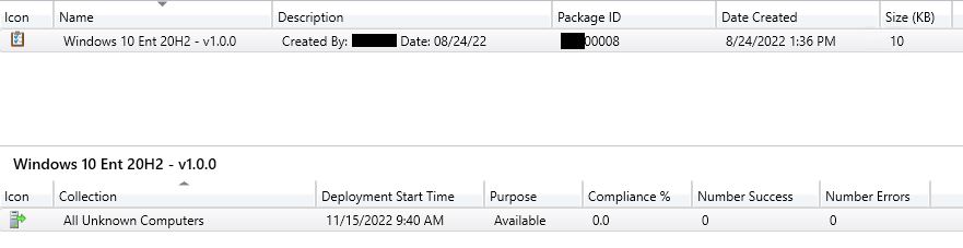

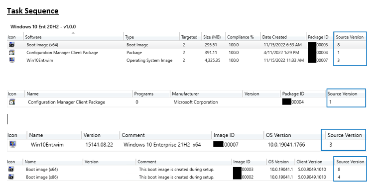

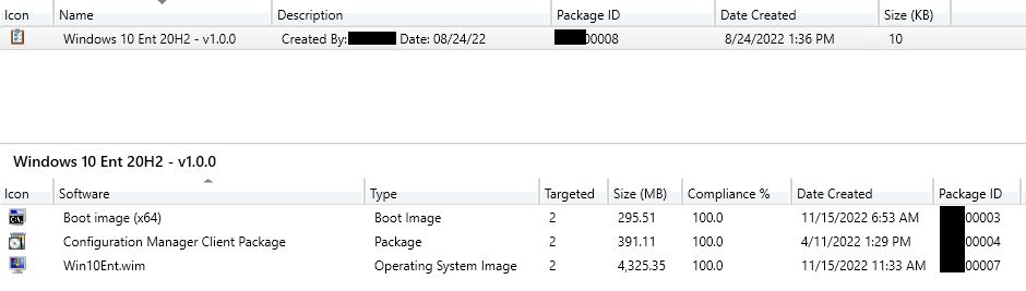

Starting up an SCCM test environment and I have completed the following: Site Server Configured Distribution Point Configured PXE configured x64 Boot Image, Configuration Manager Client Package and wim distributed to DP Task sequence deployed to All Unknown Computers Problem, the task sequence is failing at "apply operating system (See attached SMSTS.log) Verified all packages have been distributed Verified that the network service account is present on the site server. Does the network service account also need to be assigned on the DP site server role? smsts.log

Got it working. I deleted the content from the DP, re-distributed and I am good now. Thank you for your assistance ? -

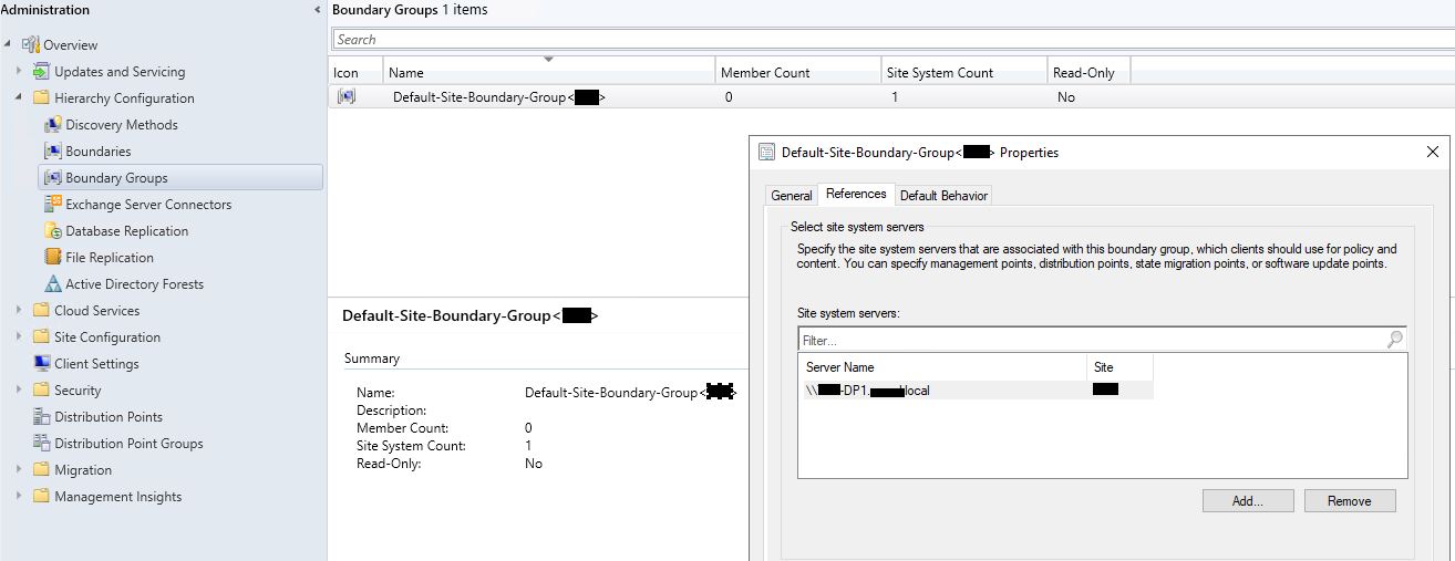

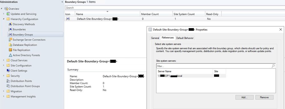

I do not as the site server and dp are on the same subnet -

Starting up an SCCM test environment and I have completed the following: Site Server Configured Distribution Point Configured PXE configured x64 Boot Image, Configuration Manager Client Package and wim distributed to DP Task sequence deployed to All Unknown Computers When I launch the task sequence it states that it cannot run because the program files for XX00003 cannot be located on the dp. I have verified that the files are on the DP and have also re-distributed them. The SMSTS log states Content location request for XX00003 failed (Code 0x80040102) Failed to resolve PackageID=XX00003 (This is my x64 Boot Image)
