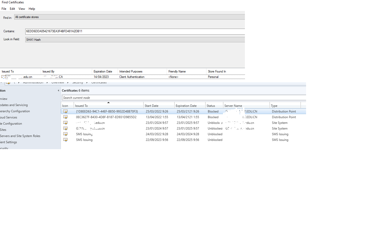

I‘m having issue with SMS_MP_CONTROL_MANAGER with Error 12175. I also checked my SCCM server's certificate and found that both SMS Role SSL Certificate expried 25/03/2023 and MECM llS Servers Certificate expired 13/04/2024. I suspected this might be the cause but how can I renew them step by step? If this is fixed, is it possible to renew them automatically? I have the GPO to handling certificate related configuration but maybe I've missted any? I've been using this SCCM server for around 2-3 years in production and recently I didn't touch it at all:( Any advice would be really appreciated. following are the erorr messages in SCCM console: MP Control Manager detected User Service is not responding to HTTP requests. The HTTP status code and text is 12175, . Possible cause: Internet Information Services (IIS) isn't running or configured to listen on the ports over which the site is configured to communicate. Solution: Verify that the designated Web Site is configured to use the same ports which the site is configured to use. Possible cause: The designated Web Site is disabled in IIS. Solution: Verify that the designated Web Site is enabled, and functioning properly. Possible cause: The User Service application pool identity does not have the required logon privileges. Solution: Verify that the User Service application pool is configured to run under Network Service account. Possible cause: ASP.NET is not installed. Solution: Ensure ASP.NET 4.5 or above is selected under Web Server - Application Development and Features in Windows Server. Possible cause: ASP.NET application does not function properly. Solution: Browse to http(s)://localhost/CMUserService_WindowsAuth/ApplicationViewService.asmx on the local server machine and follow error instructions.

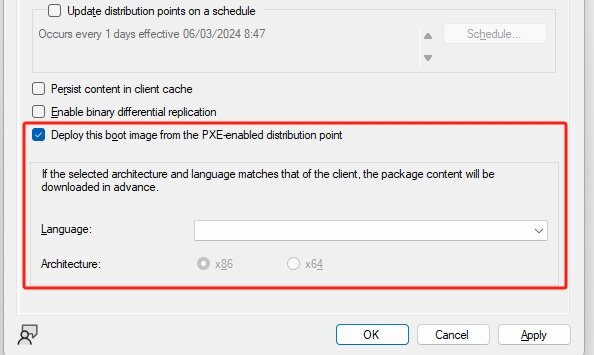

I used the default boot images in SCCM, I didn't add any boot images to WSD, and it worked with ASUSD320 desktops. I followed instructions from some posts and videos, I didn't see anyone added boot images to the WDS, do I need to do that? I noticed that in your screenshot it was the wdsmgfi.efi NBP file, and the file size is totally different. Honestly I'm not 100% following your points but would you mind advising how can I proceed to fix this issue? by deploying x64 boot images what can I do and how to make it PXE bootable?
I deployed the TS to all unknown computers only, after I deleted the existing record from SCCM Device list on console. The only change I made in TS was to specify the xml file located in the same SCCM server, I used the default install.wim from in SCCM and it works fine with ASUSD320 but not HP or Lenovo laptop models we have:( I can try adding the network drives for a try later. I'm trying to upload a short video I took on an HP 430G7 laptop, it showed "start over IPV4" then in a second it switched back to the key options, I kept pressing ENTER but it still went back. If I pressed F12 again, I couldn't see the black screen with "start over IPV4" anymore. PXE Failed.mp4
I've tried to find it from SMSPXE.log but nothing was found there, no even one single record of log. I don't think it went to the PXE process at all. The odd thing I can't figure out is that, if I used the same network cable and connect the machine to our MDT (another subnet with DHCP options), it can be OSD'ed directly without any issues. Since the PXE didn't seem to start at all with SCCM, I doubt that it was anything to do with boot.image?

Dear Experts, I've set up SCCM OSD and successfully deployed the latest Windows 11 to ASUSD320 models, all is good. Now I need to deploy the same OS to the HP laptops but when I tried F12 to network boot, it flashed in less than 1 second and switched back to the boot order option wizard. Since it's working fine with ASUS models, I suspect it had something to do with the network drive not being detected or injected. In MDT, we use the general driver packs for HP and Dell and it works fine for our models including HP430G7, G8, HP440G8, Lenovo L389/390, etc. but this seems challenging for SCCM. Any idea? If we need to deploy the same driver package to SCCM TS, what are the correct steps to get this to work? Thank you very much.

Dear Experts, In our Prod SCCM server, we are running into this issue where when we pxe boot from the client machines (new ones), F12 boot fine, but then it didn't load the .wim file, instead it showed the blue screen "Recovery Your PC/Device needs to be repaired The Windows Boot Configuralion Data (BCD) file from the PXE server does not contain a valid operating system enlry. Ensure thatthe server has boot images installed for this architecture File:\Tmp\x86x64{E9C9C3CD-A5ED-4543-89AF-AB9C1F99BA641}.bcd Error code:0xc0000098 You'l need to use recovery tools. lf you don' have any installtion media (ike a disc or UsB device), conlact your Pc administrator olPC/Device manufacturer." From the SCCM smspxe.log, I can see the following that seems to be cert issue but I have no clue how to fix it, we had PKI for our SCCM environment. Certificate [Thumbprint 0A1159C6EDD6DDA05421673EA3F4BFD481A2DB11] issued to 'MECMServer.edu.cn' has expired. Certificate not valid.. A required certificate is not within its validity period when verifying against the current system clock or the timestamp in the signed file. (Error: 800B0101; Source: Windows) SMSPXE 08/02/2024 16:41:24 2588 (0x0A1C) From certlm.msc on SCCM server, I can find the certificate via FIND option but I didn't see it actually in the personal folder as shown via FIND field. I went to Administration, Security and then Certificates on SCCM console. In there I had 2 blocked DP certificates and the issued to fields were showing as GUIDs rather than actual FQDNs. If I checked their properties, they are not trusted. What is the certificate being expired and how can we renew it? I suspect it was the DP certificate but I'm not sure at all:( Any advice would be much appreciated.

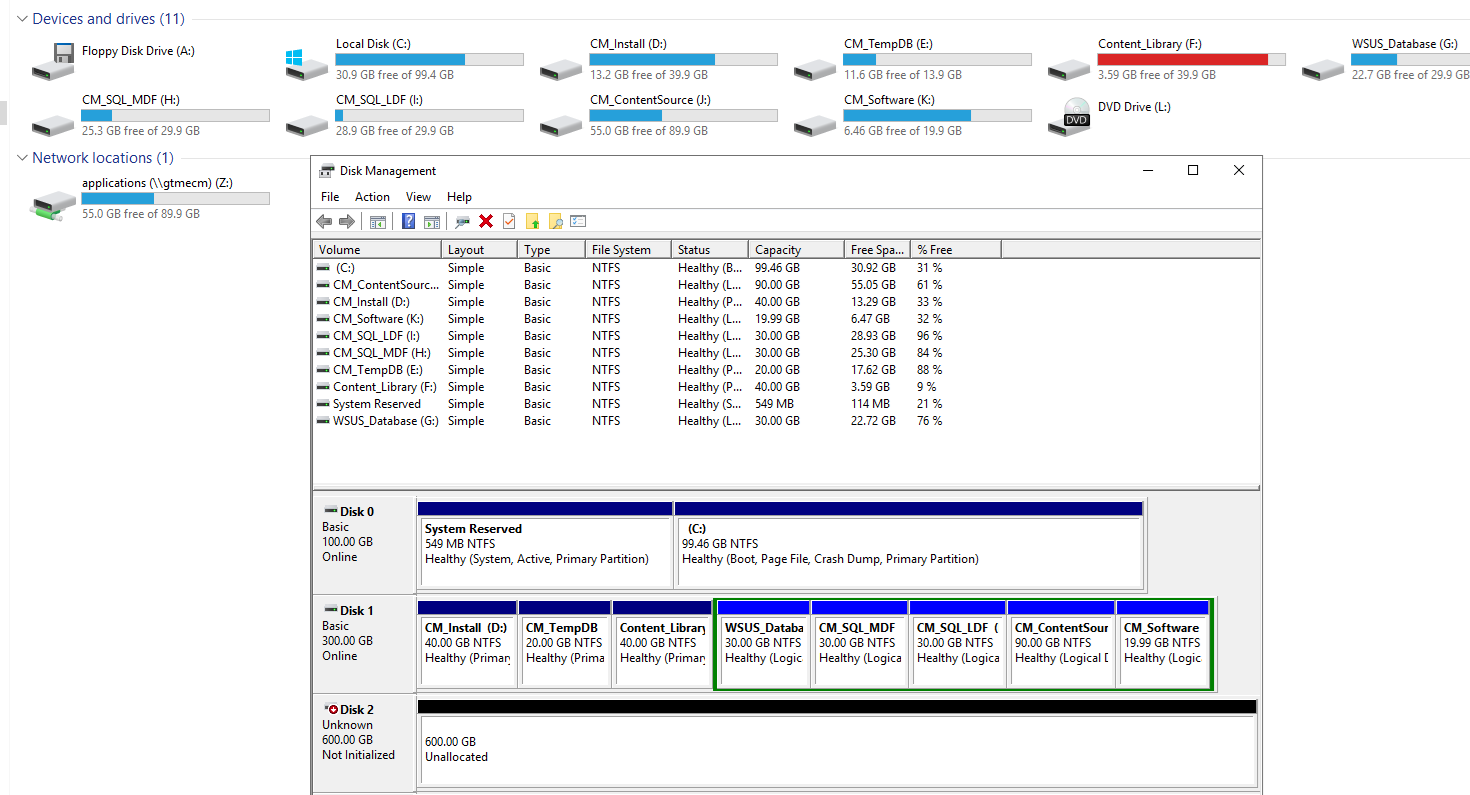

Dear Experts, I've been googling around trying to expand one of our SCCM drives where all content library resides. This has caused issues with our DP and reporting service point and failed for CB update prerequisite check. I was advised to expand the drive by changing it from BASIC to DYNAMIC but I'm not sure what is the side effect and any risks of destroying our prod server. I'm also looking for third-party tools like EaseUS but seems they are also offering to change the disk to dynamic:( I tried to clean up the content library but it showed me "Approximately 0 bytes would have been freed if this tool was run in delete mode." I was also thinking about initiating a new drive, change it next to G drive, deleting the volume and expand F drive to use the space but that seems very risky in production... This is our primary site and we have only one Win 2019 server hosting everything including the SQL server. I might also need to expand other drives later but I'm totally lost now:( Any help would be really appreciated. Thanks a lot for your assistance in advance.
