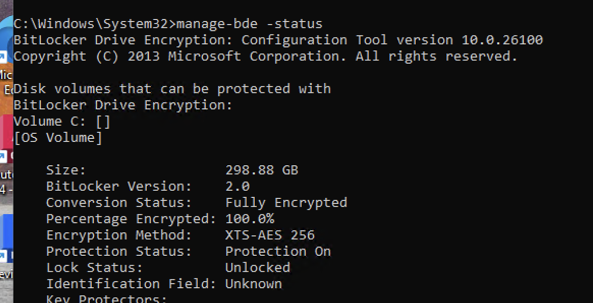

  7. @anyweb, thank you for your availability and troubleshooting. I have figured out the problem. The issue stemmed from the fact that I was primarily working with headless computers in my environment. Even though I was running MSTSC with the /admin or /console switch, I never properly checked if the established session was, in fact, a console session. This is why the policy would fail, and we would see errors in the logs when the policy attempted to launch the MBAM UI. I didn’t realize this until I revisited my VMs and accessed them through the console, instead of connecting via MSTSC. On existing, imaged devices, I was able to resolve the issue by manually interacting with a few devices using SCCM's remote control viewer, which establishes a console session. After logging in via SCCM’s remote viewer, the BitLocker policy executed and encrypted the drives without any issues. For anyone else in your community facing a similar problem, I addressed the headless computer issue by creating a task sequence during OS deployment. This ensures that devices are imaged with the appropriate BitLocker settings that align with my BitLocker policy. This way, all imaged devices are compliant from the start, and SCCM can still report compliance for these devices, since the policy settings are consistent and encryption is not required. Since I will mostly be accessing the headless computers via MSTSC, this solution works well for my environment.
