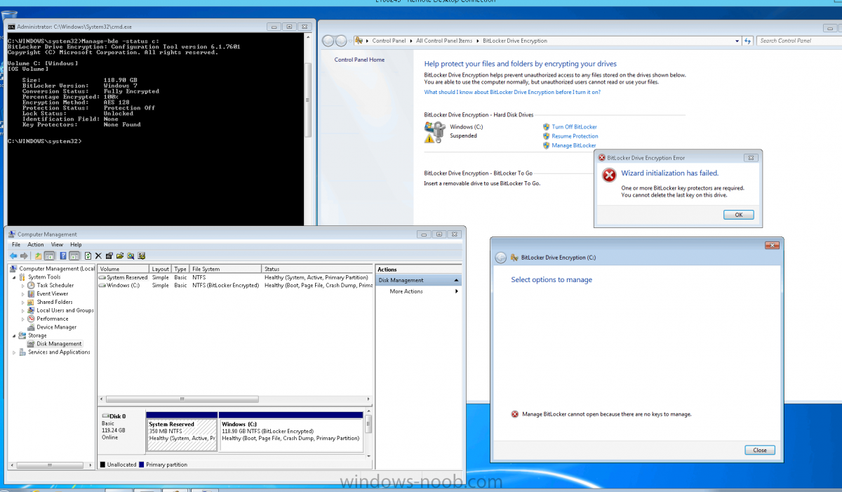

  1. This issue has resolved itself without any intervention. If it reoccurs I will update here Thanks for all the help and input, much appreciated
  2. Ah, interesting, I'll investigate further, thank you
  3. Hi smsts attached Thanks smsts-20141222-110840.log
  4. @ anyweb The Disk management snapin is showing eactly the same setup as the non-working system @Rocket Man No changes at all to any drivers @Rafaelvazquez The Disk is encrypted, it just will not resume via the GUI manage-bde -protectors -add c: -tpm -rp turns the Protection back on: Output: Key Protectors Added: Numerical Password: ID: {11X5XXX7-X6XX-4X33-X484-X81362251232} Password: 123456-678901-789012-345678-123456-123456-123456-123456 TPM: ID: {Random String} ACTIONS REQUIRED: 1. Save this numerical recovery password in a secure location away from your computer: 123456-678901-789012-345678-123456-123456-123456-123456 To prevent data loss, save this password immediately. This password helps ensure that you can unlock the encrypted volume. manage-bde -on c:Output: C:\Windows\system32>manage-bde -status C: BitLocker Drive Encryption: Configuration Tool version 6.1.7601 Copyright © Microsoft Corporation. All rights reserved. Volume C: [Windows] [OS Volume] Size: 118.90 GB BitLocker Version: Windows 7 Conversion Status: Fully Encrypted Percentage Encrypted: 100% Encryption Method: AES 128 Protection Status: Protection On Lock Status: Unlocked Identification Field: None Key Protectors: Numerical Password TPM So, at the end of the SCCM build, there are no Key Protectors available in order to resume protection. Is there an SCCM log file that would maybe point me in the direction of where the issue may lie? The "Enable BitLocker" step at the end of the task sequence is set to create the Recovery Key in ADDS - if this has not happenned, would we see the issues above? Or alternatively, how would you recommend that I troubleshoot this? Thanks for you help so far everybody!
  5. Nope, there has been no change to the Task Sequence - I'll get hold of a laptop without bitlocker issues next week to verify that the 2 partitions is correct. The task sequence is showing what we see above, which would be expected behaviour Disk Manager and manage-bds are both confirming that the drive is encrypted though?
  6. Hi We have recently had issues with Bitlocker deployments, as per attached screenshot. There is not much in either the smsts log or the ccmexec that points to the cause. I have compared both smsts and ccmexec logs to those from successful builds. What would be the best way to troubleshoot this? Are there other log files that I should be looking at? Many thanks for your help
